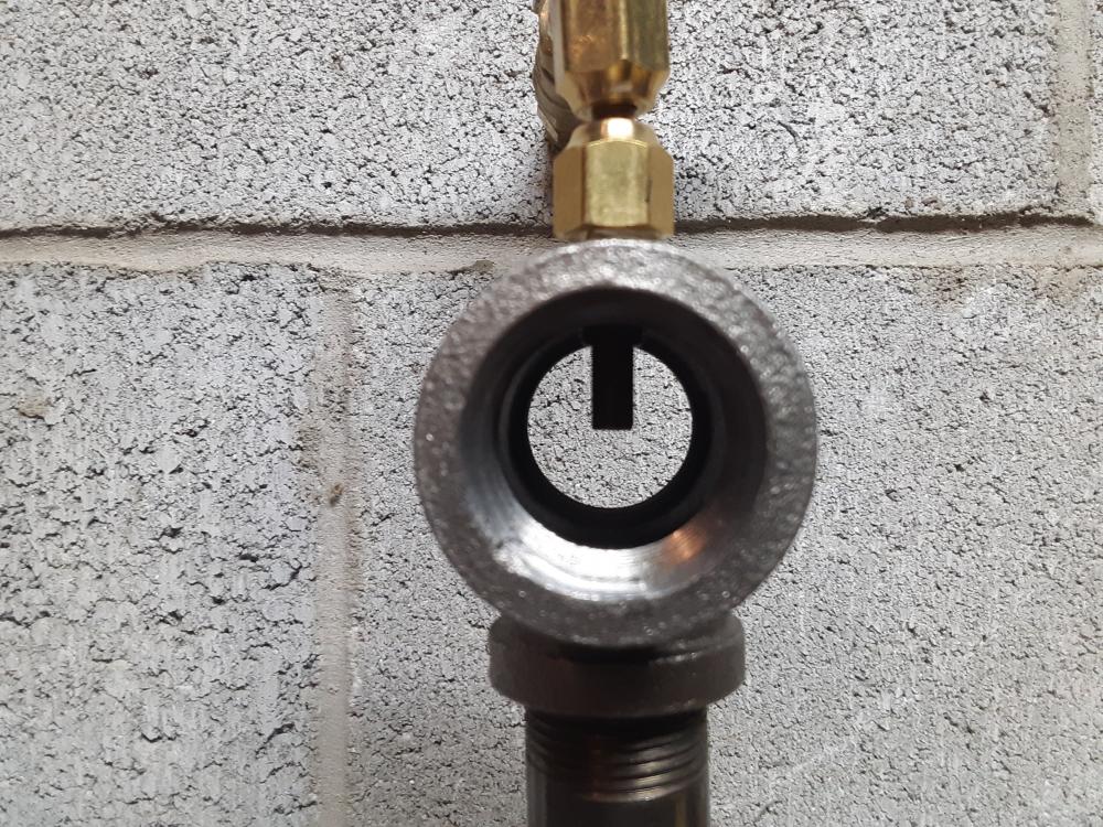

New here, and very excited about all the wealth of knowledge in one spot. In saying that, i sure wish i knew of this place BEFORE i attempted to put this forge together lol. All i see now is all the things to do different!
So i had originally planned a larger, rectangular build. That was months ago though, and i got to noticing steel prices lately, so i decided to just go with an old freon tank i had sitting around. I already had the double burner set-up and plumbing, saw someone on youtube had done it, and, well, here we are. Massive overkill i know. Hey, i can always turn it down, right? It looks ridiculous, and kind of embarrasing : / Anyways, it is what it is now, here is the issue: On its 2nd fireup, after about 15 minutes, i noticed some occasional wiffs of flames up in the t-area. It seems to be running okay, there are occasional "coughs" id like to diagnose, but lets start with the safety issue first.
2" kao and Mizzou refractory, 6 inch nipples, .035 tips, pretty standard stuff. I recall not putting teflon tape on the mig tip, but i figure a leak there would not be a wandering flame? Theres room for the burner to go up another inch or so, could be too low in the forge? Was at about 5psi, bouncing back and forth between burners, valves just cracked open, refractory was pretty orange, was it just too much heat?  Also of note, this is running outside with occasional breezes. I looked for answers before i posted, didnt find any, hope you all dont mind the question.

MJForge iwas thinking back to tuning my frosty t and if i remember correct that is a problem of too rich remember frostys numbers are a ballpark you need to tune it more from there raise the tip up. if still too rich trim1/16th off and try again also be sure to clear the mig tip after cutting frosty or mike may say other than me though so don't take me word for word

Thank you all. I guess my thinking/worries first off revolve around the shear ridiculousness of this thing lol. Im not daunted, not going to give up, i'll look back at it someday with a chuckle i suppose, and be better off for it. But until i nail down a CONCRETE THIS TIME plan for the next one, im concerned that thing is even safely usable, first and foremost. So thats my first question. To my thinking, the heat potential of it is pretty high for such a small area, and thats just got to introduce all kinds of variables. Even if i get the burners properly tuned, then what?Just more headaches because of the bad design?
The flames showed up after it was warmed up, thats my first clue. Exactly what is burning, where its coming from, i dont know. I cant imagine flame coming back up the burner, but i have no idea, maybe it can? Sure dosnt seem possible from my limited experience thinking. Excess fuel being ignited? Well, i'll shutup and let the experts-expert.
But... Next one must-have list: Proper burner to size ratio, loose all these fittings for more stable set-up, and a more durable refractory layer. I wheel this thing outside for use, and im noticing how hard that is on it. Thanks again, i really appreciate it!

Stop with the self deprecating banter, you've done a pretty darn good job for not really knowing what you're doing. Yeah, lose most of the hardware hanging on the burners, the ball valves need to go on the manifold way back from the burners. If you keep the hoses as far from the openings as possible you probably don't need copper tubing, propane hose is designed to be fire resistant and has a distinctive smell if it's getting hot.
Your burners look good, they're too far into the forge so the nozzle ends are getting hot enough to pre-ignite the mix in the mixing tube.
Without seeing them burning I can't guess how well tuned they are.
Burning back to the gas jet is NOT a matter of fuel air ratio. The cause is two fold, you already know what one is but I'll confirm it. YES your forge is too small for a pair of 3/4" NA burners, back pressure will peak, stopping the flow so the flame will burn back in the mixing tubes, this stops combustion in the forge which relieves the back pressure so your burners start burning again. This can be very quiet and subtle, yours is on the subtle side, OR it can be loud like a chainsaw on sheet metal or send large puffs of flame out the forge openings.
The other cause is because you fell for the mythtaken notion that the lower the psi burners run the better. This is an urban myth, started inadvertently by Ron Reil who took low psi as a goal and spent a bunch of time and effort getting his to run at darned low pressure.
I've been making T burners since I developed this adaptation of a jet ejector for a burner, I'm thinking 30-35 years? No I just used my fingers to count and it's got to be 40 years. I had my first one working before the internet went public.
Anyway, none of my T burners operate properly at much less than 9-10psi. and I'll turn them up to 14psi. if I'm needing a screaming HOT fire cave for something special.
You have have more than 2x too much burner, pull one of them off and save it for your next forge. One 3/4" T alone is a nice amount of overkill for a freon tank forge. Save the one closest to the opening you use, it'll let you work without putting more of your project in the forge than necessary.
Pull the burner back until it's barely penetrating the refractory liner, just inside the shell. The thing to watch out for is is the flame being blown back out the burner port in a jet. A little flame exiting around the burner is no problem but if the flame exiting the nozzle is hitting the liner in a way it's being deflected back then it's a problem. Just slip the burner a LITTLE bit deeper. By LITTLE I mean a little bit, a 1/4" is a big adjustment. Sneak up on the optimum distance to insert the burner. Don't get carried away looking for IDEAL, just get it working properly. Okay?
While you have the ceramic blanket unpacked from the burner and burner mount to adjust it out, age your burner so it is NOT aimed straight at the far side. Floor in this case, it's like filling a cup by squirting a hose straight down in it. The flame is hitting a pretty close floor straight on and dispersing in 360*. Unfortunately the curve of the cylinder represents greater resistance than running along the floor to the openings. What tends to happen is excess back pressure which inhibits burner performance.
If you aim the burner so it's hitting the far side at an angle the flame will flow around the cylinder with less resistance, meaning lass back pressure so the burner will breath easier and burn more strongly. As a last benefit the flame forming a swirling pattern in the forge will spend longer in the chamber transferring ore energy to the liner which in tern radiates it as IR onto your project to do useful work for you.
Make sense? Give these a try and please feel free to give me a shout, we'll get that puppy up and screaming hot in no time. You'll have a better handle on these little machines when you build your next one. ;)

So yes, that all does make sense to me.  I have enough material to fill the extra burner hole, and i'll just go in slight adjustments on the depth and and angle of the burner, and go from there. I'll get to work on it, and report back. Thanks again!

Pull your burner all but about 1/4" out of the liner. You can form the liner itself into a flare. This adjustment doesn't need to be crept up on incrementally, unless it starts BLOWING flame out the burner port. A little flame is okay though it SHOULD induct air into the forge through gaps.

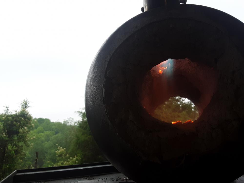

So ive not gone far with this thing, its been storming every time i can spend some time with it outside. I did get the hole filled, refractory is dried, and just had time tonight to take a few pics. First 2 are with the burner slightly tipped to the side, second is tipped as far as coupler allows, looks to be hitting at a better angle. Kinda tough to get a good pic of the flame that shows color, its pretty crowded in there. Just thought id check in and see if that helps any. Thanks.
Certainly looks better; let us know once you get forging.

Thanks, and will do. And thats cool, us too.
