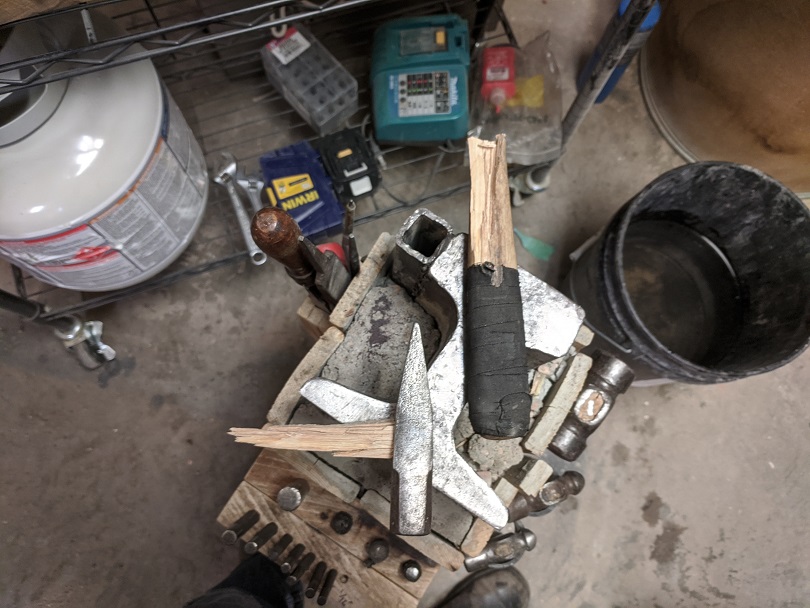

So this is the third time this year I've snapped this hammer's handle. I'm very much a weekend forger, and the longest time I've had between snappage was probably about 10 forging sessions of a few hours each. It's my favorite hammer head at the 16oz size so I'd like to get this right. I'm gonna give you all the details if any of you feel inclined to post-mortem where I went astray.
First break:
For the handle, I took a concrete tamper and cut a chunk off the handle. It was labeled as and ash handle, but who knows. I cut a slot for a wooden wedge on the band saw, drove a wooden wedge and a metal wedge in. I've made all my own wooden wedges using shim scrap and a palm sander. The wooden wedge went with the long axis of the eye, and I put the metal wedge at a 45 to the wooden wedge. After driving the metal wedge, I saw a crack about 3/4" long running down the length of the handle starting where the eye touches the handle. I filled it with epoxy and forged away. Lasted quite a while, but broke after about 10 forging sessions with a jagged fracture under the eye. I didn't get any photos of this break.
Second break:
While rehandling after the first break, the handle snapped on a diagonal plane while I was driving in the metal wedge. I just took the first handle, cut off the snapped part and rasp-ed the end down to fit in the eye, and cut a slot for a wooden wedge with a borrowed dozuki (it's not mine, I'm not one of those guys, I swear! :P). This time I used linseed oil on the part of the handle inside the eye and on the wood wedge after researching the forums here. This time I took a photo:
Looks to me like the metal wedge was too much stress and caused a crack or propagated what was left of the crack on the first attempt.
Third break:
I ran out of tamper handle, so I dug through my box of saw drops and found a piece of kiln-dried plane-sawn that was so white it had to be ash or maple. As I'm writing this and looking at the rest of that wood, it doesn't have the grain to be ash and I'm pretty sure it's maple. I shaped the handle on my belt sander, and did the same procedure as the previous two times, wood and metal wedges. I didn't see any cracks on the wood after driving the metal wedge. Two forging sessions later, the head flies off. I have pictures, but I'm pretty confident I just solved this one by realizing I used maple instead of ash.
Overall, the common denominator of the first two failures seems to be the metal wedge, and the third was a material mistake. The wedge is about 1/8" thick by 5/16" long at the widest and tapers over 5/8" ish, with three "barbs". The hammer eye is very roughly 3/4" x 1/2". When I use no metal wedge, the wood wedge always starts backing itself out after the first few strikes (both for band saw cut slot and dozuki cut slot). I haven't tried waiting long enough for the linseed oil to set before swinging, but I feel like the wood wedge shouldn't back itself out that easily linseed or no. Any advice here?
Make and cut a slot for the wedge that has a bit of a kerf.  Smear the sides of the wooden wedge with wood glue to make the wedge slide into place easier.  Once the glue sets, the wedge should stay put.  If it later loosens up, add a metal wedge.
When you finish putting the handle into the hammer head, leave 1/4 inch of the handle sticking out of the hammer head.  This will mushroom over in time and keep the head from coming off the handle.  Turn the hammer handle up in a bit of boiled linseed oil and mineral spirits and let the mixture soak into the wood. Couple of days should do, and add more mix as needed to keep the wood covered.   Remove the hammer and wipe the hammer head as well as the whole hammer handle using the mix and an old t-shirt.  When finished burn or spread out the shirt material so it does not spontaneously combust.  Wipe the handle with the boiled linseed oil and mineral spirits mix every day for a week and once a week for a month.  Let the wood suck up all the mix it wants.
Examine your hammer technique.  You can not push the hammer to move metal, so hold the hammer loosely let the hammer head do the work.  When it wants to bounce off the metal, let it, catch it on the way up and swing again.

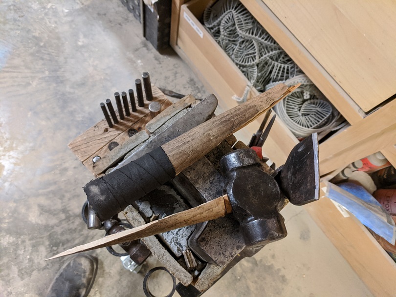

Guess what I broke this time! Another handle I made last year from the same concrete tamper! Who'da thunk! Cracked start all the way inside the eye, followed the grain, and split the handle. I may not be doing too well in the forging department but I'm getting really good at making wooden shivs :D

Seems like that is too many broken handles.  Time to compare all three for common problems, flaws, etc.
It may be your swing.  Hold the hammer handle loosely and do not push it toward the impact.  Let the hammer head do the work.
On the bottom side of the pic of the handle, up near the head is a small divot in the wood. You did not have a missed blow at one point and hit with the handle and not the head did you?  I know seems kind of no brainer not to do it, but when diagnosing a problem start with the basics.
This may help some. Make a list of things that will cuase the handle to break. Things like missed blow, loose head, etc. Then go one by one and eliminate each until you discover the cuase. Oh and do not assume, make sure. Make sure that the head was not working loose, do not assume that since you have been using the hammer for the past year it was still tight (as an example, i know kind of hard after it is broken.)
Forget the tamper handle! It's only good for longitudinal forces and not strong ones at that, you don't ram tampers into the ground, you lift them a few inches, foot at most and let them fall with a LITTLE extra. Trying to slam them down only tires you out faster without significant improvement to compaction, a broom handle works just fine on a tamper.
A hammer needs to resist bending moments and impact shock, any flaws are stress risers and failure initiation points. If the shoulders at the head are sharp you might want to soften the inside corner for the same reason you don't forge a sharp inside corner. It's not as much an issue with wood but it CAN contribute to issues.

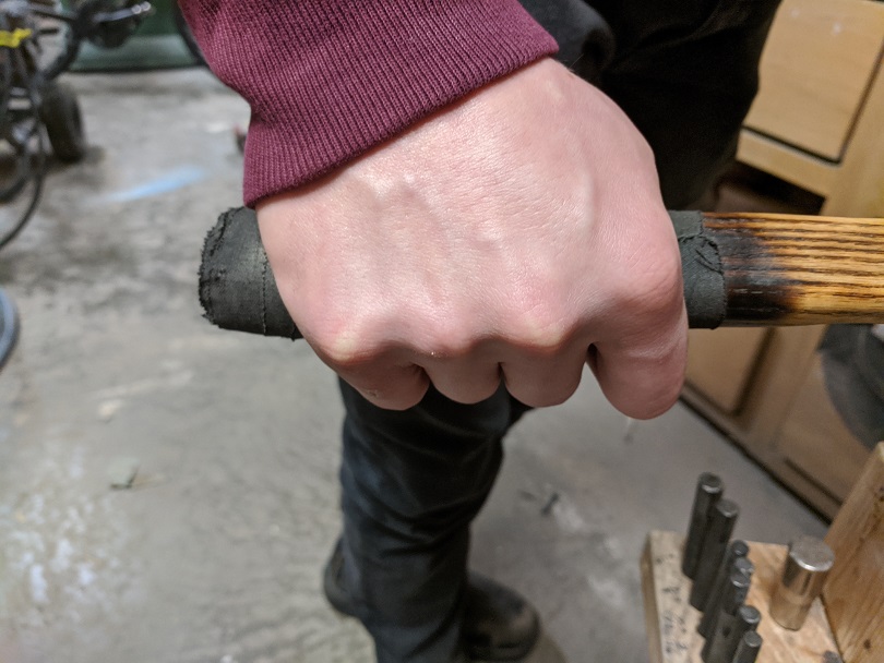

Failure Analysis:
Show us photos of what your hitting, the hammer used, how the hammer contacts the work, etc.  Show us the way you are gripping the hammer handle, from both sides.  Once we actually see what you are doing, we can then make specific suggestions.

Most of what I did recently was kitchen knives. Included an unfinished blank with the next photo showing my basic grip (no tongs because one hand for the camera!).
Side views of my grip:
I change grips when raising (not swinging down, that has the same grip as above) a hammer that's more than 2lbs:
Sorry I know that's a lot of uncropped photos. I resized them as quickly as I could. Going on a trip.
The hammer used wasn't this hammer in the grip photos. The hammer I use 80% of the time is the rounding hammer I snapped. Same grip, but I don't change grips when lifting the rounding hammer.
