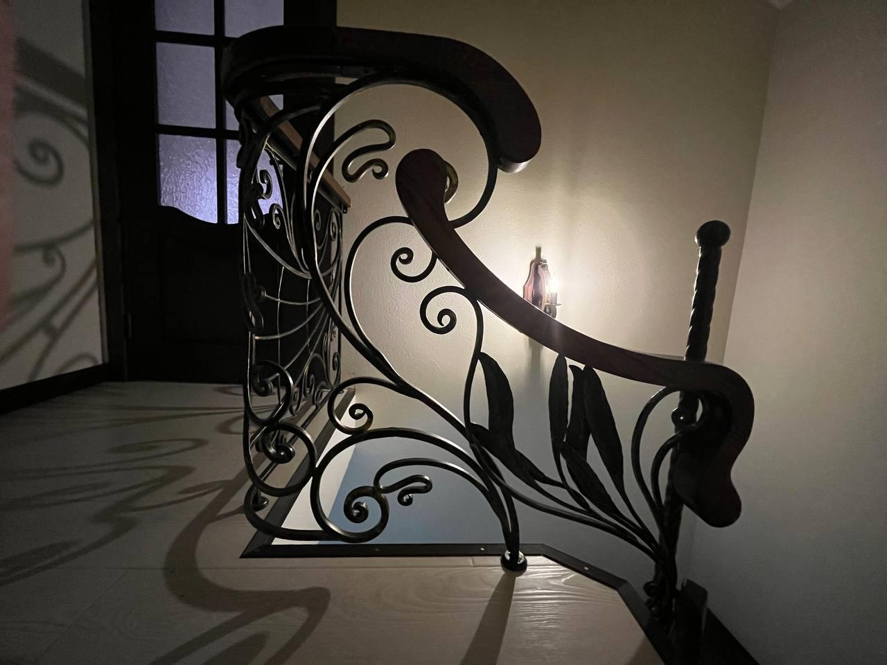

alexandr Posted July 27, 2023 Share Posted July 27, 2023 Guys, thanks for your ratings. Finished another project today. Connected 2 railings on the stairs. Quote Link to comment Share on other sites More sharing options...
LarryFahnoe Posted July 27, 2023 Share Posted July 27, 2023 Beautiful work Alexandr!! --Larry Quote Link to comment Share on other sites More sharing options...
Frosty Posted July 27, 2023 Share Posted July 27, 2023 IIRC Repousse is French for, "Pushed from behind." Exquisite as always Alex! These railings bring something new to my mind with every new angle. A fishing net into the surf, wind and clouds, undersea scenes. What a treat it would be to walk up and down the stairs every day. Frosty The Lucky. Quote Link to comment Share on other sites More sharing options...
alexandr Posted July 27, 2023 Share Posted July 27, 2023 Парни, спасибо! The customer is passionate about yachting and fishing. His wish was the presence of a fishing net and a sword. I coped with this task, it was more difficult to find a solution how to connect the fences to each other. The stairs have a very small turning radius. After a long "brainstorming" suggested to make a spear and add some algae. There is a small child in the house, it was necessary to close all the holes. The customer's wife sent a video. 1.MOV Quote Link to comment Share on other sites More sharing options...
Frosty Posted July 27, 2023 Share Posted July 27, 2023 You nailed it Alex! Frosty The Lucky. Quote Link to comment Share on other sites More sharing options...
Shainarue Posted July 27, 2023 Share Posted July 27, 2023 Alex, job well done! That is beautiful and handsome. Quote Link to comment Share on other sites More sharing options...
Hefty Posted July 28, 2023 Share Posted July 28, 2023 Alex, do you cold-twist the spiral into the pole of the spear the same way you do your square bar twists? It looks great! Jono. Quote Link to comment Share on other sites More sharing options...

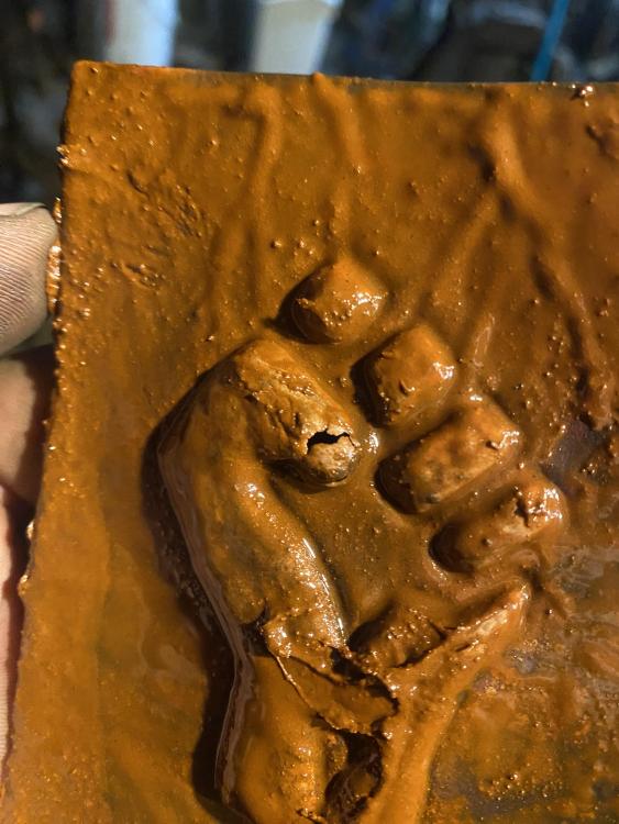

JHCC Posted July 28, 2023 Share Posted July 28, 2023 Fixed the thumb, but tore the copper. I’ll do the planishing and see how it looks; I might be able to pull off a repair. Also made an adjustable-height chasing stand out of a bit of gear I’d picked up cheap and had been thinking about using in a striking vise. This is better. All the way up: All the way down: Quote Link to comment Share on other sites More sharing options...

alexandr Posted July 28, 2023 Share Posted July 28, 2023 20 hours ago, Hefty said: Alex, do you cold-twist the spiral into the pole of the spear the same way you do your square bar twists? It looks great! Jono. Hi! This is a rolled pipe. I buy them ready made. There are different diameters. Quote Link to comment Share on other sites More sharing options...

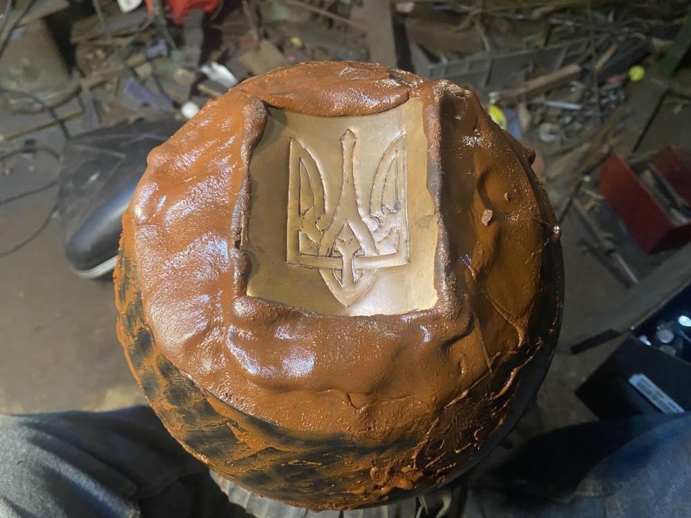

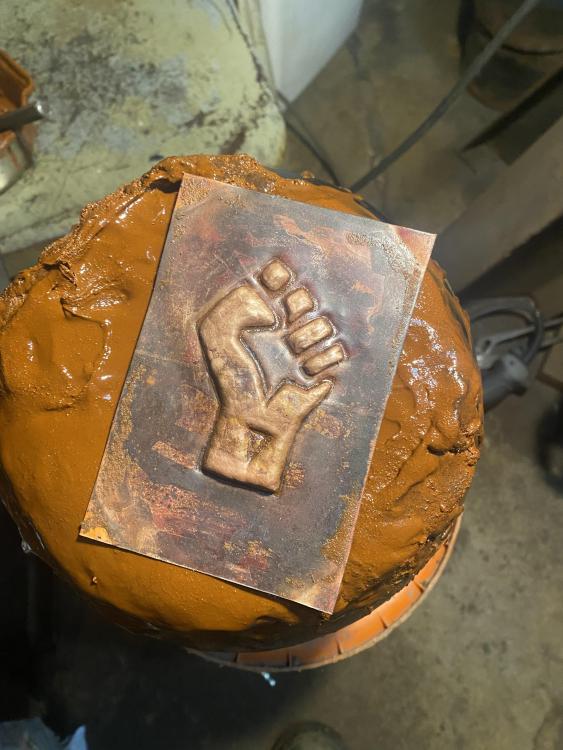

JHCC Posted July 29, 2023 Share Posted July 29, 2023 Finish the hammer work on the first repoussage piece, which still needs pickling and finishing: And started a second practice piece: I think the next project will be a flower, but I’ll need to make a few more tools first. I like the workstand, but it is a bit low, even at its highest setting. I have some more of the pipe I made the legs from, so I’ll probably splice in about 18” on each leg. I think I may also add a rim around the top of the bowling ball, to keep the pitch from running down the sides. Quote Link to comment Share on other sites More sharing options...
