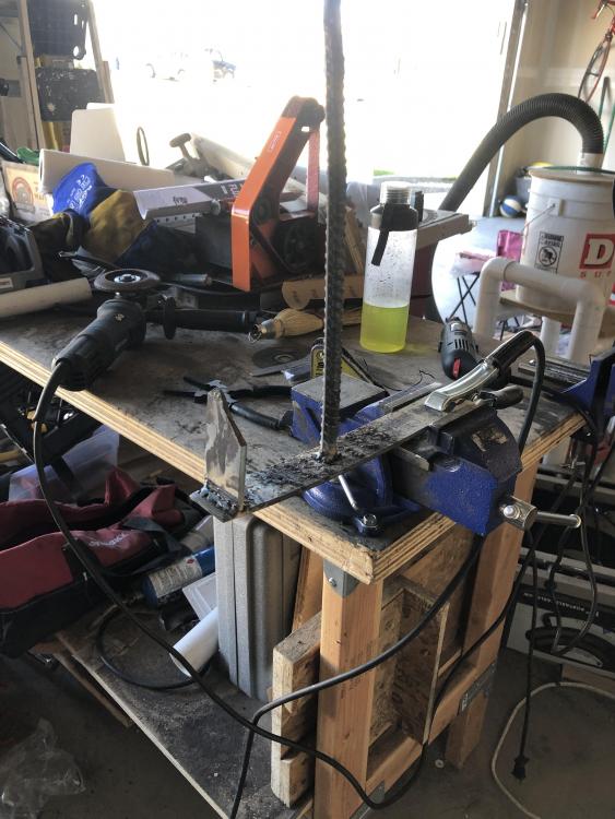

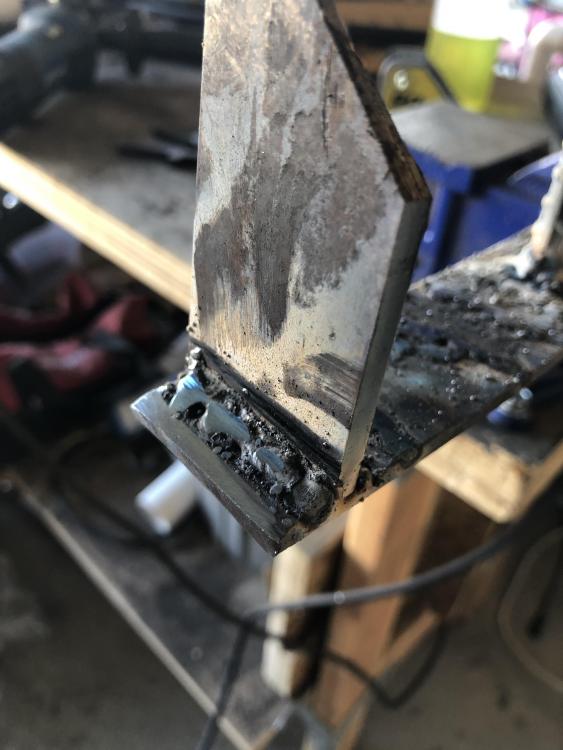

BEHOLD! I have welded.
First weld ever (not really, I welded once in 7th grade but I’m not counting it). It’s terrible, it’s awful, but I finally got off my butt and tried.
About 3 hours before the Governor decided to close the state for 21 days, I was driving past HF, and decided to stop and buy their cheap welder, so I can teach myself to weld.
For fun I was just making sloppy lines (very sloppy) and then wanted to see if I could make 2 pieces stick together. They are stuck and they have not yet fallen apart!
It may not be a big deal to you but after almost a decade of school and countless years of intellectual navel gazing it is very nice to be doing things rather than thinking things.
Appears to be stuck, so long as it's not structural. Chip the slag out so you can see how well without testing to destruction. Grinding welds smooth is NOT considered a pro thing.

Those little HF welders are not terrible, but the flux wire that comes with it usually is. It's usually pretty dirty. You may have better results with name-brand stuff (I did) and they sell Lincoln MIG flux wire at Lowes. Your local welding store, if open, may have better selection and better pricing, but at minimum, try a roll of the name brand and see if that works better for you. I have a favorite Central Welding store that's full of knowledgeable, helpful people and while I may be the stupidest customer they have, they are always quick with good info.
