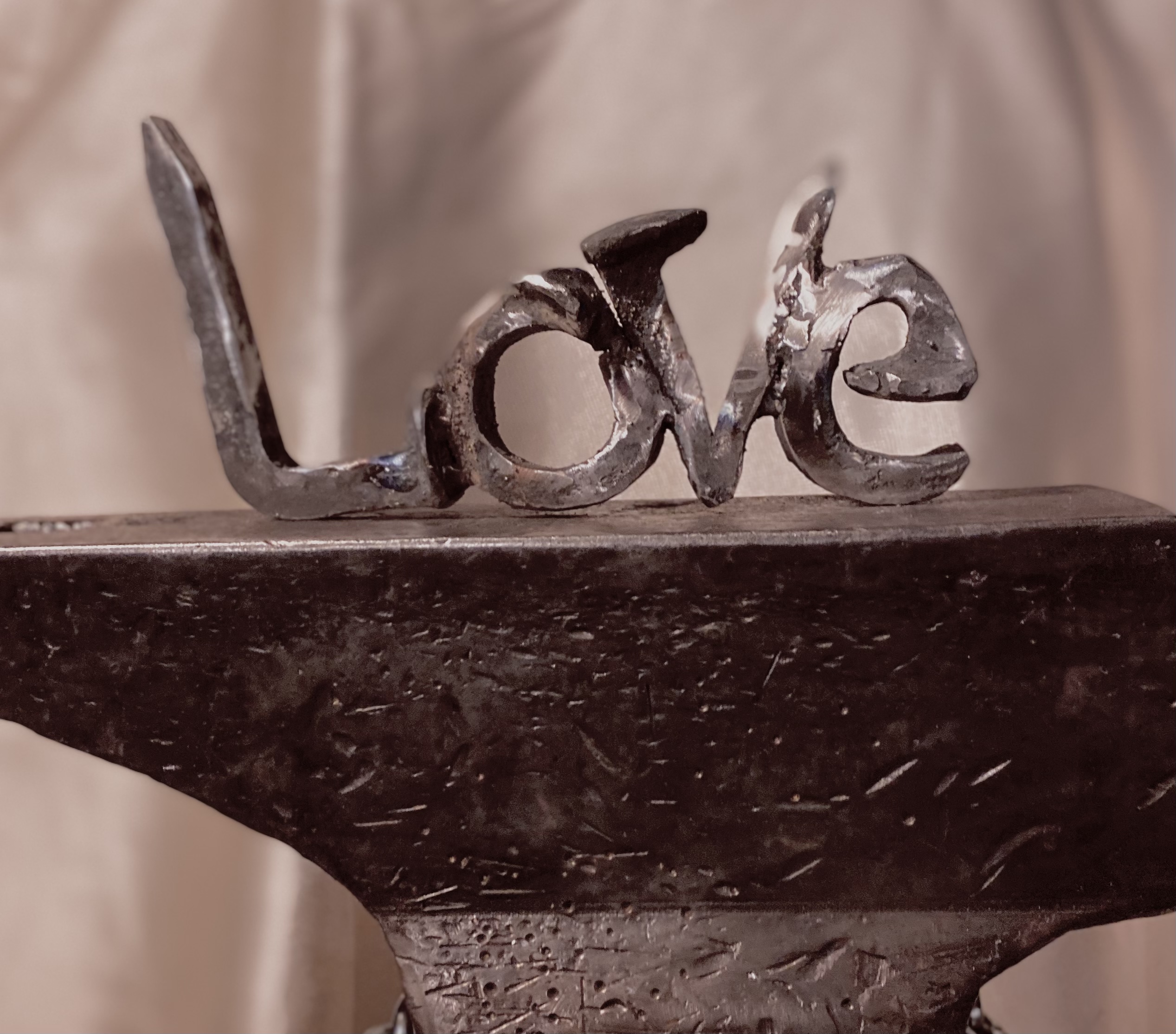

  7. Thanks for the replies folks! For those who commented on the idea for this use of RR spikes, this wasn’t my original idea. My daughter saw it on Pinterest. I don’t know who came up with the original idea but it’s really clever.
  8. So... My kid saw this online and said she wanted one. It took me a while, but I finally was able to make something I didn’t hate. Question: How would you go about cleaning this thing up? There is weld splatter, forge scale, and all sorts of other “dirty” stuff that probably doesn’t belong in a little girls bedroom or on something kids will handle. I don’t have a sand blasting cabinet and the idea of hand sanding or going over all of the little parts on this with a dremmel does not sound happy. Can you sand blast without a cabinet?

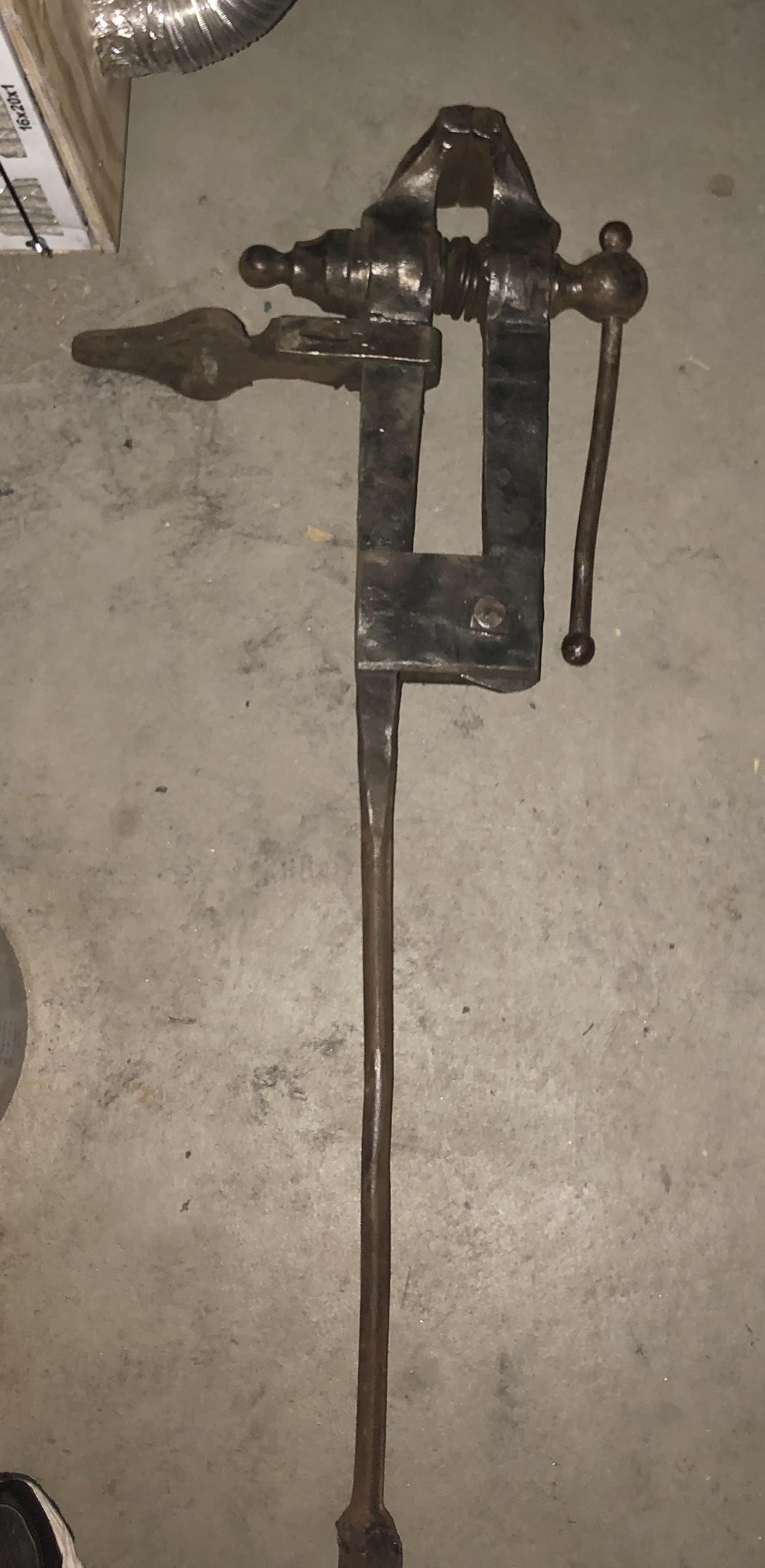

  19. mpc replied to mpc's topic in Vises
    Well, the base is almost done (I’m going to put casters on it). I had to forge a new bracket to hold it in place. That was entertaining and educational. I just need to make a spring and I’m done

  23. mpc replied to mpc's topic in Vises
    Any tips on forging a new spring? I need to forge a new mounting bracket. I figured I’d just use some 3/8 mild steel I have sitting around for that. Then, I’ve got a big ol’ coil spring in the garage. I was thinking I’d cut off a bit, draw it out to something flat and just do something that will be held in place by the bracket (like the photo). Do I need to use “spring” steel? Do I need to heat treat it?

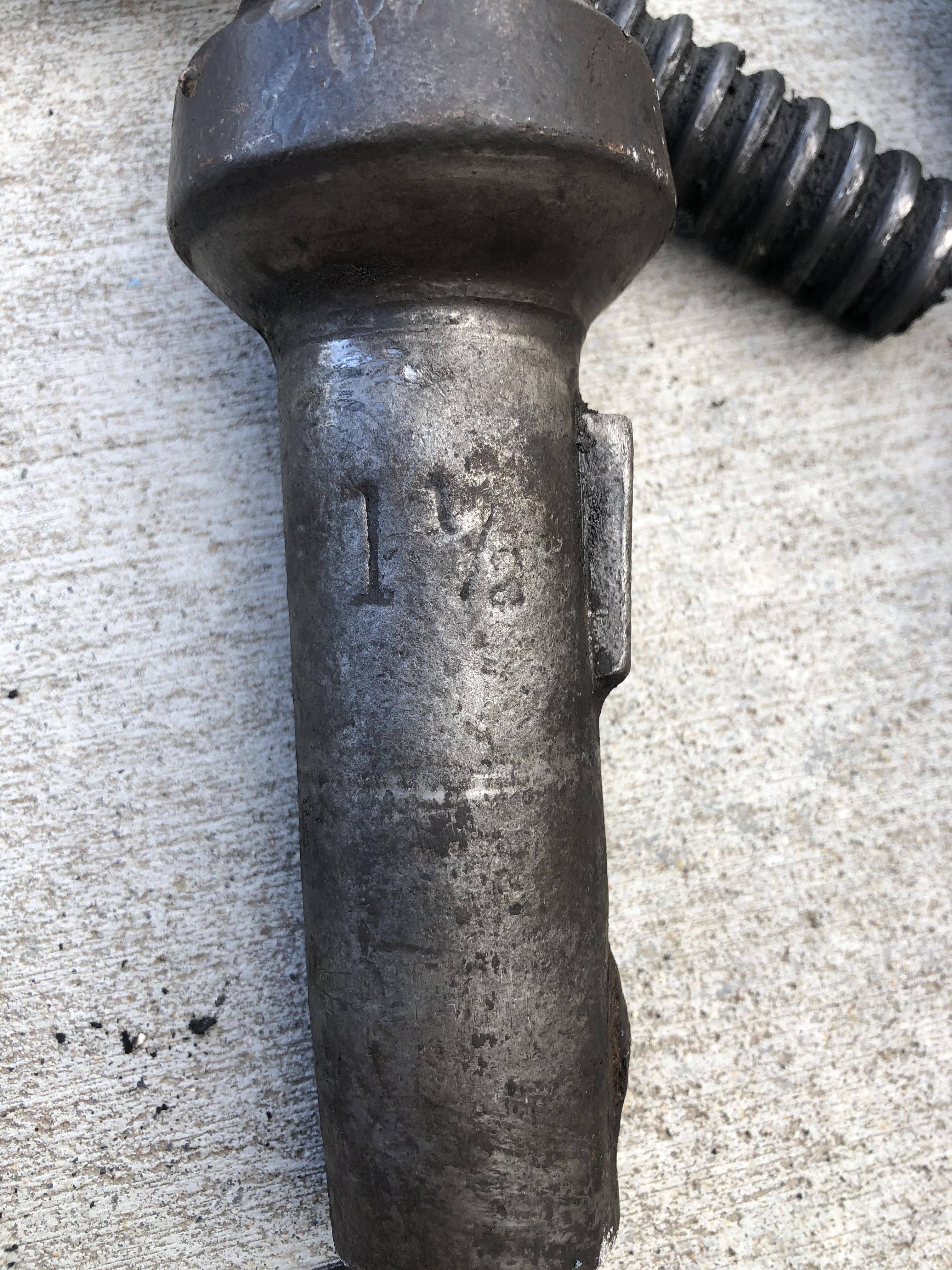

  24. mpc replied to mpc's topic in Vises
    Plot twist: I am out of degreaser! The Mrs (healthcare provider) says it’s not a good enough excuse to run to the store. Now I have to find something around the house to use to clean it. Coronavirus! Also... I stuck my finger in the screw box and was surprised to find that there are only about 2” of thread in there. I was expecting it to be much longer.

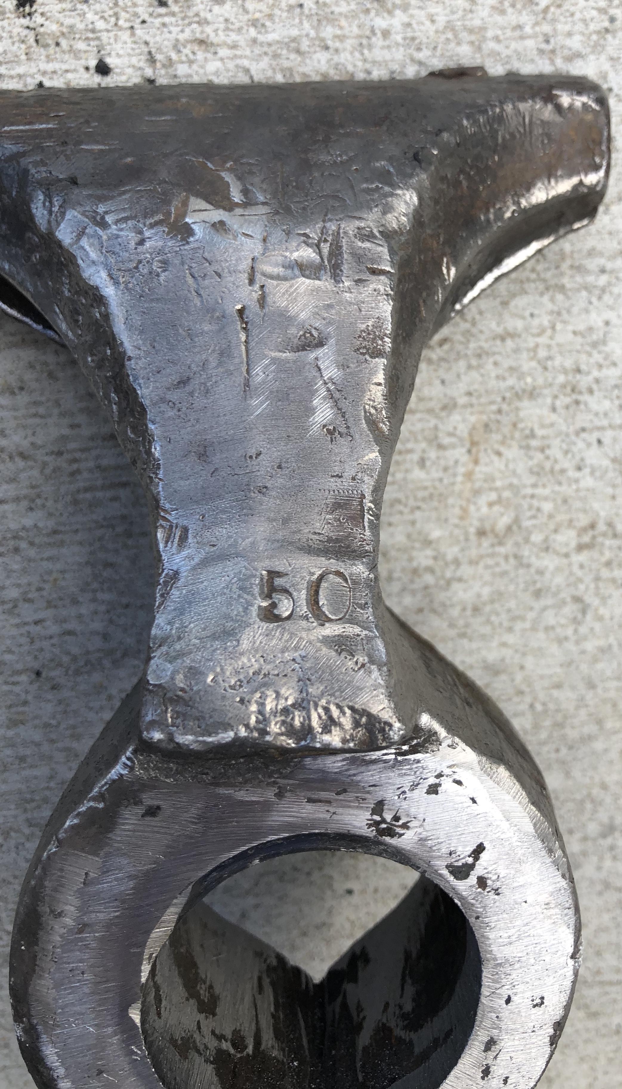

  25. mpc posted a topic in Vises
    I spent my first day of “social distancing” in the garage working on the new vise. I had to cut it away from the RR track. Then I had to cut away the old bracket (because it had been welded into a large glob of metal). They had welded a coil spring around the screw mechanism and that took some time to finally cut away but now I’m down to just the parts. I took pics of all the markings I could find. Next up, I might degrease and re-grease the screw. Maybe clean up the jaws a little. I need to forge a spring and a new bracket. Then I’ll work on figuring out a base. Any other suggestions from those of you who have done this before?
