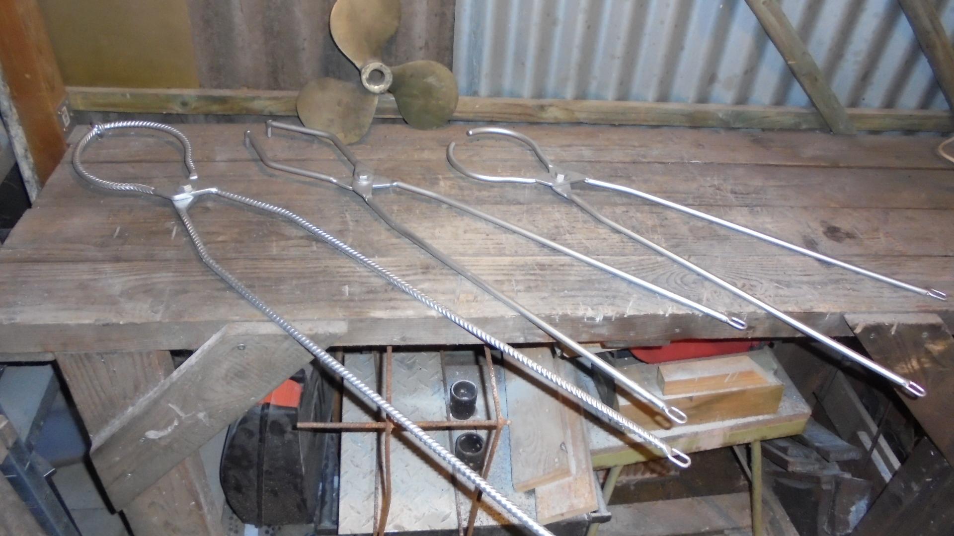

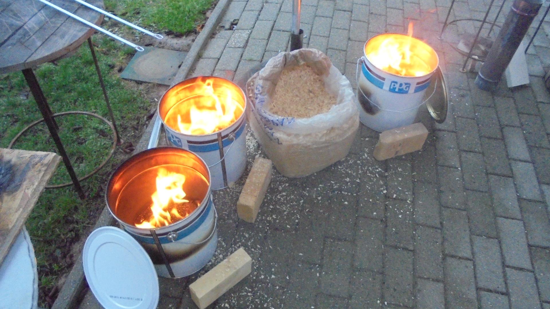

Hans Richter Posted March 24, 2020 Share Posted March 24, 2020 Hi Chris, made these tongs for my raku firing and to place the glazed work in the reduction canisters. Maybe an idea to produce a number of suitable tongs by bending and welding that help you to produce the intended wrought iron tongs. Tongs that are suitable for handling delicate ceramic work will certainly also be suitable for your intended purpose. Big hug to the little wife en stay healthy. Cheers, Hans Quote Link to comment Share on other sites More sharing options...
Chris C Posted March 24, 2020 Author Share Posted March 24, 2020 Thanks, Hans. Quote Link to comment Share on other sites More sharing options...

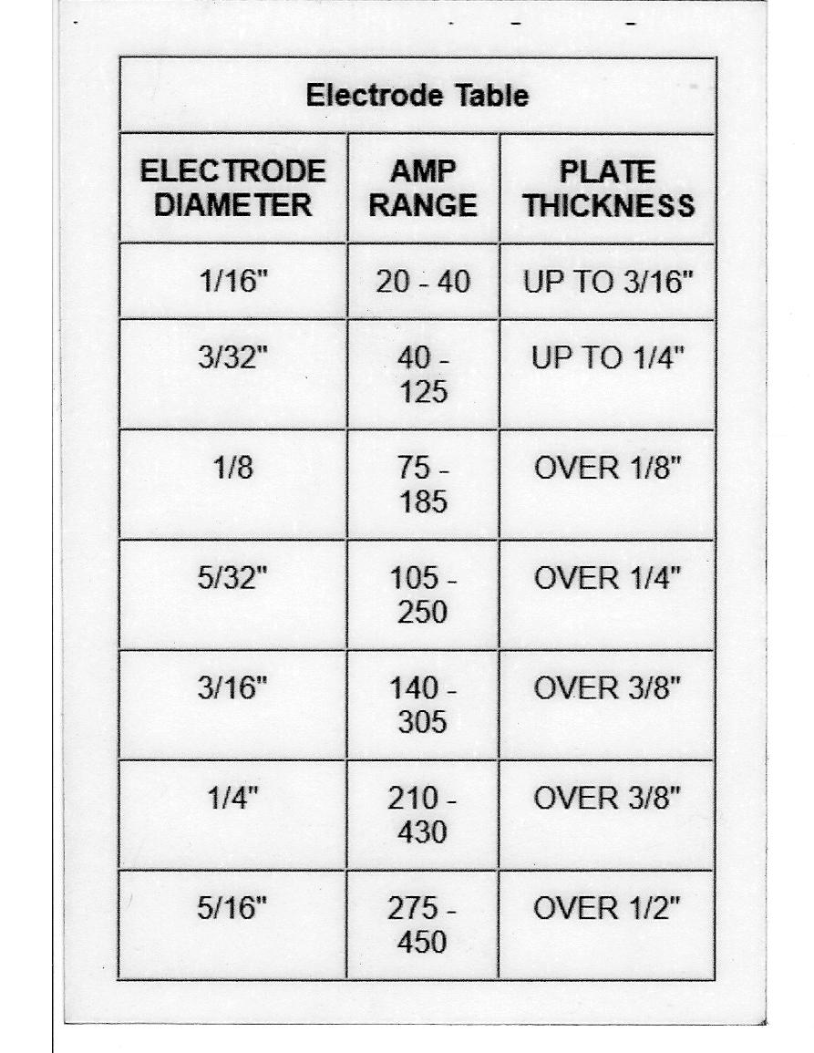

Chris C Posted March 25, 2020 Author Share Posted March 25, 2020 Frosty, This is the chart I go by. Got it off the Internet when I first got my welder. I was using 1/8" rod. Trying to weld a 3/4" post to a 1/4" plate. Figured 145 amps was a pretty good choice. Quote Link to comment Share on other sites More sharing options...
Glenn Posted March 25, 2020 Share Posted March 25, 2020 Different welders have their own personalities and prefer slightly different settings. I have charts as to each rods polarity and settings posted on the welder, then covered with clear tape. Still use the division trick to get close and adjust as needed for each job. Finally started writing the information and taping it to each box of rods also. Quote Link to comment Share on other sites More sharing options...

Marc1 Posted March 25, 2020 Share Posted March 25, 2020 5 hours ago, Chris C said: This is the chart I go by. Got it off the Internet when I first got my welder. I was using 1/8" rod. Trying to weld a 3/4" post to a 1/4" plate. Figured 145 amps was a pretty good choice. That chart is a bit deceiving. What size is "over 1/8" ? 12" is over 1/8 . To try to weld 3/4" to 1/4" plate with 145 amps is possible, if the weld is just to stick them together with not much structural requirement. otherwise you would go with 250 / 300 AMP full blast and 5/32 rod. Quote Link to comment Share on other sites More sharing options...
Chris C Posted March 25, 2020 Author Share Posted March 25, 2020 Marc1, if I read that chart right, "over 1/8" would be between 1/8" and 1/4", at which point the chart suggests stepping up to a 5/32" rod and 105-250 amps. Since this is an AC only machine, I'll stick with AC rods. arkie, I've already wasted my money on a 5 lb box of 7018. Was under the impression I was buying an AC rod. It makes pretty "horse puckies" welds. My rods are as old as the machine, (some 25 years old) so as soon as our "shelter-in-place" order is lifted, I'll get some fresh 60XX rod from the DIY store. I've no propane and no way to get any, so will be practicing on welding today. I'll use the thinnest 6013 rod I have, which is 3/32. Hate wasting it just running beads onto a plate. Wish there was some project I needed (like I did my hammer and ton rack) that I could work on and actually accomplish something, but bare beads it is. Quote Link to comment Share on other sites More sharing options...
