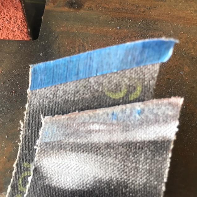

 The original splice, split and with the tape ground off of one side:

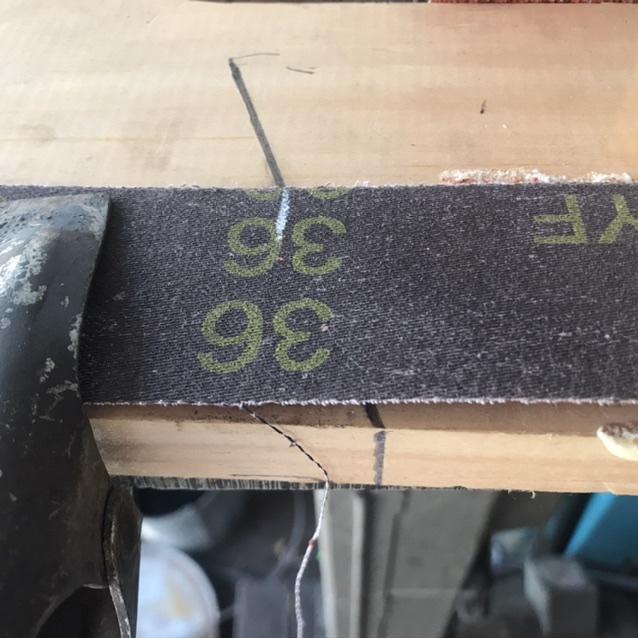

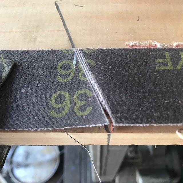

My splicing board has a pencil mark showing the correct angle. Once the length is marked with a bit of soapstone, that mark is put against the angle:
The belt is cut (I use an old handsaw):
The two ends are butted together and clamped to the splicing board:

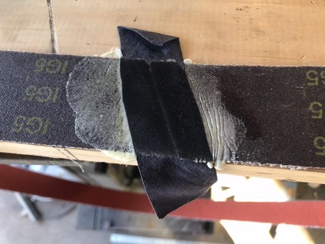

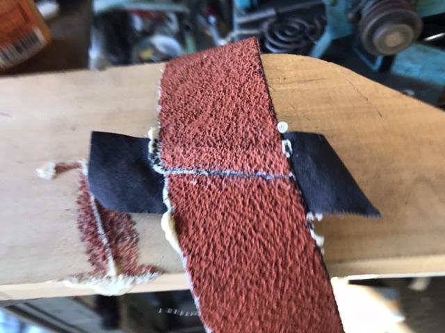

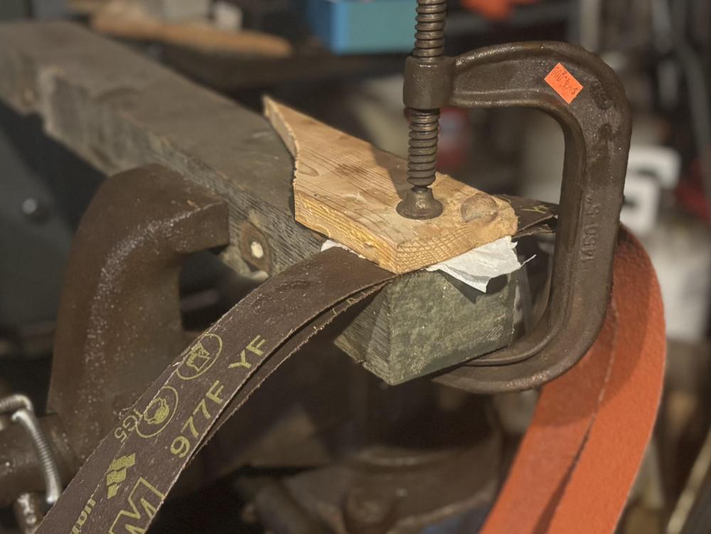

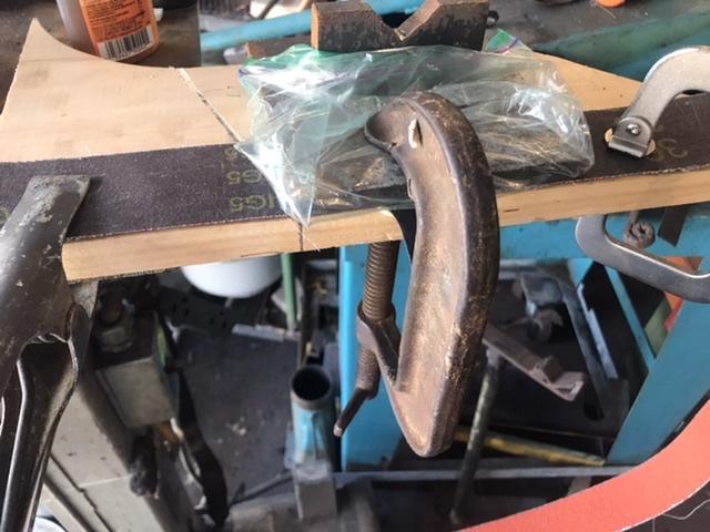

The surfaces are dampened with a wet paper towel, a layer of Gorilla Glue and the fabric splice are applied, the steel clamping block is put in a plastic bag, and everything is clamped together for two hours:

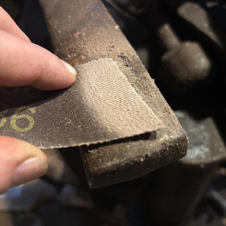

This is the underside, after the glue has cured:

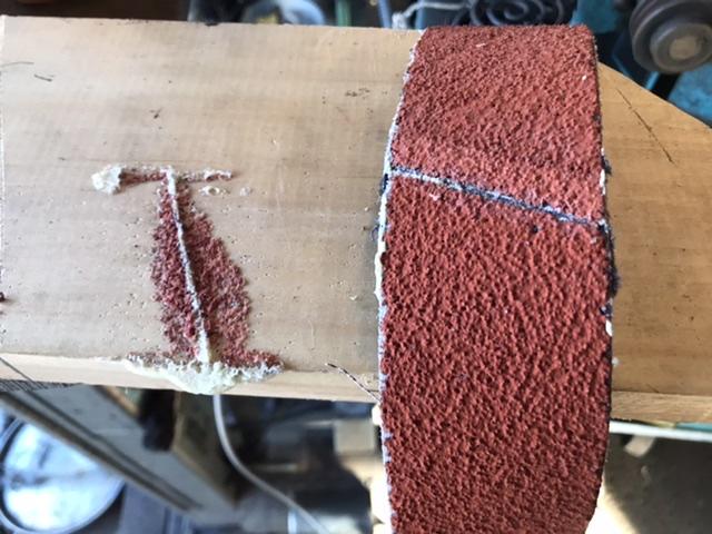

And the front. A bit of the coating came off the belt, but none of the grit.
And this is after the splicing fabric and excess glue have been trimmed from the edges:

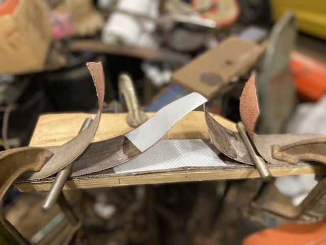

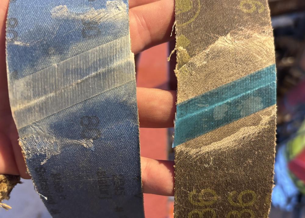

Long-overdue update: in practice, the bias tape tended to last significantly shorter than the belts themselves, and I ended up having to reglue a couple of the belts when the fabric let go. After the last rather spectacular rapid unscheduled disassembly (which fortunately caused no damage apart from a bit of a scratched wrist), I decided to seek other alternatives.
And so, after wandering for a time through the lands of Google, I encountered the following method, which I here assay.
The key ingredient is fiberglass strapping tape of a variety I’d not previously encountered: where the fiberglass is a woven cloth rather than longitudinal fibers. (The original instructions recommended “Scotch Extreme Application packaging tape”; I used “Bunker Hurricane Tape”, as that was what my local hardware store had on the shelf.)

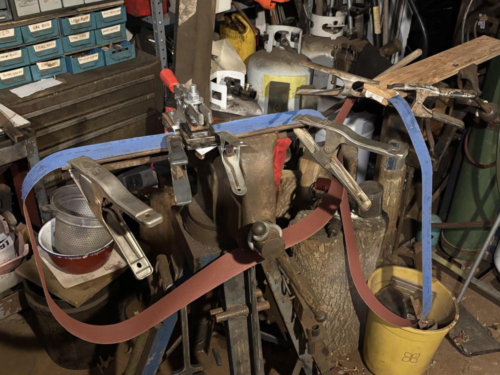

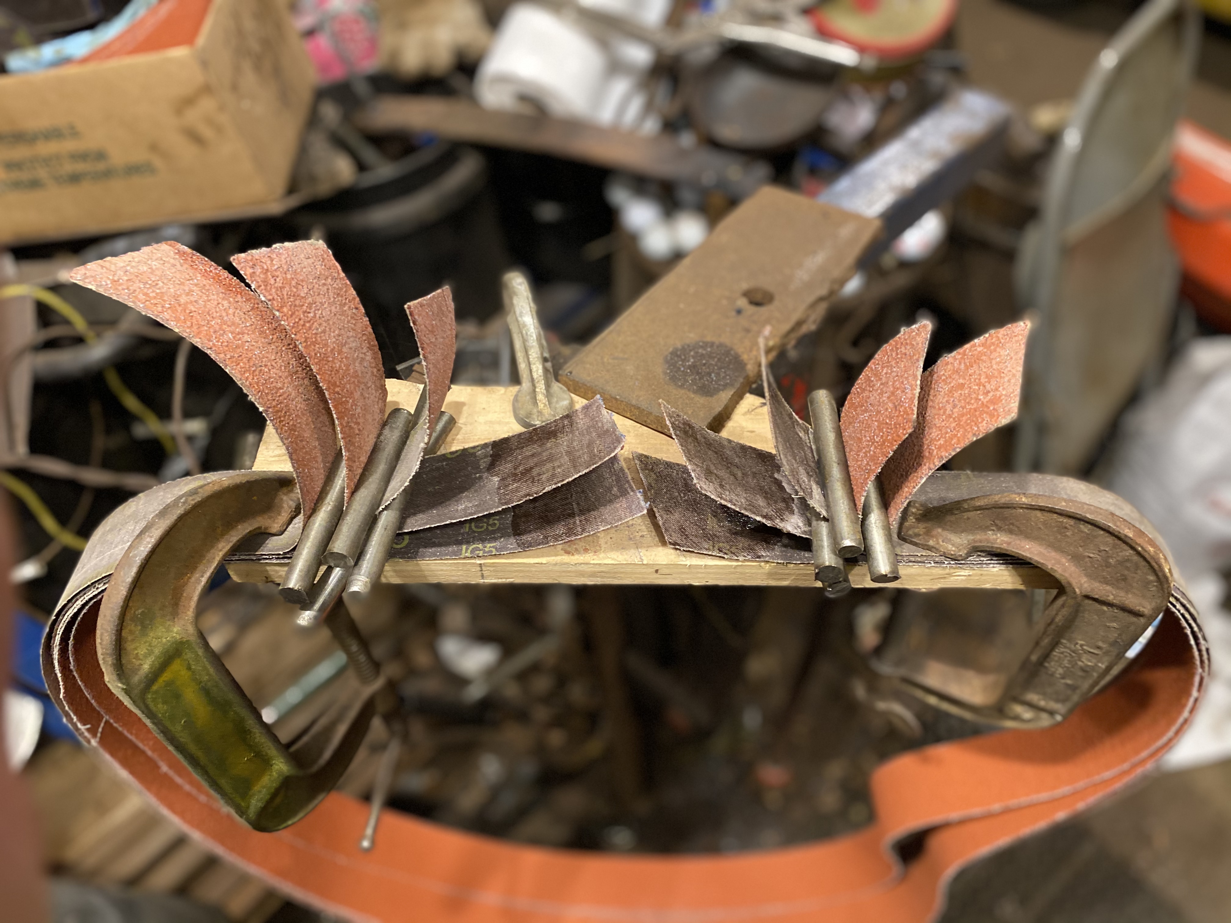

The belts are cut to length and the backs roughened on either side of the splice. A layer of contact cement is applied to the backs and allowed to dry.

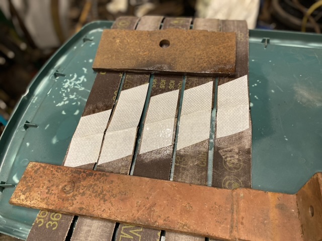

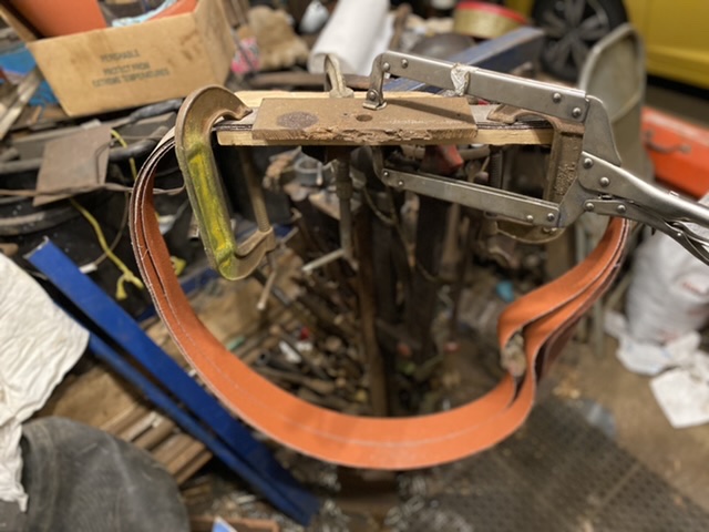

So here I’ve set up five belts to glue. They’re all clamped down to a backing board, aligned with the front edge to keep them straight. I’ve put some pieces of round bar between the belts to keep them separated while the glue dries.

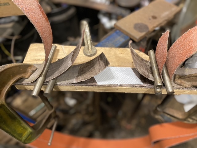

The tape is applied first to one end and then the other.

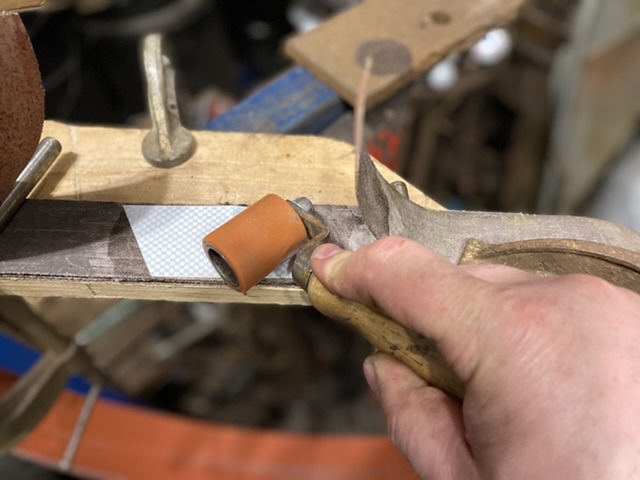

The tape is rolled down with a brayer.
This is repeated until the whole stack is done. It’s probably not necessary, but as recommended in the instructions I was following, I clamped everything to cure for an hour or two.
Finish with a quick coat of spray polyurethane to seal the edges.
And we’ll give it a try tomorrow!

UPDATE: I took a look at the belts during my lunch break today, and things don't look good. The tape was bubbling, and when I put one of the belts on the grinder and tensioned it, the joint blew apart instantly. The adhesive on the tape did not hold at all and was actually still sticky.
I've done a bit more research on the Hurricane tape, and it turns out to have been a bad choice. It seems that it's a pressure-sensitive, water-based adhesive that stays removable for up to two weeks. Oh, well.
Next step is to get the originally recommended tape and try again. With luck, I should be able to get the bad glue off these five belts so they won't be wasted.
Lesson learned: don't overcommit to an untested method.

Although I have never spliced 2x72 belts, when I spliced 1x30 belts. 3M Scotch brand strapping tape worked well. I made the tape twice as long as the factory tape and it held well and there was no "thump" as the belt passed the splice.
Proper tape acquired. I’ll get some contact cement later. Updates to follow.
That should work. The tape I used only had the thread running in one direction. I didn't use any extra cement and used a roller to stick the tape down. From the picture yours has a cross hatch pattern, should be stronger for sure.
