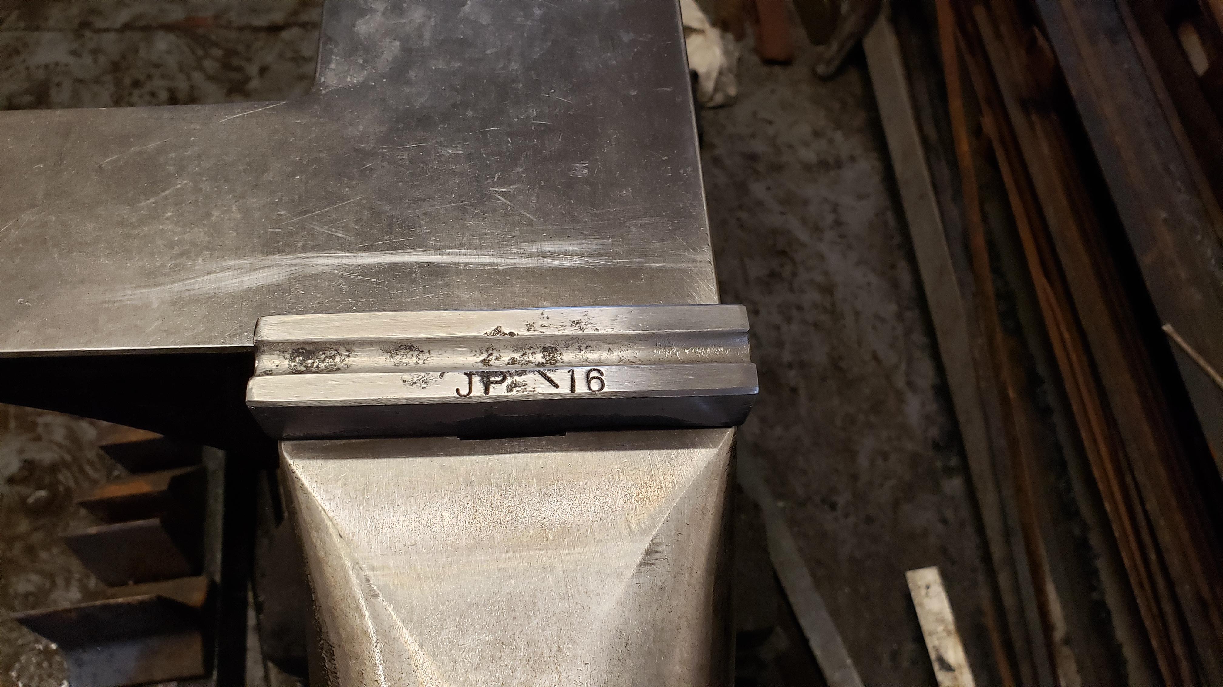

It tested out between 60 and 64 all over. Tail, horn and side shelf and 1 spot just shy of primary work spot 60-61.
Every where else 64HRc.
I will get my bench top hardness tester in the next few weeks and make a few cert blocks to compare it to.
But against known hardened materials it's pretty close.
It was tough holding everything and the camera to get it all to jive.
Until the tester is verified it's just for fun.
I tested it on hardened 5160 and 1045 and it was accurate for those materials as hardened.
61HRc and 55HRc so seems pretty good.
I'll makes test blocks which a tool like this should be verified against before use.
Fun and interesting just the same.

So the hardness has been verified using the tester with test blocks..  It accurate enough for me.
As for use.. It's a great anvil..  I'd love to have more rise in the horn since I use the horn a lot so to account for the desired rise I use the offside radius to gain more penetration.
Coming up on a full year of use and have no complaints and would buy one again if the need be.
its very comfortable to work on..  Anyone who swings a hammer a lot will know what I mean.  (feedback, control, metal movement, etc, etc)..
