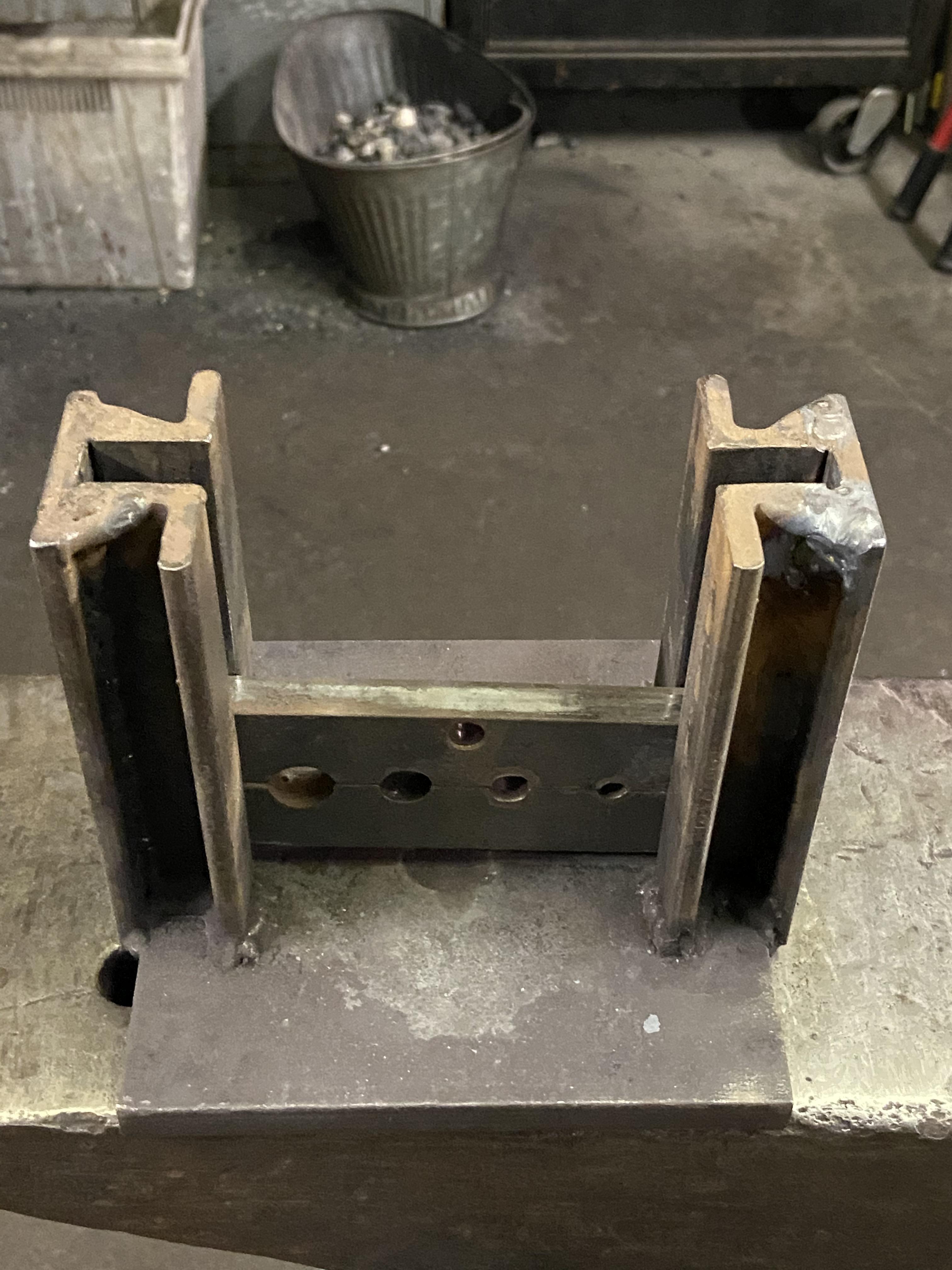

MacLeod Posted January 26, 2020 Share Posted January 26, 2020 On 1/24/2020 at 3:23 PM, ThomasPowers said: sans-culotte I look up to the sans-culotte Well, after cutting up rust leaf springs and cutting up some plate to make a frame which took all of yesterday, including head scratching time, I changed my approach today. I went for something that suits the small stock I mainly use and cobbled this together using an old square profile caravan axle. I suppose what I really mean is I went for something more suited to my ability! It’s not pretty but I can turn the dies 90 degrees in it which will come in handy. I had to do a silly shaped hardy peg for Anvilina’s silly shaped hardy hole but it doesn’t go anywhere when I leather it. Apart from work on my sons dirt bike I did nothing else today, Mrs MacLeod’s to do list grows longer Link to comment Share on other sites More sharing options...
Irondragon Forge ClayWorks Posted January 26, 2020 Share Posted January 26, 2020 Great idea using square dies, may have to build another Guillotine myself. Link to comment Share on other sites More sharing options...
MacLeod Posted January 26, 2020 Share Posted January 26, 2020 1 hour ago, Irondragon Forge & Clay said: Great idea using square dies, may have to build another Guillotine myself. To be honest, it’s more of a happy coincidence from an easier to make(for me) design rather than much forethought and planning. Handy for marking lines on my pokers before twisting(with v shaped dies) will save messing about the grinder, and twice as fast as a chisel- in theory! Won’t take long for you to make one of these. Link to comment Share on other sites More sharing options...
