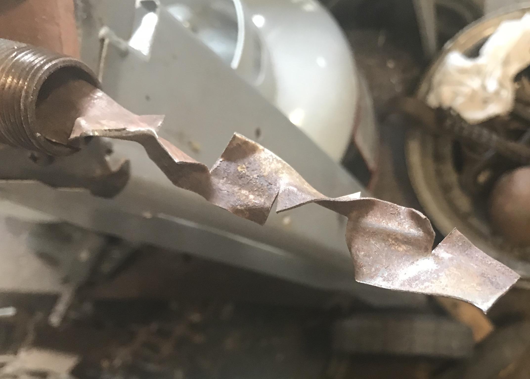

thematrixiam Posted April 16, 2019 Author Share Posted April 16, 2019 step 1. Grab some tools and materials. step 2ish..cut, fold, cut, connect, Flux and solder. Alternate as you go. Step 3:... wish you had a torch for better solders... I used a soldering iron. Still works, but torch would get it hotter. Save yourself $300. Quote Link to comment Share on other sites More sharing options...
Buzzkill Posted April 16, 2019 Share Posted April 16, 2019 If you have the time and inclination, I would be interested in the combination of performance/fuel efficiency with and without your device in place. If you end up with a hotter forge with less fuel burned it may be worth the effort. If the difference is negligible or non-existent then it's probably not worth the time and effort to create such a device. Quote Link to comment Share on other sites More sharing options...

Mikey98118 Posted April 16, 2019 Share Posted April 16, 2019 On 4/14/2019 at 9:17 PM, thematrixiam said: as for making these, what about cutting some steel part way through and then twisting? with a blown burner would it matter if these static mixers are super accurate? No; as an internal part in a sealed system that wouldn't matter at all. Low pressure oxy/natural torches used by the railroad used internal twisted ribbons to enusre sufficient mixing. Some very short body torches still do. thematrixiam is on to a good idea for s burner system, it should not be dismissed Quote Link to comment Share on other sites More sharing options...

Mikey98118 Posted April 22, 2019 Share Posted April 22, 2019 It seem likely that a twisted ribbon inside the mixing tube of a ribbon burner would end some performance problems in that system. If I were making a NARB, this OPPORTUNITY would not be wasted!!! Quote Link to comment Share on other sites More sharing options...

Frosty Posted April 22, 2019 Share Posted April 22, 2019 20 minutes ago, AdamTheSaint said: but I am somewhat concerned about pooling of propane in the tube. What would cause that to happen? We're talking a small diameter tube about 8x as long with a substantial volume of flow. How would anything pool in the tube? Are we using the same definition for "pool?" Packing the tube with steel wool doesn't work, tried that decades ago. In a gun burner maybe. Frosty The Lucky. Quote Link to comment Share on other sites More sharing options...

Frosty Posted April 22, 2019 Share Posted April 22, 2019 Suppressors and mixers are two different machines. Instead, try looking into how Lyle at All States designed the oxy prop mixing mechanism in his torch bodies. Harris manufactured them for All States till the patent ran out. Now Harris is marketing it's own oxy propane torch system. Until the patent ran out they were the only ones selling an efficient effective torch. They use a swirl strip in about a 5" long tube. And YES, propane likes mixing with oxygen LESS than it does with plain old Earth atmosphere. Frosty The Lucky. Quote Link to comment Share on other sites More sharing options...

JHCC Posted April 23, 2019 Share Posted April 23, 2019 Now I'm thinking about making a twisted ribbon to fit in the mixer tube of my NARB. Not sure how I'll be able to tell the difference, but I have to take it out of the forge to plug a couple of holes in the ribbon anyway. Quote Link to comment Share on other sites More sharing options...
Mikey98118 Posted April 23, 2019 Share Posted April 23, 2019 Good; it may not make a lot of difference, but I suspect it will make an important difference Quote Link to comment Share on other sites More sharing options...
Vincent Tai Posted April 23, 2019 Share Posted April 23, 2019 Glad to hear Mike and others think that the twisted strip will work in the NARB, I had been thinking it would create too much turbulence/air resistance for the air to be drawn in fast enough. Quote Link to comment Share on other sites More sharing options...
JHCC Posted April 23, 2019 Share Posted April 23, 2019 Well, I whipped up something quick out of thin-gauge sheet steel. It was not a success: the burner kept huffing, and I could smell unburnt propane. Pulled it back out again, and everything was fine. This is not to say that this is a bad idea. My try was very much a quick-and-dirty experiment, and your mileage may vary considerably. (N.B.: In the interests of “only change one variable at a time”, I had not yet plugged up that additional hole in the ribbon burner, so that is not a factor in the burner’s performance.) Quote Link to comment Share on other sites More sharing options...
