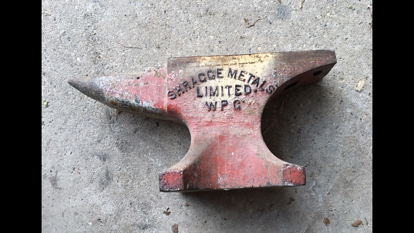

Ever heard of Shragge Metals anvil?
Can any one give me an idea about this anvil? Says it’s 125#
What should I offer for it???
Looks like a cast iron anvil. Do a rebound test before buying!
There is an old photo of a scrap metal company by that name in Canada. They may well have cast that anvil from scrap ... or not ... the factory looks like the Smunz string factory from the movie Mousehunt ... :)
If it "passes" the ball bearing test; offer 4+ times what you might if it fails that test.
Agreed, do a rebound test to see if it is cast iron or cast steel/hardened. If it is a good one, offer what you can comfortably afford.
I wouldn't offer more than $1.00 U.S. per pound, maybe settle for $1.50, if it passes the ring & rebound test. That being said , I have four anvils and don't particularly need it but haggling can be fun.

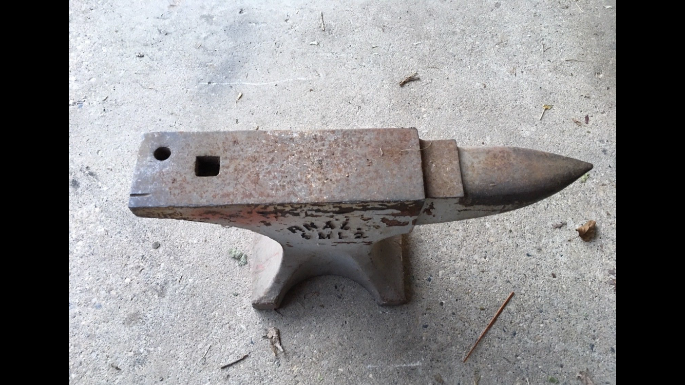

I was hoping I was seeing a line about an inch down that meant a steel top !!
Does less than 70% rebound automatically mean cast iron? I don’t feel confident I’ll know if it is...
He’s asking 500 CAD,  which is around 375 US.
A lot of cheap cast iron anvils are cast with that line precisely to deceive the unwary.
$3USD/lb for cast iron (if that is what it is, as seems likely) is pricey.
If you go there in person, bring a file and a ball bearing, or small ball peen hammer.
If the file skates on the face plate, but cuts into the body: joy. If both surfaces cut the same: door stop.
75% rebound with the hammer or bearing in a rust and paint free spot: anvil. Less than 75% rebound, or dents from the test: Anvil Shaped Object (ASO).

Although I tend to agree with the above, your typical Vulcan usually comes in at the 60-65% range and many people get good service from those.  Rather than strictly rejecting 60% to 75%, I'd say that's an area where price really comes into play--Pricing should reflect that it's barely passable.  I would however, cut off on anything in the 50's or below except toward scrap metal pricing--because a cheap hunk o' scrap will probably be just as serviceable and possibly more serviceable if you shop well.

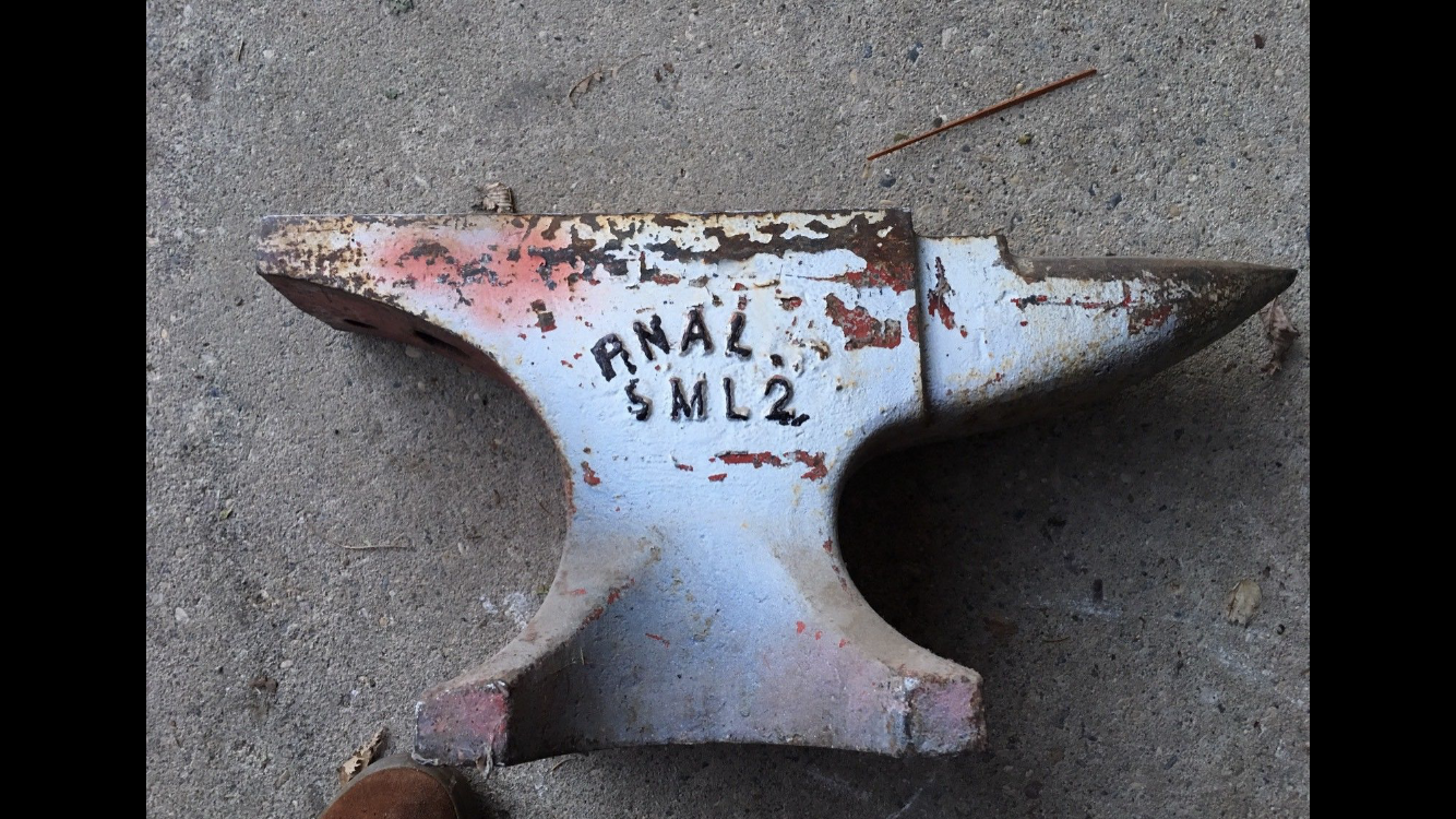

I was trying to figure out what 'Arnalloy sml' means. I have a 95 lb anvil from Shragge - in 1980 they became Orloff metals which us still around in Winnipeg.  It has beautiful ring and bounce- definitely not cast iron.
But does Arnalloy mean its made from a certain alloy or what?

But to answer the question. Yes.
