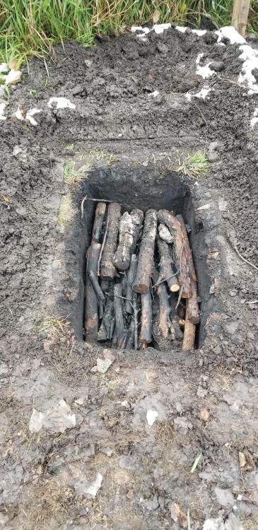

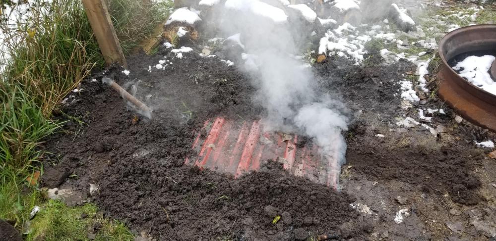

I found a paper from the United Nations that described charcoal making methods for developing countries.  One method they described was digging a hole, filling it with wood, let it burn for a while and then cover.

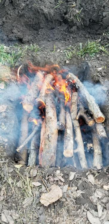

I dug a hole about 16" x 30" and about a foot deep.  I then went over to the big burn pile of tree limbs and cut enough wood to fill the hole.  Most of it was 1-2" diameter. I got a fire started and then placed all the wood in.  I didn't pack it super tight.  After everything was burning pretty good I put a piece of steel roofing over the hole and sealed the edges with dirt.

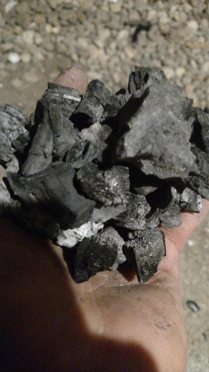

I let it sit overnight and opened it the next day.  It didn't work very well.  Most of the wood had not burned and converted to charcoal.  I was able to get about 3 gallons of charcoal out of it. Mostly from the lower area of the fire.  So...back to Google and more reading.  I found some articles on medieval charcoal making showing the pit method using vented pits.

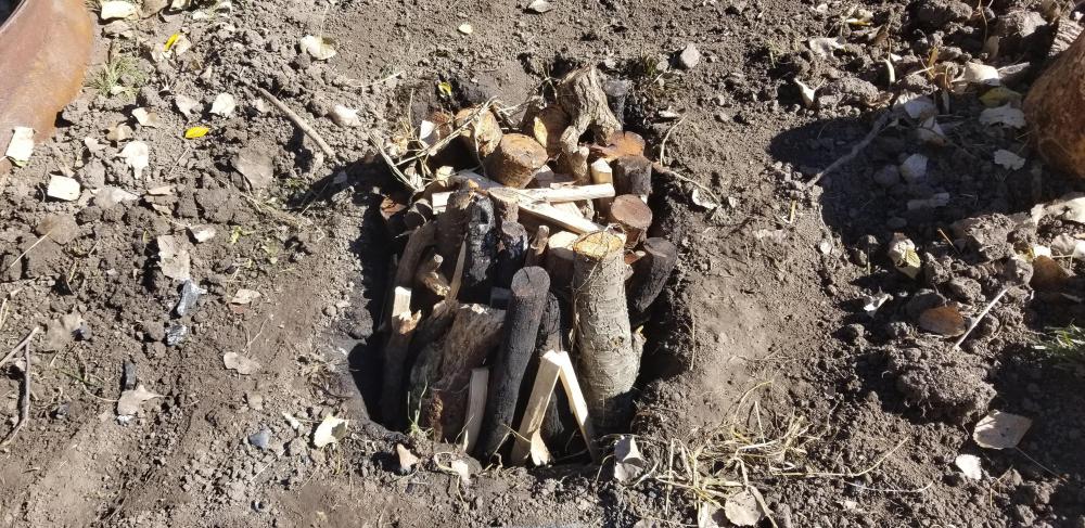

  I put a pipe in on one end of the pit for an air intake and dug a small trench on the other end.  Reloaded the pit with wood and got it fired up.  After it was blazing pretty good I covered it again and sealed it up, leaving the vents open.  It put out some heavy white smoke for a while.  After three hours the smoke volume was a lot less and was a lot lighter in color.  I pulled the pipe and sealed it up completely with dirt.  I figured it would be better to err on the side of under cooking.  If it's not completely done I can always fire it again.  I'm going to open it up after work tonight and see how successful I was.  If this works I have a big pile of tree limbs that will work great for charcoal making and if it doesn't work I'm not out any money.

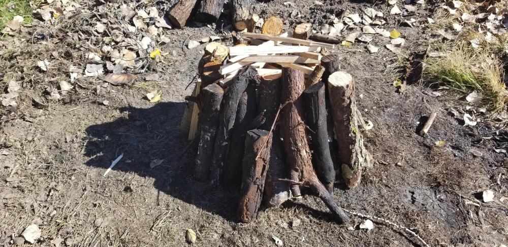

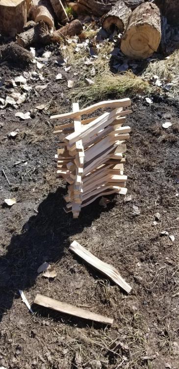

I started off by building the traditional three sided chimney.
The chimney was filled with kindling and the logs were stacked tightly around it.

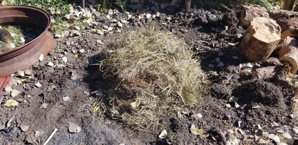

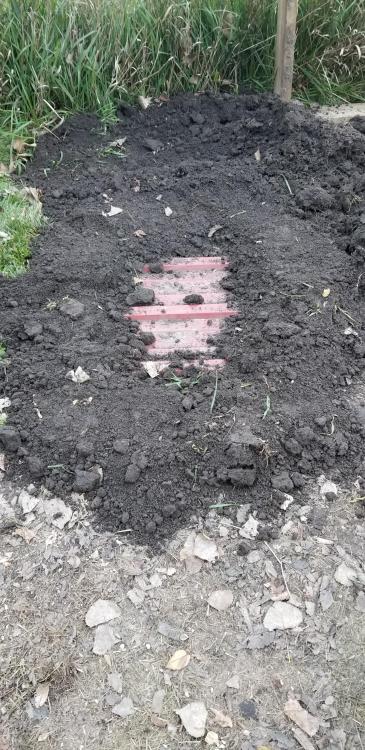

With my small scaled down version of a charcoal pit the sides were too vertical for the leaves or dirt to stick.  To build a pit with the correct shape and less sloped sides would of taken a ton more firewood and I didn't want to build that big of pit yet.  So I rebuilt the pit inside the hole that I had been using for my previous charcoal making experiments.  I packed the wood as tight as I could.  The chimney opening was covered with a piece of 1x10 prior to covering the mound.
It was quite windy and the leaves were blowing off the pile as fast as I could add them.  I've read that Colliers also used grass to cover their pits if it was available, so I used hay.

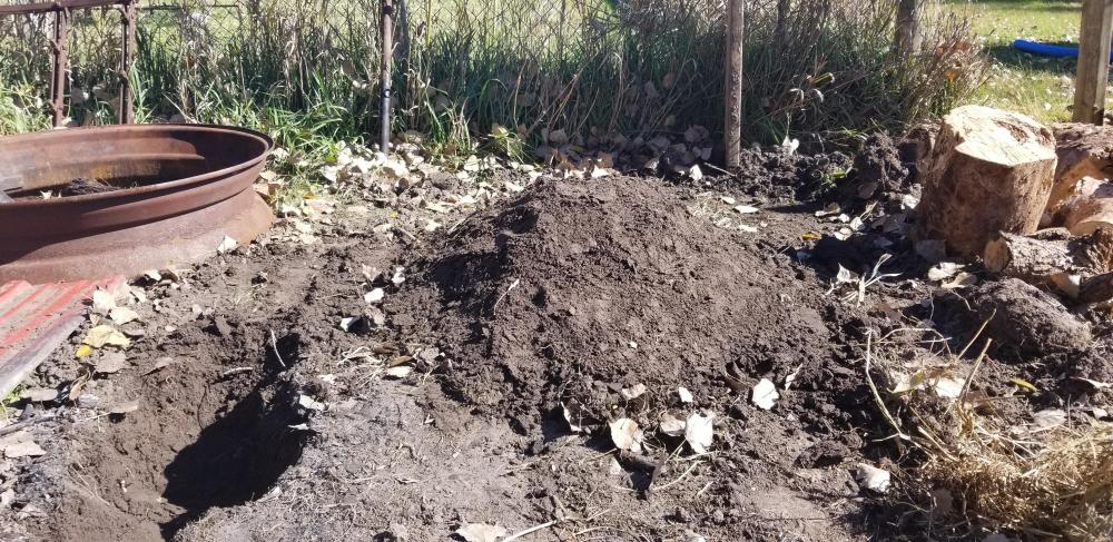

I then covered the pit with a couple of inches of dirt.
I removed the "brigen" chimney cap and dropped a shovel full of hot coals down the chimney to "fire the pit".  The pit was fired about noon on Friday.
Covering the pit was traditionally called "leafing and dusting".  The dirt that I used was dug from the ground and had some moisture in it.  After packing it down I think it sealed too tightly and didn't allow the pit to breathe as much as dust would of.  I ended up having vent holes opened in the pit during the entire burn.
The pit never put out a ton of smoke, it was just slow lazy wisps of smoke from the vent holes.  The pit burned overnight with no holes opening up in the cover.
After burning for about 24 hours I "jumped the pit"  and walked over it tamping it down with my feet.  One section sank about six inches suddenly when I stepped on it.  I can't imagine how dangerous and nerve racking that must of been for the Colliers jumping their 15 foot tall pits.  One wrong step and they would of fallen into the fire.
The pit continued doing it's thing smoking all weekend.  Unfortunately I have a job and had to work on Monday, and I didn't want to leave it burning unattended while I was gone at work. So Sunday afternoon I sealed up the vents and let it cool down a few hours before I opened it up.
I was hoping for buckets full of wonderful charcoal.  Turned out that only about 40% of the wood had converted to charcoal.  I'm guessing this pit would of needed to burn for about a week.  While I didn't get a ton of charcoal out of the deal I still think it was successful.  I learned a lot about the history of charcoal making and had the kids involved in the process too.  Probably not many other 8 and 6 year old kids that know what a collier is, much less can say that they helped with  a traditional style charcoal pit. :D
