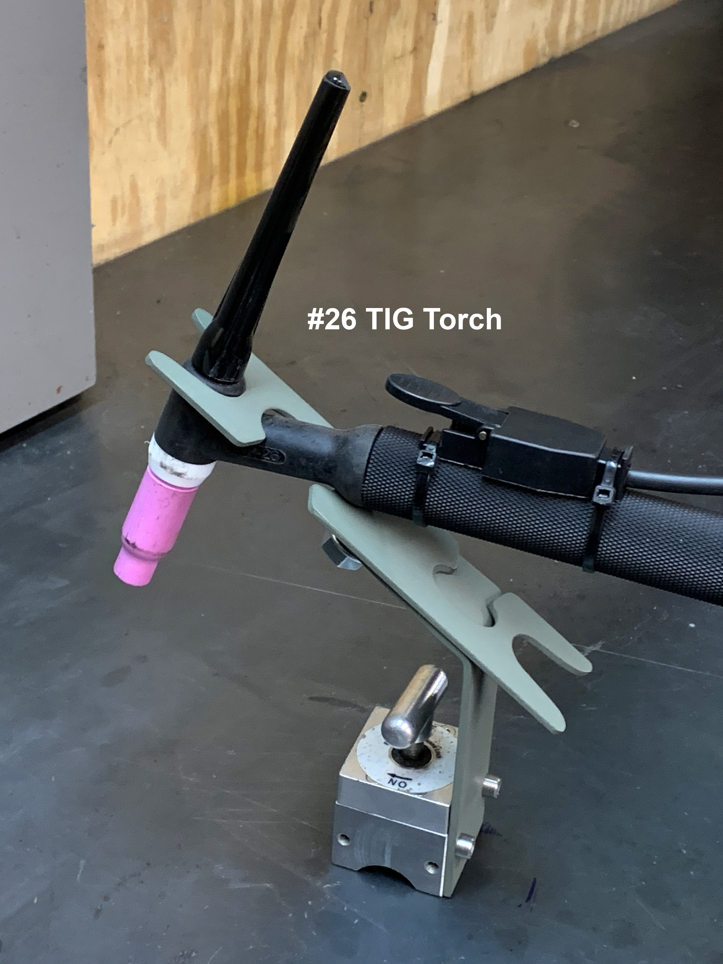

I've been incredibly busy this past year and haven't done much in the way of blacksmithing, but I have done a few welding projects. Here's a little gadget I just finished up to make my TIG welding a bit more convenient. I borrowed a few ideas from torch holders I’ve seen online. My variation on the ones I’ve seen was to make two sets of cutouts, one for a larger TIG torch and one for a smaller TIG torch, which could be rotated to select the size. I don’t think that’s a new idea, as there are almost certainly people who are smarter, faster, and better looking than I am who thought of it first, but here it is. Two opposed pairs of Belleville disc springs provide adjustable clamping force to maintain the selected position with enough resistance to keep it from rotating when in use, but still allow it to be rotated by hand. The multiple Belleville disc springs provide a wider, less-sensitive adjustment range than a single Belleville spring. The switchable magnet makes it easy to reposition, and it can drop any beard of ferrous debris that it might grow. The magnet can also serve double-duty as a setup magnet. As with other magnetic bases, it’s much more strongly attracted to a thick steel bench top than a thin one. If the steel top is too thin, the magnet might not hold adequately. My usual disclaimer: I do not guarantee the safety, efficacy, or applicability of the devices, designs, or ideas I have described here. Any use of these devices, designs, or ideas is entirely at your own risk.

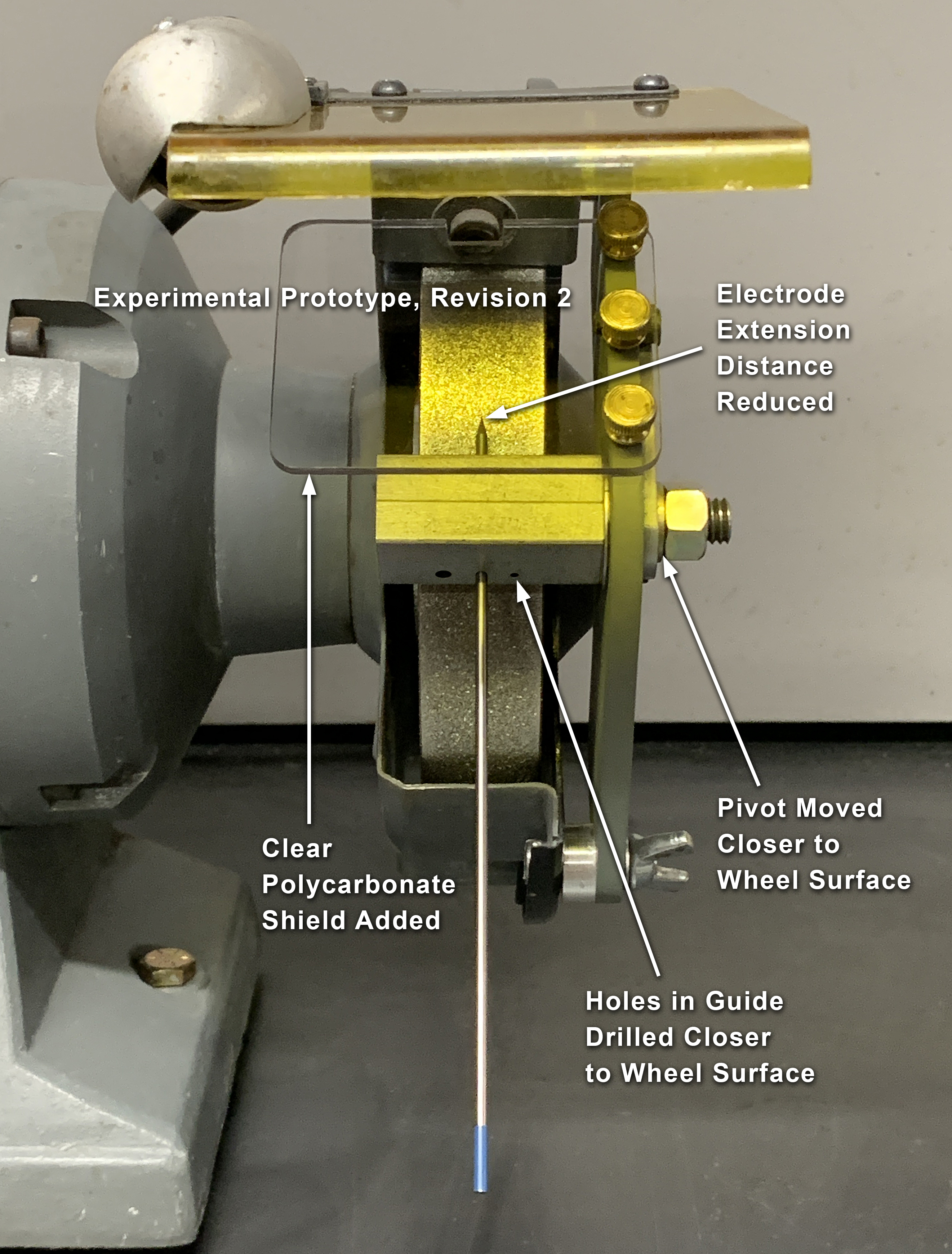

Updated material to "Experimental Jig for Sharpening Tungsten Electrodes” Revision 2. In this revision I moved the electrode guide pivot closer to the wheel and also drilled the guide holes closer to the wheel. These changes place the electrode closer to the wheel surface and reduce the distance that the electrode extends past the electrode guide (as shown below). One person contacted me with a similar suggestion. I think these changes could make grinding results more consistent. I do not know what effect these changes might have on the possibility of kickback or breakage. I haven't experienced any problems yet, but I haven't ground very many electrodes with the different versions of this device, and there is always a chance of electrode breakage or kickback. I would have to do a lot more testing before I would feel confident about the device's safety and effectiveness. I also installed a clear polycarbonate shield over the electrode grinding area (as shown below). I thought this might offer some additional protection in the event of damage occurring to the electrode. I attached the shield with thumbscrews for easy removal for cleaning or replacement. Even when using the bench grinder's original polycarbonate shield along with the new shield that I installed, I still wear eye protection when grinding electrodes (or anything else for that matter), as well as keeping myself clear of the end of the electrode when feeding it into the grinder. As stated before, this is an experimental prototype and a work in progress, so I do NOT recommend copying this design. More changes will probably be upcoming, if or when time permits me to do further experimenting and testing. Feel free to PM me or leave a comment. Disclaimer: The device described here is an experimental, prototype device. I do not warrant the safety, efficacy, or applicability of the device described here. Any use of this design or device is entirely at your own risk. Use all appropriate personal protective gear when using this or other tools. This post is not intended to be instructions for grinding tungsten electrodes. It is only a description of an experimental prototype device in its early development stages. Disclaimer: The device described here is an experimental, prototype device. I do not warrant the safety, efficacy, or applicability of the device described here. Any use of this design or device is entirely at your own risk. Use all appropriate personal protective gear when using this or other tools. Thanks for reading, and please check back for further updates. Please PM me if you have any questions or comments you'd like to discuss offline. Al (Steamboat)

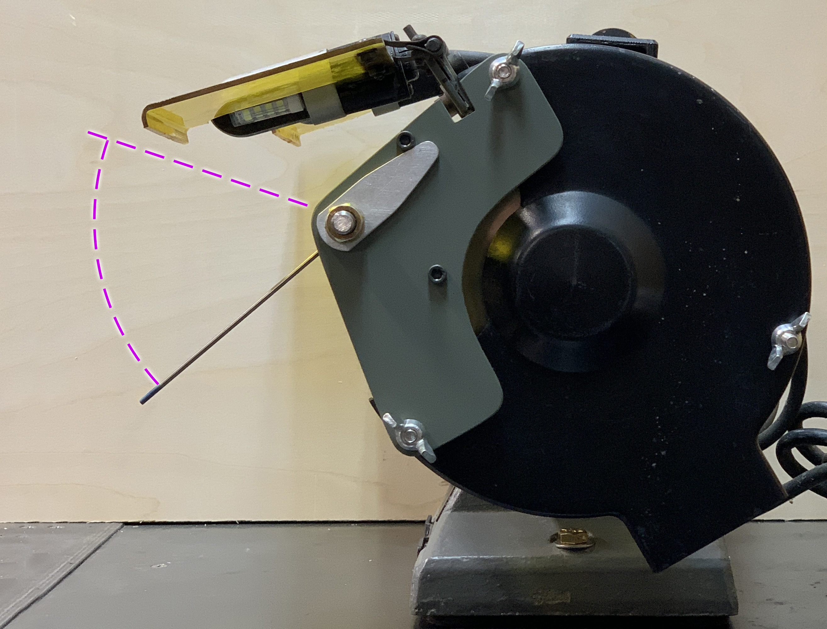

“Updated material to Experimental Jig for Sharpening Tungsten Electrodes” Revision 1. I have made some changes to the original version of this device. As mentioned, this is an experimental prototype device. It is a work in progress and not in its final form, so at this point, I do not recommend building a copy of it. As I experiment with it and discover new problems or shortcomings, I will try to improve the device with safety, efficiency, and ease-of-use in mind. Please note that I am not a professional in any of the fields related to developing this device, and I am open to suggestions to improve my design. In this revision, I made the following changes: I replaced the knob used for tightening/locking the position of the electrode guide with a hex-head bolt that can be securely tightened with a wrench. Rationale: This will allow the electrode guide to be locked more tightly and securely in position and make it less likely to move while in use. I connected an arm to the electrode guide and added stops to limit the angular range of the electrode guide to PREVENT electrodes from being pointed downward in the direction of wheel rotation. This device is designed for grinding electrodes in the general orientation that I depicted in the photo in the original post and also below (i.e., against the rotation of the wheel). Rationale: Because this device employs an ELECTRODE GUIDE, if one were to grind an electrode with the tip pointing downward in the same direction of the wheel’s rotation, the wheel could “grab” the electrode and pull it down through the electrode guide, which could jam the electrode against the wheel, destroy the electrode, and possibly even send pieces of the electrode flying through the air, which could be dangerous. This modification is intended to prevent that situation. The electrode angle relative to the wheel is limited to the range shown in the photos below. This setup prevents the electrode from being pointed downward beyond the point where it is perpendicular to the surface of the wheel. In other words, it prevents the electrode from being pointed in the direction of wheel rotation. FYI, here is an informational (not sales) link to a Miller Welding document available at the time of this post, which includes some basic information on electrode preparation and grinding (see the bottom of page 8): https://www.millerwelds.com/-/media/miller-electric/files/pdf/resources/gtawbook.pdf Warning: It is very important to try to avoid kickback when grinding electrodes. Before grinding an electrode, I make sure the diamond wheel is running true and that the surface is smooth and free of any irregularities that might increase the chance of kickback. I feed the electrode through the electrode guide into the wheel carefully, rotating it against the wheel with light pressure, while keeping myself clear of the opposite end of the electrode. While I have not "yet" experienced any kickback when using this prototype device, to be on the safe side, one should always assume that it is a possibility, and of course one should always wear eye protection and view the grinding process through the safety shield on the bench grinder. I have only tried this device with a diamond wheel. I do not have any plans at this time to try it with other types of abrasive wheels, such as aluminum oxide, silicon carbide, etc., as there are too many variables to deal with, and I don't believe that other abrasive wheels would last as long as diamond wheels for grinding tungsten electrodes. Possible upcoming changes in future revisions: I might modify the shape of the electrode guide and install it even closer to the grinding wheel. I think that this might add more stability to the electrode during grinding, since less of the electrode would be protruding from the guide. I don't know if it would have any effect on reducing the chance of kickback. A scale could be etched on the mounting plate, and the arm could be used as a pointer to indicate favorite grinding angles, which could save adjustment time. Again, this prototype device is a work in progress and not in its final form. There may still be bugs to work out. I expect to be making a number of further changes and fixing issues as they come up. I am sharing the development process on the IFI forum because I am not a professional in any of the applicable technical areas, and I would like to get comments from forum members that could help me improve this device. Disclaimer: The device described here is an experimental, prototype device. I do not warrant the safety, efficacy, or applicability of the device described here. Any use of this design or device is entirely at your own risk. Use all appropriate personal protective gear when using this or other tools. This post is not intended to instruct the reader in how to grind tungsten electrodes. It is only the description of an experimental prototype device in its early development stages. Thanks for reading, and please check back for further updates. You are welcome to PM me if you have any questions or comments you'd like to discuss offline. Al (Steamboat)
