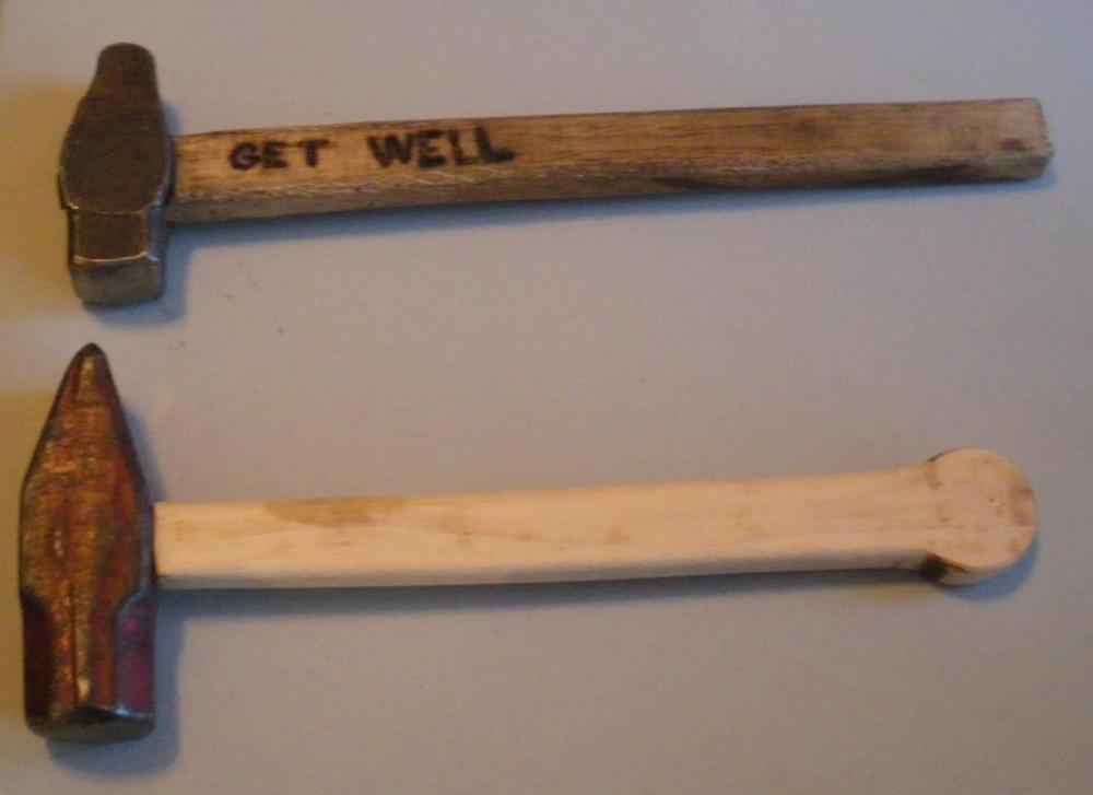

I make my hammer handles from 5/4" straight grain, clear, hickory I bought from a cabinet, hardwood supply. I taper them slightly from the head to the end of the handle with a little knob end that became an unnecessary tradition of mine. I prefer a slab handle as it's easy to grip lightly but securely and indexes effortlessly so you never have to try to keep the hammer face level side to side. A slab handle can't roll in your hand without being almost painfully obvious. The slight taper really isn't noticeable as such but if the handle slips at all your grip tightens reflexively.
I don't care for much flex in my hammer handles. Farriers seem to like whippy handles and have good reasons.
Below is a pic of two of my  hammers. The "Get Well" cross pein hammer was made for me by a good friend after my accident. Mark, AKA Metalmangler on Iforge is a farrier made this is a less whippy hammer handle, he knows I'm not a whippy hammer guy. The one below is a 2.5 lb. $0.50 yard sale cross pein hammer head on one of my tapered slab handles.

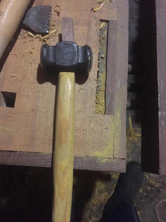

I’m fond of Osage Orange myself for mid to heavy duty handles.  Ash and hickory would follow close behind.  My go to wood working mallet I made from a green cut ash tree chunk with lots of knots (the more the better for mallets).  15 years later with lots of abuse it hasn’t even so much as started a crack.  Find something local to you and use it - it’s probably exotic to lots of other people in the world!
Below low is an Osage Orange handle on a fine rounding hammer made by Littleblacksmith.

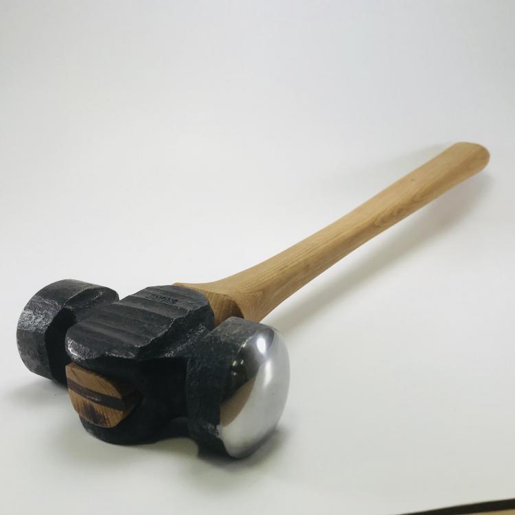

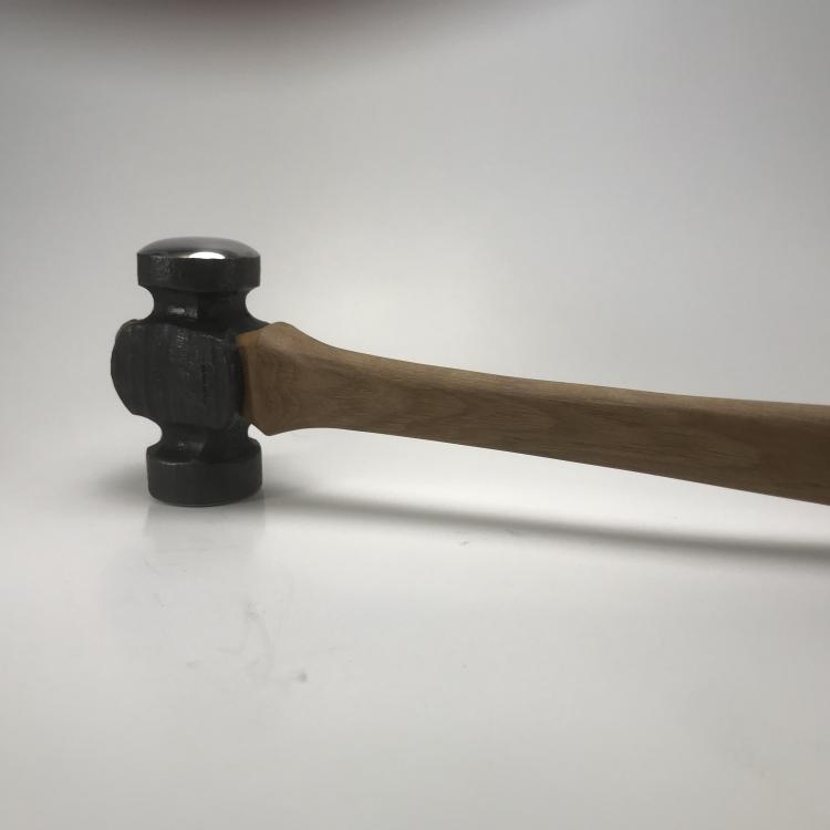

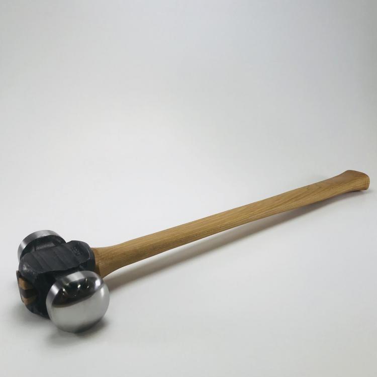

I think we’ve all been where you are in trying to find a way to improve the hammer handle, some of us quite recently. Hickory has been used forever for a reason. Strength, flexibility, grain and price.
I prefer a handle with similar characteristics to Frosty’s but thinner and whippier. For a recent platers rounding hammer for a race track farrier, the handle was thin indeed. If your familiar with farrier hammer brands, my handles are sort of a cross between those made by Bruce Wilcox and Steven Beane
Here’s a few recent ones.
