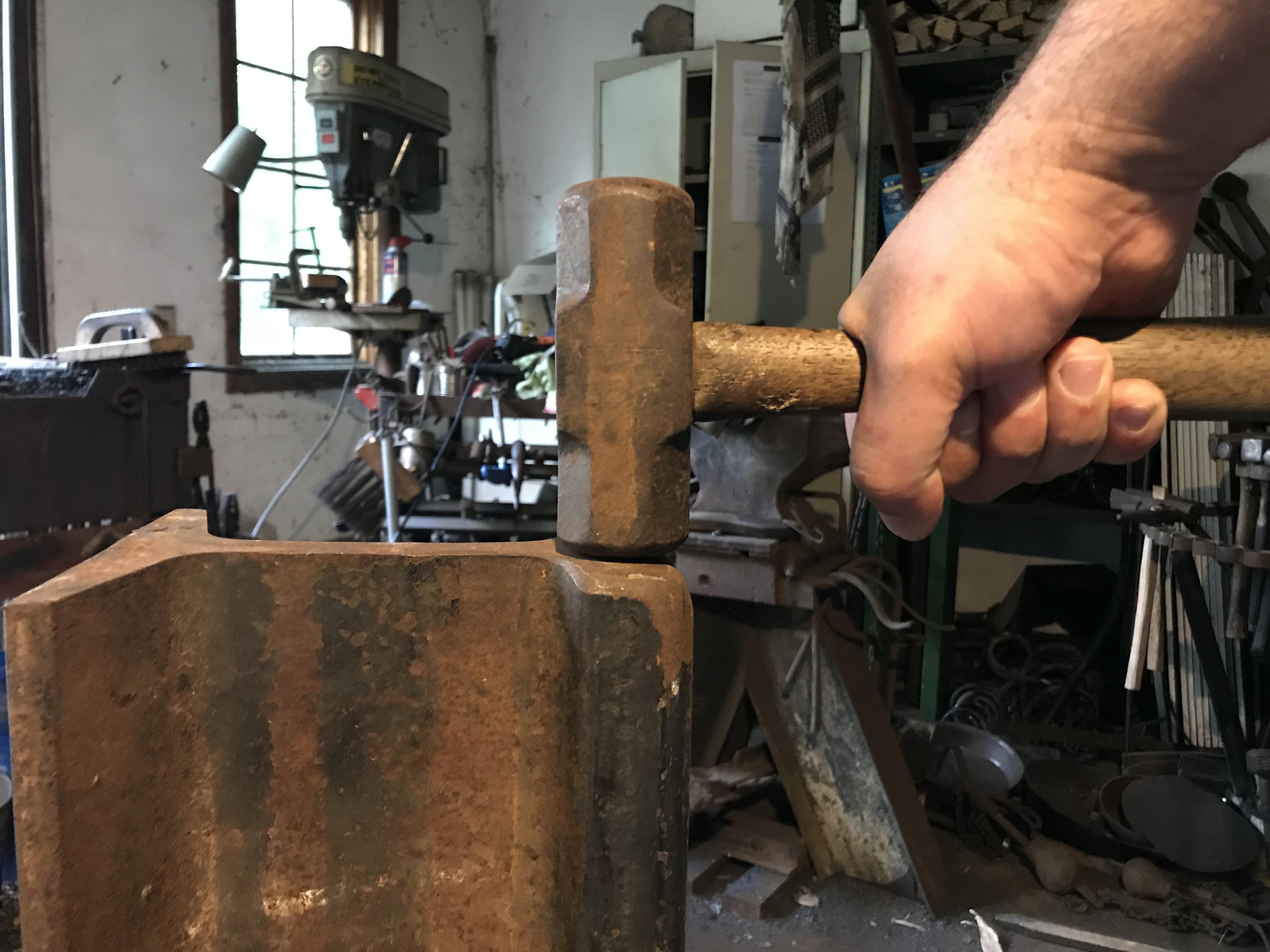

Marc1 Posted August 10, 2018 Share Posted August 10, 2018 On 8/9/2018 at 11:59 PM, JHCC said: What's the risk? Unless your hand is somehow below the face of the anvil, your knuckles never come near the top of the rail while you're hammering. What's risky is hammering on the face of the anvil when you've left a hot-cut or other tool in the hardy hole, because that sticks up above the work face, putting your fingers at risk. Sure. Picture a beginner forging on a vertical RR track standing on the back of it and missing the minuscule working surface, holding the hammer 6" from the head and not 12". (Most of my hammers don't even have a 12" long handle) Unless you cut away the web and the base diagonally or in a J cut that vertical RR is an accident waiting to happen ... not to mention that unless you forge confetti size stuff, it would be a frustrating exercise comparing to any anvil, made in China or in Bulgaria. As for the supporters of "horizontal RR is better than vertical" ... better for what is the question. Surely you can see that hammering on an RR on end will sound and feel a lot more solid for good reasons. A horizontal RR will appear to be more practical with a larger surface. Providing you can restrain from cutting a pretend horn or heel in it, and providing you want to forge small stuff and have no neighbours, a horizontal RR may serve you for some limited purposes. Yet comparing horizontal with vertical and only comparing which one is more solid, vertical wins hands down. On that line, I visited a scrap metal yard not too long ago that had a pile 2m high of crane rail. This stuff was massive and would make the railroad lovers salivate. Definitely good improvised anvil material. To the OP I stand by what I said. Use your Chinese anvil until you smash it out of shape. Then and only then decide your next move. In fact probably way before your Chinese anvil looks like a donut, a better anvil will find its way in your workshop. Quote Link to comment Share on other sites More sharing options...

JHCC Posted August 11, 2018 Share Posted August 11, 2018 47 minutes ago, Marc1 said: Picture a beginner forging on a vertical RR track standing on the back of it I can picture that scenario, but it seems much more likely that a beginner would address a track anvil from the side with the running surface: Quote Link to comment Share on other sites More sharing options...
anvil Posted August 11, 2018 Share Posted August 11, 2018 23 hours ago, JHCC said: rigidity I did read that,, however, when properly mounted to a stump or stand rigidity can no longer can be an issue. 17 hours ago, JHCC said: 18 hours ago, Marc1 said: Picture a beginner forging on a vertical RR track standing on the back of it I can picture that scenario, Referring to this pic and your comment about a beginner. How would you keep from dinging your iron on the two edges? Even with good hammer control, seems that would be a real problem with such a small surface to forge on. I can't even see where you have enough surface area to forge a leaf keychain without dinging it up. Again, I'm not argueing. And my "intro" to this configuration is due to the web these last few years. This is my first look at its possibilities. Thanks for the info. Its not for me. Quote Link to comment Share on other sites More sharing options...

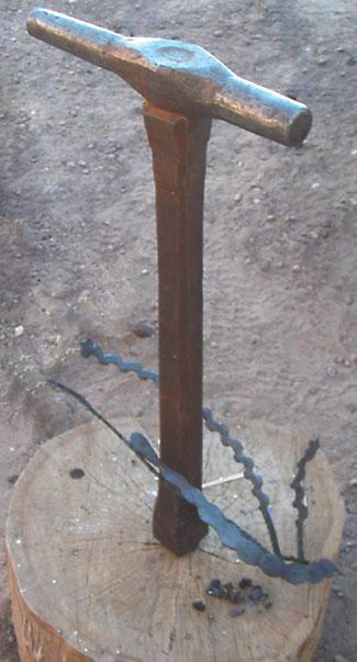

ThomasPowers Posted August 12, 2018 Share Posted August 12, 2018 And yet in the early medieval period they used to forge swords on what we would consider tiny anvils nowadays. There is that video of a smith forging kukris using a sledge hammer head as his anvil---better go tell him that's not possible cause he's been making a living doing it for a long time! Perhaps for what *you* do you must have a larger faced anvil. I however could easily see scrolling the hard way on the roman anvil at bath. I've owned an ASO and found forging on a much smaller chunk of real steel to be much superior! Especially when forging coil springs where most of the energy of a hammer strike went into denting the cast iron and not deforming the work piece. Quote Link to comment Share on other sites More sharing options...
