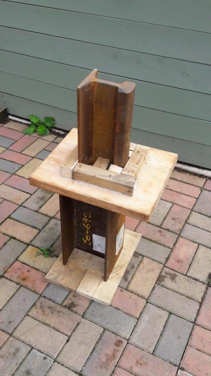

Chuyn Posted August 9, 2018 Author Share Posted August 9, 2018 I got my hands on a 15inch piece of railroad track. I seen tons of picture of both horizontal and vertical position. Is this just a preferences? What do you guys recommend. Now that I got something acceptable to forge on is there a material you guys recommend? I thought of getting just some 2x12 and making a square stand and placing the railroad track in the center and having it a few inches above the wood. Maybe placing a a few inches of a solid block of wood under all the 2 ×12 and the track to help reach with a proper height. I seen a few anvil with 2x12 but I'm not sure if just having a bit of wood under the rail and covering the sides with 2x12 would be efficient or a waste of wood. Thanks for the help guys! Quote Link to comment Share on other sites More sharing options...
Charles R. Stevens Posted August 9, 2018 Share Posted August 9, 2018 I recommend vertical. In the horizontal the 7/8” web flexes minutely and absorbed some of the energy intended to move steel. As to the stand I would go with somthing “L” shaped to that the flange side is braced and the end is supported but on has acces to the rest of the rail for forging Further with the L shape stand a stake plate can be fabricated for top tools and fitted to the top of the L. Quote Link to comment Share on other sites More sharing options...

Chuyn Posted August 9, 2018 Author Share Posted August 9, 2018 Thank you so much! By having a plate underneath the rail does that have an advantage to it? Also the plate on the top part of the L. Is that for cosmetic? I found a place in town where they sell similar plates like that. Is there a certain material that is better to get? Quote Link to comment Share on other sites More sharing options...
Charles R. Stevens Posted August 9, 2018 Share Posted August 9, 2018 If you get crazy with a very heavy hammer the steel plate under the anvil will help, other wise it should be fine. As to the top plate, creating a square hole in one makes a holder for top tools and gives you more versatility. Quote Link to comment Share on other sites More sharing options...
Zeroclick Posted August 9, 2018 Share Posted August 9, 2018 You could try this design it is quick and simple and works well as an anvil. The main factor is making sure the railway track lines up with the shape of the I beam. Regards, Luke Quote Link to comment Share on other sites More sharing options...
Marc1 Posted August 9, 2018 Share Posted August 9, 2018 I would rather use a mediocre anvil than risk my knuckles on that vertical rail. A low quality anvil will get dings from your missed blows and sink in the centre of the face where you work the most. So what? You paid ... how much? $15? Use your anvil on a sturdy stand to your heart content. In one year time take a picture and post the "before and after" for a laugh. It will be the measure of your activity. Once it is a squashed banana, look for a better one and hang that one as a trophy on the wall. What matters is what you make and how you make it. The anvil is just a place to do your hammering. Quote Link to comment Share on other sites More sharing options...
JHCC Posted August 9, 2018 Share Posted August 9, 2018 What's the risk? Unless your hand is somehow below the face of the anvil, your knuckles never come near the top of the rail while you're hammering. What's risky is hammering on the face of the anvil when you've left a hot-cut or other tool in the hardy hole, because that sticks up above the work face, putting your fingers at risk. Quote Link to comment Share on other sites More sharing options...

ThomasPowers Posted August 9, 2018 Share Posted August 9, 2018 One of the advantages of the vertical rail is that there isn't enough face to allow you to work on the face with your hammer hand over any tooling... Dozers, graders, front end loaders often have wear plates that have sq holes in them that make for an easy adjunct hardy hole. Quote Link to comment Share on other sites More sharing options...
Charles R. Stevens Posted August 9, 2018 Share Posted August 9, 2018 As my hand is about a foot from the hammer head and the head is atleast and inch wider than the handle I don’t see, nor have I had an issue with my fingers coming in contact with anything I have used for an anvil, to include a heavily modified rail anvil mounted vertically. as to placing the rail on top of the I-beam, with 15” of rail you will have to cut the rail down to 15” or less. If you don’t have the cutting and welding tools for that wood is easer to work with. Quote Link to comment Share on other sites More sharing options...
