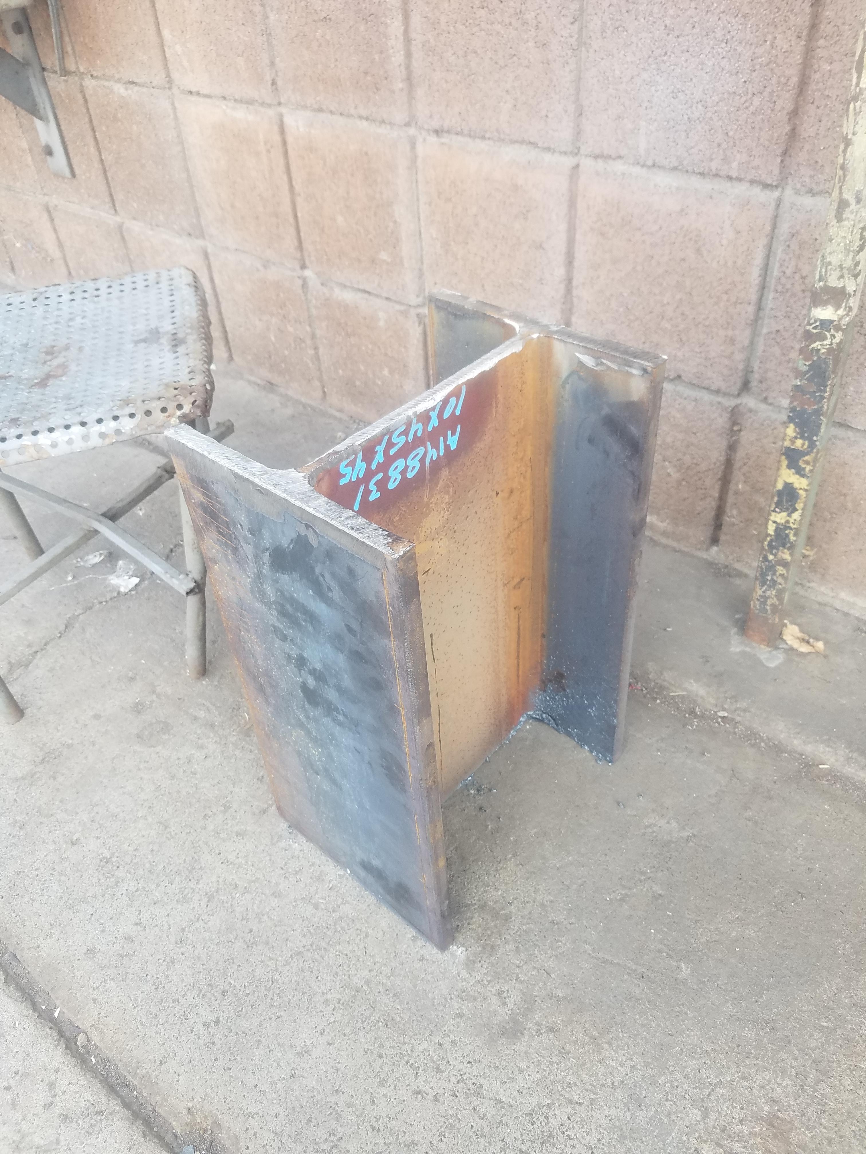

So I recently have gone to 5 scrap metal places in town and only two of the 5 I can buy metal. Unfortunately I wasn't able to find anything close to "block of steel" but I was able to find a good piece of metal to forge on while looking for something better. I'm gonna try and go to car junkyard and see if there's anything there. If not, I'll just keep checking the other two places and hopefully something comes in.
It's about 6lb, 1in by 5inch in diameter

S I got 1inch ball bearing from Amazon and I tested both my anvil and the piece of metal and they both go less than 3 inches in the rebound test.
I'm currently working on getting a piece of railroad track. Hopefully my buddy is able to get it.
From what height?
From 3-1/3” is 90%, which is great. From 10” is 30%, which isn’t.
5 minutes ago, JHCC said:
From what height?
From 10", sorry
And the ball is hardened?   If so it sounds like the metal is annealed!
If the markings are coming from dents you made in the anvil face then there is an issue.  If the marks are from the hammer then not.
Rebound won’t have much effect on finish. What will are irregularities in the anvil and hammer faces (which will transfer to the workpiece) and hammer control.

I found a place in town where they would sell me a piece of 865 metal beam for about $50. Do you guys know if that's good material to use?
