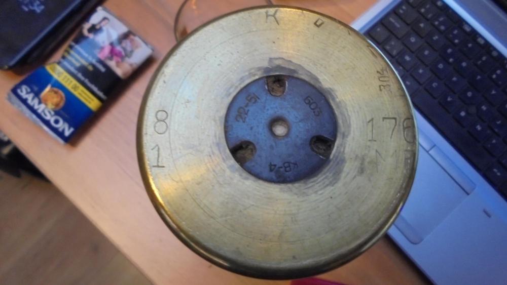

Regarding the firing cap, I need to do some research on the anatomy of these shells.  My pal did send a pic of the bottom.  I thought I would research taking the cross-type thing out and cleaning it to make sure there was no residue.

Good day friends, I have a grenade shell here that I have inherited from my grandfather, this one is engraved and has served as a flower vase. It is a Russian grenade shell  (I do not know which caliber) and faded in the WW II. All this, to give Chris an impression what he can expect on the inside (nothing, except the channel of the weft pin)
Also I have a spicy offer of a whopper from the WW I excavated in the Flemish fields. If you are touched by one his missing chips from this boy? I do not know :( - incredibly that once the brass ignition mechanism is polished, you can still recognize the grading of ignition and name of the producer (Krupp) after 100 years.The airtight containment of the Flemish clay has benefited her work well.
As for the coating inside, I will go for a food approved layer of silicone. I hope that I could be a little helpful.
