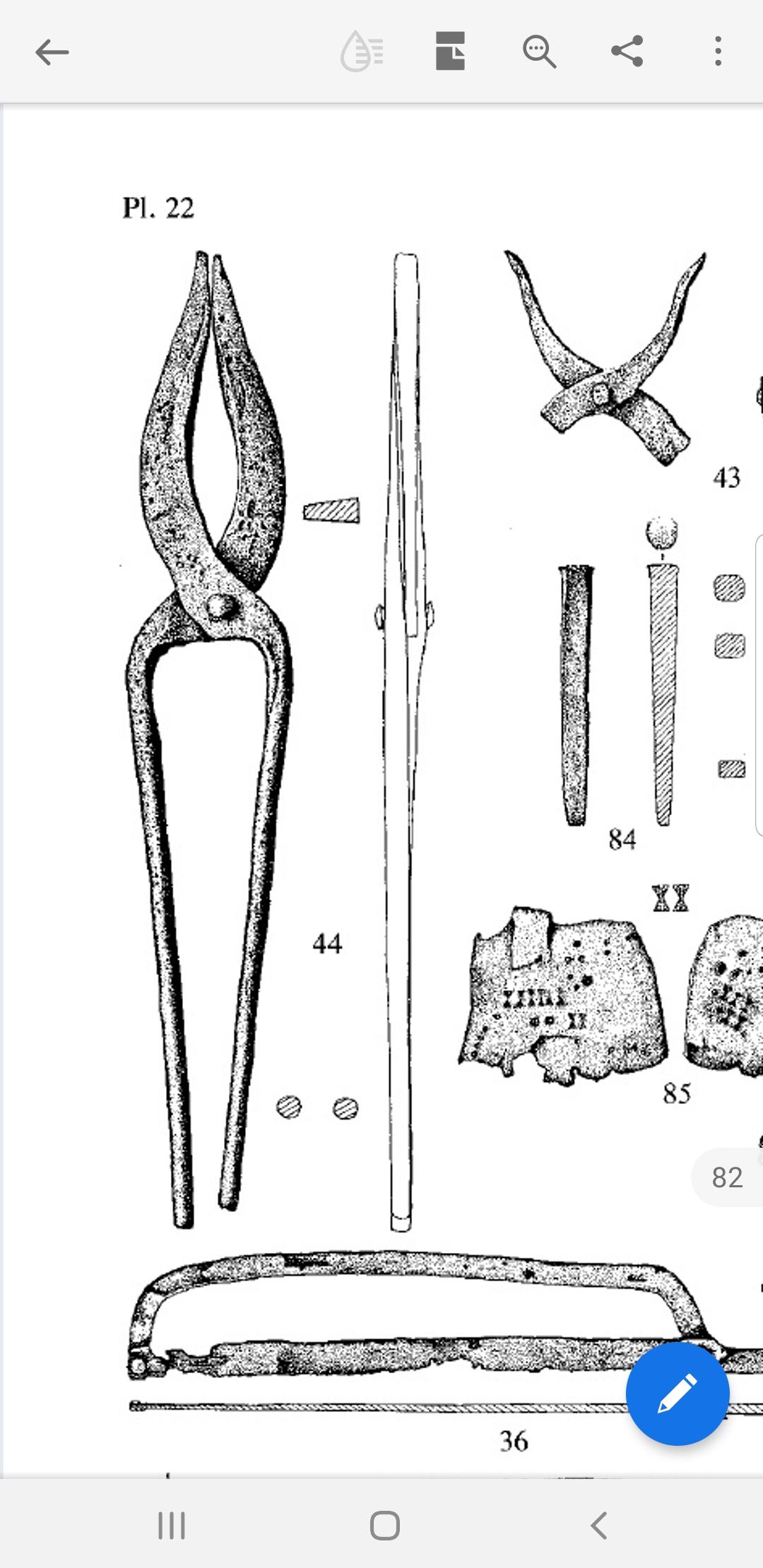

Jon Kerr Posted January 4, 2020 Author Share Posted January 4, 2020 TP- im about to buy a welder so a tool holder like you described might be possible soon.... thanks. Also yes I was careful that the dice opposites added to 7. My gamer mates would never forgive me for a mistake like that.... id never hear the end of it. That said.... one of my gamer friends is very lucky, and the another very unlucky. I might make their bottle openers to be all 5s and 6s, or all 1s and 2s, for a bit of a joke. Today was a HUGE success. I wanted to have a go at a set of viking style tongs, similar to those found at Mastermyr. I also wanted to try shorter handles than my other tongs to see how that feels. Im incredibly happy with these. Easily the best thing Ive forged so far. Took me around 4hrs although that inluded making my first rivet and making a nail/rivet header. (Note- they look enourmous in the photo- they were still to hot to put in my hand for scale. They're not that big because the reins are fairly short, but theyre nice and chunky. Reins are approx 8-10mm square for scale). Quote Link to comment Share on other sites More sharing options...
Irondragon Forge ClayWorks Posted January 4, 2020 Share Posted January 4, 2020 Great looking Viking tongs, I love mine for blade work. Quote Link to comment Share on other sites More sharing options...

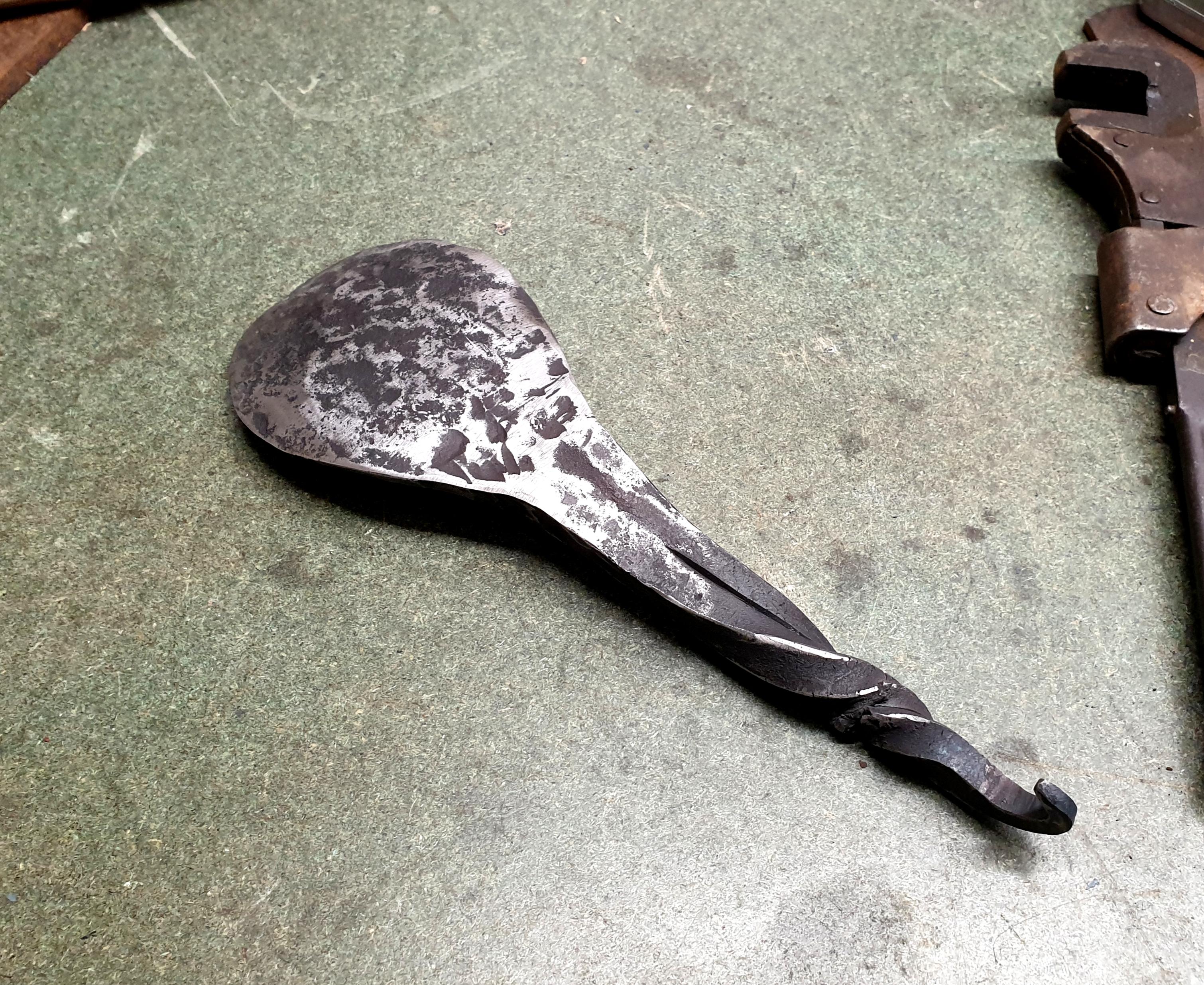

Jon Kerr Posted January 11, 2020 Author Share Posted January 11, 2020 A friend of mine wanted to see my forge in action, as he hasnt visited since the forge was "a box of soil in the garden" (his words!). .... well I wasnt just going to let him watch so he got handed the sledgehammer. He did a fantastic, tireless job and we succeeded in making a new coke spoon for managing my fire. Unfortunately, I burned the steel on the handle while we were chatting, and then tried to twist it with a tapered handle. Both these errors resulted in a crack in the twist which ruined the handle. The handle is also shorter than I'd have liked, anyway. Im planning to cut it off at the damaged section, then do some more work to untwist, reforge square and draw out much long and thinner, then recreate the twist and hook. Quote Link to comment Share on other sites More sharing options...
ThomasPowers Posted January 13, 2020 Share Posted January 13, 2020 Pudding spoon? Quote Link to comment Share on other sites More sharing options...
Daswulf Posted January 13, 2020 Share Posted January 13, 2020 Tough on the spoon. Well, if you do get a welder you could weld a new handle on, or fire weld one on if you're feeling lucky. I always warn people visiting my forge and more so that take up a hammer to pound something out that it only takes seconds of not paying attention to ruin hours of work. I have to remind myself that as well, sometimes the hard way. Quote Link to comment Share on other sites More sharing options...

Jon Kerr Posted January 14, 2020 Author Share Posted January 14, 2020 My blower has a foot pedal, but I'm finding with coke I need it on all the time so I've basically rested a hammer head on the pedal so it's always on. I control the air flow with the valve on the Iron Dwarf forge. (my blower is noisy as hell though unfortunately!) I'm learning about burning stuff the hard way. I was excited to have my friend in the shop, and I got caught out once we'd drawn the steel down to a smaller size and the heating times went down accordingly. The handle is too big anyway. For now, its structurally sound and I can use it as-is (its better than the rubber handled garden trowel that I was using before!). There's enough material to cut off at the burn and draw out much longer. Quote Link to comment Share on other sites More sharing options...
Jon Kerr Posted January 18, 2020 Author Share Posted January 18, 2020 Spoon fixed. Confession: there are, or course, massive cold shuts running the entire length thanks to the chisel line from before..... but its hardly going to effect the functionality of a spoon handle. I need some help and advice on another project, please... I'm trying to make a cross for my wife's grandfather who recently passed away. Its a temporary grave marker for the 9 months till the ground settles and headstone can be placed. He was a carpenter, so I wanted to do a nice job, hopefully something he would not be ashamed to have on his grave. He was also a proud Irishman, so I figured a celtic cross with a ring would be nice, and I could forge the pieces of the ring. I'm happy with them so far, but I'm worried they do not form a perfect circle. While working I was matching them to a chalked line to try and get the correct curvature but they're not perfect. Any tips for getting the curves perfect? Or do you think they look good enough as is? Quote Link to comment Share on other sites More sharing options...
