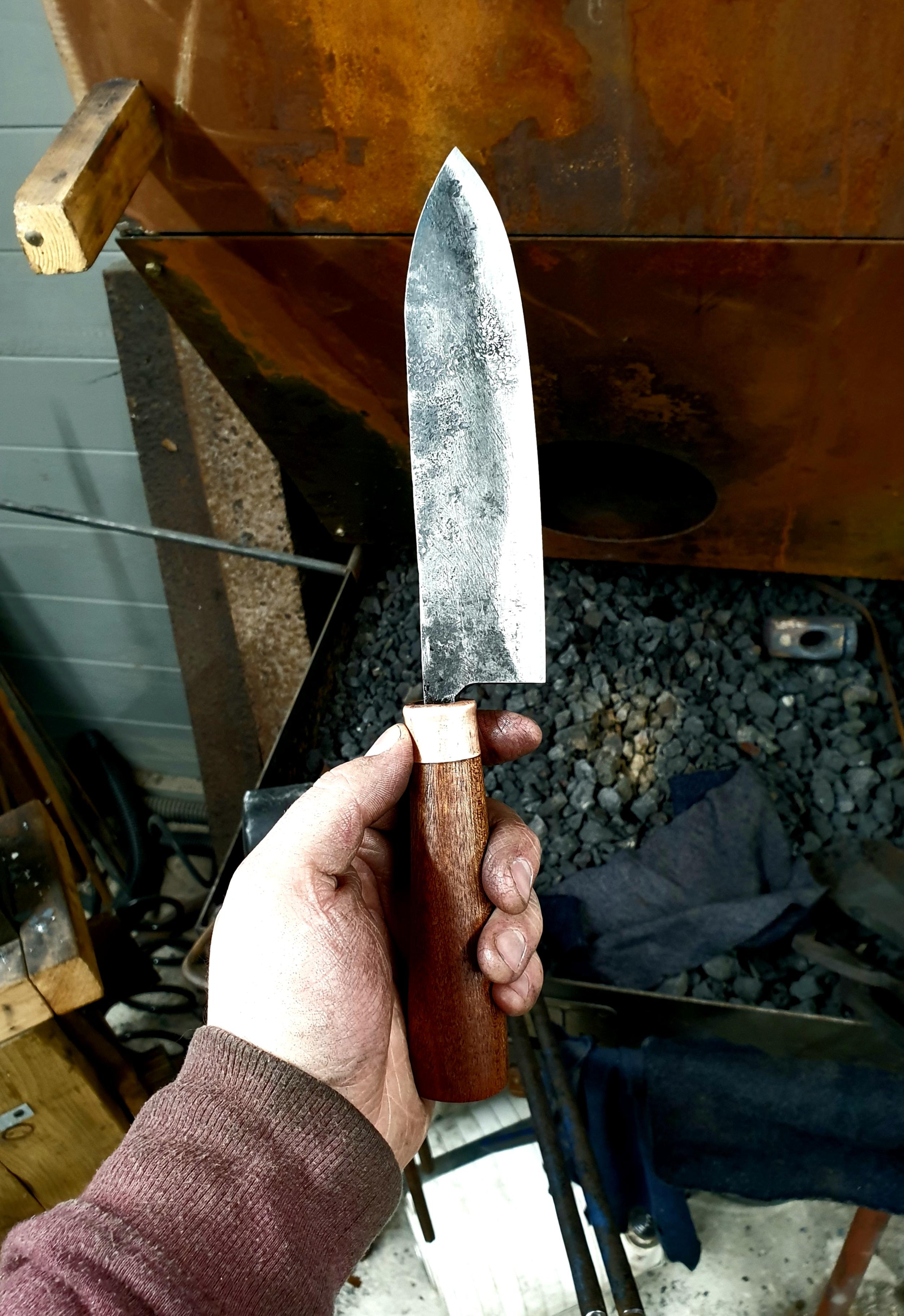

Jon Kerr Posted February 23, 2020 Author Share Posted February 23, 2020 Finished my first knife..... first ever handle too. I dont think I've heat treated it properly. I quenched it (in oil) but then questioned my memory regarding tempering (I have done it before in kitchen oven) and ended up trying to do it in the fire by heating the spine (using a kind of residual heat method like for punches and chisels). This actually went too far and the blade turned purple, but a file still seems to skate so I sharped it up. Now that I've come back in and read up again I remember thay knifes are usually tempered for a few hours. Is it likely that my knife is glass hard in the middle? Will it be dangerous? If so I can remove it from the handle and do it again properly. Any tips on steps welcome. (Its leaf spring). Quote Link to comment Share on other sites More sharing options...
Neal the smith Posted February 24, 2020 Share Posted February 24, 2020 Hi Jon. Looks awesome for a first attempt. I like the profile a lot. Re tempering, hard to say without knowing how thick the blade is and how quickly you heated it. Of course the only way to tell for sure is to snap it a look at the grain structure. I imagine you took your time though so should be ok. Quote Link to comment Share on other sites More sharing options...
pnut Posted February 24, 2020 Share Posted February 24, 2020 What are you going to be using it for? If it's not going to be used for processing whole animals I think it should hold up fine to average kitchen use. People use ceramic blades and they're brittle. It looks good but as to the temper I'd say use your best judgement. Pnut Quote Link to comment Share on other sites More sharing options...
Jon Kerr Posted February 24, 2020 Author Share Posted February 24, 2020 I'd like to gift it to my brother and sister in law..... They will only use it for general kitchen use- vegetables etc. Neil- it's quite thick-4mm at the spine (its made from your leaf spring!) The colours definitely ran back to blue but I just wonder what the effect of not "soaking" for a longer temper might be? Why is it ok to temper a punch or chisel for a matter of seconds, but a knife needs 3 hrs? Quote Link to comment Share on other sites More sharing options...
Neal the smith Posted February 24, 2020 Share Posted February 24, 2020 Ah, OK. Now, I know I'm going to get something wrong here and someone with more knowledge of the crystalline structures and transition points will correct me, but here goes: In my experience, all heat treatment time is based primarily on the material and its thickness. This applies for quenching, annealing, normalising and tempering. As a result, if made of the same material, the results of tempering a chisel for seconds will not be the same as tempering a knife for hours. When you quench, you change the Austenite to Martensite, trapping the free carbon atoms within a hard and brittle structure. Tempering allows carbon trapped in the Martensite to be released, which has the effect of reducing hardness and increasing ductility. (Don't ask me how!) However that's not to say that either is wrong - could you put your punches in the oven for a few hours? Sure, but they are likely to have more ductility than they need and less hardness. Could you slowly heat the back of your knife and let the colours run and then stop the temper as soon as the blade hit the right colour? Again, sure (a treatment often referred to as blue-backing), but the physical properties won't be the same as the soaked knife. Quote Link to comment Share on other sites More sharing options...
JHCC Posted February 24, 2020 Share Posted February 24, 2020 Shorter answer: because getting the heat treatment just so is more important with a knife than it is with a punch or chisel. Generally speaking, you're dealing with a smaller cross section and have a lot more time and effort invested in a knife, so you need to get very specific properties out of the heat treatment that aren't as critical as they are with a punch or chisel. You certainly could give a tool the heat treatment for a knife, but the advantages probably aren't worth the time and effort. Quote Link to comment Share on other sites More sharing options...
ThomasPowers Posted February 24, 2020 Share Posted February 24, 2020 If the back of the blade actually went to blue then that should handle the edge being a bit harder. It looks like a cooks chopper and I would suggest just going with it as it is. If it breaks it's more likely due to problems with the original forging---temperature ranges are MUCH more important with blades and hard for folks starting out to internalize---especially if they have been "practicing" with more forgiving steels. (If anyone from the NMT Bladesmithing club is reading this; please reread that previous line!) Quote Link to comment Share on other sites More sharing options...
