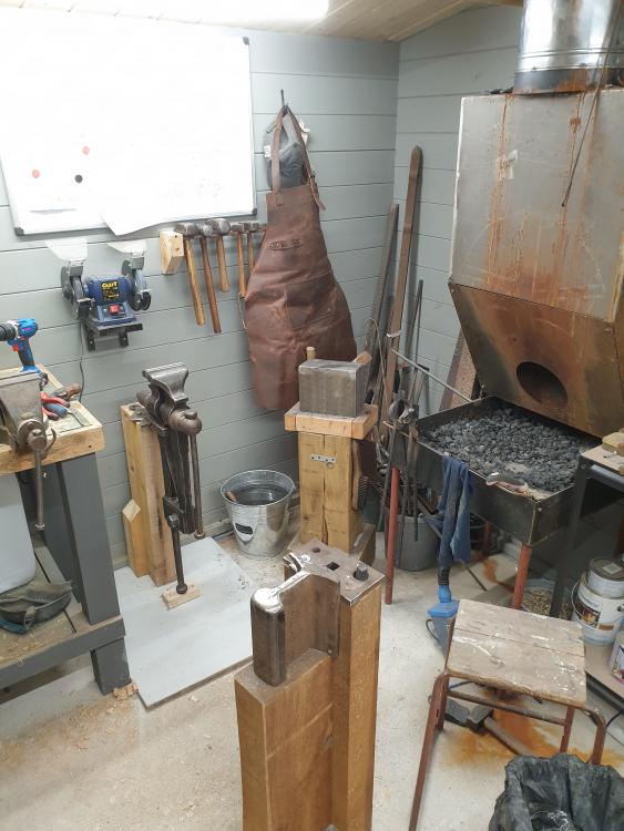

Frosty Posted November 20, 2019 Share Posted November 20, 2019 I don't do a lot of heat treating but I have a quench tank. It's made from a 15 gl. lube oil barrel and has a nice reasonably tight fitting lid. It lives in a cut down 55 gl. drum again with a lid. The lube barrel is thin steel and poking holes in it is a concern so I cut a piece of 14 ga. steel sheet to fit and dropped it in. Then I cut and bent 5/8" expanded to make a shallow basket that slips in the barrel and welded a pair of handles that raise above the oil level but are below the level of the lid. The 14 ga. disk has been enough armor I haven't poked a hole in it and the basket allows me to fish out things I drop without reaching into the oil. The cut down 55 gl. drum is containment if it catches fire or gets a hole poked in it. I preheat with a piece of 2" dia. round bar, noting fancy I just heat the end and stand it in the oil, it's long enough I don't have to do anything special it only gets HOT on one end. On the rare occasion someone doesn't plunge a quenched piece completely under the oil and its flared up I just tossed the lid on the oil barrel and the containment and we took a break for the smoke to clear. I HIGHLY discommend using: ABS or PVC pipe, plastic bucket, wading pool, etc. for a quench tank like you see on TV "reality(?)" shows You REALLY don't want to touch a side, have the hot steel melt a hole and let the oil out, especially seeing as it's flowing over a piece of HOT steel. A healthy stream of burning oil is just SOOOO hard to explain to an insurance adjuster. They have their own definition of understandable you know. Frosty The Lucky. Quote Link to comment Share on other sites More sharing options...
Jon Kerr Posted November 20, 2019 Author Share Posted November 20, 2019 Frosty- thanks, I think I'll copy you on both fronts- cut a thicker disk of "armour" to protect the bottom from dropped sharp objects, and also find a larger tank for it to sit in to act as containment in case of a disaster. That makes me happier as my £25 lovely 30litre, sealed lid, shiny blue quench tank isnt a waste of cash!!! (I did TRY to find something cheap/free but struggled!!!) Quote Link to comment Share on other sites More sharing options...

Jon Kerr Posted December 2, 2019 Author Share Posted December 2, 2019 Hi everyone, More updates- boring by most people's standards but its progress for me I made 2 small hooks, and rigged up a temporary bending jig with two round piece of steel in my vice. This worked a treat and was much easier to get the bends to match. As soon as I have access to a welder I'll be making myself a proper version. I started two bottle openers, but reacher the stage where I'm missing the tools needed to continue. SO, rather than try to bodge it with tools I have, I've forced myself to be patient, stop, and make the necessary tools to finish the job properly. So.... I made a simple drift from an old masonry chisel. Its not perfect but it will do the job. I removed the rail track from the post so I could safely cut a notch out to make a mini horn. My portable hardy anvil is now a really useful tool- the holes are fine for punching and drifting, and the square hole works well for my only current hardy tool (a hot cut). I'm hoping to make a spring fuller soon! Next time I'm in the shop I can use the drift and mini horn to do a little more on the bottle openers. Then, I'll have to pause again to make a rounded punch (for the opener tab), and a chisel and a centre punch as I want to try a dice twist. (These will be gifts for my boardgamer/wargamer friends!) The final pic is the current view of the forging area of my shop. I couldnt be happier with this, given that I was forging outdoors, at the bottom of a muddle garden next to a falling down shed this time last year! Quote Link to comment Share on other sites More sharing options...

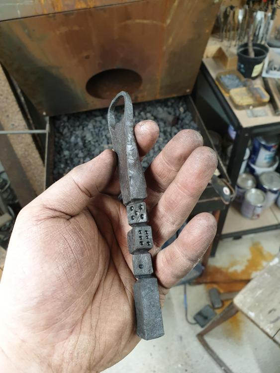

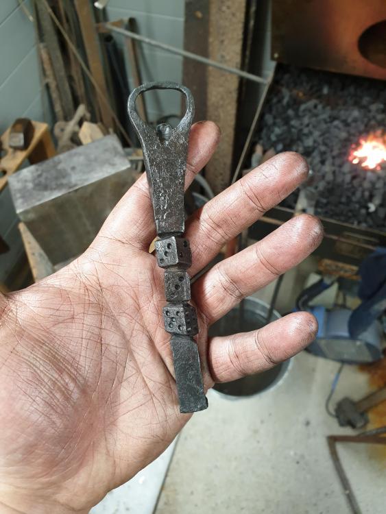

Jon Kerr Posted December 28, 2019 Author Share Posted December 28, 2019 Hi all, quick update! Things are going great in my little forge- I'm really making progress. Thanks to the introduction of the mini-horn to my rail anvil, I had all the tools I needed to finish my first bottle opener with a dice twist!! Incredibly happy with this- especially sincs I've tried this a few times over the past year and this is the first time I succeeded. Really proud of it. Now I just need to make about 10 more for all my nerd friends. I also took Thomas' advice and made a handled chisel from an old small cross peen hammer. Havent used this yet. Heat treated the chisel end and annealed the striking end. The forge is evolving all the time! I made a quick hammer rack. My sister bought me a new apron for Christmas which is hanging on a hand made hook. And..... most excitingly of all...... my amazing wife bought me a 3 day Bladesmithing course with Owen Bush (Basher on IFI)! I cant wait. April cant come soon enough. Quote Link to comment Share on other sites More sharing options...

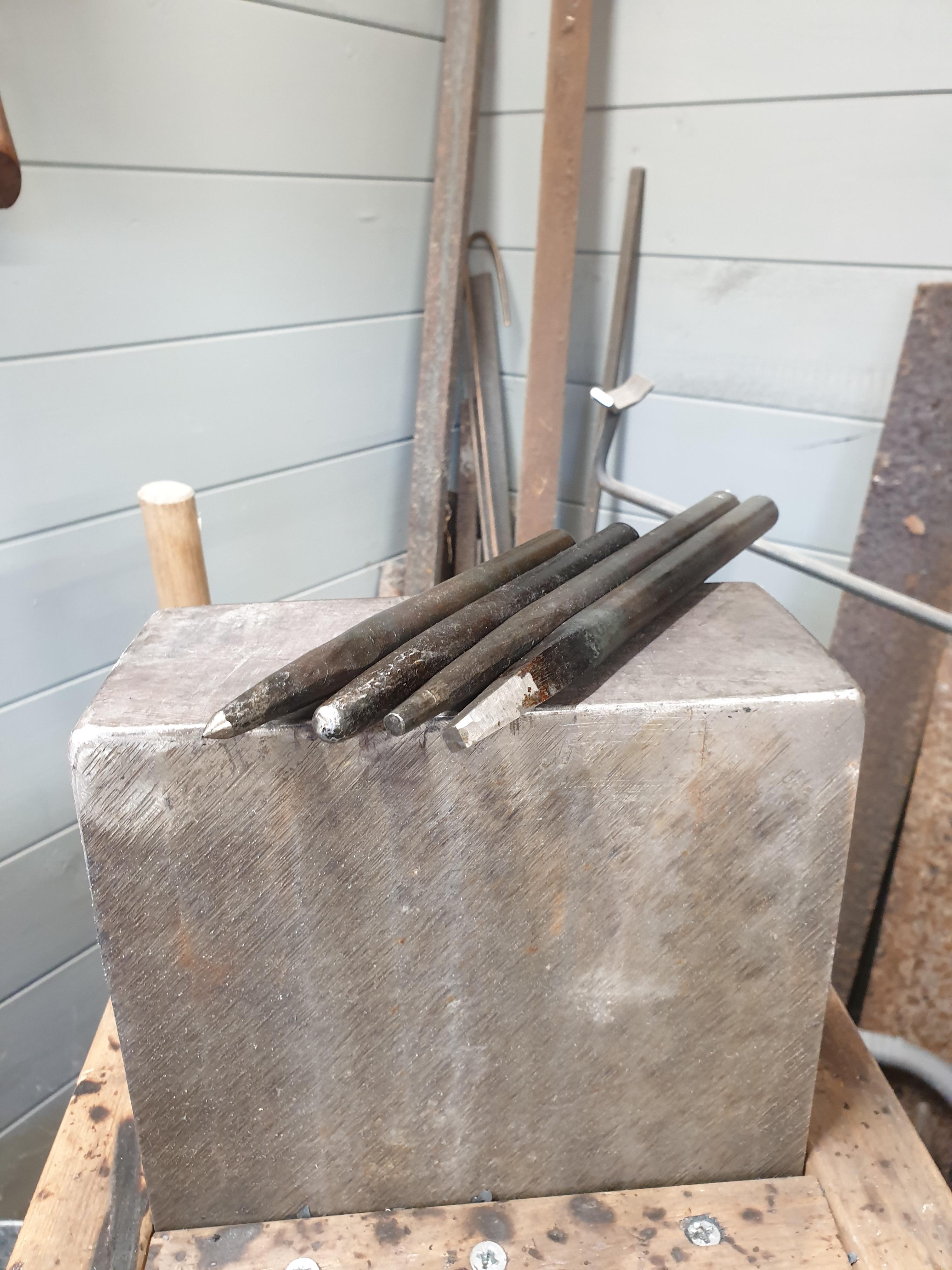

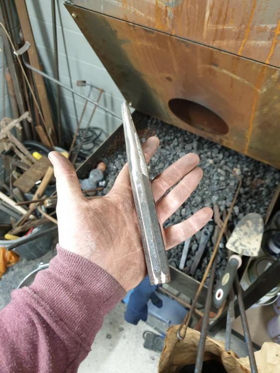

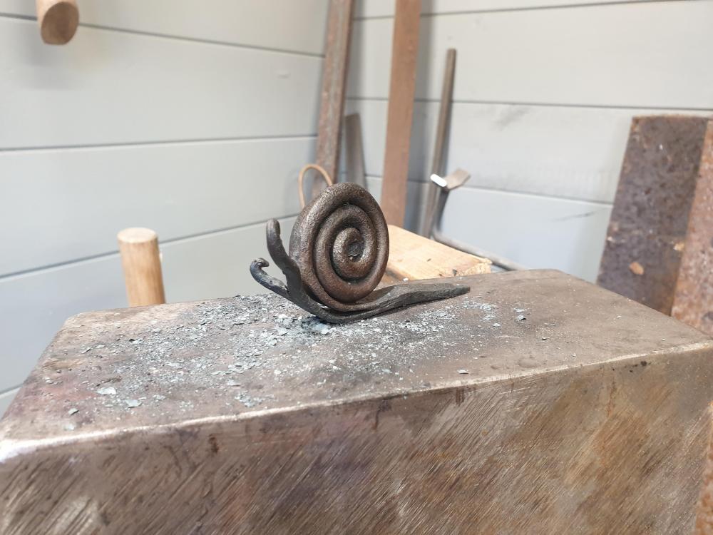

Jon Kerr Posted December 30, 2019 Author Share Posted December 30, 2019 Today I managed my first solo forge weld!! A few weeks ago I met up the Neal the Smith from IFI and he gave me a forge welding intro which was awesome. Today was the first time I managed it in my own forge (coke, wheras Neals is gas). Super happy and I finished a snail (much better than the first, although I still burned an antennae off!!) I also forged and heat treated a better centrepunch and a rounded punch (last one was rebar)..... to make more dice twist bottle openers. Finally I made a simple punch holder from a tin can screwed into my hammer rack.... Quote Link to comment Share on other sites More sharing options...

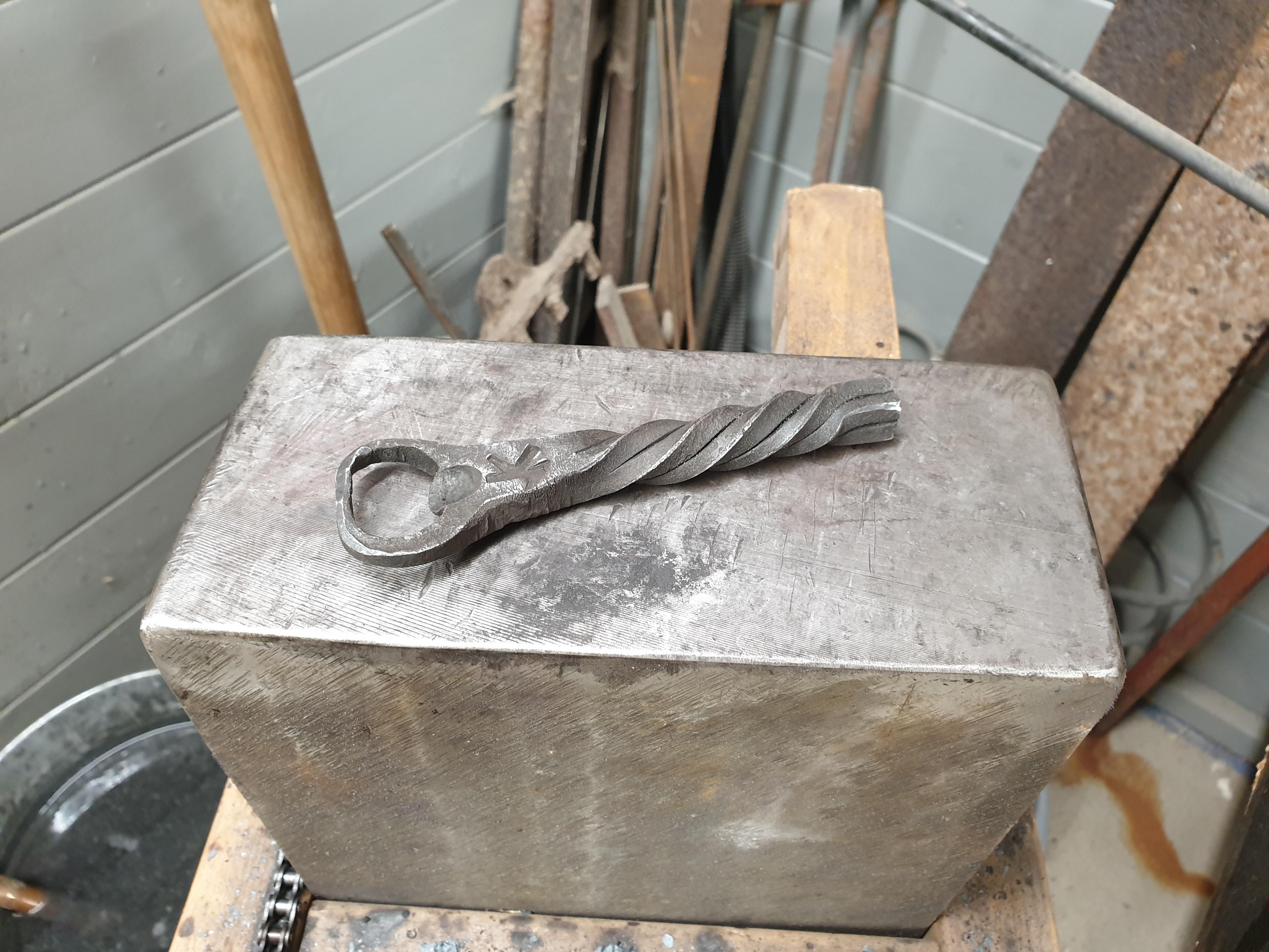

Jon Kerr Posted January 1, 2020 Author Share Posted January 1, 2020 Not sure if anyone is reading these updates but I'll keep posting nonetheless as its nice to track my progress for my own sake... Today I made a bike-chain hold down with a foot stirrup, inspired by JHCC. Forgot to photograph it but it works wonderfully well. I also made two more bottle openers. Really really pleased with twisted one and used my touchmark in earnest for the first time which came out nice. I made a second dice twist opener which didnt turn out as good as the first.... but practice makes perfect. Quote Link to comment Share on other sites More sharing options...
