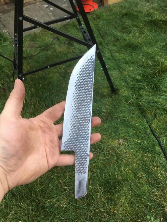

Frosty Posted October 3, 2018 Share Posted October 3, 2018 Ferrier's or Hoof rasps are excellent for hot rasping forged work like oh say blades. Hmmm? Other things to look for are: punchs and chisels, hex wrenches. You see them at yard, garage, etc. sales often in a pile or old can for not much. The punches and chisels are good medium carbon steel and make excellent bottom tools sometimes for just grinding to a different shape. Hex keys are also good steel and make fine impact tools on a smaller scale say chasing chisels and decorative punches. Hmmm? Frosty The Lucky. Quote Link to comment Share on other sites More sharing options...
