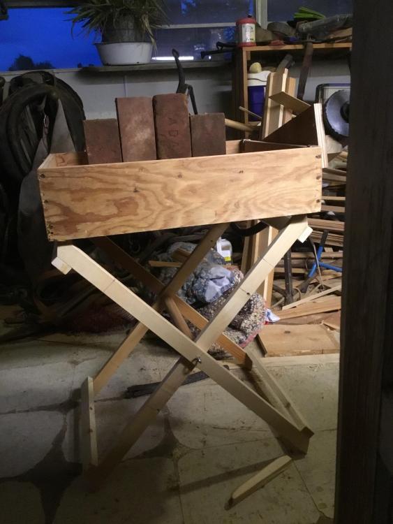

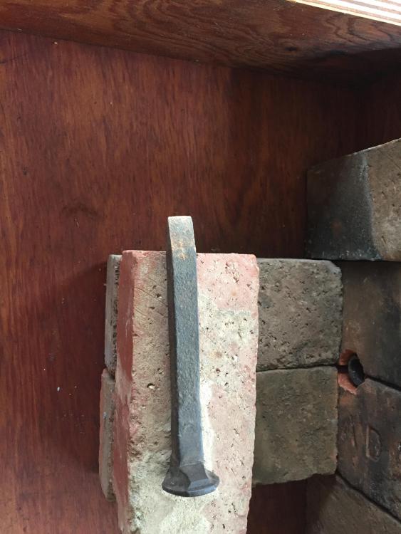

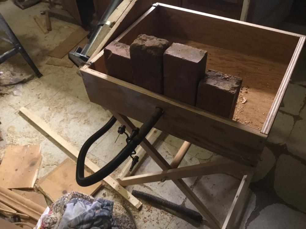

Charles R. Stevens Posted May 1, 2018 Posted May 1, 2018 I need another bag of litter, some handles, an other bracket on the air pump but she burns Quote

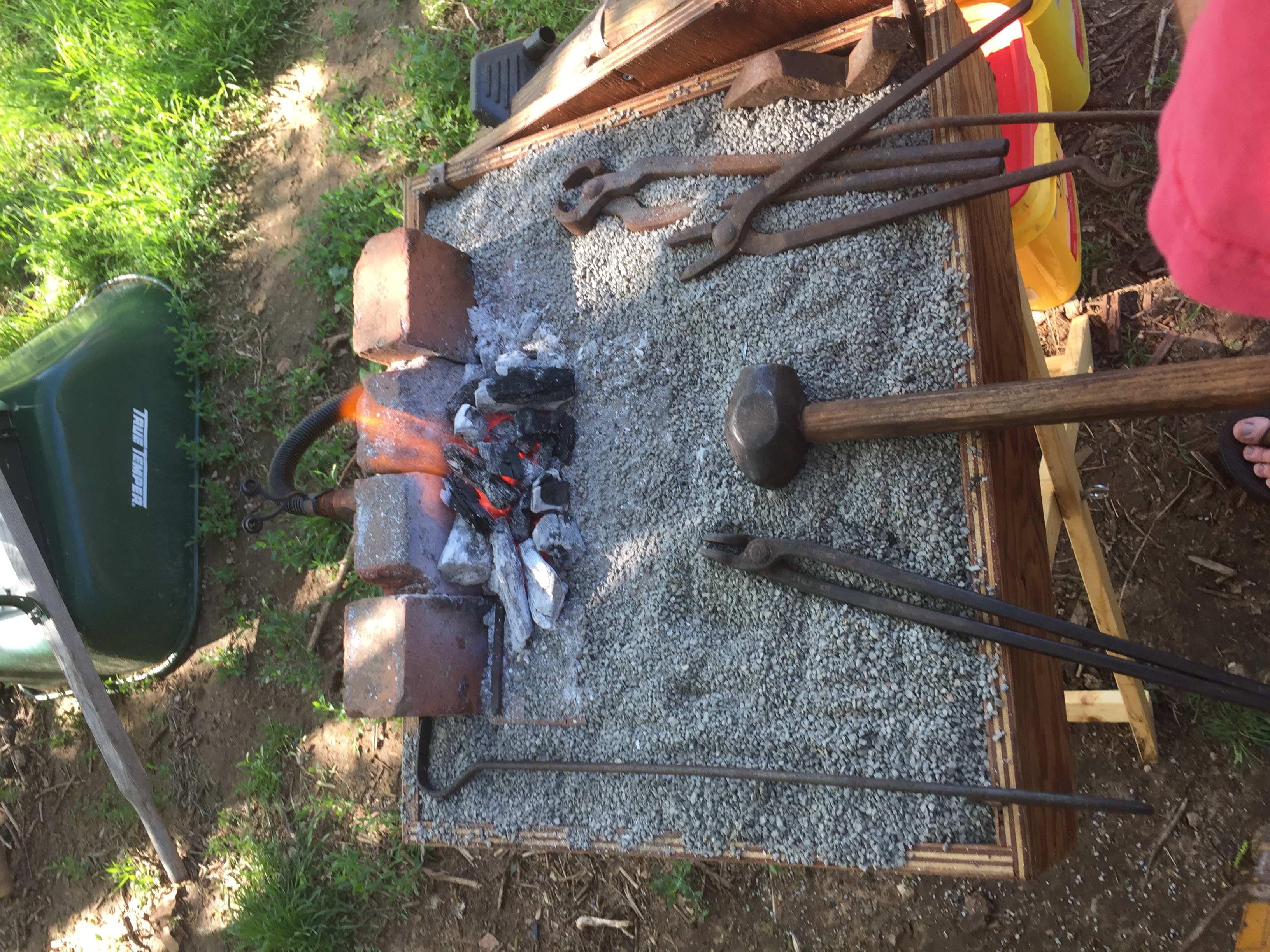

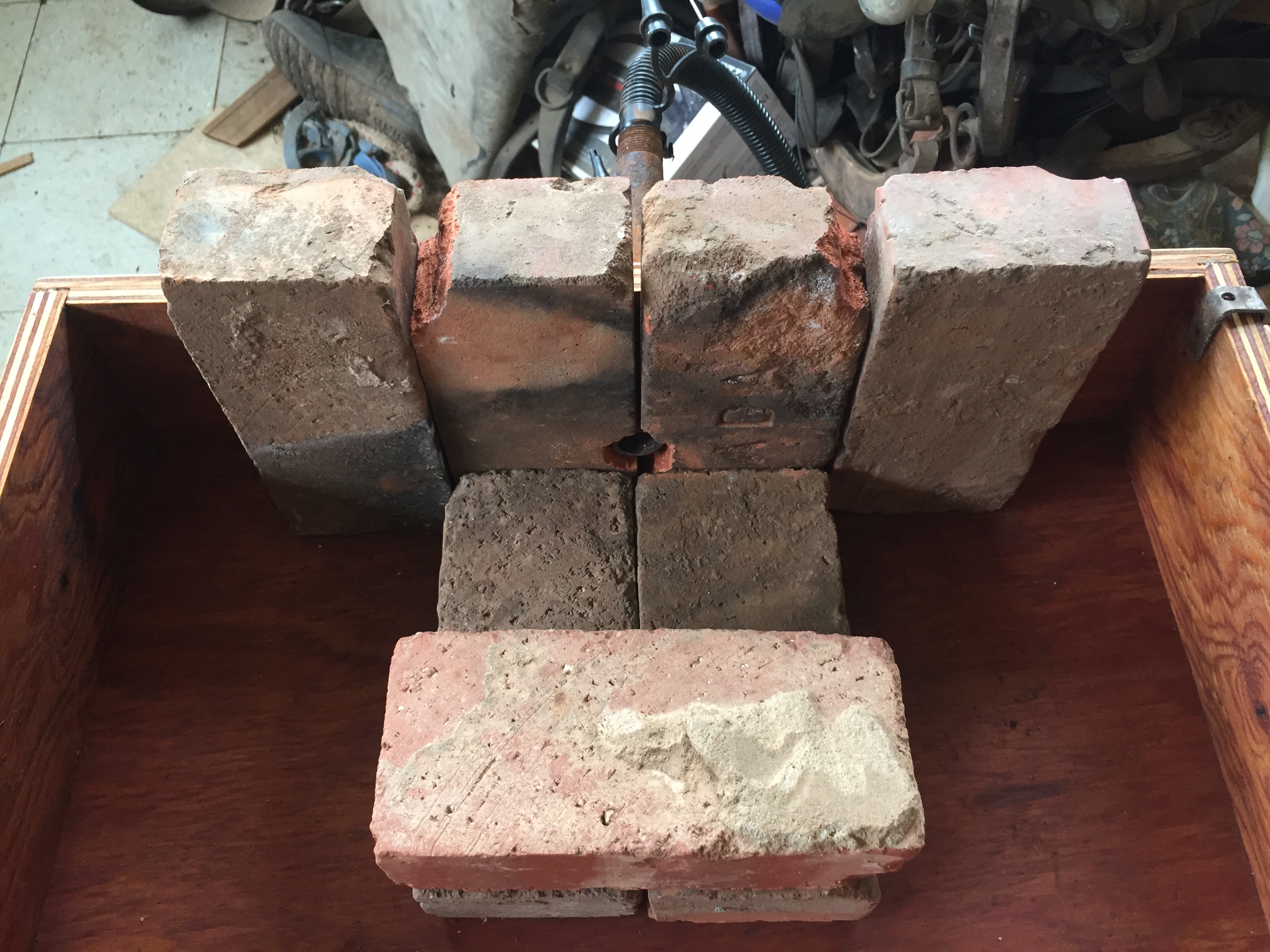

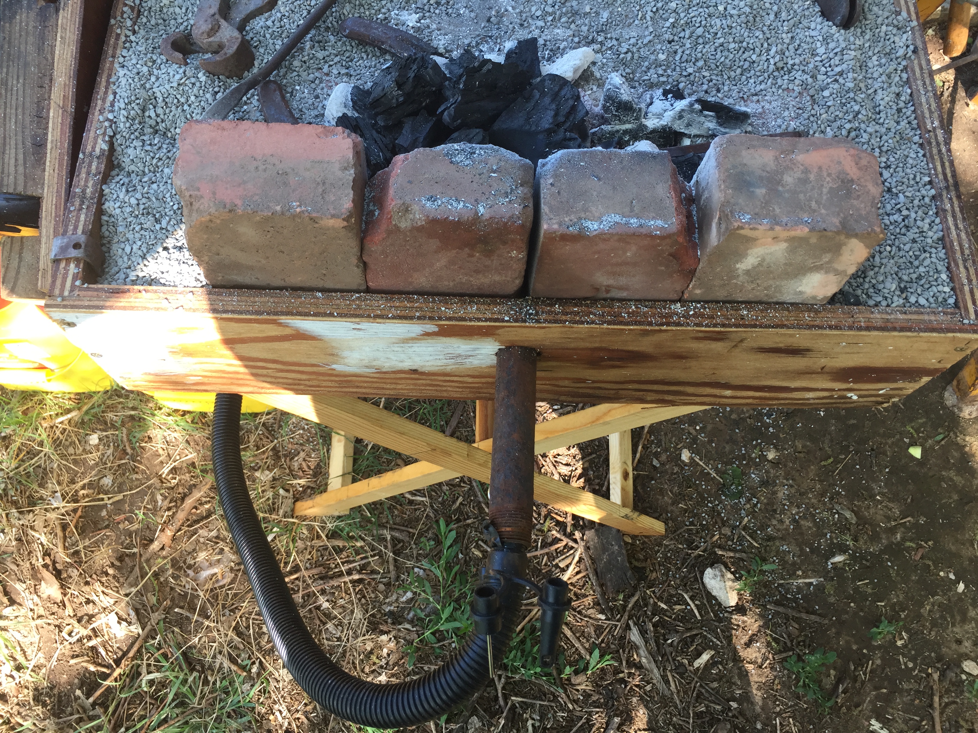

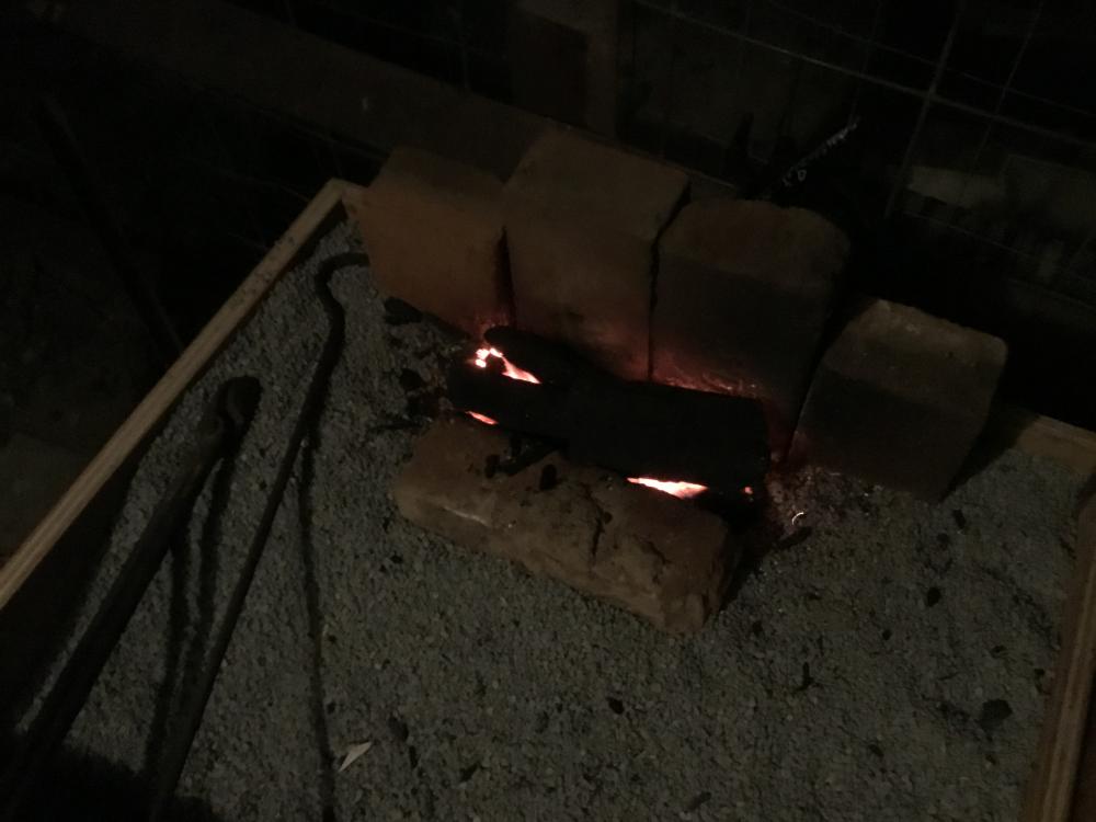

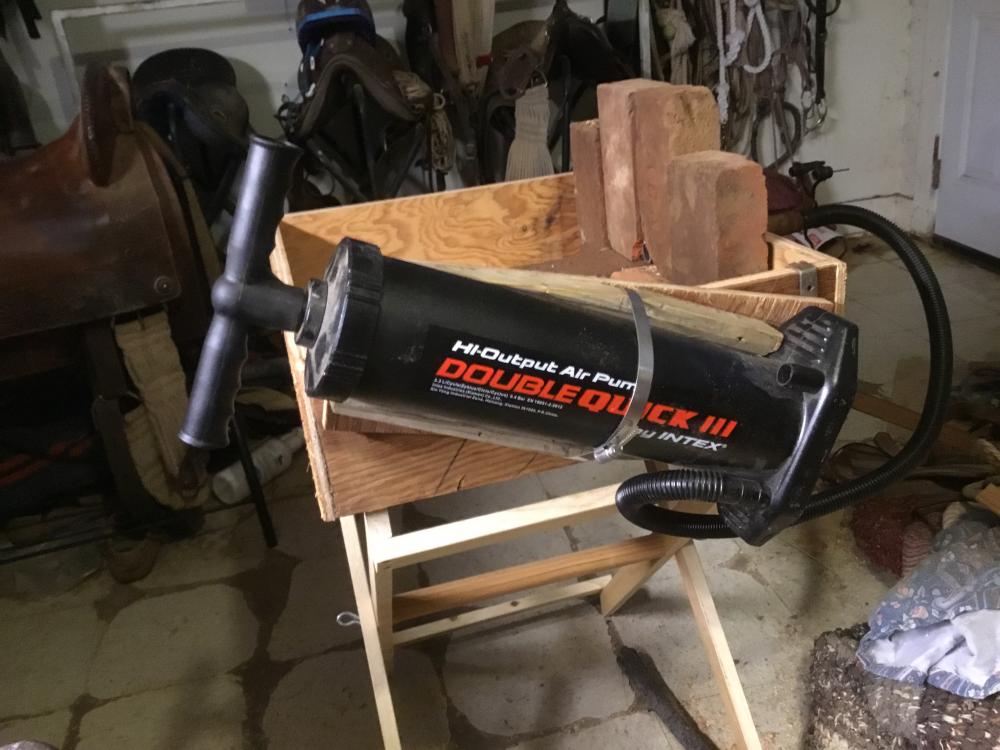

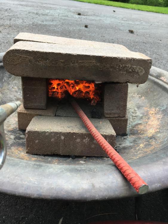

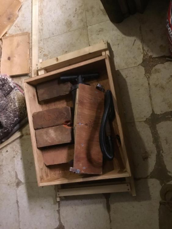

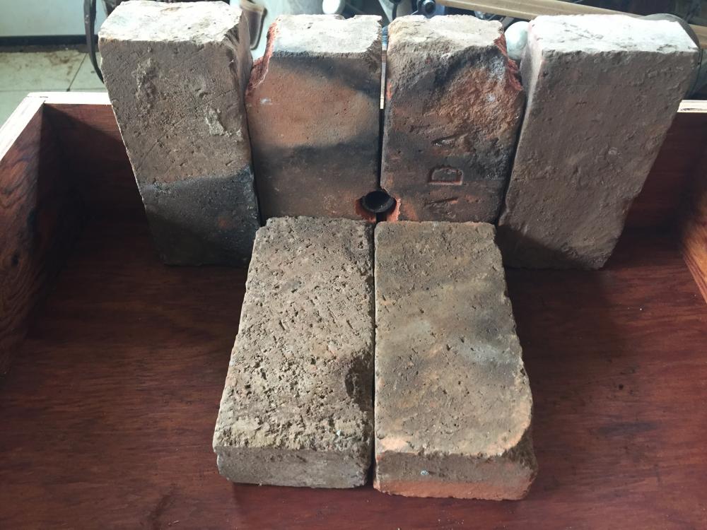

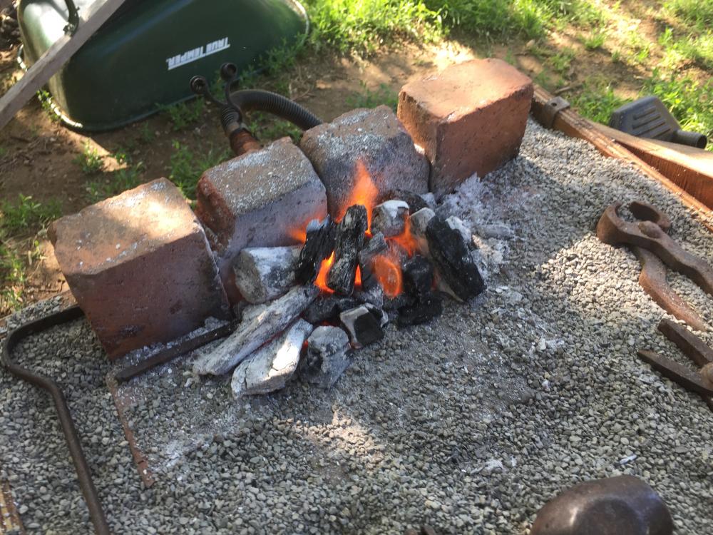

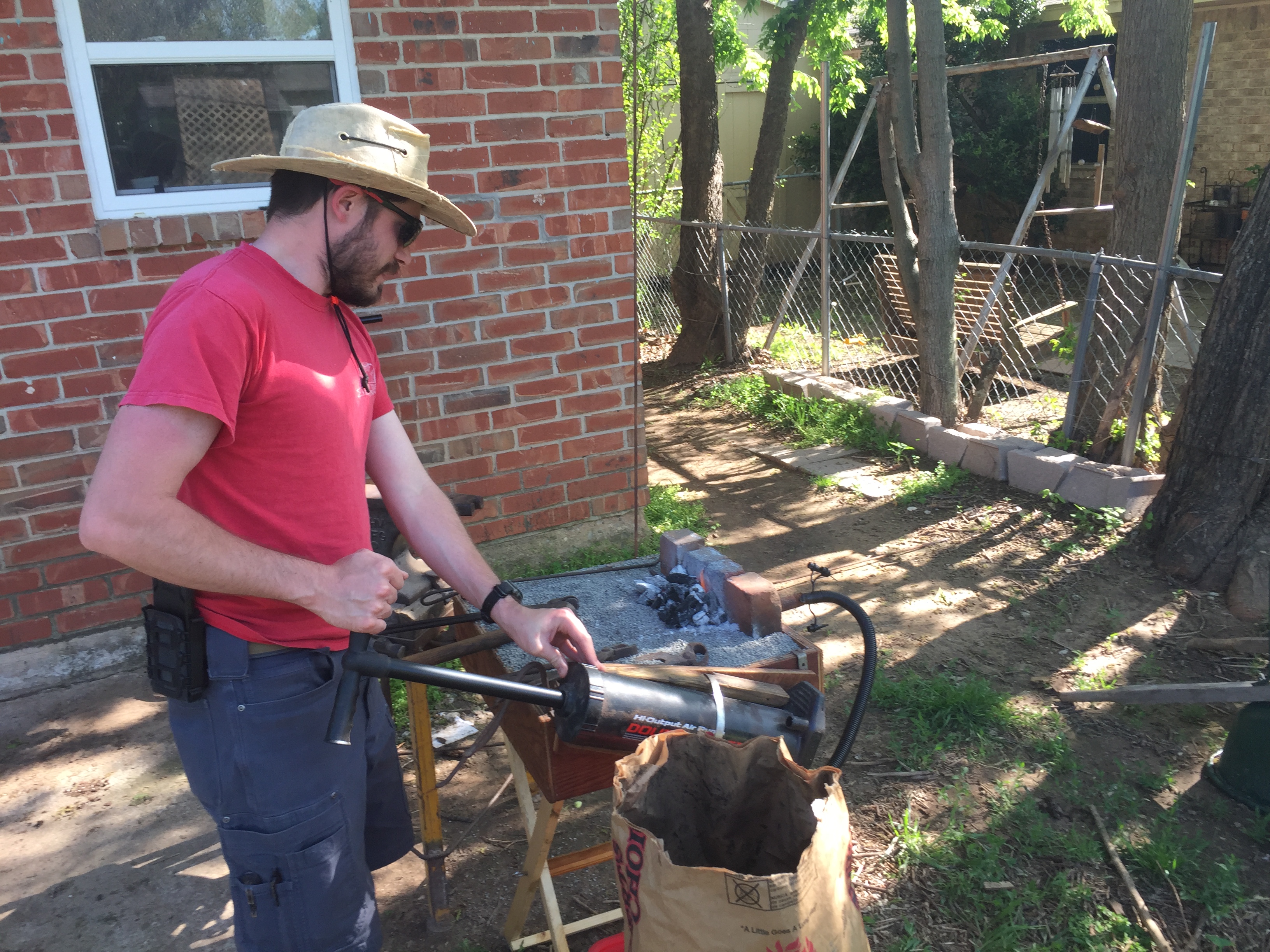

Charles R. Stevens Posted May 2, 2018 Author Posted May 2, 2018 Old soft red brick from Oklahoma, lol. I have already made a change but as I am out of pocket, no pictures. Figured that the shoe and the pump would prove the point. That was about 15 min from light to that picture. It sedled down and got hotter as all the fuel cam to temp. The back of the box and tuyere were warm to the touch (8”) but not even as hot as my morning coffee mug. now I have a portable for demoes. Cat litter worked the camp. This morning before leaving for counceling I oiled it and planed a bit in the legs so I can flip them around so it sits better. Quote

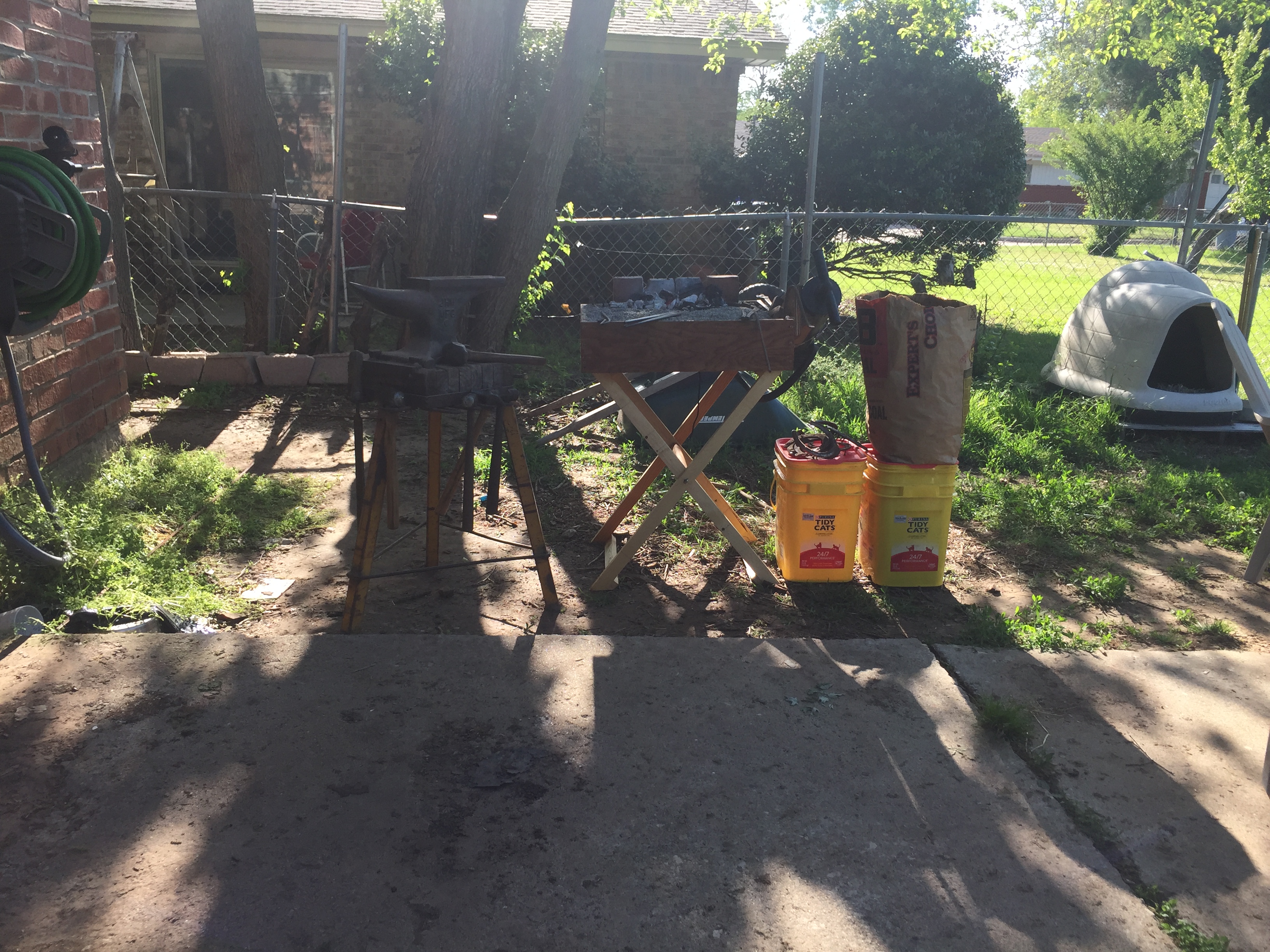

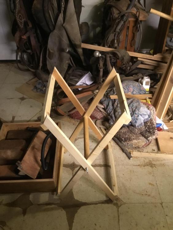

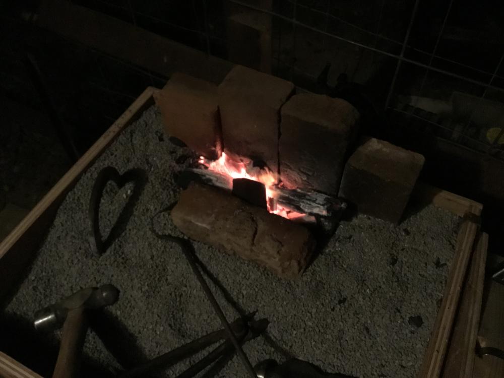

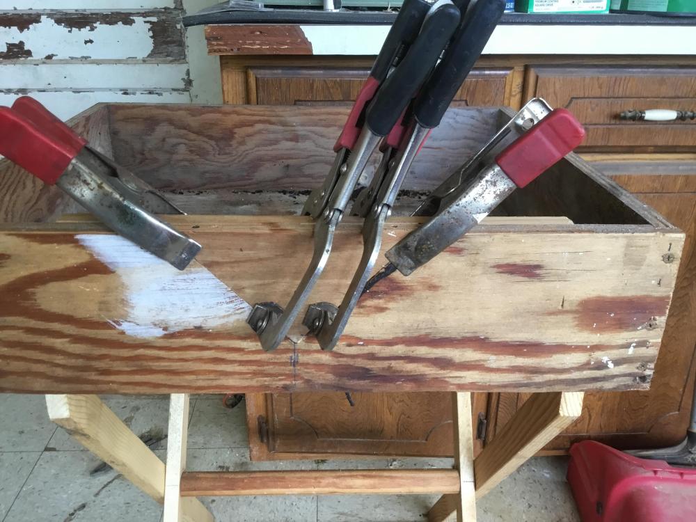

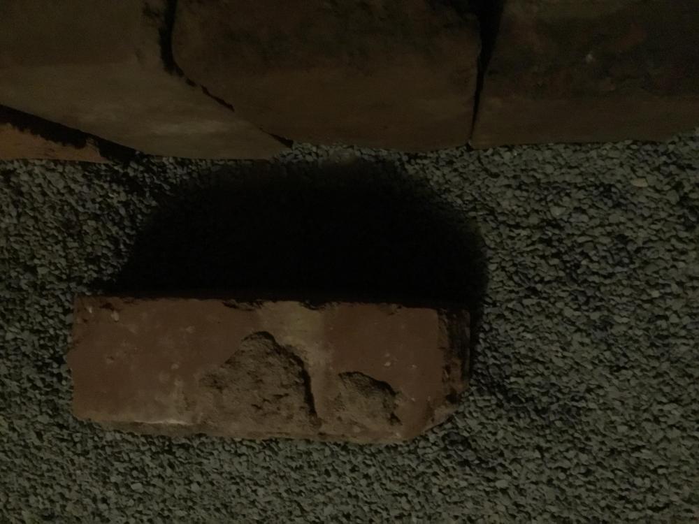

Charles R. Stevens Posted May 2, 2018 Author Posted May 2, 2018 Coat of oil, and modifying the bricks. I want 3 more bricks. As this is intended as a portable and demo forge. Brick carving tool Quote

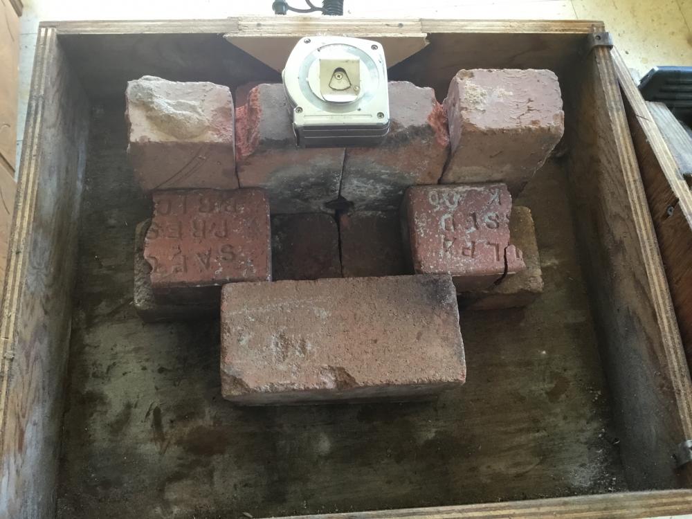

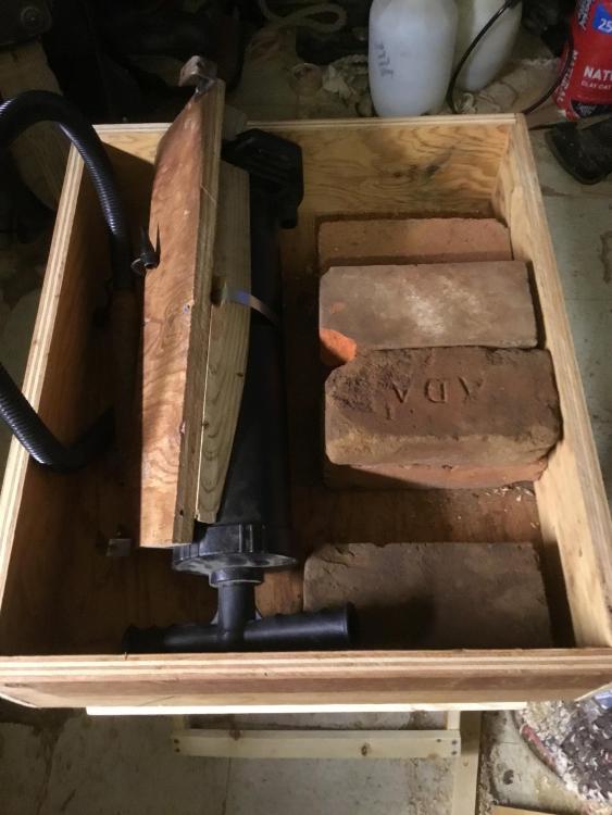

Charles R. Stevens Posted May 2, 2018 Author Posted May 2, 2018 Needs furnished and equipped. Still some tweaking to do Quote

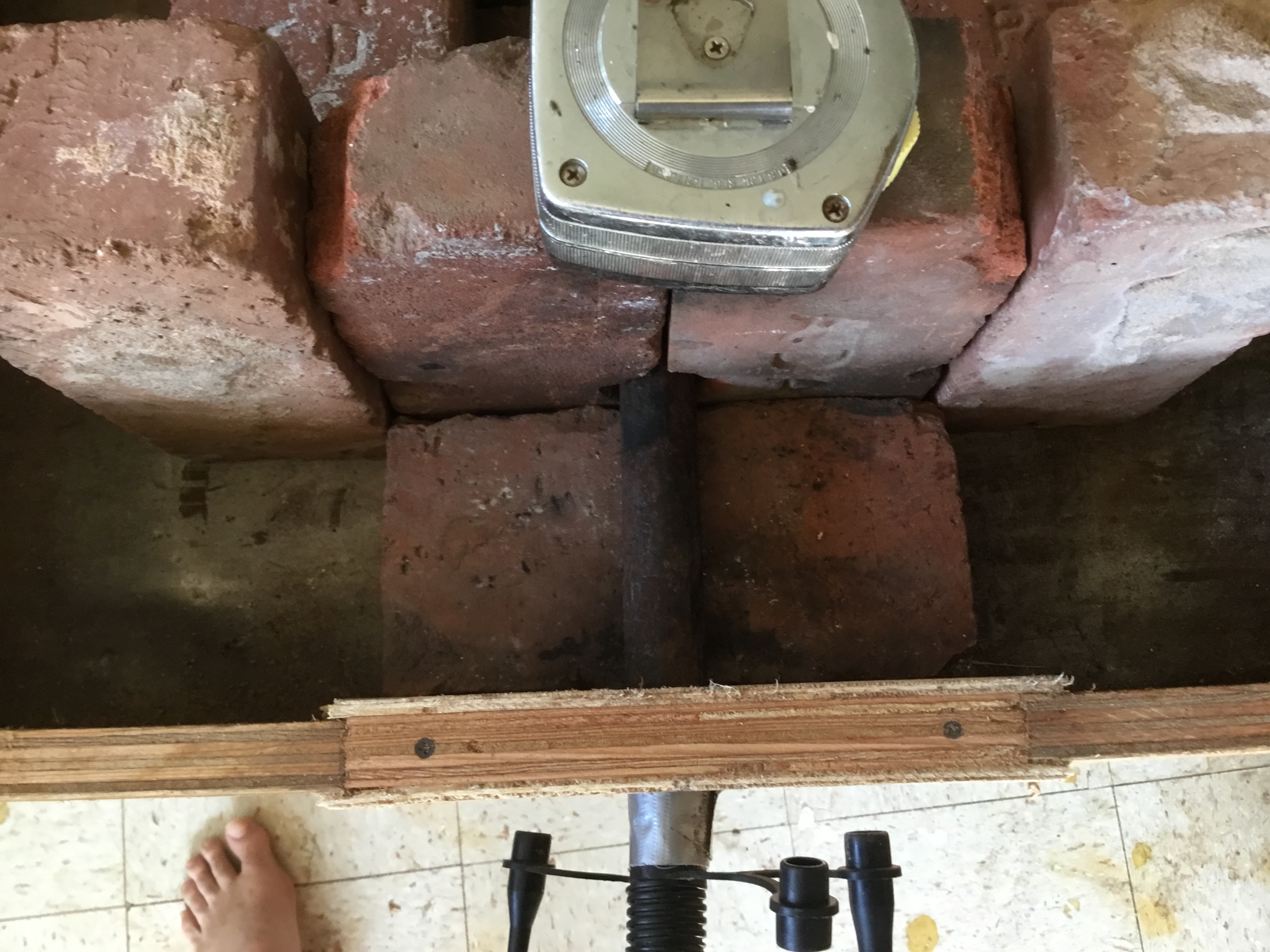

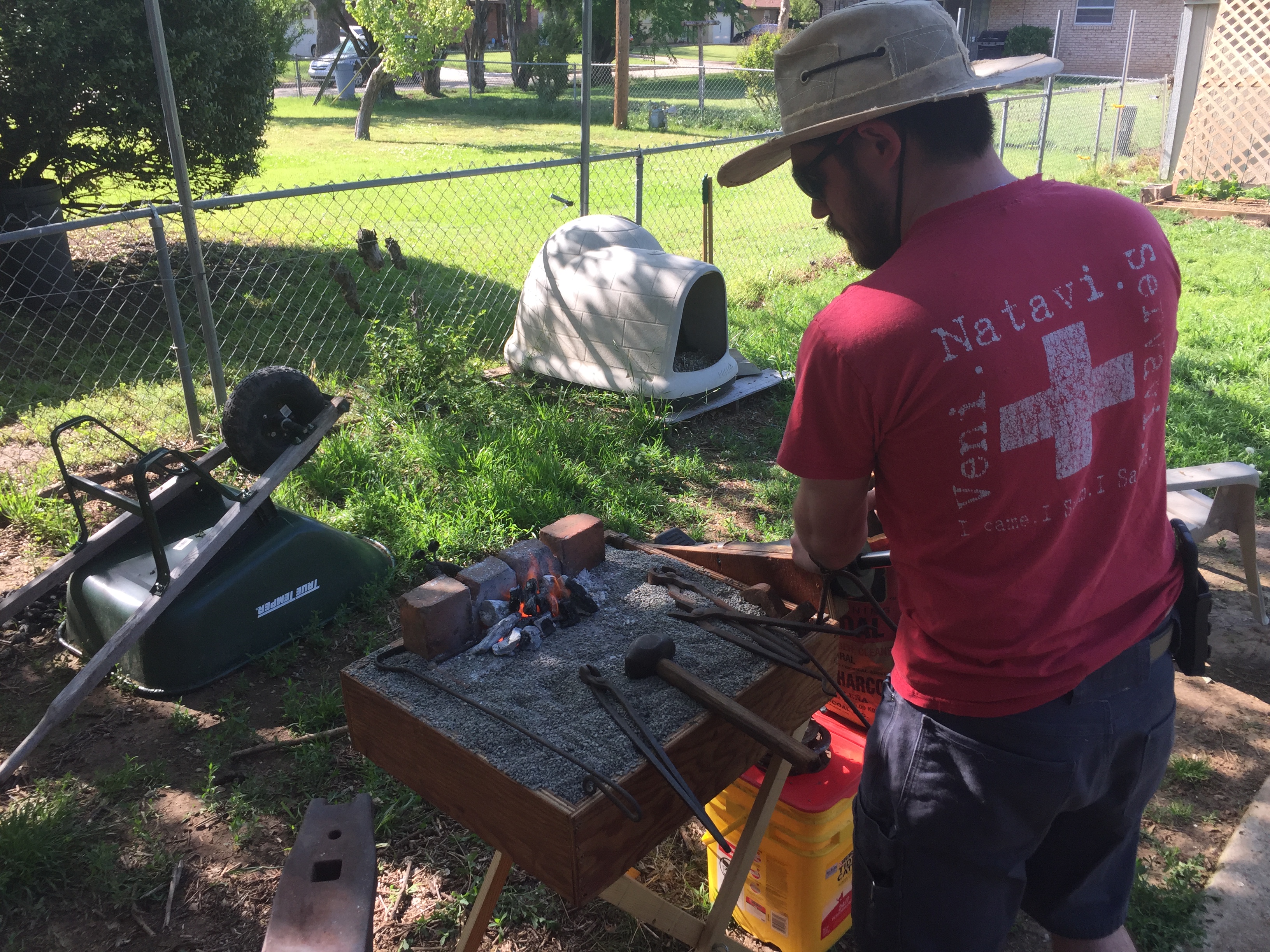

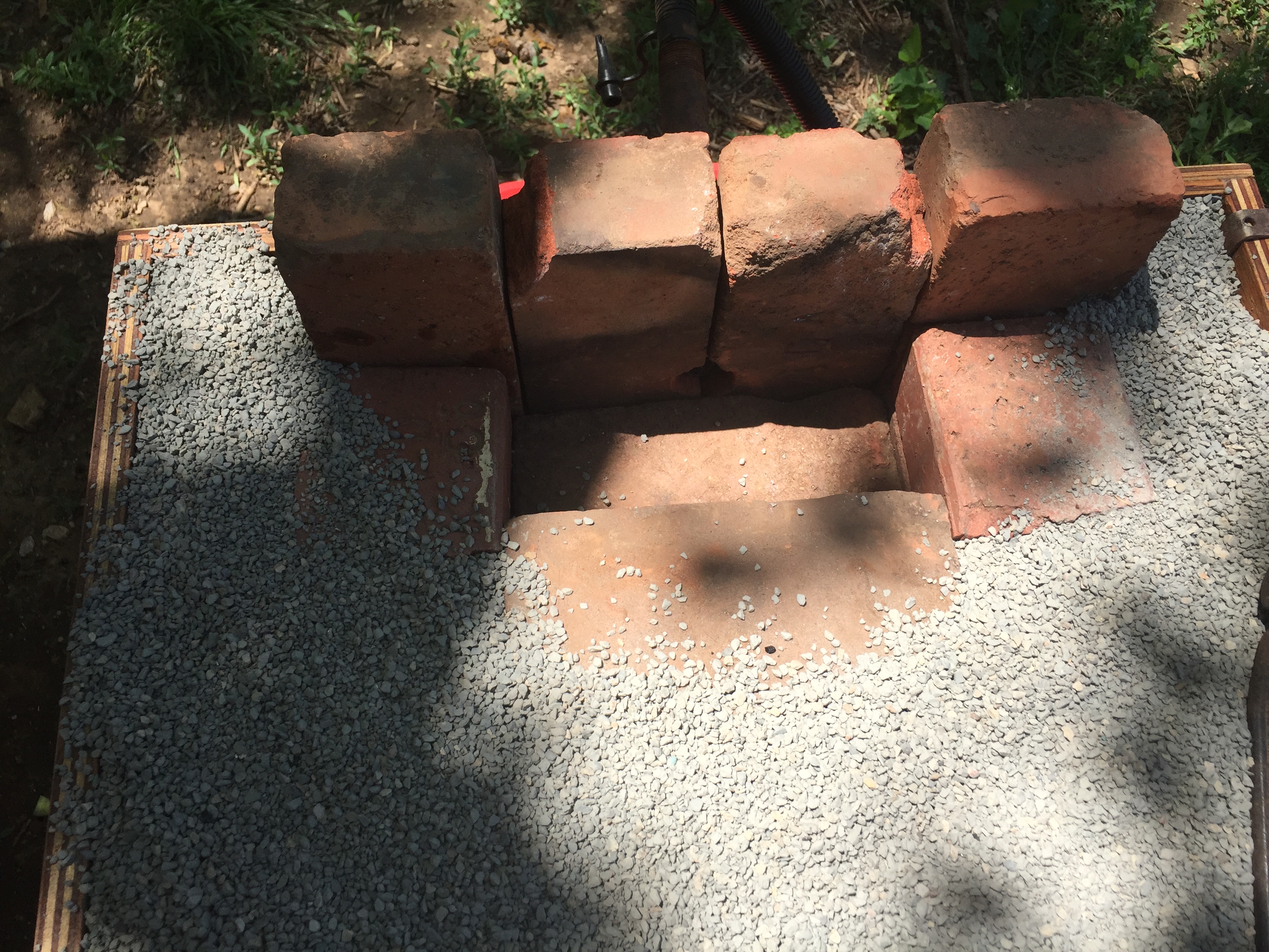

Charles R. Stevens Posted May 6, 2018 Author Posted May 6, 2018 First field test. About 6 hours. The seam between the bricks proved to be a problem. I will be putting in a bit trim to hold the bricks an inch or two forward so I can put cat litter behind them. The jet of hot air created a bit of a fire after 5 hours. I will post pictures of the damage and fix later. My buddy will knocking off the rust on his forging skills Quote
Charles R. Stevens Posted May 21, 2018 Author Posted May 21, 2018 Repaired being made, as after 5 hours the crack between bricks allowed hot air to ignite the box. So after repaires I will be leaving a space to fill with litter between the box and the bricks Quote

Charles R. Stevens Posted May 29, 2018 Author Posted May 29, 2018 In the 6 hours we used it the other day the 8” long tuyer got fresh coffee hot the end where the hose connected as did the back of the box. Some were along the line somthing shifted and a supper heated jet of air started making its way between the bricks (wood flashes to flame at about 600f) and we did have a problem with the box burning) but using my hands to check I didn’t have anything get to hot to hold. My solution is to move the fire bowl forward the width of a brick, this placing 6” cat litter behind the fire wall (I am sure 2” would be enough butt a brick is convineant as a mesure The other change was to reorientate the stand, thus reducing the wable as you pump Quote
Meadowgrove Posted May 31, 2018 Posted May 31, 2018 On 29.5.2018 at 5:40 PM, Charles R. Stevens said: My solution is to move the fire bowl forward the width of a brick, this placing 6” cat litter behind the fire wall (I am sure 2” would be enough butt a brick is convineant as a mesure Butting bricks... That's an excellent typo! Got me thinking about the air gaps left between the bricks, creating "heat bridges". For added safety, you could try putting a ~1" layer of litter under the bricks as well? Quote
Charles R. Stevens Posted May 31, 2018 Author Posted May 31, 2018 You certainly could, it would require a deeper box. As heat rises it has not proved to be much of an issue. Honestly I have more brick than absolutely needed because of the box volume and the desire to keep the forge portable. The two on the floor and the 4 across the back are needed, as one can simply scoop out a depression in the litter. In my case the bucket I have does not fill the box, thus the brick. Quote

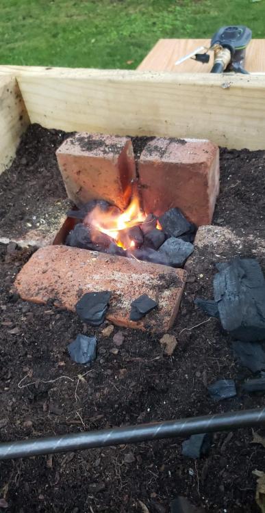

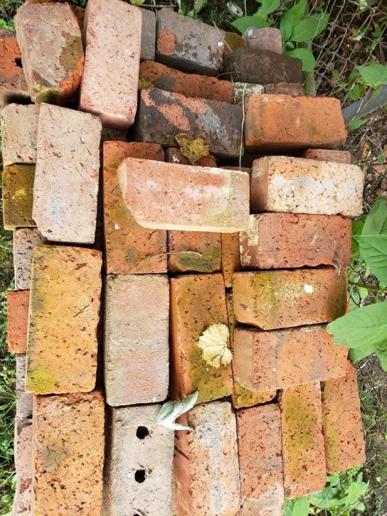

Tyler Cech Posted June 4, 2018 Posted June 4, 2018 Well, I basically have a junkyard full of stuff to use. I know how to make charcoal, which is the way I’m leaning towards, a solid fuel forge. I’m planning on using a large metal bowl I have and setting a brake drum in the center with the pipe coming down for a ash dump and hair dryer, probably the way that Glenn had said. I’m hoping to use what I have instead of buying things but I can buy things if needed. Quote
Tyler Cech Posted June 4, 2018 Posted June 4, 2018 I actually made this today in like ten minutes just to try banging on some metal. Needless to say.... it didn’t work to well. Those aren’t fire bricks btw. I just tried to do this in a couple minutes. Quote
