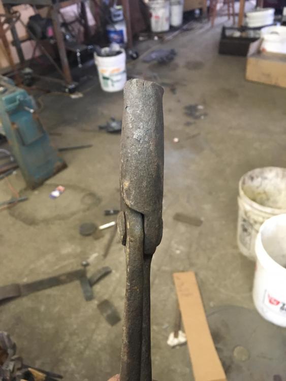

Steven Bronstein Posted April 3, 2018 Share Posted April 3, 2018 I have always wondered what the benefit of the traditional method of making tongs which creates the shoulders between the boss and the working end. There are currently available flat blanks that are used to make tongs. These do not create that shoulder but still seem to work very well. Does anyone know the rationale behind the more traditional method. The extra mass on the end of the tongs does not seem to help in their ridigity or function. Quote Link to comment Share on other sites More sharing options...

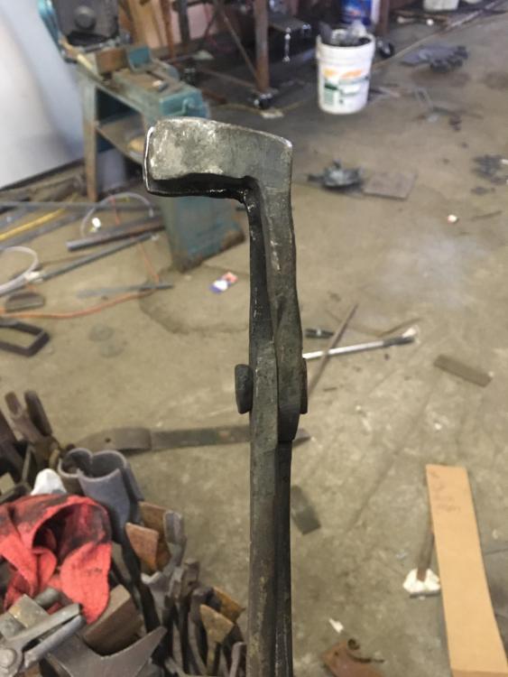

Steven Bronstein Posted April 3, 2018 Author Share Posted April 3, 2018 The tongs on the top show that the material is parallel above the hinge. The pair of tongs on the bottom have the shoulder just above the hinge. The instructions for forging tongs at a 45 over the edge of the anvil helps to create that 90 degree shoulder and I have never understood its purpose. Quote Link to comment Share on other sites More sharing options...
VaughnT Posted April 3, 2018 Share Posted April 3, 2018 The first pair of tongs hold the work off the side of the reins, already off balance, and you have to adapt for that. The piece between the rivet and jaw aren't parallel - one is angled so it can line up with the lower jaw at the working bit. In that instance, flat stock cut out from a sheet will get the job done plenty fine. With the lower pic, the tongs are designed to hold the bar in line with the reins so you have good alignment and are able to rotate the hot steel with a simple turn of the wrist. In order to achieve that alignment, you have to offset the jaws so the work remains in line with the handles. Most people that I've met don't like using off-set tongs unless they have to, myself included. They can be handy, but aren't preferred. Quote Link to comment Share on other sites More sharing options...
Steven Bronstein Posted April 3, 2018 Author Share Posted April 3, 2018 That is a function of the job the tongs are designed to do and doesn't address the question of why tongs are traditionally made with the large off set shoulder when a short gooseneck that aligns the jaws to the reins will work equally well to balance the work. Quote Link to comment Share on other sites More sharing options...
Smoggy Posted April 3, 2018 Share Posted April 3, 2018 Leverage, the shoulder type can offer an advantage for the same rein length due to being able to hold the work closer to the pivot. There may be other reasons but that's the obvious one to me. Quote Link to comment Share on other sites More sharing options...
Charles R. Stevens Posted April 3, 2018 Share Posted April 3, 2018 Jaw width and alignment for flat jaw and other non goose neck designs. Buy doing it that way you have two identical halves and more meat in the pivot boss. Quote Link to comment Share on other sites More sharing options...

swedefiddle Posted April 4, 2018 Share Posted April 4, 2018 Good Morning, I think what Steven is asking about, 'Why do you turn 45 degrees, on the far side of the Anvil, for the second step of making Tongs'. The reason is, so the base of the shorter jaws will clear the hinge boss of the other jaw, after they are riveted together. It is difficult to see all the strengths and weaknesses until you look at MANY TONGS. K.I.S.S. You don't have to make it difficult, but you have to learn where and why. Neil Quote Link to comment Share on other sites More sharing options...
Marc1 Posted April 4, 2018 Share Posted April 4, 2018 7 hours ago, VaughnT said: The first pair of tongs hold the work off the side of the reins, already off balance, and you have to adapt for that. The piece between the rivet and jaw aren't parallel - one is angled so it can line up with the lower jaw at the working bit. In that instance, flat stock cut out from a sheet will get the job done plenty fine. With the lower pic, the tongs are designed to hold the bar in line with the reins so you have good alignment and are able to rotate the hot steel with a simple turn of the wrist. In order to achieve that alignment, you have to offset the jaws so the work remains in line with the handles. Most people that I've met don't like using off-set tongs unless they have to, myself included. They can be handy, but aren't preferred. Absolutely. It has to do with the geometry of the tong. When you close the jaws and exercise a reasonable amount of pressure, the tong jaws unless aligned, will tend to twist. A gooseneck offset jaw will flex and twist much more than a straight jaw forged to be in line with one another. i don't think I would want a tong with two dissimilar jaws like the one at the top. Quote Link to comment Share on other sites More sharing options...
