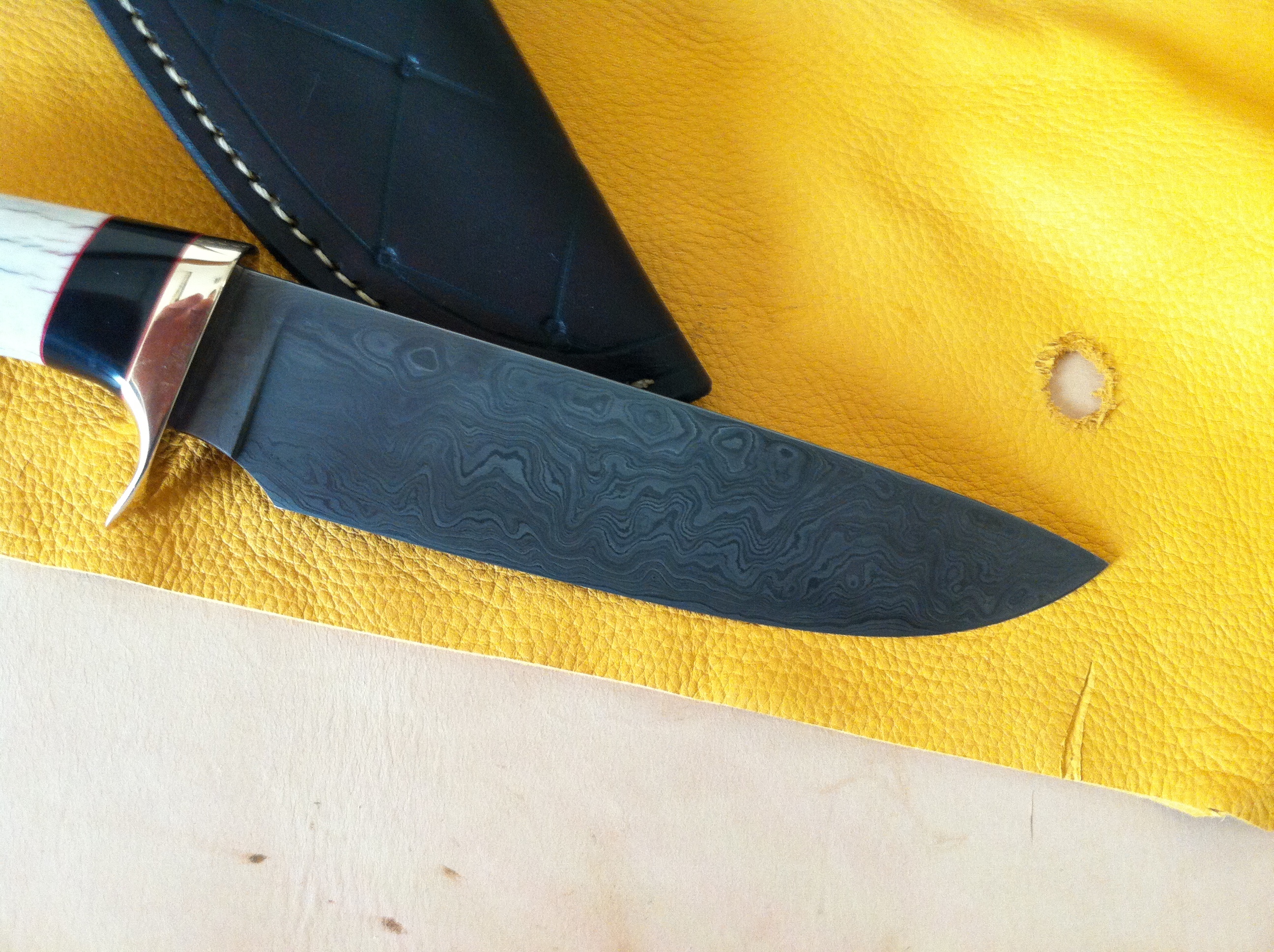

One of ways I was taught to make damascus was the individual stacking of single pieces, or "frontier damascus" or "scrapmascus"  Makes some interesting patterns and no two are alike, and is fun, but the main thing is it's a good way to learn that you don't need a lot of force to forge weld and what the colors and flux looks like and how the steel responds at temp.  And it's fun.
This is a pic of one I did a while back, it's got pieces of files, saw blades, ball and roller bearings, a chunk of a wrench, some leaf spring, some pieces of O1 from a knife I screwed the grinding up on, 1084 and 15&20, L6, pieces of chain saw chain and roller chain, predominately all high carbon and care was taken to try and put contrasting materials together and not say two pieces from the same file.  Each piece welded up one at a time and then draw out length wise and sideways and folded and stacked until the pattern evened out.  I don't do a lot like this, but it's a good learning exercise.

That's a very pretty knife. I'm still working on locating the nearest smith to me, and I'll be joining ABANA as soon as I can (paycheck stuff). I know they teach classes in Santa Fe (2-ish hours) and Moriarty (1.5-ish) but both are above my pay grade. I live in a pretty remote area of the state. Until then I'm surviving on books, BPs, YouTube and hours of forum reading. And practice at random things when I can...

Will, absolutely beautiful!...did You ever post that knife somewhere?...could be I missed something.
