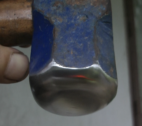

  24. Did some grinding on my 3 pound hammer and got one flat and the other head round. It is mad how careful you got to be to get out all the tiny kinks. Anyways here is my hammer.
