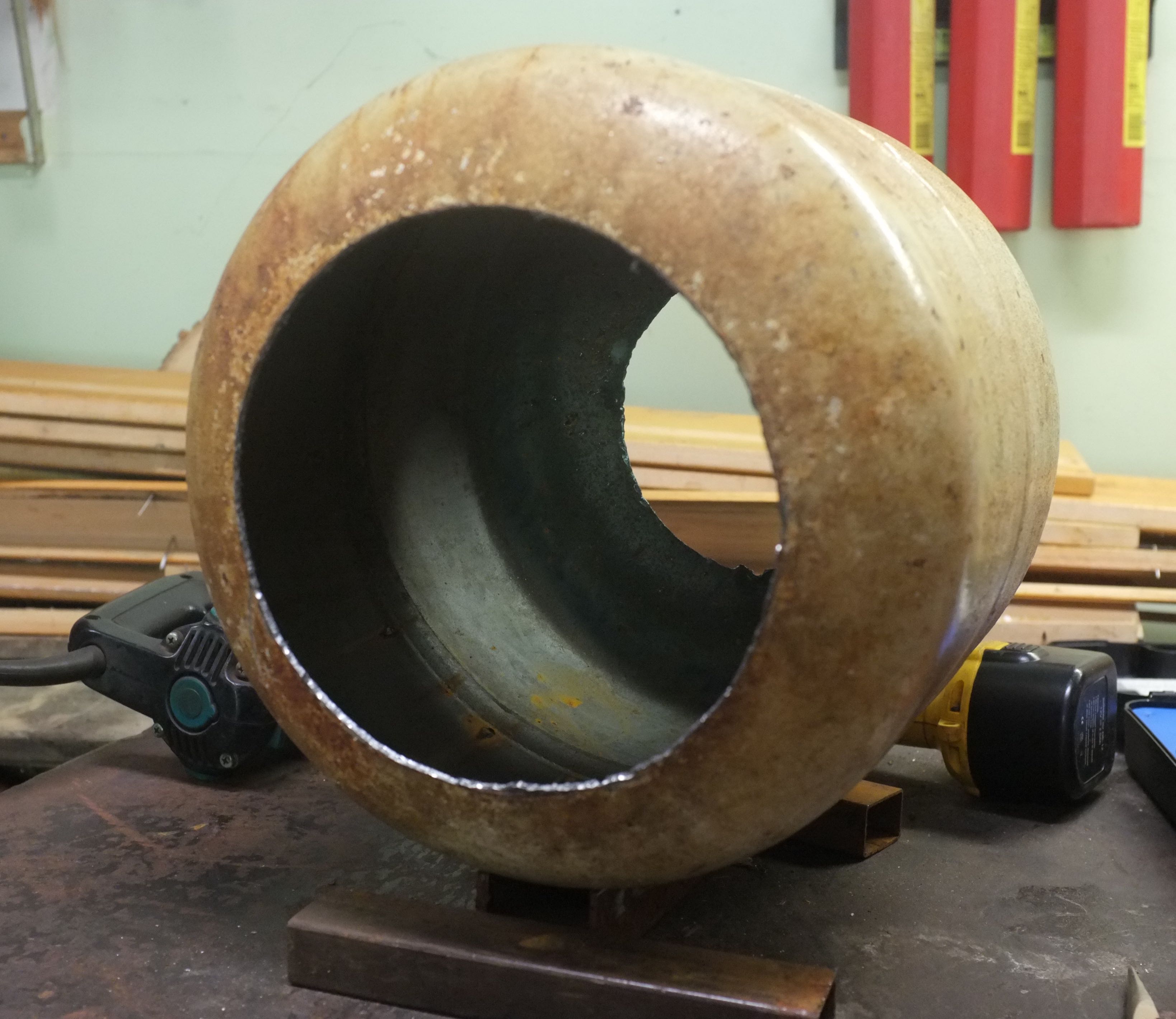

I want to make a new forge that will be efficient, borax resistant and will have a welding temp.
The body will be made with a 20# propane tank. The insulation will be 2 inches of wool, Kast-O-Lite and Metrikote. Thank you Wayne for the good advice.  The front and back opening will be closed by insulated brick.

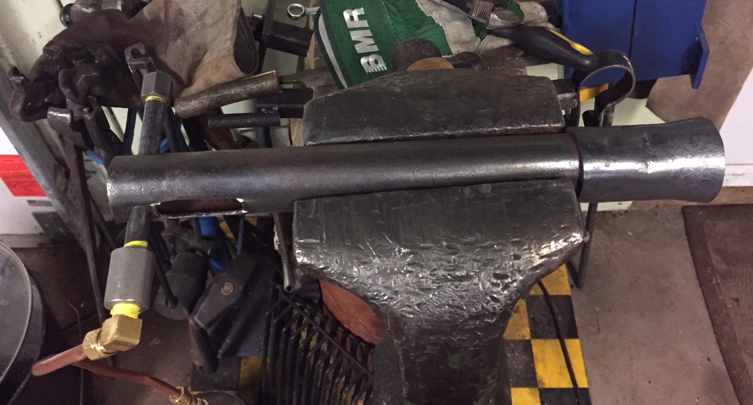

I want to use my Oliver burners, see the thread : https://www.iforgeiron.com/topic/51613-oliver-upwind-burner/
The small ones are ¾ inch while the big ones are 1¼ inch

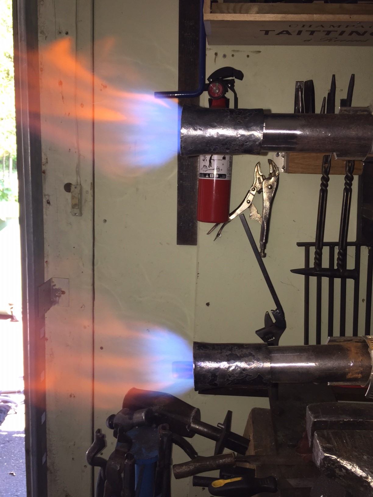

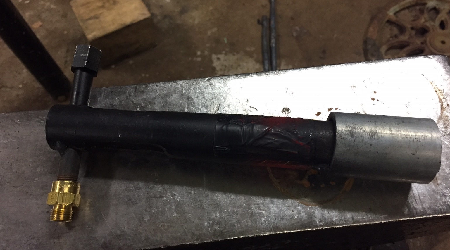

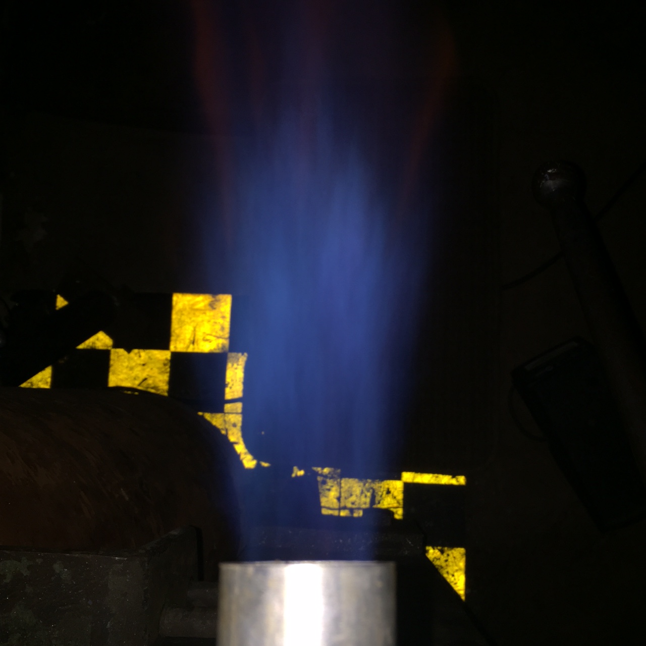

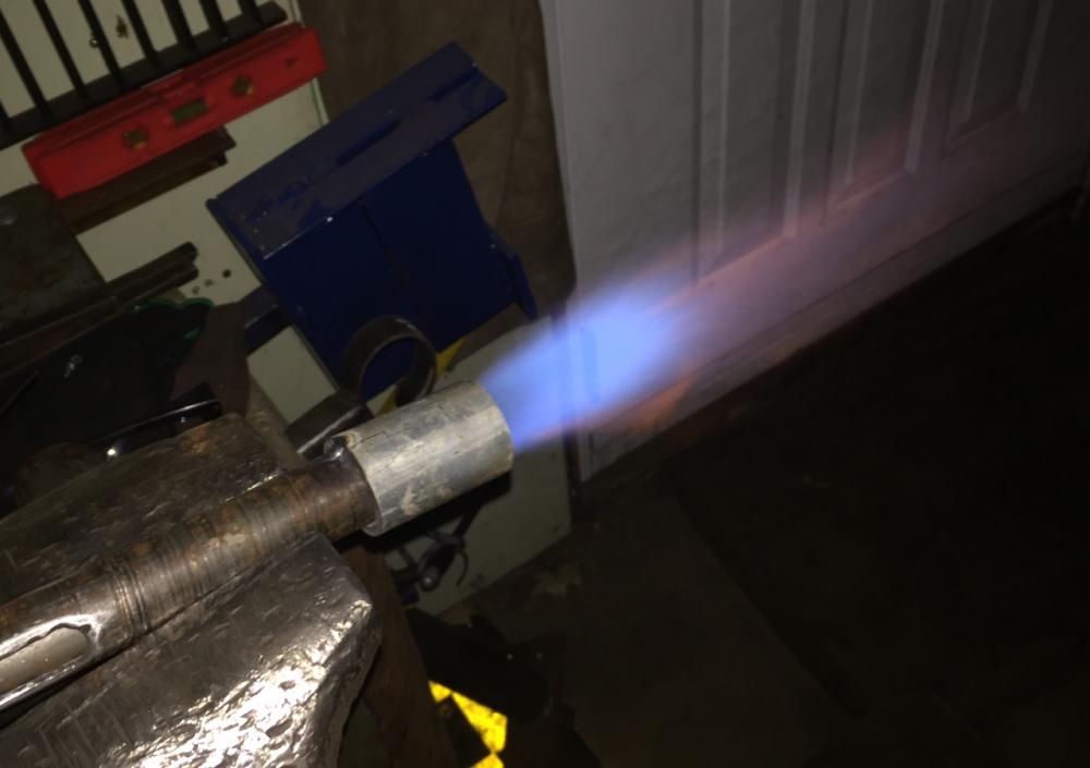

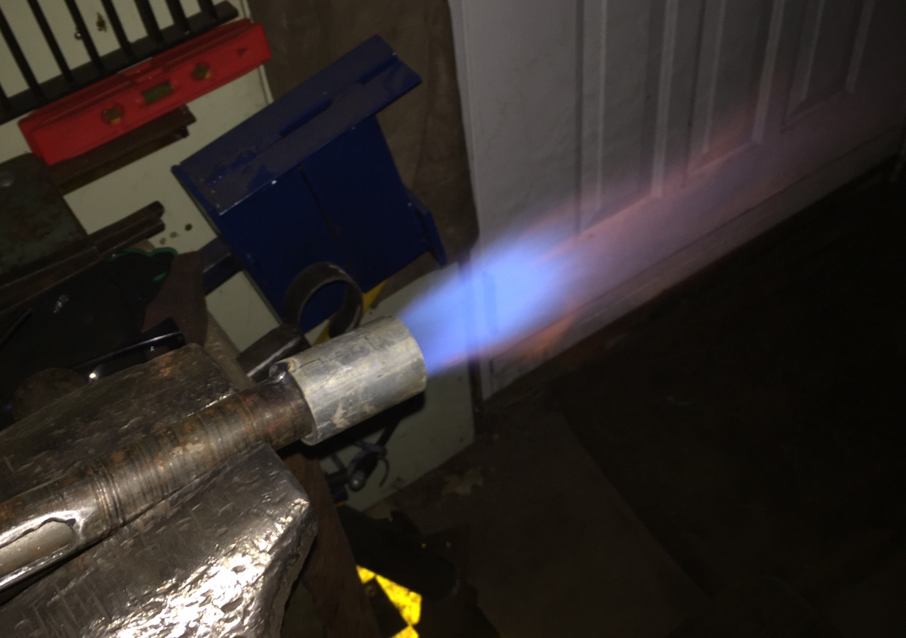

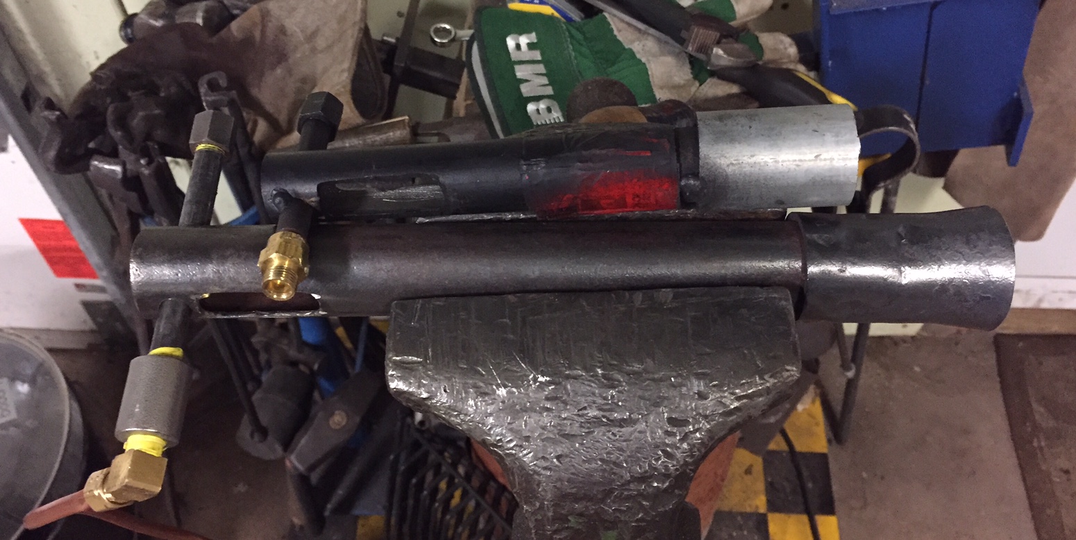

Here are the pictures of the burners and their flame
The small one :
IMG_2250.thumb.JPG.d96190d58c5cb347b68db8fdef9c73cd.JPGFullSizeRender.thumb.jpg.be367b1a3e0fbaa827fbf0c4d4520656.jpgIMG_2327.thumb.JPG.14facbcc52812e717da2a16fcd8ed1ec.JPG
The big one :
IMG_2249.thumb.JPG.4e807b508ed37948a73ff67557c9ff6c.JPGIMG_2283.thumb.JPG.dcf51cd266942f6cc5205216b5ec576c.JPG
Small vs. Big :
My question is what would be the best burner's set-up for that forge ? Should I put, 2 small, 1 big or 2 big ???
Sounds like you have the construction down pat. What's the interior volume? I'm not going to go out and measure a propane tank to do the math.
The 1 1/4" burner will be more than it needs but you can always turn it down. Two 3/4" burners should be enough but not knowing the internal volume I can't say for sure.
Between 480 and 560 cubic inches depending on the thickness of wool I want to put
The general rule of thumb is one each well tuned 3/4" burner for every 300-350 cu/in. Two 3/4" burners is overkill but within reason and will make for even heat throughout the chamber.
A 1 1/4" burner is about equivalent to four 3/4" burners and the flame would be concentrated in one spot. I'd call that unreasonable overkill.
And I agree; it is total overkill. One 3/4" burner, with that flame, should bring a forge, properly constructed from a five gallon (20 lb.) propane cylinder to yellow heat. If you wanted more even heat throughout, you would need two 1/2" size burners (of that potency).
Thanks Frosty.  That's what I was looping for
So, It'll be 2 x 3/4 ;)

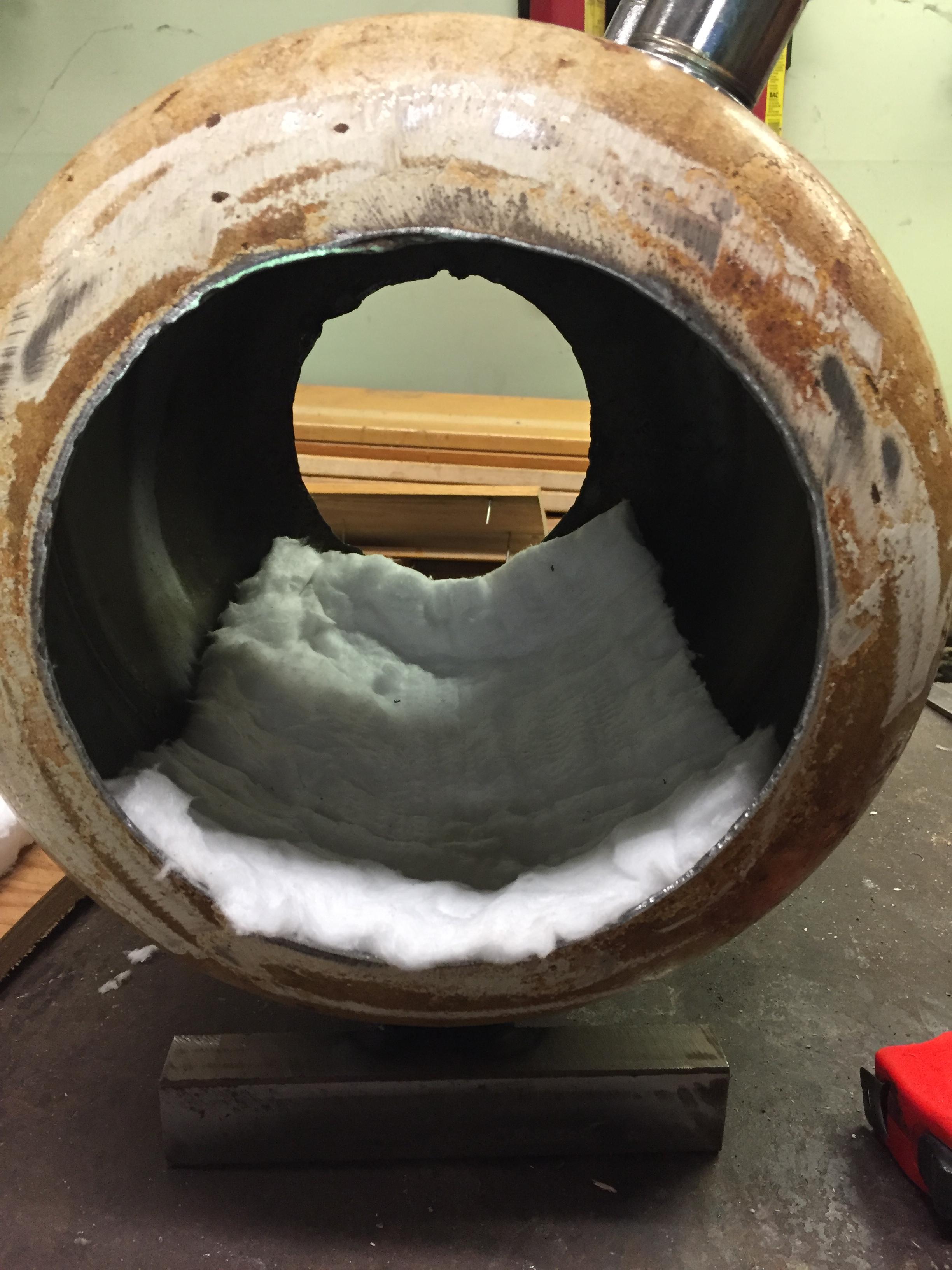

Refractory cement and infrared reflective paint have arrived. Tomorrow, holes for burner supports, wool installation and cement layer.IMG_2414.thumb.JPG.d138c21a2a5acfe590f18e95166030f2.JPG

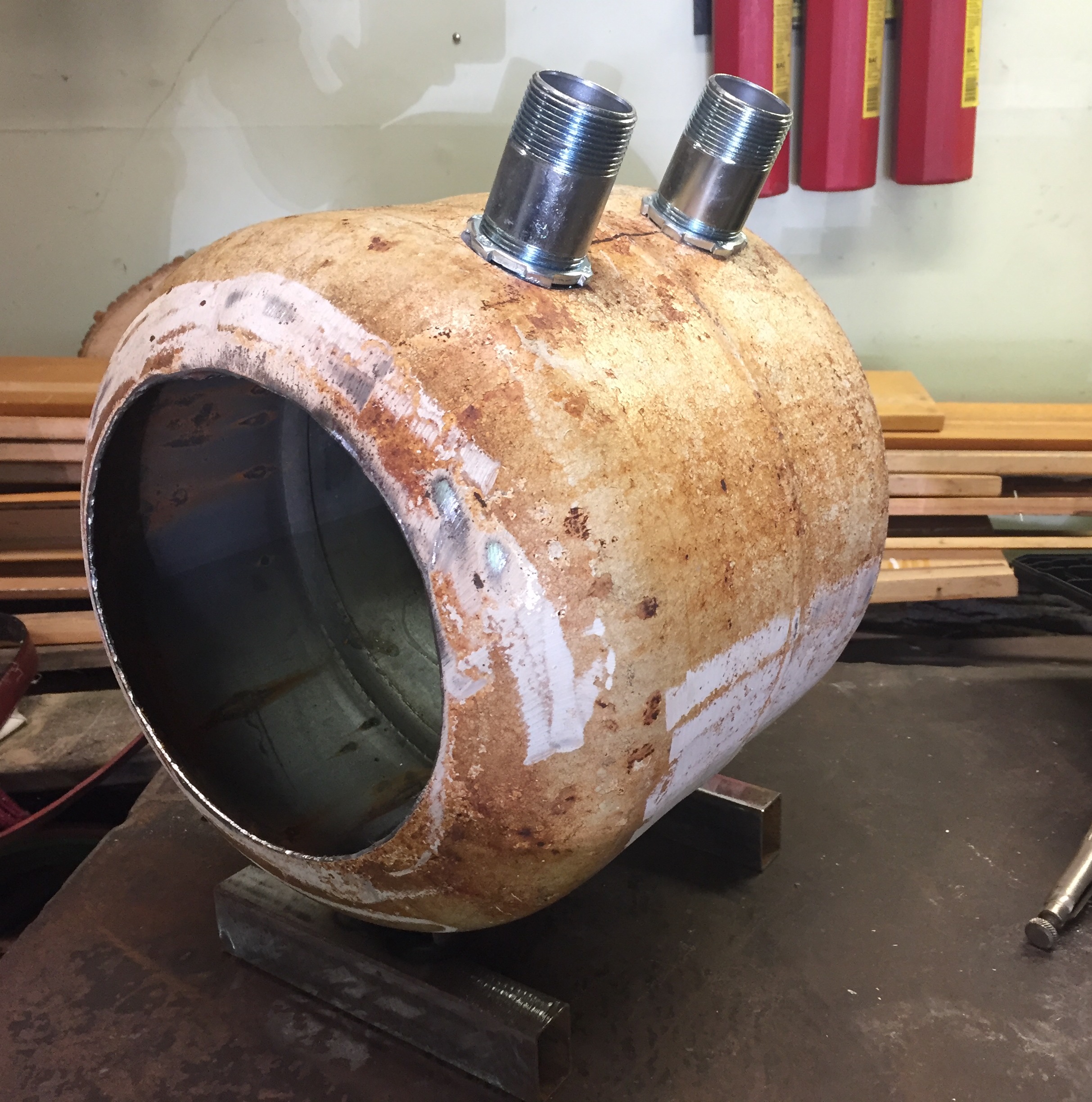

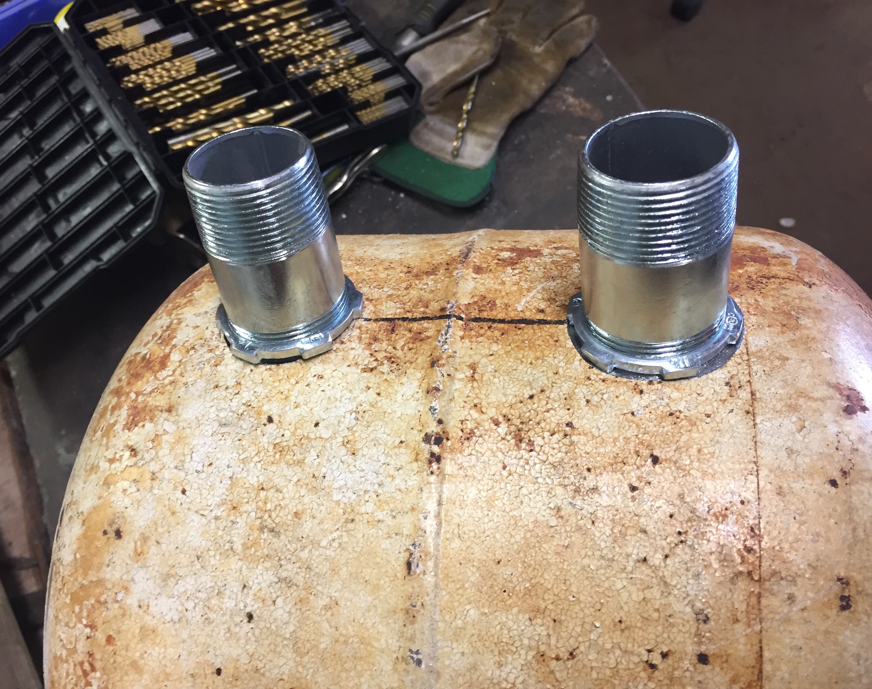

I only installed the burner ports. I use electric box nipple. To hold the burner, I take selftaping screw and once the hole drilled, I cut the tip and put the screw back. This holds everything in place.

Those burner holders are zinc plated.  Not likely a great idea there.  They may or may not get so hot that it causes problems but it's best to avoid the risk.  Strip the galv before the final assembly.  You don't want zinc poisoning sneaking up on you when you do some long hot forging.
Or I might be missing the point if they're just "placeholders" for something else later.
Don't worry, it will be :rolleyes:
Don't forget to rigiddize your insulation.  Cheap and easy

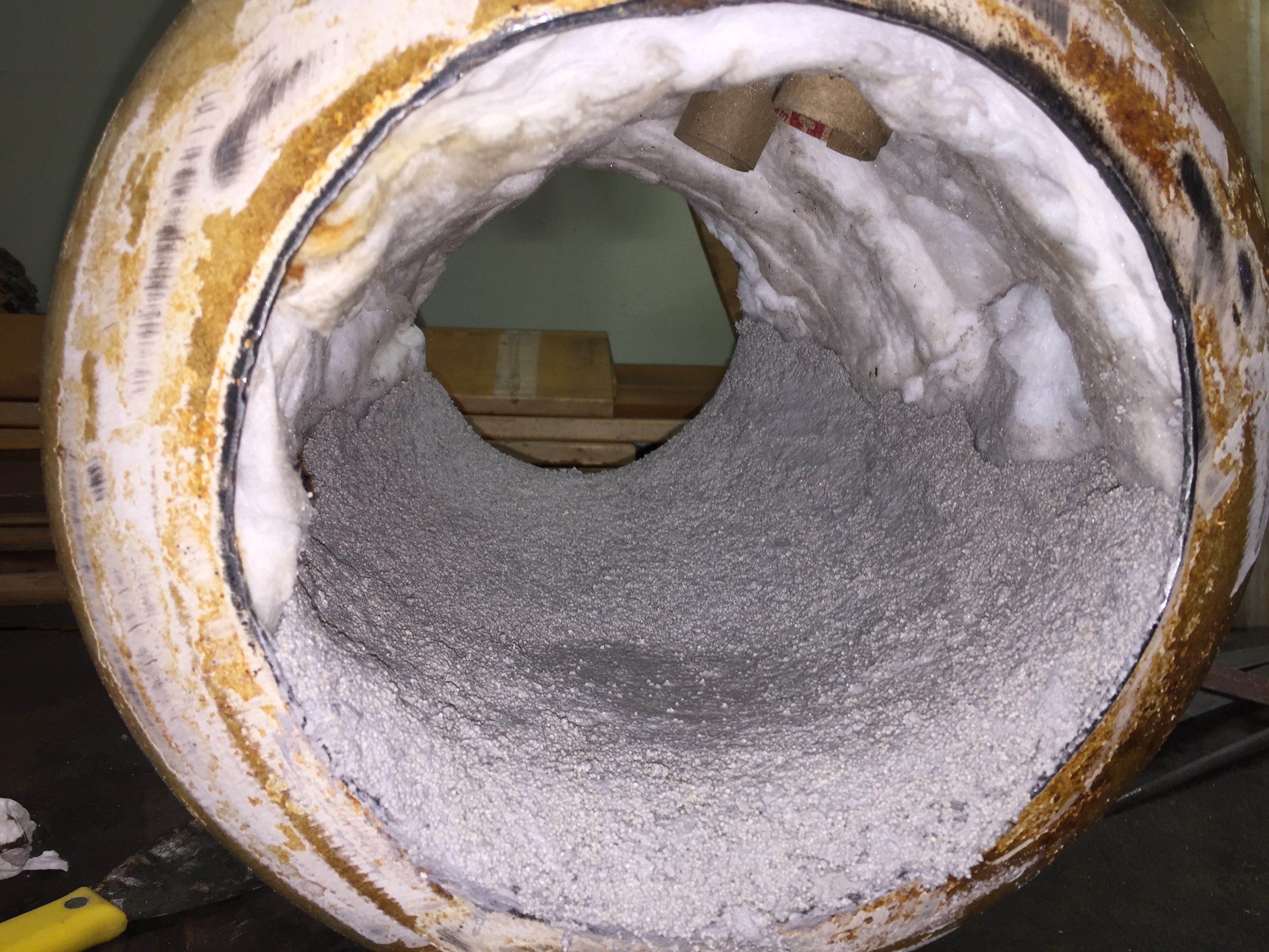

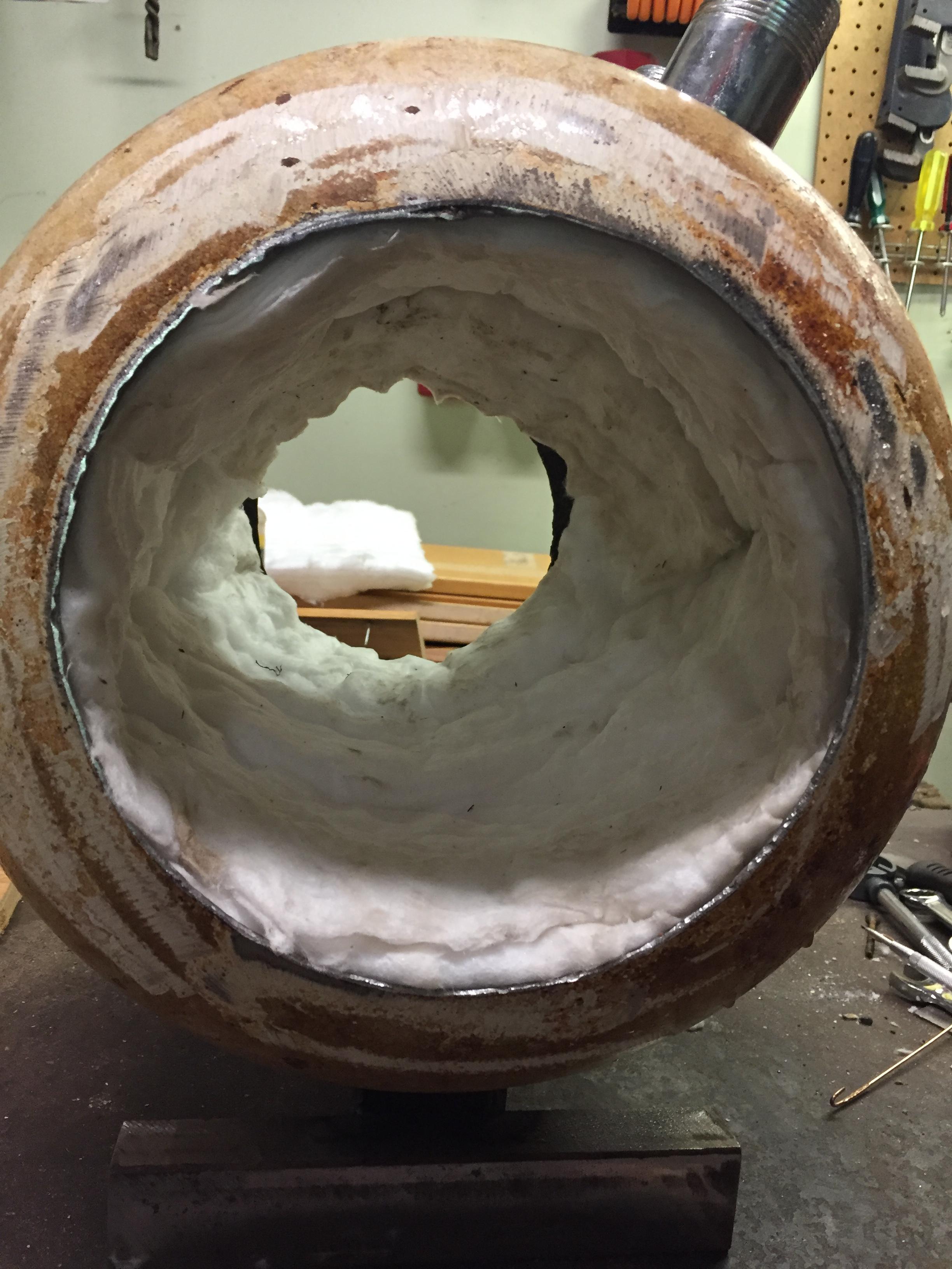

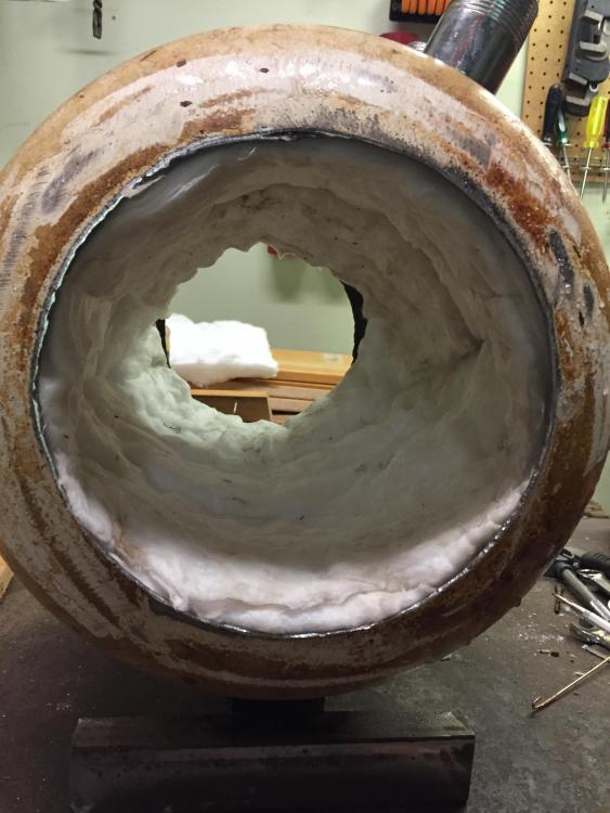

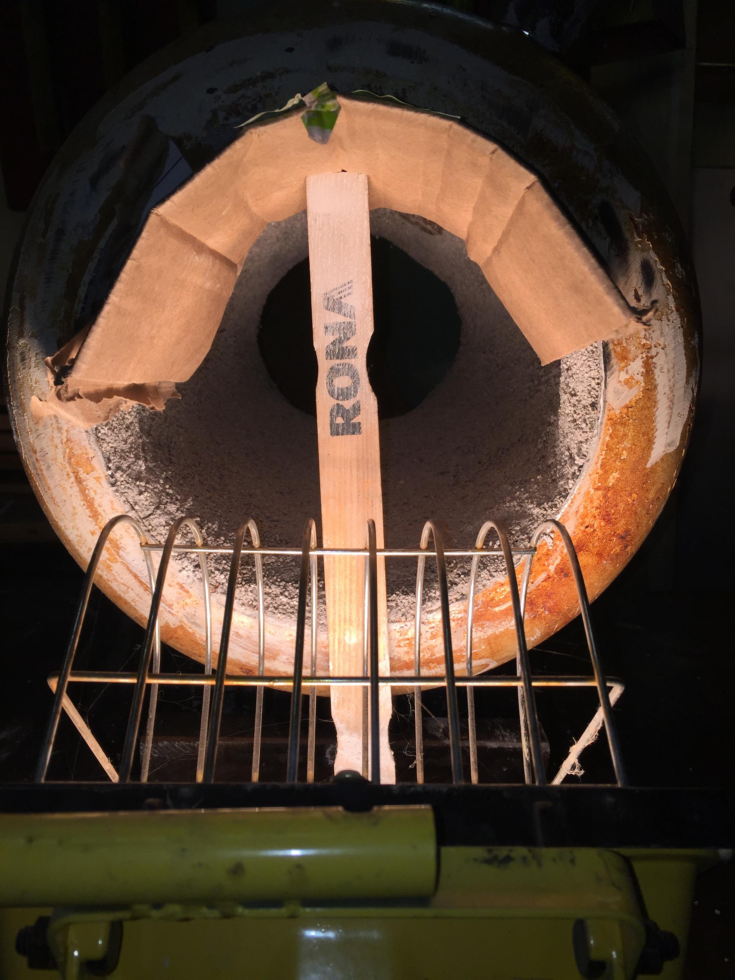

One more step done !  2 inches bottom + 2 inches all around.  Tomorrow : Kast-O-Lite !!! ;)59ab1336ed1d6_IMG_24382.thumb.JPG.837c5a553cb42daed5f01012b58e14c5.JPG59ab133b7dcb7_IMG_24392.thumb.JPG.8be0ad7efa6132e22beeabc65d335a62.JPG
I applied the Kast-O-Lite, it went well but I concluded that I should have done it on 2-3 days instead of the same day.
I should have done the third part of the bottom, wait until it is dry, turn a third, repeat for a third and finish the last third.
To think that it is quite dry and to continue quickly is a mistake IMHO.
My result looks OK, but the next one will be done with the sequence of thirds.

As you can see trying to roll 2" thick blanket makes large wrinkles, 2 layers of 1" are smoother, easier and easier to rebuild down the road. Rushing is almost always a mistake. I screwed up  my last forge by laying the KastO-L-ite floor and not waiting long enough to flip it over and line the roof. The floor in that forge bulges enough I can't make partitions to size it so it's 2x larger than I need for 90% of what I do.
