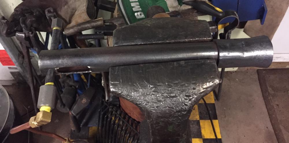

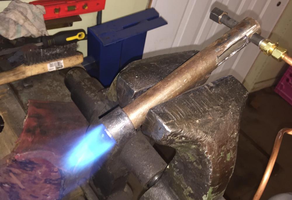

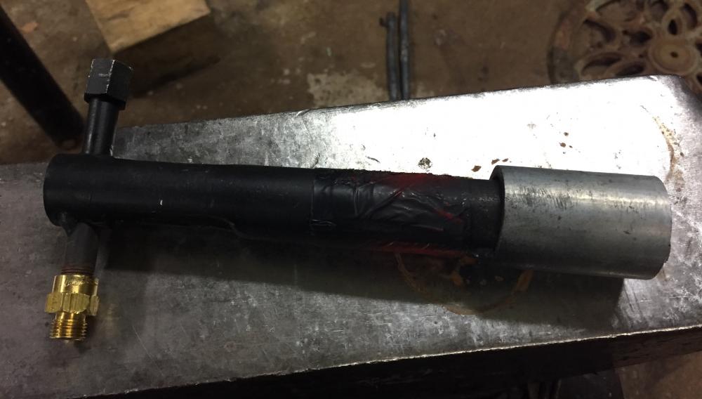

I really enjoy making burner. I did the «Oliver Upwind» but I opened the holes along the length.
I also added a sliding choke (not on the picture) but it is useless since I do not need to do any air restriction.
The only adjustment remains the flare.
Since i took the picture I filed the slots for a better look.  The jet is a no.60 hole.

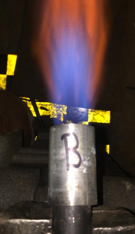

upwindburner1.thumb.jpg.563d4dd7f89642d9cadf7c53a916ee74.jpgupwindburner2.thumb.jpg.b4070c12743e18a96266f16934b1f0b8.jpgupwind1-flame.thumb.jpg.e2fc58a75c7a8d22c51664a091bb6356.jpg

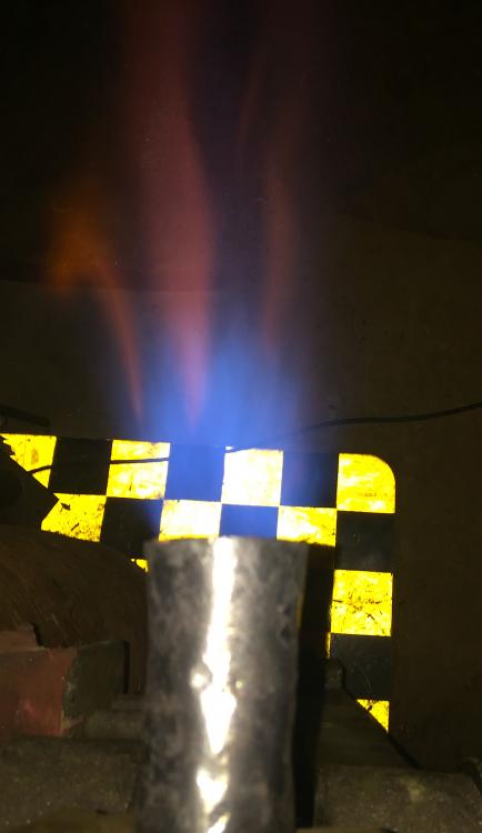

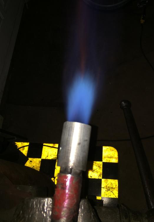

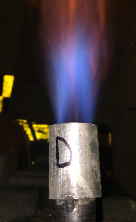

The third photo show an acceptable flame for use in a forge; it is a neutral flame, with an acceptably small secondary flame.
Thanks Mike, I am beginning to be able to identify an adequate flame through your good advice. :ph34r:
I am a notorious perfectionist picky butt. And Burners 101 needs to be saved from my druthers. Workable burners are the goal; that is one. I would be pleased to see it on that thread :D

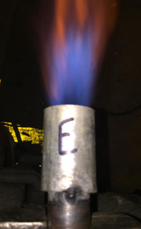

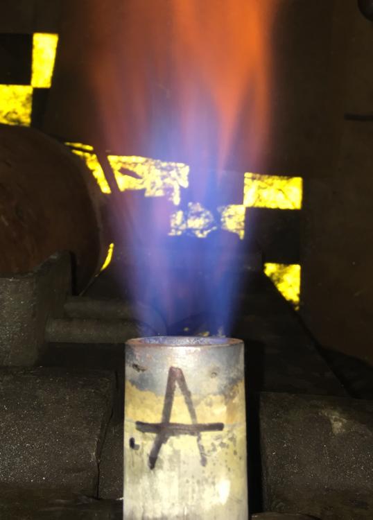

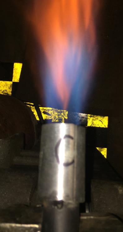

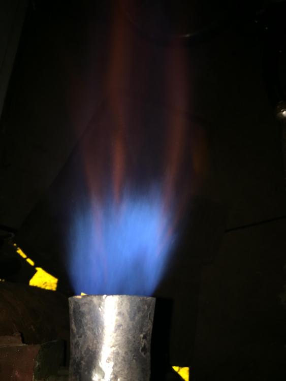

I changed the flare... a simple 1inch pipe x 2 inches long.  The flame style good !  This one is ready. :rolleyes:
Yes, that is a nuetral 100 % primary combustion single flame envelope, It reminds me of the flames from my early Mikey burners.
Congratulations, that is a whole lot of flame perfection, considering the design you wore working from.
Yeah, your burner gets TWO gold stars! Well done, you have that baby tuned to a fare thee well.
I would sure appreciate those flame pictures, and a write up of the changes you made to get from one to the others, on the Burner 101 thread.
Otherwise, they become much harder for people to see at the end of the month, when they will join all the other old files. I want people to see that they don't need a perfect burner design to end up with a great flame. Also they make a fine example of how much, some tweaks in a finished burner can radically change its flame. I can post perfect flames coming out of perfect burners forever, without doing as much good for people who are struggling with tuning problems, as your photos can.
Done !
thank you again for posting this series of flames someplace where people can benefit from them over time.
...now, k If you can somehow be sweet talked into writing up an account of your burner build, my day will be complete. If anyone disagrees with your choice of design or construction methods, let that flame shut their mouths; it certainly shut mine :D

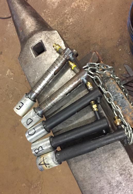

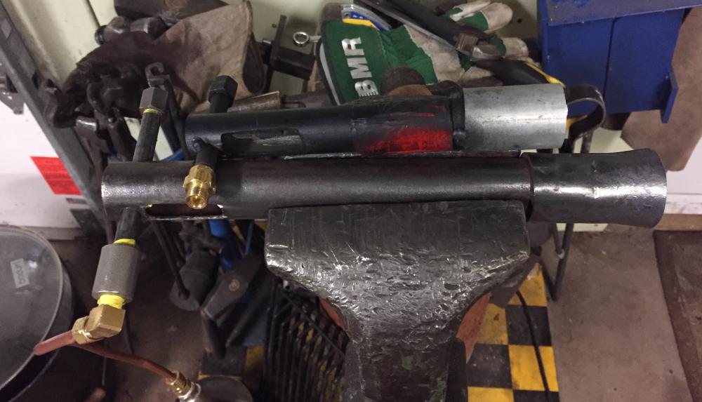

Bigger is better ?
This is the burner used for the flame posted in this thread.
I made a larger copy.
See the difference....  3/4 OD versus 1.25 OD
Flame produce by the big boy at 5-7 psi.
I have to rework the flare to clear the orange flame.
So ????  :huh:
By George I think you HAVE it!

Well, luck or not you have developed the knack of producing hot flames. As to the orange  streaks; my belief is that they are from oxidation of the flame nozzle, which is why they are more severe with mild steel nozzles. In the past, guys have even found these streaks to be more pronounced  with #304 stainless nozzles than with #316; in any case they do no harm.

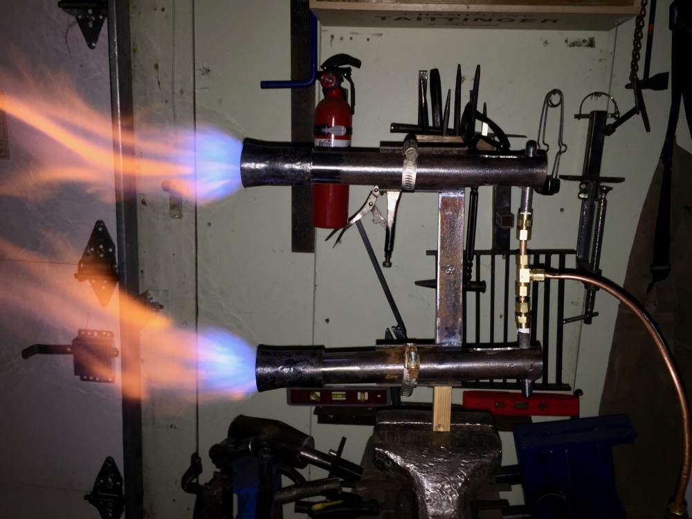

Yes the nozzles are mild steel...  Here a twin-setup of Monster Oliver !!! 59737ef4d6bb6_twinoliverupwind.thumb.jpg.8a699b935d1c89a0fc71baea5ca94d52.jpg
1.25 OD,12 inches long, running at 8-10 Psi
I note that your flame nozzles have a lot more than the recommended taper; and if this has anything to do with those very hot flames, the rest of us may have to rethink what we think we know on this subject!
Those are a lot closer to 1:12 than the bell reducers you see used successfully on burners. I have to assume the burner can either be tuned to take advantage of that kind of turbulence or has other benefits than we normally use flared nozzles for. Say slowing the flame velocity quickly but outside the burner so it doesn't effect induction adversely.
I'm always rethinking these things, especially when I see so many successful examples that fly in the face of my rules of thumb.

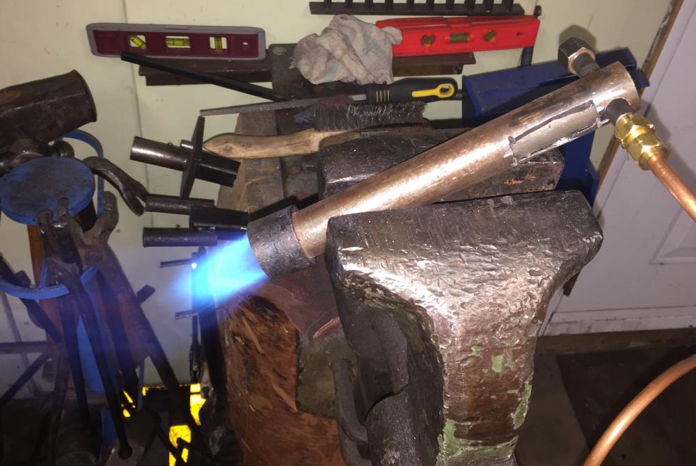

I made a small production of burners and like our children, there are not 2 of them identical.
It would take a lot of file work to fine tune them all similar to one another, but I do not think that the result is worth the work.
