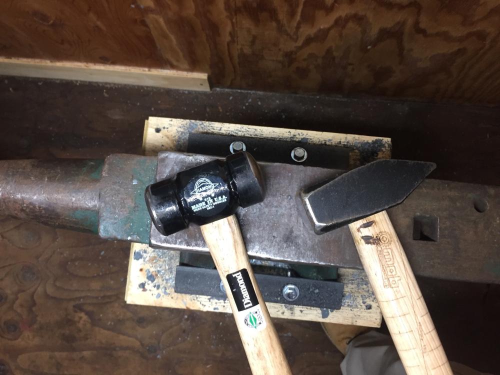

Total beginner, just finished my first forging session.  Pretty happy with the results, but what a humbling experience it was.  Forged the hook first, then the s hook out of 3/8 square....probably took me a little more than 2 hours to forge.  I don't think I was heating the metal up enough or was having to much surface contact with the anvil, was loosing my heat very quickly.  Also, had a xxxx of time trying to hold onto the piece doing the 2nd side with pliers, which marred up the metal, definitely have to work on coordination.  Any advice or critiques would be greatly appreciated.

Had 2 more 1-2 hour forging sessions this week, definitely more downs than ups.  Wanted to try a different hammer so I ordered a diamond rounding hammer spent about an hour dressing it, to decent shape.  Decided to put together the flat jaw quick tongs I got off ebay, so pounded out the reins, twisted the jaws....tried to thin and shape the jaws, was a complete failure, so just hot riveted and I guess no shame in finishing with the angle grinder.  So, then tried to forge a leaf key chain using the Brian Brazeal 2 sided taper with 1/2" square,  had a hard time moving the metal to form the far shoulder and realized too late that I didn't leave enough material for the leaf.  Continued on and the near side shoulder wasn't forming right then when trying to thin out in between, metal wasn't going anywhere, gave up when it started to twist.  Was starting to feel a little down, needed a win so decided to forge another hook, and came out beautiful, my taper was much better this time.

All good observations and advice so far. What I see in your piece is a normal beginner's mistake. A big part of hammer control is teaching your reflexes (muscle memory) to strike the same place every time and hold the work steady. The hammer marks on your work show you chasing the work with the hammer. This is normal, everybody does it in the beginning. You are swinging with your whole body, just like you were taught to swing a baseball bat, golf club, pick, sledge hammer, etc.Put your back into it! is the wrong thing to do at the anvil. Develop hammer control first, power comes later. Uncontrolled power is just damage in action.
Does that make sense? How to and tips follow.
Do NOT move your feet. Keep your elbows stuck to your side, same spot, do not move your arms around at ALL. Just a vertical swing, put a little snap into the blow with your wrist. As a health issue keep your thumb OFF the handle! We'll go into that later if you'd like to know the joint and soft tissue damage that CAN lead to.
Keeping your elbows against your side, your feet stuck to the floor and your shoulders immobile is called "indexing" this is a set position that allows consistent results. Rehearse your stance, mark it with chalk if necessary, it's THAT important. Position your holding and hammer hand before you put the piece in the fire so you don't stand there with the steel cooling while you think. Practice stepping away, learn where the MOST CONVENIENT place to lay your hammer. I like mine on the anvil with the handle pointed just off my right hip and the face I want to use pointed away. I can swing into position and it's right where my hand is. Remember, what works for you is what counts. Yes?
It sounds silly to practice blacksmithing with a cold forge but it works to rehearse your moves. Your work will lose heat FAST as soon as you draw it from the fire so you want to be ready to "Strike while the iron is HOT," it's not just a saying to us. ;)
In the interests of heat management and having HOT steel to hammer, Do NOT lay it on the anvil till you're ready to hit it! Position it by eye, just the briefest touch will align the impact face of the work you're hammering with the anvil face, same with a shoulder, if you have already marked it then it's easy to let the mark drop on the edge of the anvil. Just NO NOT lay it on the anvil while you grab your hammer and think about what you want to do!
Ideally you can leave your right foot in position at your anvil, pivot to the forge and draw the work with your left hand, holding your hammer in your right hand. Pivot back into YOUR position, index the work on the anvil, moving your whole body, your elbows are glued to your side (remember?) and strike steel that's only been out of the fire for 3-4 seconds or less. Hmmm?
I know that's a lot to think about but rehearse it makes a big difference. I've been a hobbyist smith for a good 50 years, mostly self taught till the early '80s. It's not a good thing to go it alone, in fact it sucks. Side tracing again, sorry. The bolded text is just for emphasis, I'm not shouting, it's just important enough to remember.
