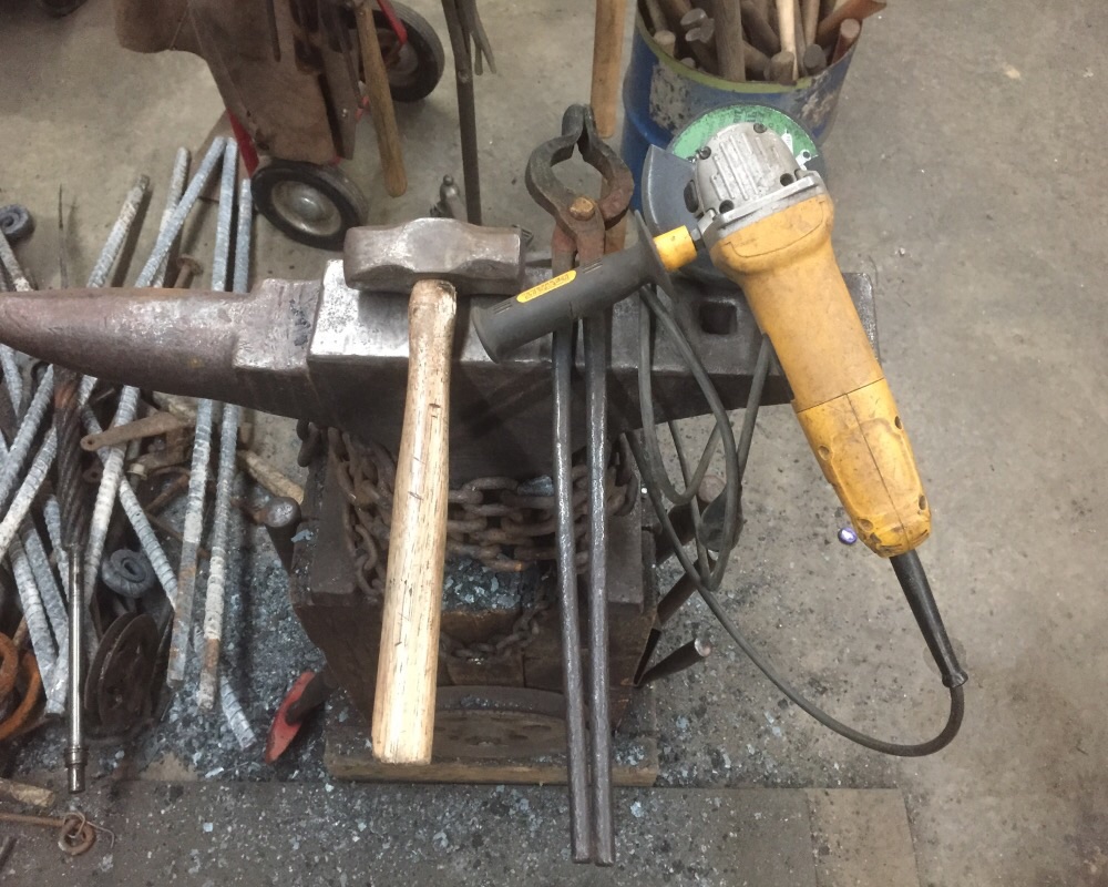

Here is it in visual. 3lb because it is my go to usually. ( good inbetween for me)  1/2" bolt tongs (because I use them often and could modify them if I needed), and 4 1/2" grinder because of many reasons in versatility of use. ( I can find many different wheels for on it to accomplish my many needs)
that is just for your theoretical question. :) I'm a tool junky.
I would have chosen V-bit jaws on the bolt jaw tong, just because that way they can hold more than the round jaws can. I'm surprised you even allow rebar in your shop besides the rebar in the concrete floor.:huh:

Good point on the tongs LBS. I was going with what I have so far and use  don't let the rust fool ya
