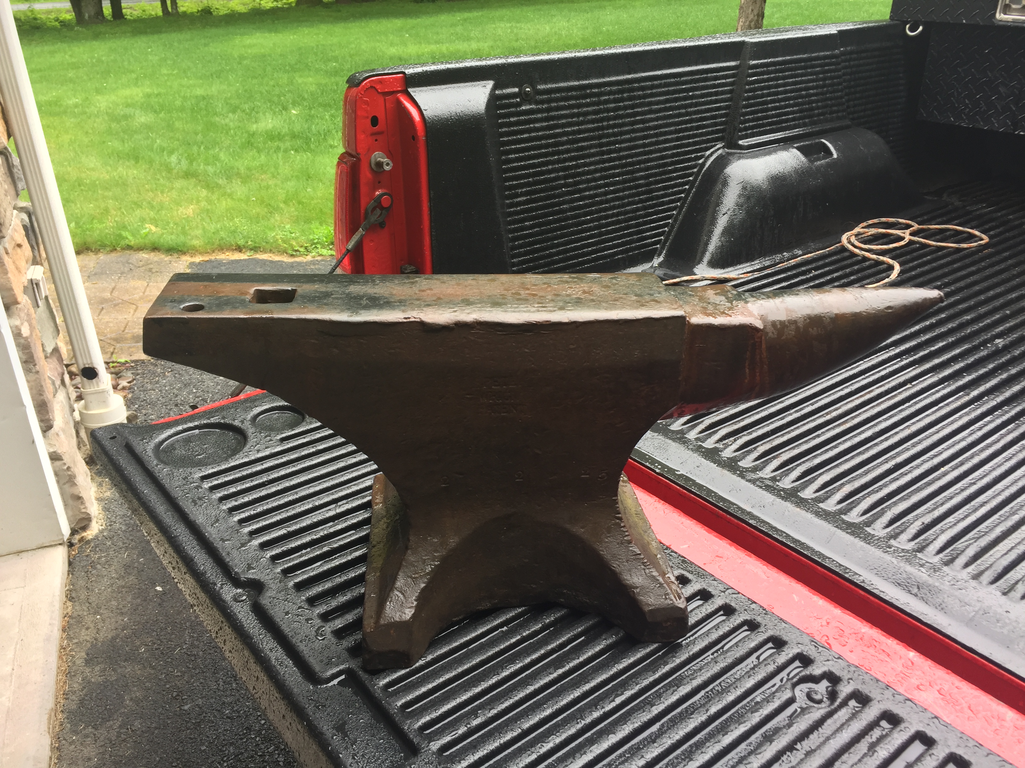

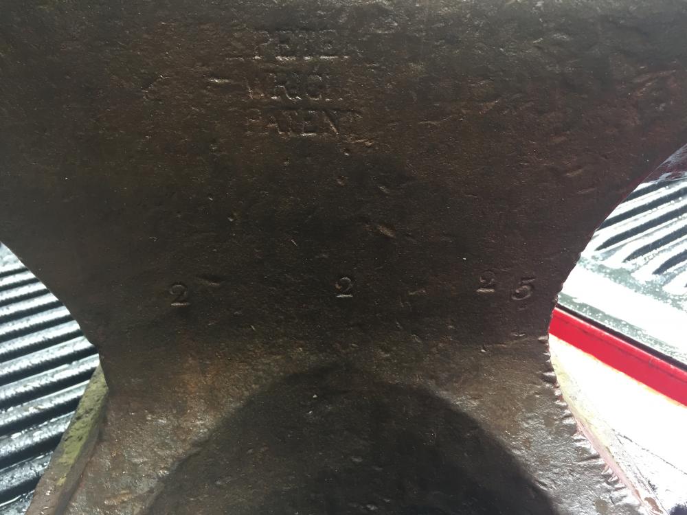

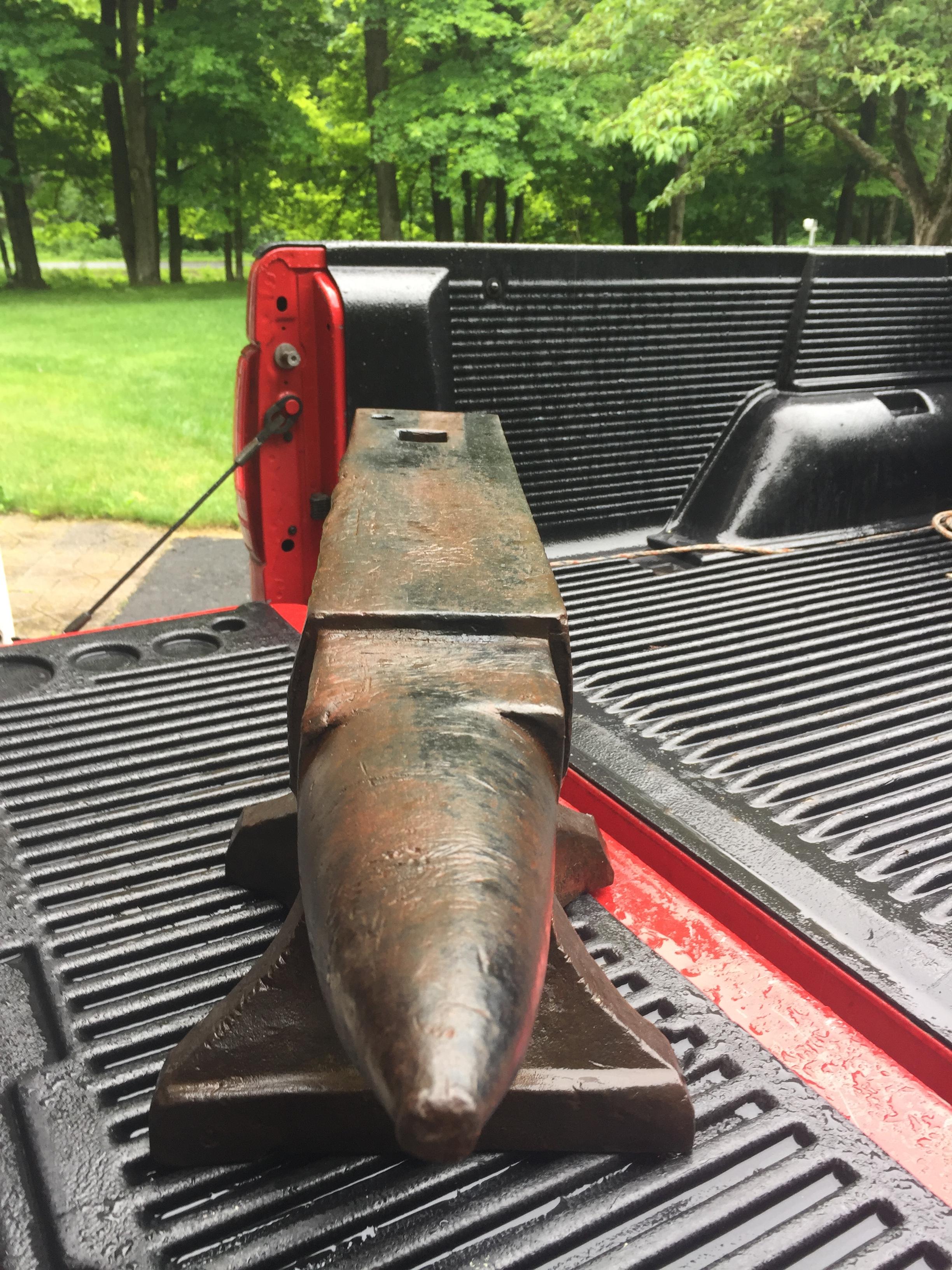

Found a 305 lb PW today

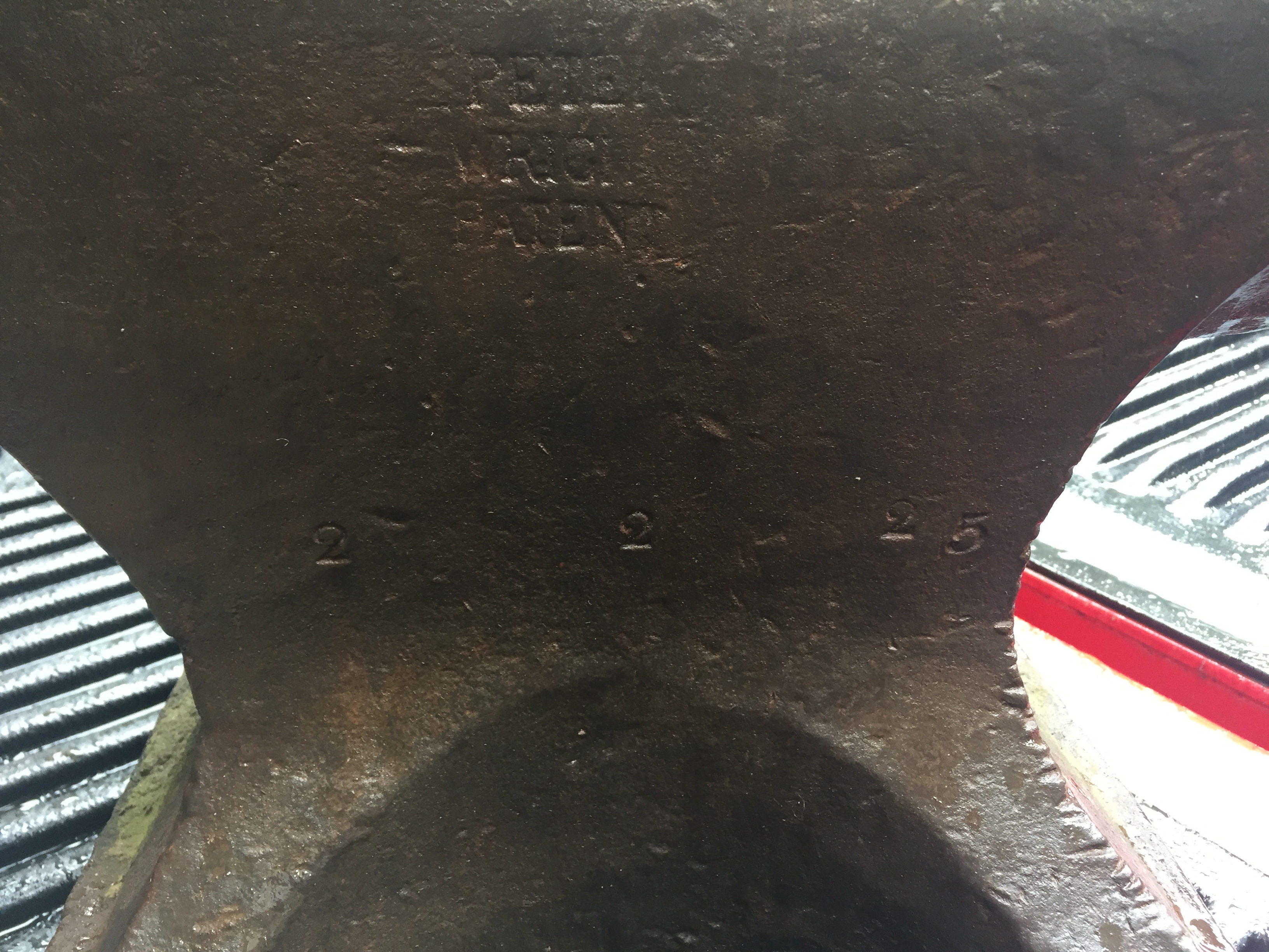

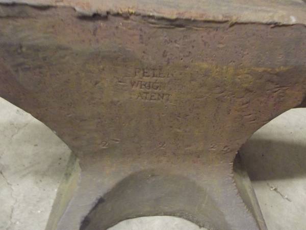

I'm in PA this weekend visiting family and decided to take a look on the local Craigslist...this PW was only 10 miles away, so I contacted the seller and picked it up.  The pictures aren't great because it was raining, but I'll take some when I get it home.  It's marked 2-2-25 and has a 9 on the left side of the front foot, but I can't see any other marks aside from Peter Wright Patent.  It has great rebound and ring, essentially no sway, and really just a bit of edge deformation that should be easy to clean up.
The seller said he got it years ago when he bought the entire contents of an auto repair shop nearby that had been in business for decades....pretty cool.
It has rested long enough. Take it home and put it to work. Congratulations.
Remember the deal included free shipping. Tie that thing down against the headboard of the truck bed real well before you get out on the road.

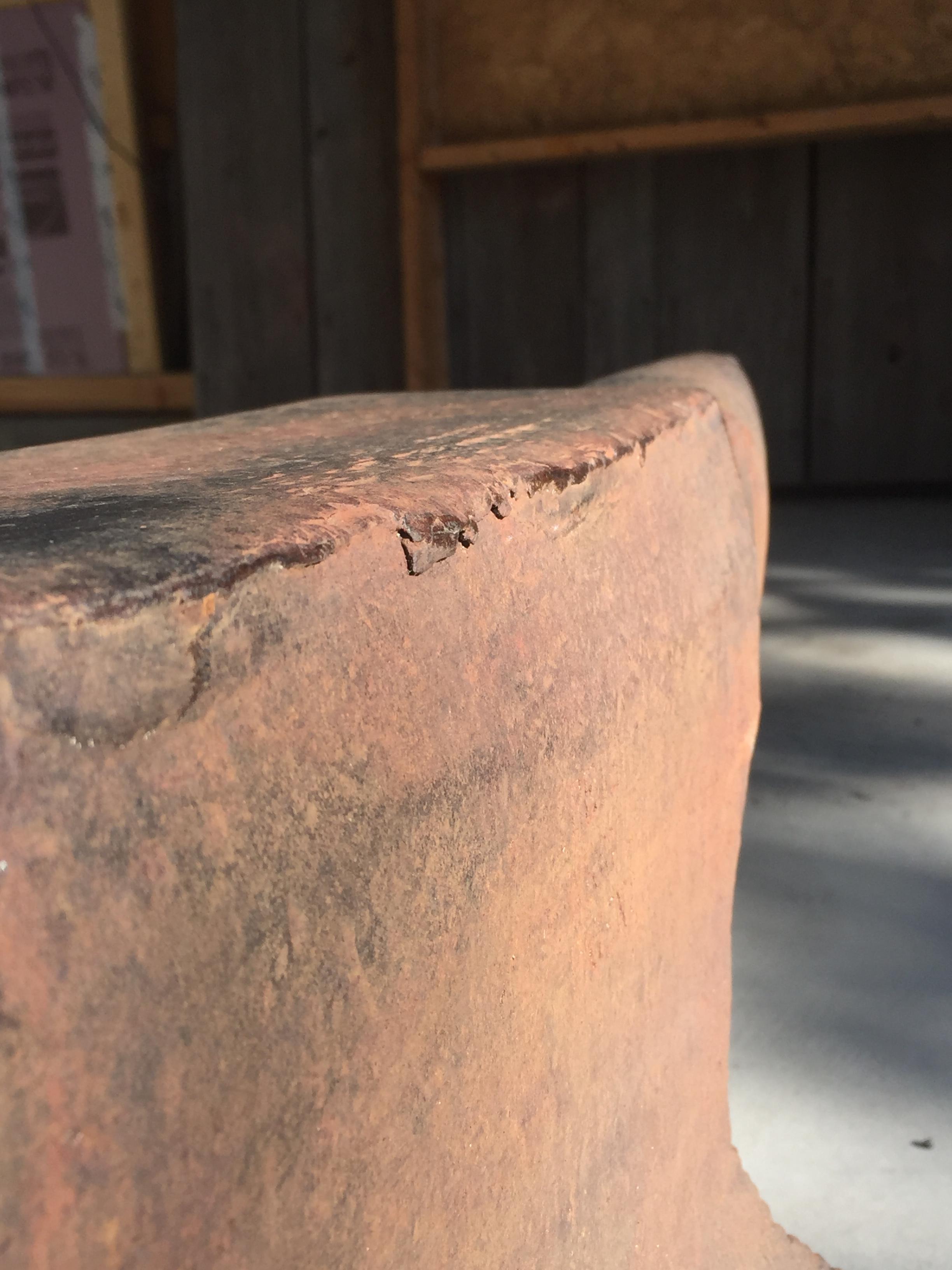

I don't see anything on the edge that needs cleaning up.  What do you intend to do to "clean it up"?
The pictures don't show it well, but there's some mushrooming on the edge that caused a couple of jagged, sharp edges.  I was just thinking of getting rid of the sharp edges so I don't slice myself open.
Yeah buddy! Great haul!  I'm with you on cleaning up the mushrooming. As I'm sure you know, just be sure to go slow and don't take too much off. At most just take off enough to bring that deformed area back to square with the body, if possible and if not round off the sharp edges that are liable to chip off. I use a rather worn out flap disk when I've got to do it.

Excellent just the way she is. I wouldn't do anything to her except hit hot metal to keep her happy. Good score by the way. Just to be nosy, how much did you get set back for her?
I don't plan to do anything other than the slightest touchup where the mushrooming left a jagged edge.  I'll post a picture of the area when I get it home in good light.
I paid $900...pretty happy with that!

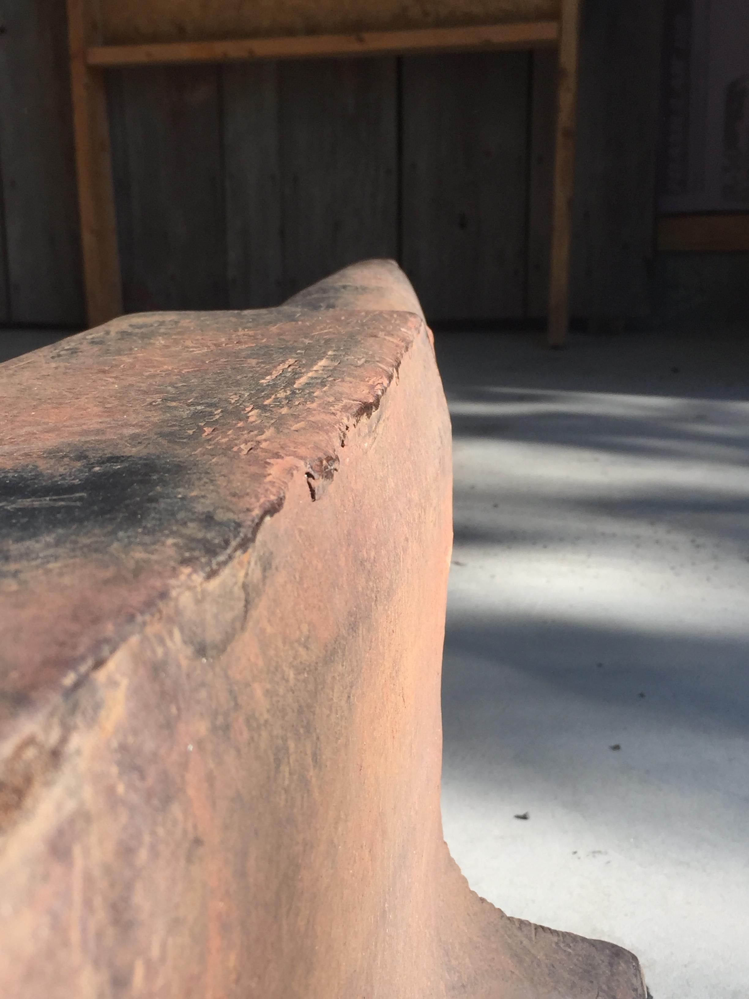

OK but remember that sharp edges tend to leave cold shuts in the work pieces and rounded edges to work better.
I have a 125 year old smithing book that basically says: is anyone stupid enough to think an anvil should have sharp edges?
Of course they were using real wrought iron which suffers even more from this problem...

I guess broken it would be a better description. I mean one that the edge is rounded and isn't going to take off too much material at a time. It's pretty easy to take off more than you want or grind in a groove with a brand new 80 grit flap disk.
Really, it's not about the disk. It's more about being careful and not going overboard. As often is done here, this information is not necessarily directed at Bart but to anyone else reading this who might be new to smithing and think they need to do a lot of clean up/grinding on their newly purchased, previously owned anvil. As you all know, not all grinding is bad but it could be easy for someone who's never had an anvil before to get carried away trying to "bring this anvil back to life". I've often read the suggestion that people should spend a year getting to know their anvil before doing any sort of modification and I agree with this. But a little bit of work on an anvil like this is more of a safety issue and any grinding on an anvil should be done with care lest more damage be done than good. That's why I suggested a worn out, broken in or less aggressive disk.
I think its a good idea to remove the rag forming on the side. I have found that it will eventually lead to spalling, taking a chunk with it. So as with the struck end of tools, keep it dressed and avoid those issues.

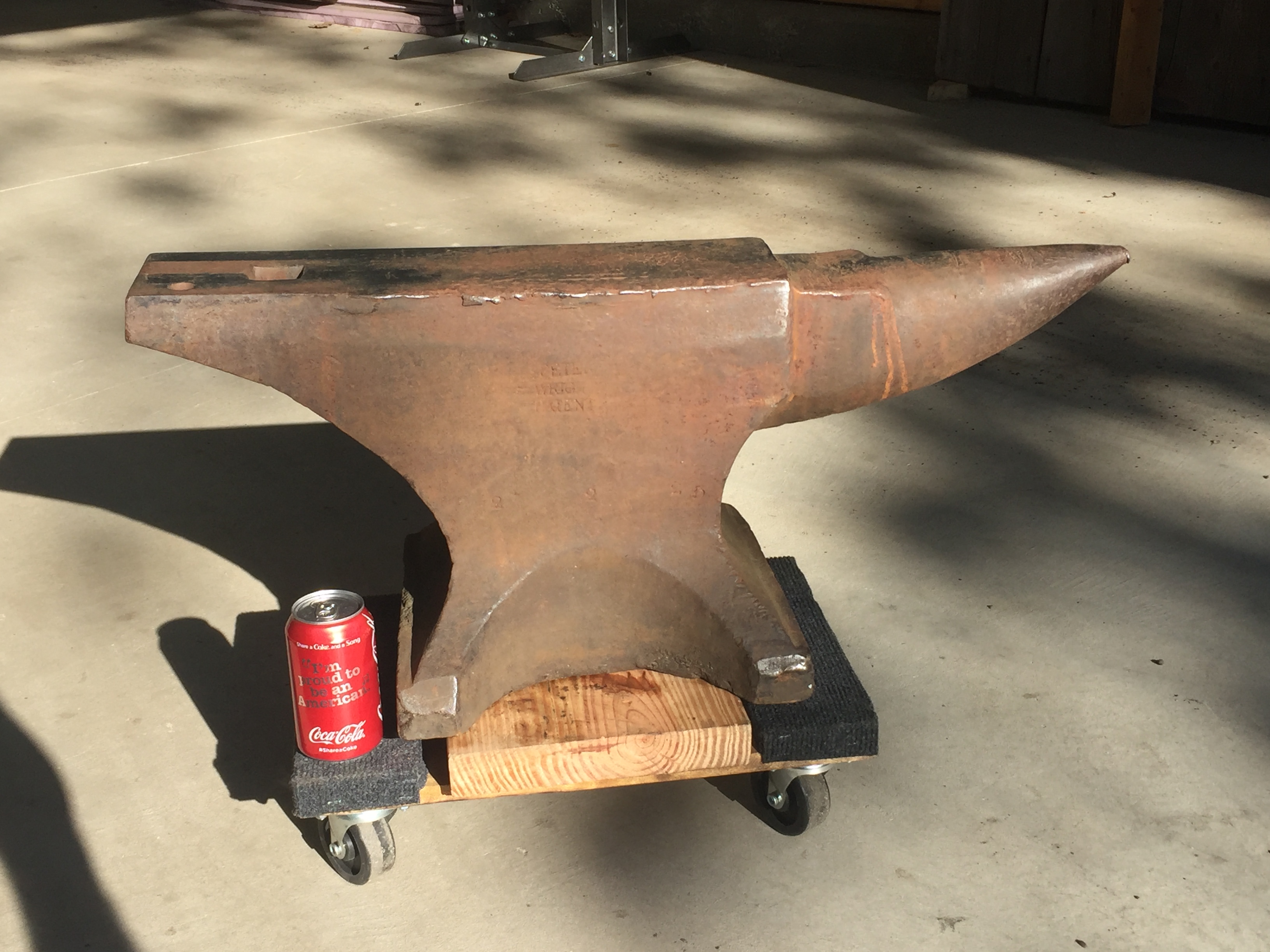

Got home and took a couple of better pics.  All I was considering doing was to remove the jagged parts to leave a rounded edge that wouldn't be likely to chip.
I tested the rebound again after unloading it and it's got to be at least 85%....barely have to move your hand to catch the ball bearing.
