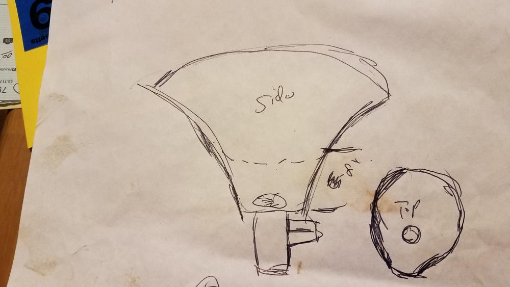

I knew a knife smith who was actually quite good.. He only used Anthricite coal as he could just go to any of the local (walking distance) hardware stores and buy a 50lbs bag for cheap money.. He forged strictly with hard coal and it made all sorts of really top notch knives and swords..
Anyhow, he gave me a few pointers.. His forge was cement lined and it had an electric blower with a slide choke on the side.. To start it he would start it with wood and then pile the fuel on.. He used nut coal..  The secret was a very deep fire (firepot 8") and a funnel shaped affair.. He would pile the coal on till it was about 12 or 15" deep an throw the air to it..
The front was bent downwards like in the sketch and it was all filled with cement to create the firepot/bowl..  His forge looked like a used wheelbarrow he just hammered the side of it down to form the side lip.. Filled it with cement using salt water as a very dry mix..  The fire would get hot enough to melt the cement and even had pieces of what looked like glass where the cement had melted from the high temps.  Like a glass furnace..
Anyhow, I asked him about switching fuels or his expereinces with different fuels..   He laughed at me, took a puff of his cigarette, a drink of whisky and said " When you have come to the conclusion so many are doing it wrong..  It's time to start doing it right"..       Then added why would he want to use anything else? It's perfect, its cheap and I can carry a 50lbs on my bicycle..  Amen..
Last ton of smithing coal I bought would not fit on my bicycle.. and for the level of equipment I have  he had 2 hammers , the forge , one electic blower from a car heater, a set of 12volt batteries and a solar battery charger..   he eventually had AC electric brought to the area he called home the outside Indian tepee he used as a shop..   Was awesome..
