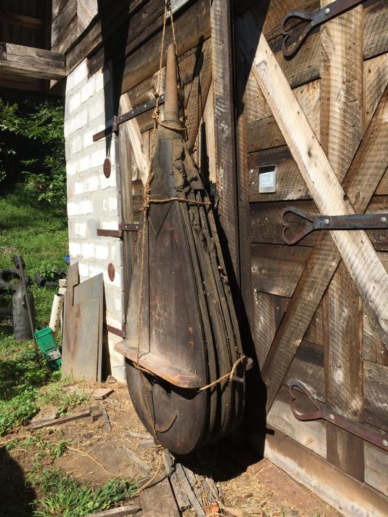

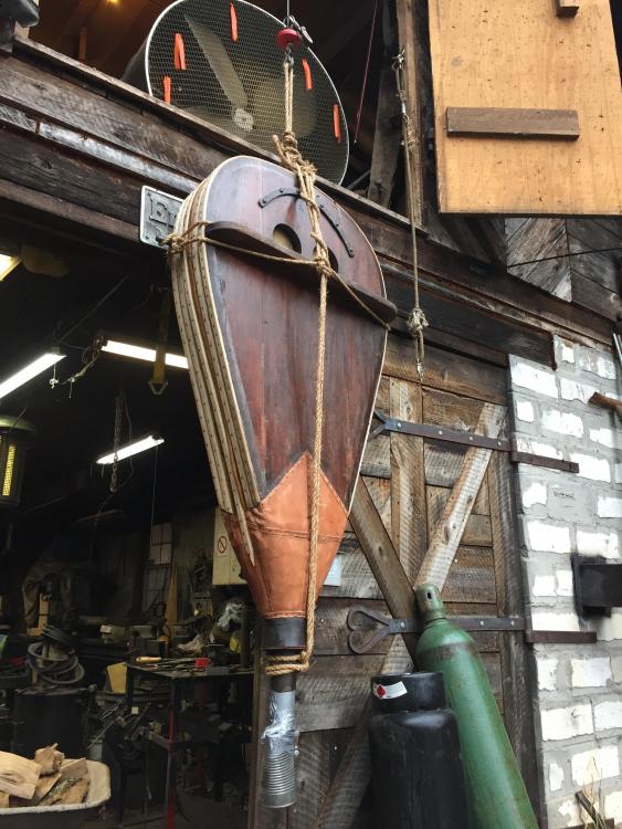

Antique bellows restoration begun
It may have been easier to make a new bellows. The center board and bottom paddle had succumbed to gravity over the years and bowed a bit under their own weight. I ended up making a metal ring I sealed to the center board so I could get a good level valve seal. The bottom board I planed level on valve surface. The leather on the old bellows was really heavy. I used a lot lighter weight leather on rebuild. I took a piece of the old leather and gave it several good scrubbings with saddle soap. After drying, I saturated it with neatsfoot oil and made a little belt pouch out of some of it. The bellows really works well. I can easily get welding heats. You also get some free run time as top paddle settles down after you pull. Gives you time to get tongs and hammer in hand. I also added a safety valve at outlet pipe. I made a box with a check valve so no gas could migrate back into bellows. Took a little figuring to get geometry right on my lever, as I had to mount bellows overhead to save floor space in my small shop. Cow horn makes a perfect handle on lever rope
Finally got back. Bellows completed and after some tweaking on valves, working great. Link removed as it needs access to your computer

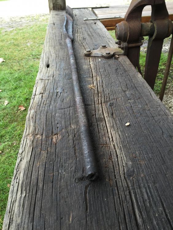

Why I love wrought iron
And the fact that it is much easier to forge weld than mild steel. Have to get used to working at higher heat, and there are different grades. Some strings apart like spaghetti and you have to continually weld up loose ends as you forge. Pictured is a gun barrel for flintlock rifle welded up from double layer of buggy tire. This iron wanted to weld and the two pieces would stick together in the fire while heating

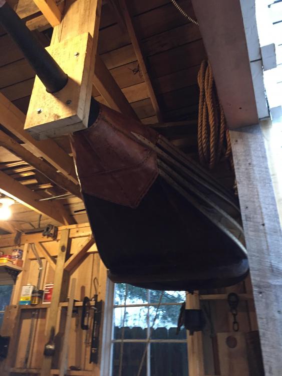

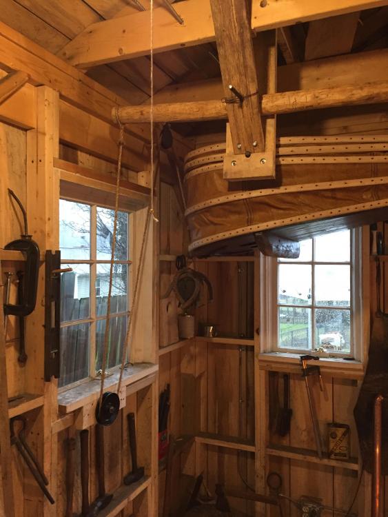

Bellows Installed
my shop is only 10 x 12
Bellows Installed
Bellows as they went in my friends shop over a year ago and as they came out yesterday. As they are mounted overhead in my shop ready for use
It has been interesting to get into it. It is in original condition and could find no evidence of previous repairs except for the 'factory' leather patch shown in the fourth photo that covered a place where a piece of the wood tore out on assembly revealing part of the feather that fit in the grooves holding them in alignment. You can see the original hide glue in the joints that is still sound in most places. Light cleaning reveals the outside was painted with a red paint of some kind. I had intended to give it plenty of linseed oil but a friend suggests using thinned out spar varnish particularly on the inside to give it some fireproofing. There was evidence of hot embers being drawn back in and burning some spots near the throat. The valves don't need replaced, just relined with new leather. One rib brace chewn through by mice will have to be replaced. The ribs look like oak, the center board and bottom yellow poplar.The top looks like pine and maybe chestnut? Hundreds and hundreds of cut nails and tacks pulled out! I don't know how you date one of these but my guess would be it is 100-150 years old. The spout is cast but the other iron work is all hand forged.
Finally got this project started. Disassembled and cleaning with some preliminary repairs. Fairly good condition but of course needs all new leather.
