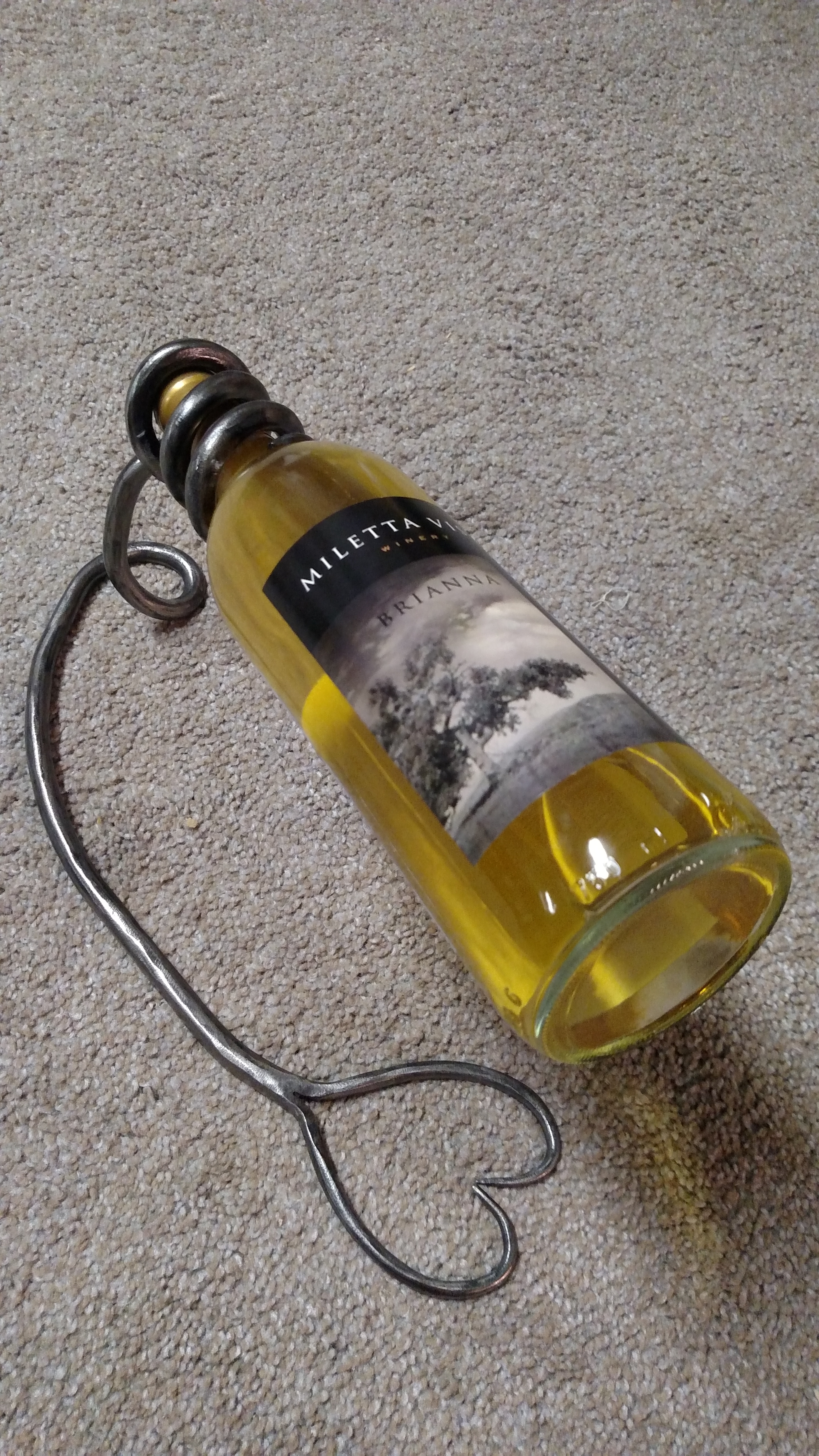

I've been following this topic from the beginning, and you guys put the flea in my ear. I had to make this, and I think it was inspired by Donniev's work :) But thank you all for this cool thread.
It isn't finished yet only out of the forge state.
But there is only a drop left!
 You are supposed to test it with a full bottle to see if it holds the weight, so buy two bottles next time. :D

And Gergely's got a big heart there. Very stable.

Gergely I like the bigger heart, as AUS pointed it looks stable. Actually it would be easier to make it stable as opposed to fighting it and taking 2 or more heats just to get it balanced nicely like I had to

Yeah it's stable - but just for sure's sake I go and buy an other bottle :)
I have a different concept in my mind, hope I can show you by the evening.
And it came as a surprise to me that the neck of wine bottles around here are 30mm/1 1/4" dia. That's exactly the same as my beer bottle opener holes. Mysterious, isn't it? :ph34r:

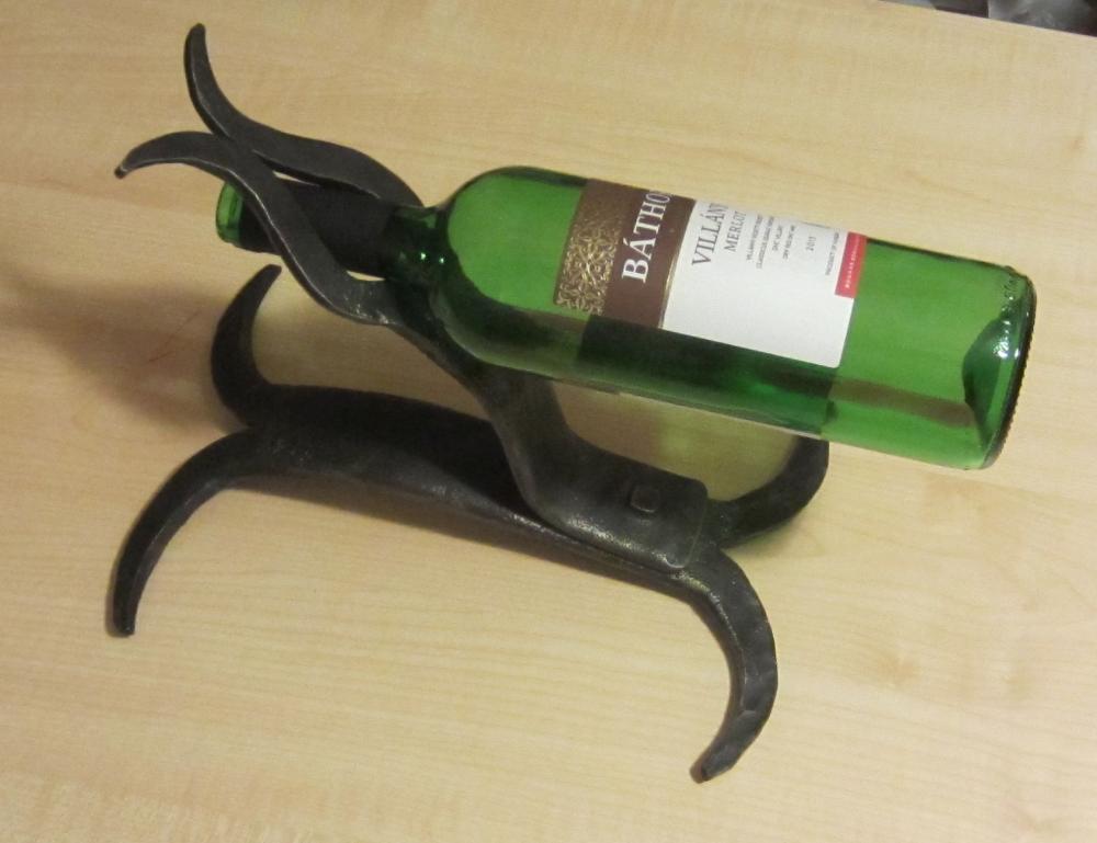

I did it, bring this out of my head today. Quite robust one I can say. 1 3/4" x 3/8" flat old iron tire stock, hot riveted together. Carnauba/beewax mix finish - first try with that.
And the original stock in front of the 3'/1m long anvil:
Gergely, that is really nice!
Tho. Now I have anvil envy.... :rolleyes:
That is a very elegant piece, Gergely. Good idea to rivet. Another one for my inspirations file.

That is not an imaginary anvil. at one meter long it's ... well ... very actual and concrete :)

I'm really happy to hear that, Aus! I've got so many ideas from you, at least I can reciprocate a bit.
One technical thing: I made the rivet from square stock. The holes are square, too. Does anyone know about any negative side effects when using square rivets?
Bests:
Gergely
I don't see any reason a square rivet wouldn't work perfectly as long as it is set properly. I used a square Mortise and tenon  in the horse shoe wine glass holder. (Wanted to test a square punch I made) Hmm... Less likely to twist... :) might just be better.
