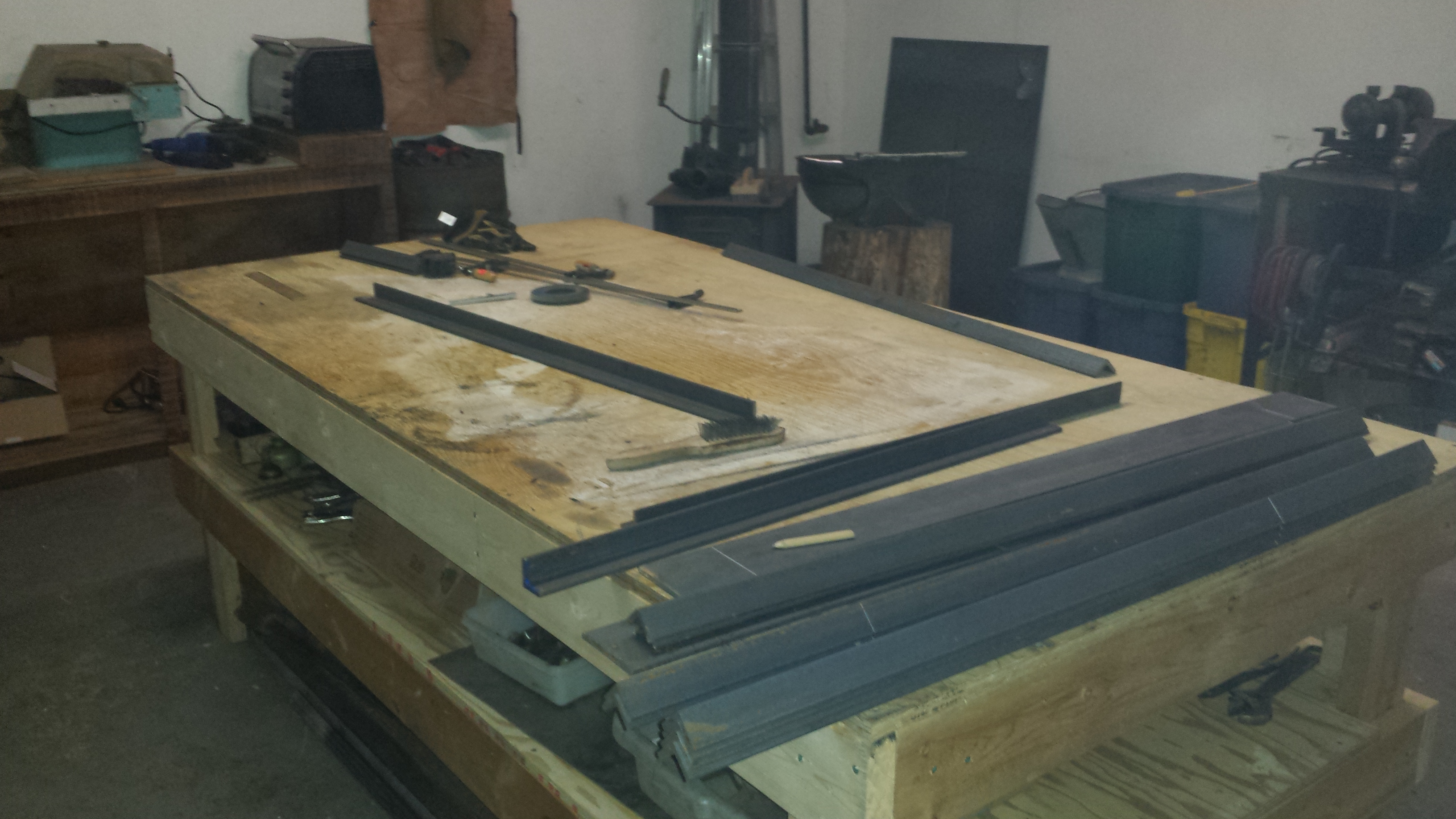

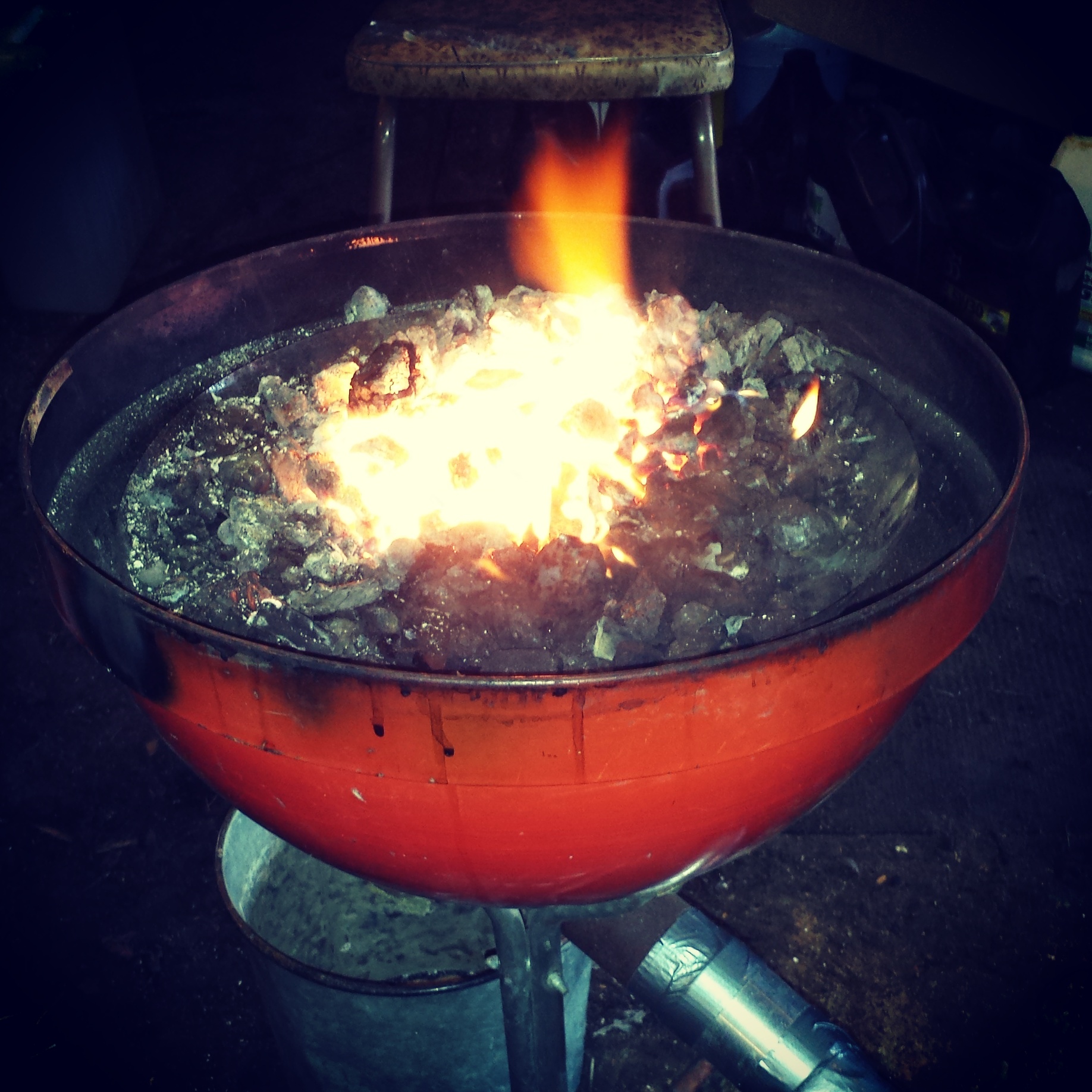

Camerican Posted January 22, 2017 Share Posted January 22, 2017 Greetings all, been a lurker for 3 years now, finally decided to make an account and join the discussion. Been running a really small what I like to call a Franken forge for 3 years. Basically an old charcoal bbq converted to a forge with a hair dryer to make the whole thing chooch. It worked alright for a while. Pretty right? Well it is time to say adieu to the Franken forge. She served me well while I lived in the city. New job finds me back in my hometown, on 15 acres and lots of room to play! So I got the go ahead from my beautiful lady to get all set up! And here we go. Will post pics as I get progress done. Day 1 had me really not knowing what the heck I was doing. Bought a bunch of metal at the metal supermarket in the city and decided it was time to put it to use. Cut all the pieces for putting it all together. The table that is. Doesn't look like much yet right? Here is the space I can call my own with a bunch of metal on my makers table. Day 2 ended with something that resembled a table top. Got my feet wet with welding. Never done that before. I don't think I will ever call myself a welder, but I can make metal stick together. And that brings us to today. Only able to be out in the shop for 3 hours today as we are in the middle of demolition on the basement and that is apparently the priority. Lol oh well, more welding and have a decent table now. Next will be to build the firepot, cut a hole in the table to insert it, build the tuyere with clinkerbreaker and build a side draft hood, then a mounting bracket for my vintage Thompson hand crank blower. Another month or so and I will have a nice little forge. Here are some details for you all Table built with 1.5 x 1.5 angle iron 36 x 48" total size Table plate is 1/8" lower shelf on the left not yet put in but will be 12 ga. For projects to cool on. If it looks a little backwards to some of you i'm a south paw so it will all be set up for a lefty. I added an extra 1.5" on 2 sides of the table so I can have a little extra coal on the bench. Quote Link to comment Share on other sites More sharing options...

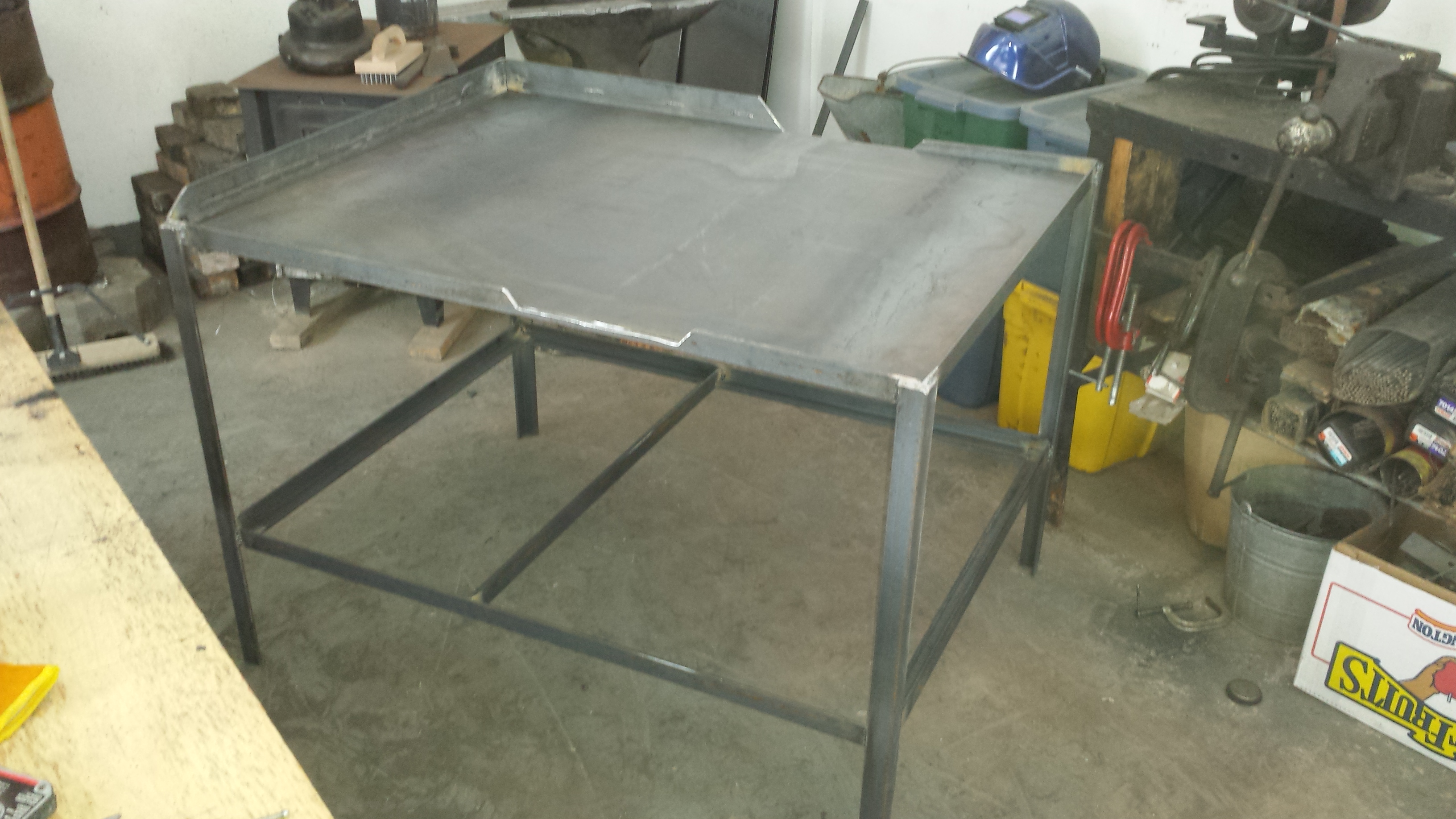

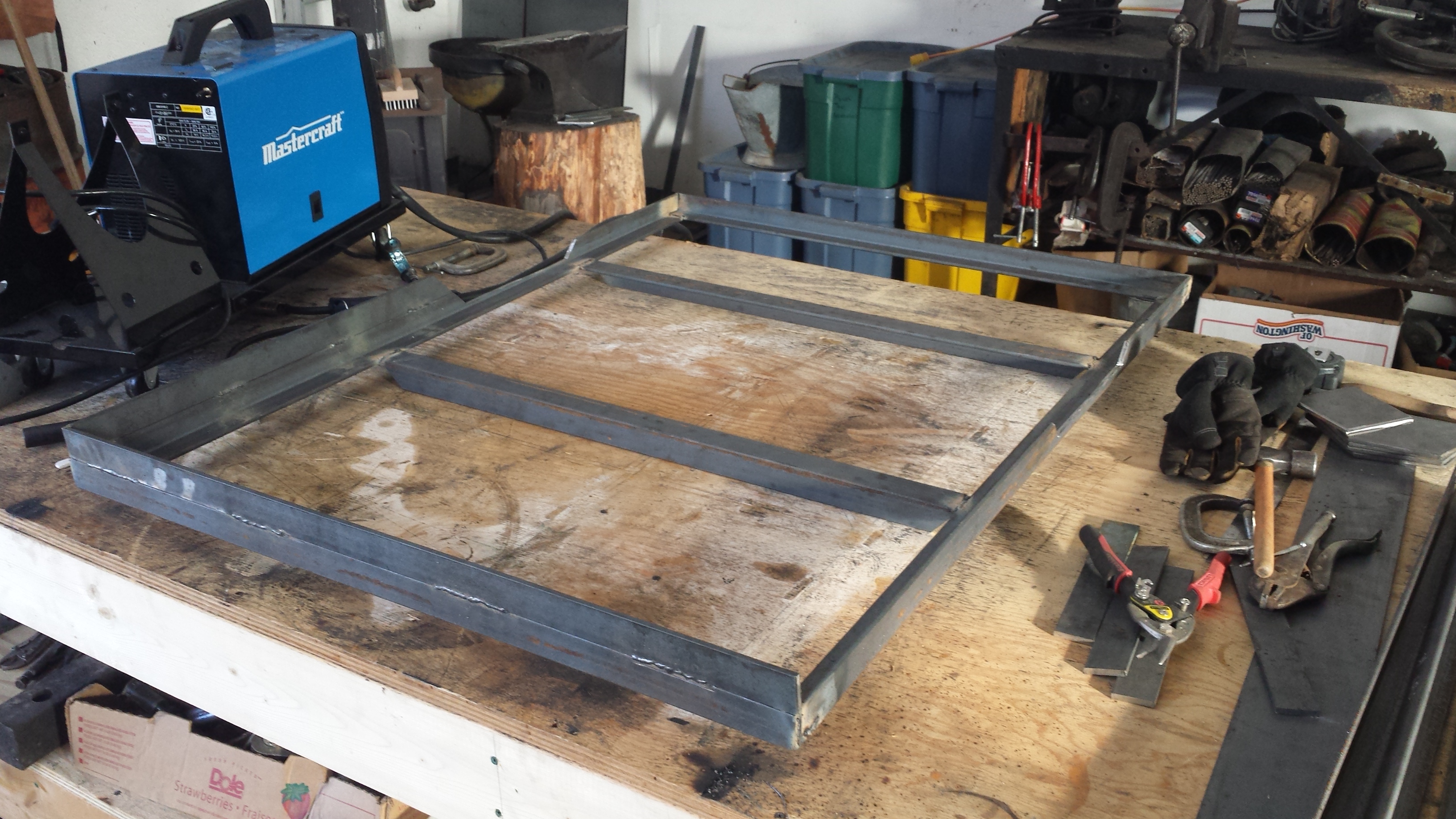

Millhand Posted January 22, 2017 Share Posted January 22, 2017 Looking good!! You will want to get some bracing under those cutouts. Just a couple pieces of angel running with the cutouts. I'd just tie the two braces you already have spanning the underside together. My table is similar and when I was welding the top plate to the angle at the cutout. It started to sag from the heat. Quote Link to comment Share on other sites More sharing options...
Camerican Posted January 22, 2017 Author Share Posted January 22, 2017 Hi millhand, yeah I was planning on adding crossbracing around the firepot hole. I am still undecided if I want to center the hole or if it should be closer to the nearside of the forge which is why I have not put them in yet. As well I haven't confirmed the firepot size. I was thinking 8" ×8" and 3.5" deep but I am wondering if that is too deep. I have seen a lot of homemade firepot being rectangular so the other option is to go 8"x10" but that is getting pretty big Quote Link to comment Share on other sites More sharing options...
Camerican Posted February 5, 2017 Author Share Posted February 5, 2017 Some progress today. Got the firepot half welded together and the tuyere built. Only in the shop for a couple hours today. Hopefully will get the rest of the firepot ash dump and clinker breaker done tomorrow and get the hole cut in the table for it. Firepot is 4" square on the bottom, 8" square on the top and 3.5 inches deep. 2" air hole. Quote Link to comment Share on other sites More sharing options...
