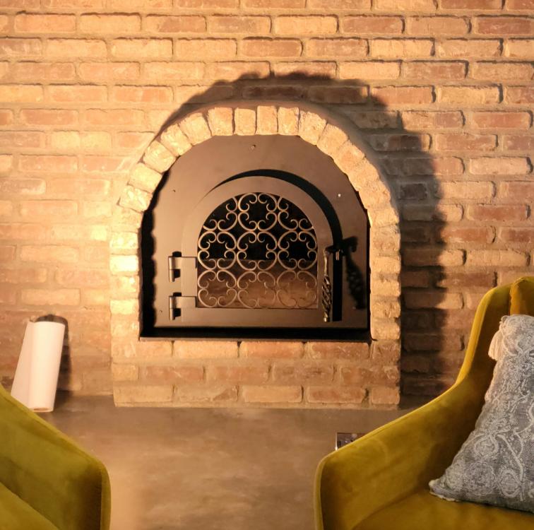

  3. Hey all here is a fireplace collab I did in 2021 with a local metal fabricator. She did all the flat steel stuff with her plasma table. I did the forging parts and she welded it all together. Comments and questions are always welcome. First 2 pics were prototyping. I realized quickly that consistency was key and came up with a process to get repeatable results using a 4" radius swage and then a scrolling jig. Also ended up using 1/4" square whereas the prototypes were 3/8 square because that's what I had on hand. Next 2 photos were to figure out proportions. I scrolled some mechanics wire by hand. Next pic is the layout before welding and the final results last. The fireplace was actually double sided. The rear door was in the garage which let the client keep the firewood out of the house.
  4. Thanks Frosty and George! I have progress pics from all my projects. I will get the last couple projects posted individually in the coming days/weeks. The fireplace grill was welded on the backside indeed. I also forged the hinges and the handle to open the door. It was actually a collab with a local metal fabricator. The door was powder coated before install.

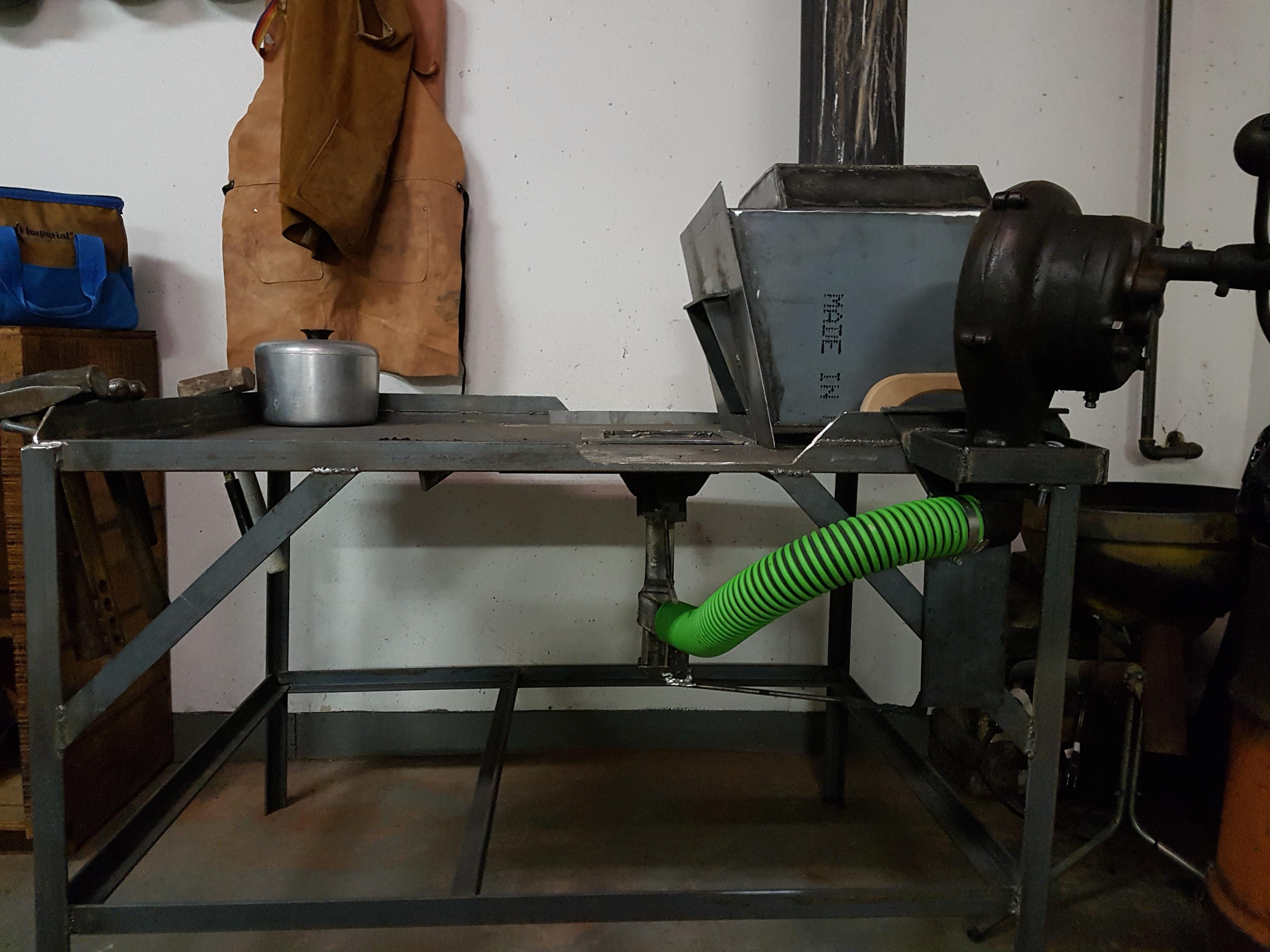

  6. Well first of all, I am really flattered that you want to build a forge like mine! Here is an update after using this forge for 4 months or so... Still have the blower on the right. It is nice to give the left arm a break while I am cranking with the right. I use sub-bitumous coal so it stays well lit even without the air going. Have about 1200 lbs of it so i am not needing to buy coal for a long while. Klinkers are annoying but a fact of life and I have learned to deal with them. The only thing I plan on doing with this forge is to upgrade the firepot. 1/4 inch is a little thin for my liking and at 3.5 inches deep I find it a little too deep. Will be replacing it this winter probably with either 3/8" or 1/2" and make it only 2.5 inches deep. I find the 8"x8" geometry about perfect for the work I do which is tool making. I only need to hear 4-6 inches at a time with being all manual on the hammer anyhow. The 6" pipe for the chimney has not been a problem. Even at 85F in the summer it draws fairly well. I will remind you that I have an ideal situation though. 15ft straight up and no buildings in the area to cause turbulence. When I build my new smithy it will be upgraded to a 10" flue. Other than that I am happier than a pig in s#!t with this set-up. Hope to see your build in the near future. I am really looking forward to it! Thanks for the interest!

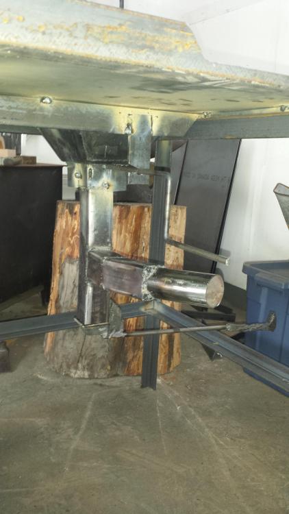

  20. Thanks Frosty!! I must admit it was not the cheapest build. Probably around $500 Canadian pesos. Will post some more pics following the first firing. She blows air now, but we will see how well she chooches. Wish I had time to test it tonight but alas dad duties call. Here are the promised final pics of the install. And details below Table: 3/16 plate 36 x 48 Firepot : 8 x 8 x 3.5 inches deep from 1/4 hot rolled steel Hand made tuyere from random box tube and such. Custom pineapple twist handle on the ashdump cut off my first rr spike project. Thompson blower: vintage 1900 ish. (Canadian equivalent to a buffalo I hear) Super sucker side draft hood made from 12 GA sheet metal. All put together with a crappy tire (harbor freight type) Mastercraft 80amp Flux core welder. This was my first time welding. I probably could have started with an easier project but hey it works! Added a tool rack at the end for my hammers and tongs. Will probably put another one on the opposite end as well. All that is left to do is drop the sheetmetal in for the cooling rack below the table . Minor detail. Please do let me know what you all think. And thanks for the opportunity to share!
  21. hey all, been a while since the last update. getting very close now. was out sick for the better part of 2 weeks, and then was away for work. I have about 3 or so hours left on getting this project done. since the last update I built a super sucker style hood. and added it on. this is the only picture i have at the moment but will add a few more once the blower stand is done next week. thanks for hanging in there. It is installed on a less than ideal 6" pipe (20f t tall) , but I will have you know that surprisingly it draws. I too am a little baffled about it, but perhaps the height and the fact that the nearest obstacle from the windward side is over 100 yrds away plays into it. Will be nice to get this project done and actually burn some coal. been a long time.

  23. Been a couple weeks. Down with the flu last weekend so I was not able to work. Got some done yesterday though. Firepot in and tuyere built. Clinkerbreaker is in and the ash dump. So I just need a paint job on the tuyere and legs of the table and she is done!! Going to make and modified sidesucker hood next and we will have irons in the fire!! So excited to see that this is coming together! One decision yet to make is for the blower stand. Don't know if I should make a bracket that hooks right onto the forge table, or make it stand alone beside the forge. Any input is appreciated.
