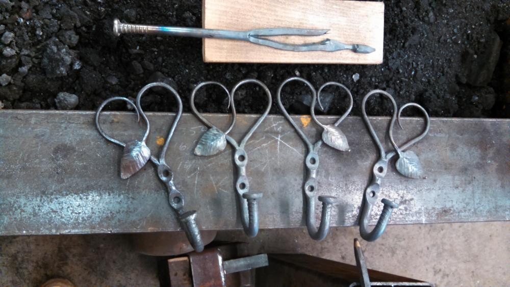

ausfire Posted January 17, 2017 Share Posted January 17, 2017 Been looking for variations on those giant 300mm nails. First up, I need to declare that the heart shaped hook is not my original idea; it's based on a design in a photo Vaughn sent to me. I think the vine and tendril one is a bit 'busy' and I might try simplifying the next one. Visitors to my forge still can't believe how big those nails are. Quote Link to comment Share on other sites More sharing options...
Zeroclick Posted January 17, 2017 Share Posted January 17, 2017 Those are some more beautiful pieces. Those nails really are cool. Quote Link to comment Share on other sites More sharing options...
Marc1 Posted January 17, 2017 Share Posted January 17, 2017 Don't simplify that. If you are comfortable making them, they look very nice to me. Particularly the left one. The heart needs a bit of detail. One observation ... if you are selling this, I would supply the fasteners with it. A bright new phillip head screw will look out of place and ruin the piece. Ideally you can make the nails for them by hammering the head of a nail with a ball peen hammer carefully all around in the vice, or supply a blackened slot screw with it. Quote Link to comment Share on other sites More sharing options...

ausfire Posted January 18, 2017 Author Share Posted January 18, 2017 Marc: I don't really intend to sell these. I want to keep them as examples of the use of the big nails. I agree that bright Phillips screws are not the best fasteners for forge work. For standard leaf hooks made from 10mm round bar, I supply either bronzed screws from Bunnings or lag screws which are squared off in the forge. They will only attach to timber of course. If you have a gyprock or masonry block wall you need the plastic plugs. What detail would you add to the heart? Perhaps draw out the shorter half more and wrap it? Glenn: Good idea. I like things that make people think. Vaughn: I'm running out of ideas too! I'm thinking of drawing one out to a long toasting fork with a twist or two. Quote Link to comment Share on other sites More sharing options...

VaughnT Posted January 24, 2017 Share Posted January 24, 2017 On January 18, 2017 at 6:36 AM, ausfire said: I agree that bright Phillips screws are not the best fasteners for forge work. Vaughn: I'm running out of ideas too! I'm thinking of drawing one out to a long toasting fork with a twist or two. One thing I noticed is that you're flattening the area where you put the holes. This is good for punching the hole through, but also detracts a hair from the possibilities. I've been forging in a divot with a 1/2" round-nose punch, then doing the through-hole for the screw. With the divot there, you get a bit more visual interest in the piece and a dome-head screw looks really nice in them. Even with a phillips-head screw, it sits below the surface in a way that makes it look like a knot or bud. Of course, I throw all the screws in the fire and darken them first. Bronze would look great by itself, standing out a bit from the waxed steel. Also, since Australia doesn't have the big nails, it might be better to save at least one so you have a before-n-after type set up. It'd make a really neat storyboard to show folks how much you can get out of a single nail. You might consider making your own "nails" by upsetting the end of a 13" piece of 3/8" stock. As you're already doing things to the pointed end, it might be nice to do a flower-bud on the head of the nail. I'll forge one out later today and post some pics. They're easy as snot to make and go really good if you're going to do leaves on the other end. Quote Link to comment Share on other sites More sharing options...

ausfire Posted January 24, 2017 Author Share Posted January 24, 2017 Vaughn, thank you for the advice. I do use your technique of forging the divot for the holes, although not quite as deep as yours. I use the back end of a small ball pein hammer, the same one I use for the tabs on bottle openers. I like that method as it lines things up nicely for punching the holes and the steel doesn't want to roll under the hole punch. I agree it is visually more appealing ... I'll make the next ones deeper. I have saved the last nail for the reasons you suggest; it is good to have a comparison between the finished product and what you started with. Anyway, I've kept it because people are amazed at how big they are. I was in a major hardware store in Cairns yesterday and the biggest nails they could supply were 125mm bullet heads. Piddly in comparison to those 12 inch spikes. As you suggest, it would not be difficult to upset 3/8 stock and make similar nails. Could even texture the grip marks. And the flower head sounds like a good idea. Here's a picture of the nail toasting fork I did. I thought it may be a bit weak drawing it out that long, but it's sturdy enough. Quote Link to comment Share on other sites More sharing options...

JimsShip Posted January 31, 2017 Share Posted January 31, 2017 These are very nice! When doing the fork, or the heart, are you flattening the end, then splitting it? (I think I'd need a hacksaw, I don't think I could hot cut something that thin!) Quote Link to comment Share on other sites More sharing options...
jeremy k Posted January 31, 2017 Share Posted January 31, 2017 As in this picture, it is easier to flatten a round to hot cut, then re-round each. Umba has a DVD video of a demo I did making these heart hooks - # RD172 I started making these after seeing one that Jake Pogrebinsky from Alaska had made. Quote Link to comment Share on other sites More sharing options...
ausfire Posted February 1, 2017 Author Share Posted February 1, 2017 18 hours ago, JimsShip said: These are very nice! When doing the fork, or the heart, are you flattening the end, then splitting it? (I think I'd need a hacksaw, I don't think I could hot cut something that thin!) Yes, pretty much. A bit tricky keeping the fork part tidy though. Quote Link to comment Share on other sites More sharing options...
