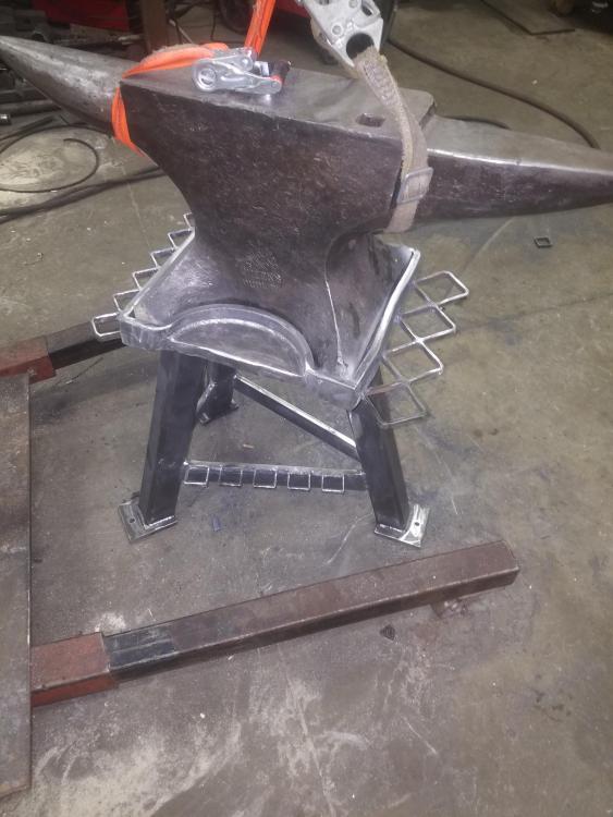

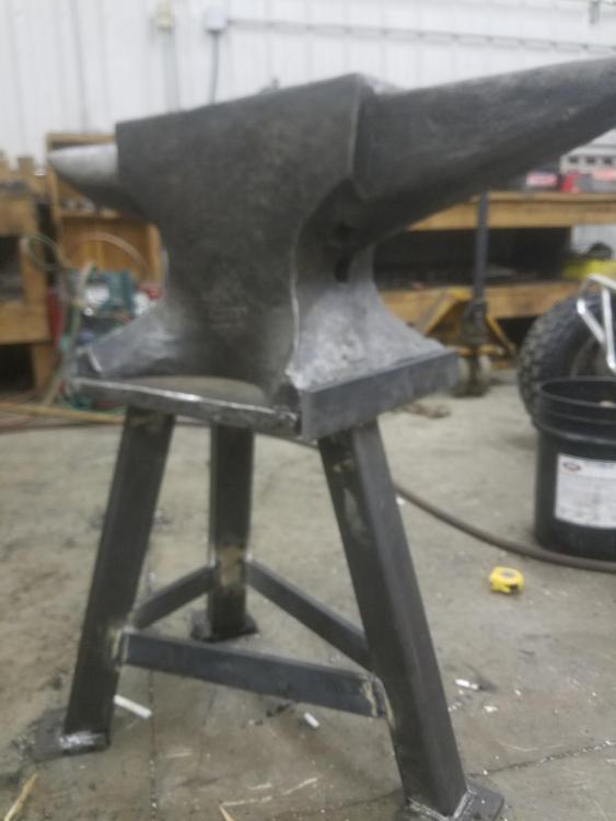

Hope this is posted in the correct place! Since I'm waiting on parts for the rest of the projects I have started, I decided to throw a anvil stand together for Mr duddly!

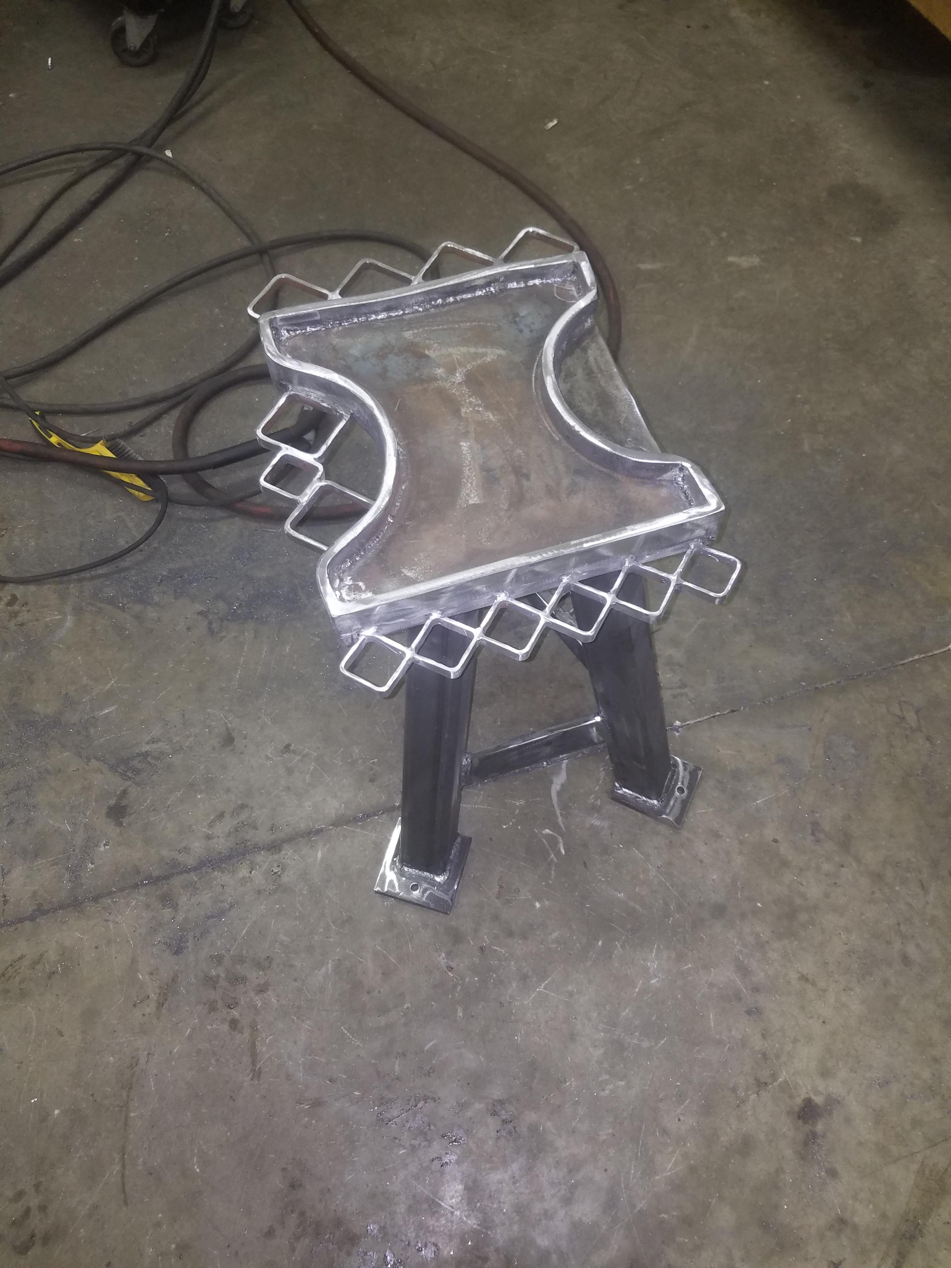

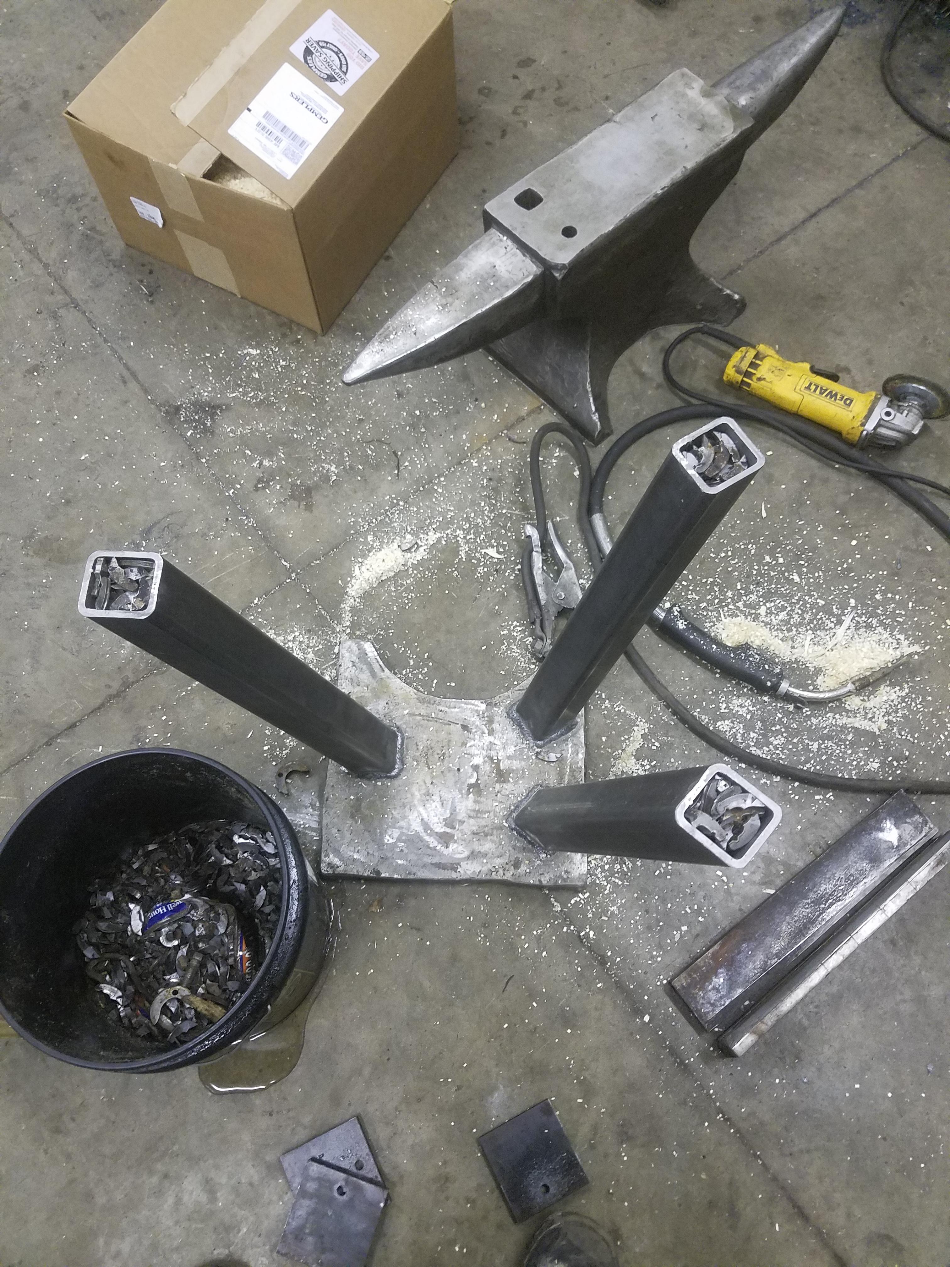

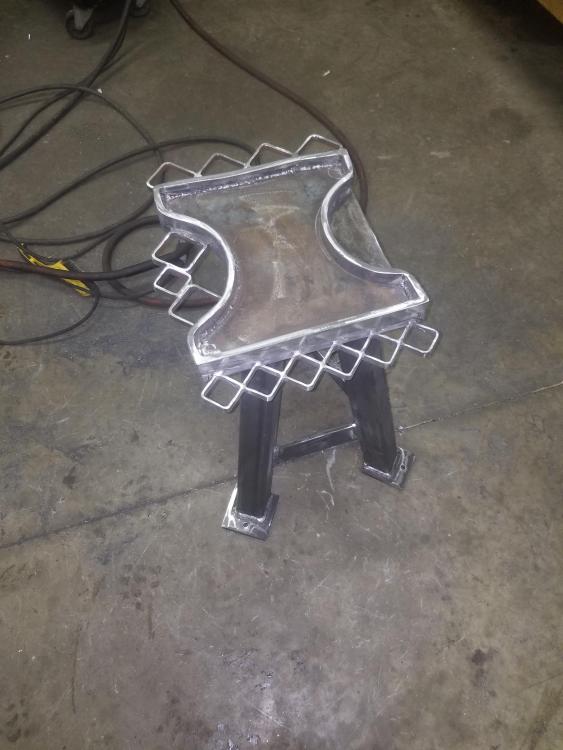

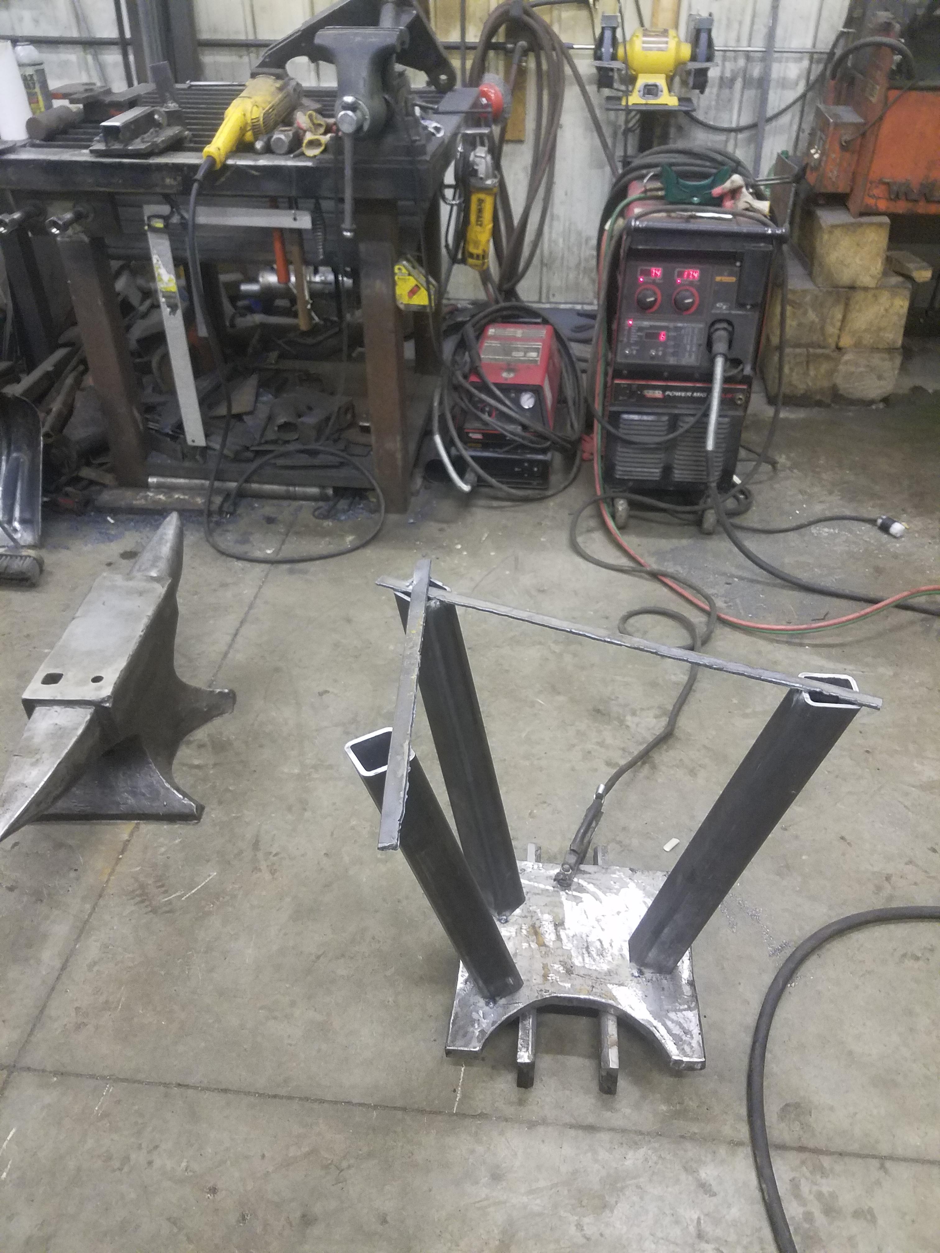

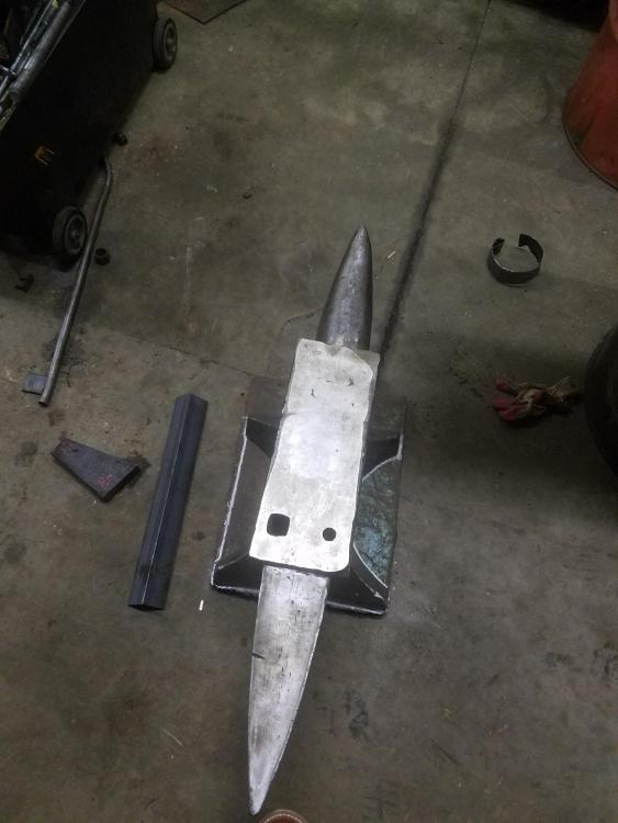

Had a old piece of 1 1/4 plate I found buried wile bull dozing, it's been hanging around my shop for Years. Pretty glad I kept the rusty slab.
There was a fair amount of cussing getting it cut.  Ran out of acetylene with 4" left.  Being me I couldn't just wait.  Way to big to fit in my band saw or is it???? Lol

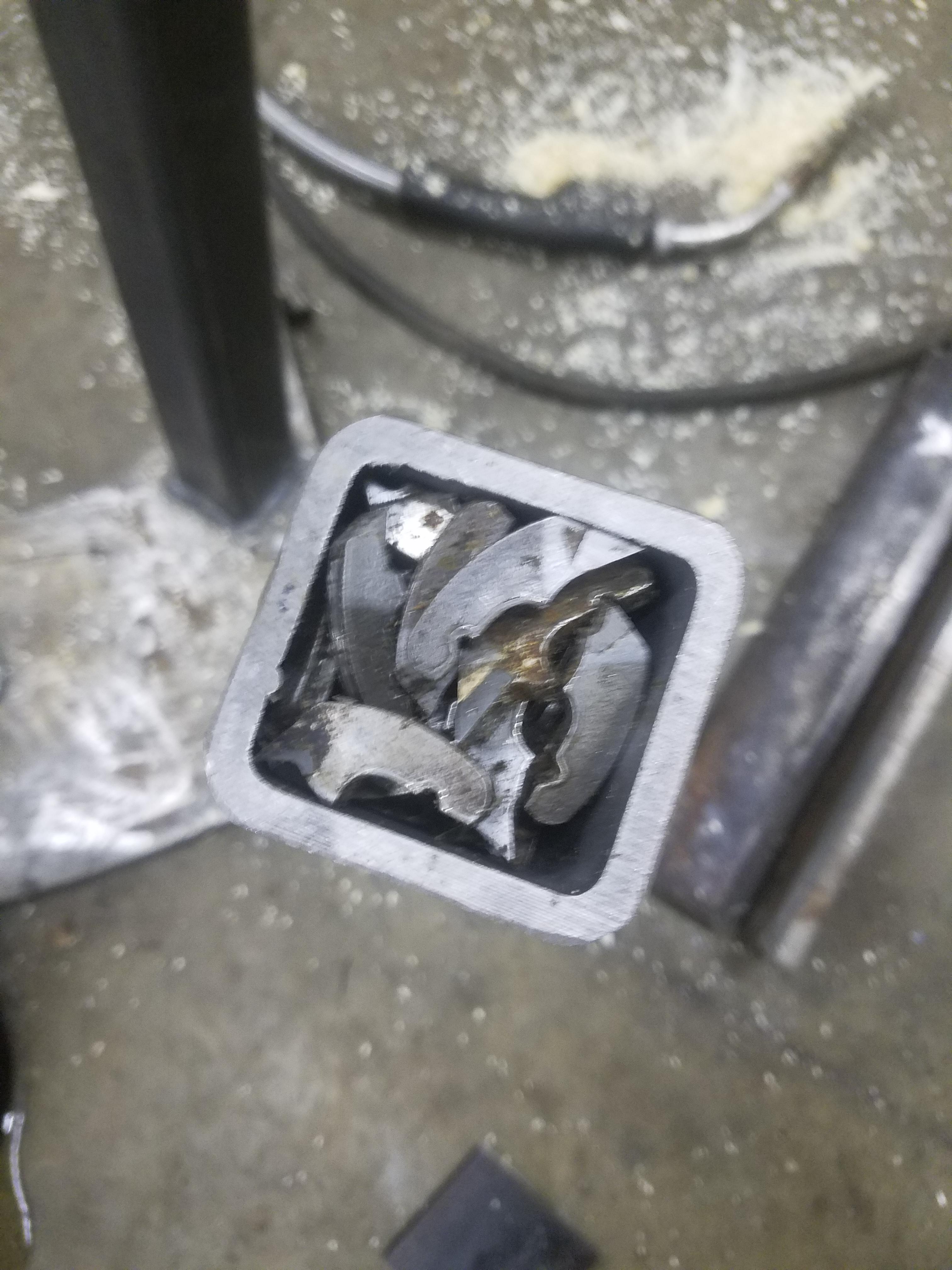

I filled the legs with a few handfuls of Sawdust, used Oil and worn out saw teeth to deaden some sound and add weight.  (I'm so going to forge weld some teeth when I get time!!)
Preheated the plate just for good measure.
Left the forge side plate full size for upsetting longer pieces. I think the big guy likes his new stand.....
It's not finished yet.  Tomorrow I'll get some tool holders and anvil clamps glued on.

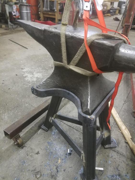

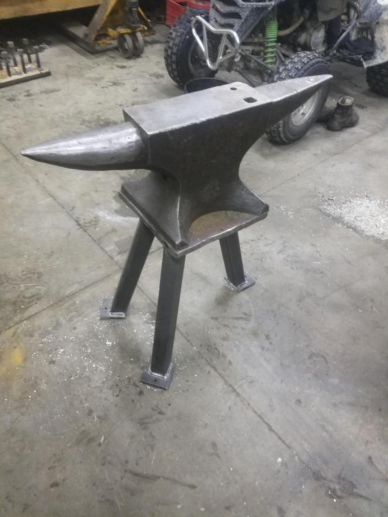

Wondering what the final height of the anvil face will be.  Photo distortion makes it look like the legs are currently about 3 feet long :)

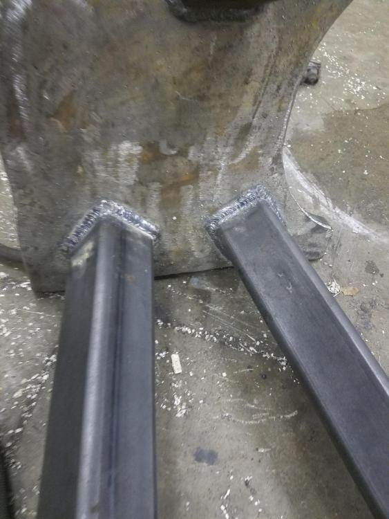

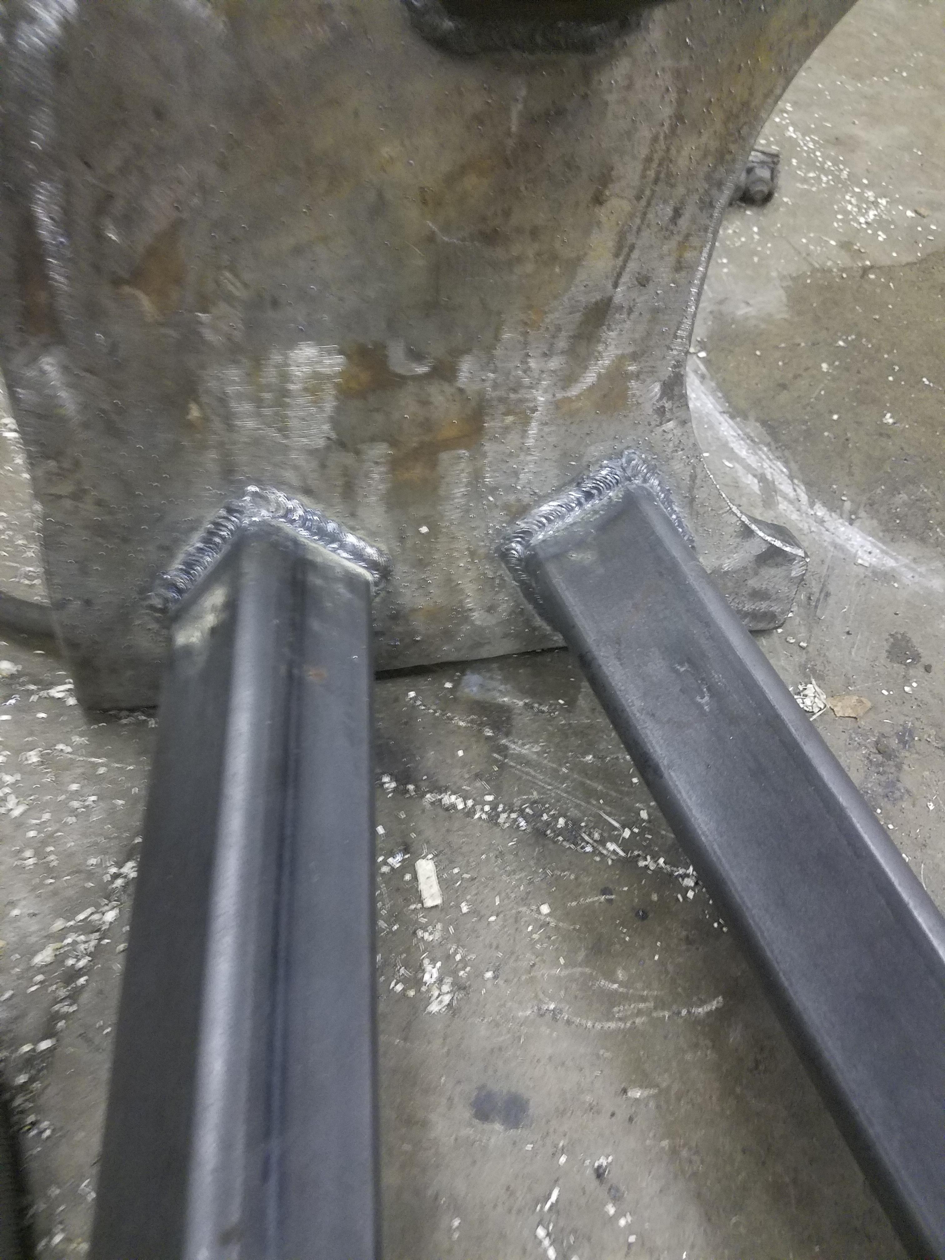

You might consider stretchers between the lower part of the legs just to take some of the stress off the upper welds in case they start to fatigue crack or move a few years down the road.  Easy insurance now, harder later.
32"to the face just above my knuckles.  I was just looking at those pics again.  The 3" square tubing looks like tooth picks as well lol.
Thanks kozzy, I will add some bracing maybe incorporate a small shelf or something.  Seems I can never have to many flat surfaces to collect my junk!
It won't hurt to put spreaders between the legs. It will not only BE stronger and more rigid it'll look stronger. Is knuckle height a comfortable working height for you? I find wrist height to be much easier on my back and eyes.
Tell you the truth frosty I don't know, the only anvil I use much atm is quite tall.  Face is around waist high.  I find that great for small delicate projects. A bear for really beating the xxxx out of something though.
This one is going to get the heavy hammer work.  One because it's a pretty heavy anvil and second is its already beat up pretty good.  So I left it a touch low.   It is about midway on my closed hand.  I posted that wrong in the previous post.
Lord willing I'll fire up the forge tomorrow and try it out :)

If it's too tall, trim the legs. If it's too short, add more feet.

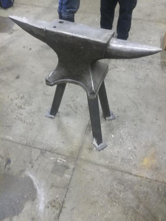

I understand the idea of the three legged stand, but if you are using it on a level floor would not a four legged stand be more stable? If one was to shove that anvil sideways it may topple over. Good job  though, just my two cents worth.
No need to relurk Millhand we just try to keep the site one we wouldn't mind letting an 8 yr. old read.
A quad stand wouldn't be MORE stable, just as maybe but you'd have to keep the floor really clean. A tripod will always stand on all three legs so it can't rock on 2 of them. A quad will balance on the two longest and only one of four needs be longer, say a paper match under one foot and it will rock between that one and the one opposite.
You can get away with a quad on a REALLY clean smooth floor, level is optional. A good way to accommodate slight imperfections is with soft foot pads say inner tube rubber glued to the pads.
A Tripod is more stable because it only takes 3 points to define a plane. If a forth point is added it is actually less stable.
I spent the night cutting it back apart as it was to tall.  After some super great advice I tested it with some soft Wood. Heel of the hammer on half inch stock. I originally  went for a face hight between my wrist and knuckles. To high for me.
 Simple Stand turned into a ton of work! But it will be rite when I'm done. I hope anyways:)
I give for the night.  9 hours at work, 4 hours on this stand.  Should have been a 3 hour job max!! Need to forge the last two pieces of the top.  But I'm whooped
 Looks good up there and my hammer lands flat on stock.

I put wood under my stand legs so they don't grind up the concrete floor. It also can be raised or lowered with different sizes of blocks. I have four legs and just tap a wood shim under one if needed to stabilize it. I do the same with stumps. Usually need two shims for them. Your stand looks great. Nicely done.
