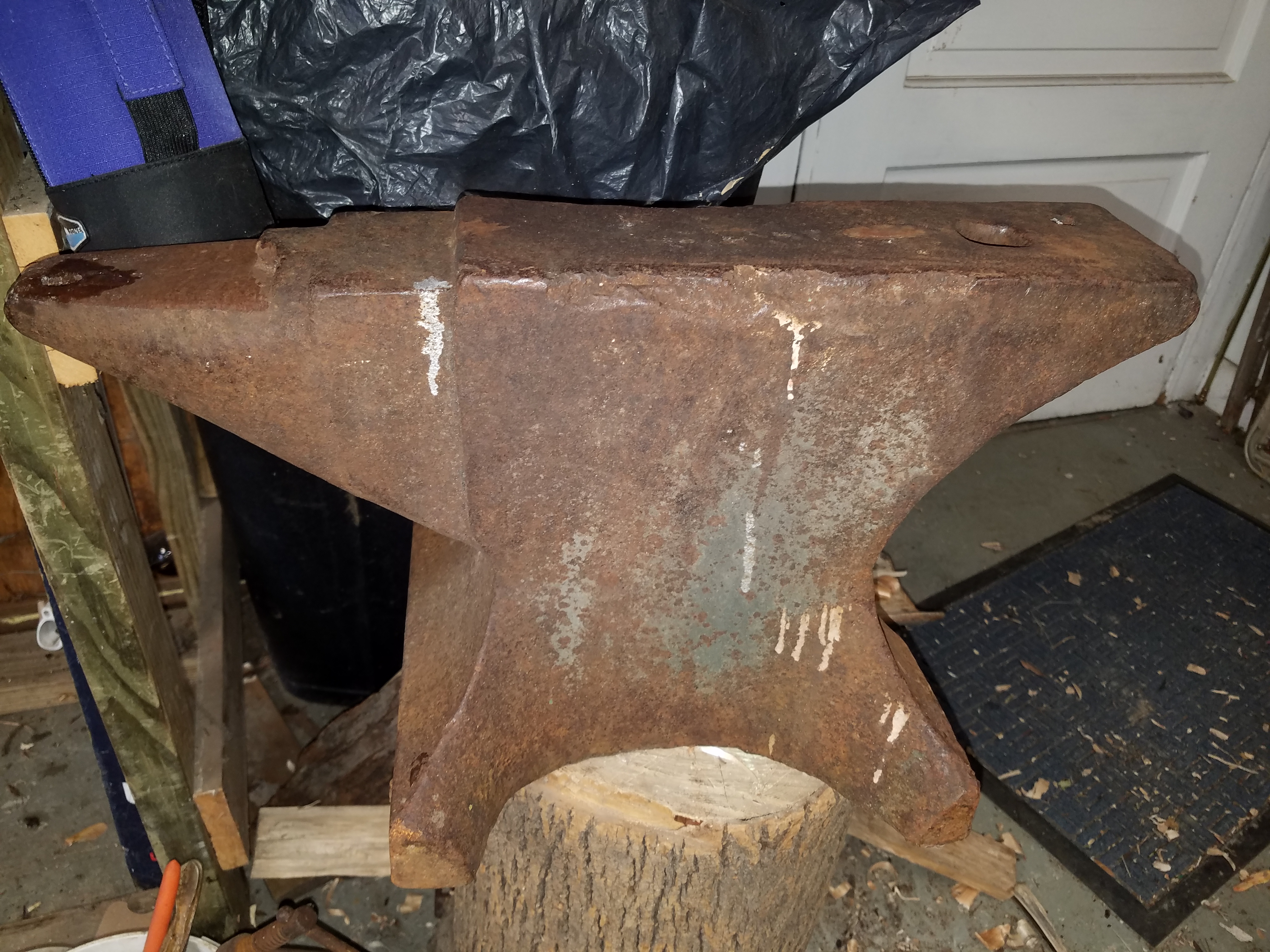

HP500 Posted January 7, 2017 Share Posted January 7, 2017 Hello everyone, first post. After spending the last couple of years looking for an affordable anvil without any luck, I finally came across one within my price range. However, I don't know what brand it is or how old it is. I cannot find any markings on it. It also has some damage on the edges of the face. The anvil weighs exactly 160# and has been sitting outside for years. If I want it, I can purchase it for $160 USD. Here are a few pictures. I can post more if needed. If anyone can tell me what brand it is and if it is worth the price, I would greatly appreciate it. Thanks! Quote Link to comment Share on other sites More sharing options...
ThomasPowers Posted January 7, 2017 Share Posted January 7, 2017 The face looks very thin and a tad fragile; can you see if the base material is cast iron or wrought iron? My local scrapyard sells blocks of steel for US twenty cents a pound that make decent starter anvils, $160 (BTW is that Singapore Dollars, Canadian Dollars, Australian Dollars,...?) seems a bit high to get a hardy hole. Quote Link to comment Share on other sites More sharing options...

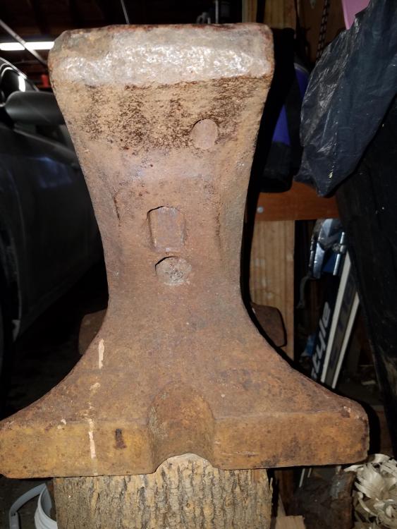

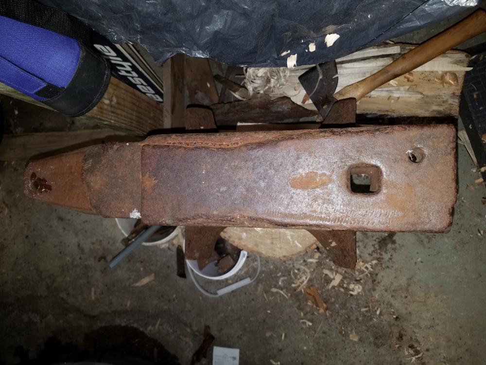

HP500 Posted January 7, 2017 Author Share Posted January 7, 2017 Thanks for the quick reply. That would be US$. Here are a few more pictures. The face is almost completely flat, with maybe 1/16" gap on a small section of it. It seems to have a good bounce when I let a hammer fall on it (I don't have a ball bearing yet) Quote Link to comment Share on other sites More sharing options...
ThomasPowers Posted January 7, 2017 Share Posted January 7, 2017 OK The swelling below the hardy hole is often indicative of the Badger Anvil. A cast iron anvil with a steel face much like the Vulcan. If so it would be much harder to repair than one with a wrought iron or steel base. The flatness of the face combined with the thinness might indicate that someone had ground it flat sometime previous which to me ranks up there with grinding an old master painting to get the surface "flatter". OTOH they tended to be thin anyway. They were not a top tier anvil in their day. Anybody else know of another anvil brand with that swell below the hardy? Quote Link to comment Share on other sites More sharing options...
BIGGUNDOCTOR Posted January 7, 2017 Share Posted January 7, 2017 I wouldn't pay that much for that anvil, due to the extent of the damage. I would walk away or just offer $40. All you are getting is a hardy hole, and a little bit of real estate to work with. I agree with Thomas, you would be better off spending that $160 at a scrapyard, and on other tools. $160 is enough to get everything you need to get started. Quote Link to comment Share on other sites More sharing options...

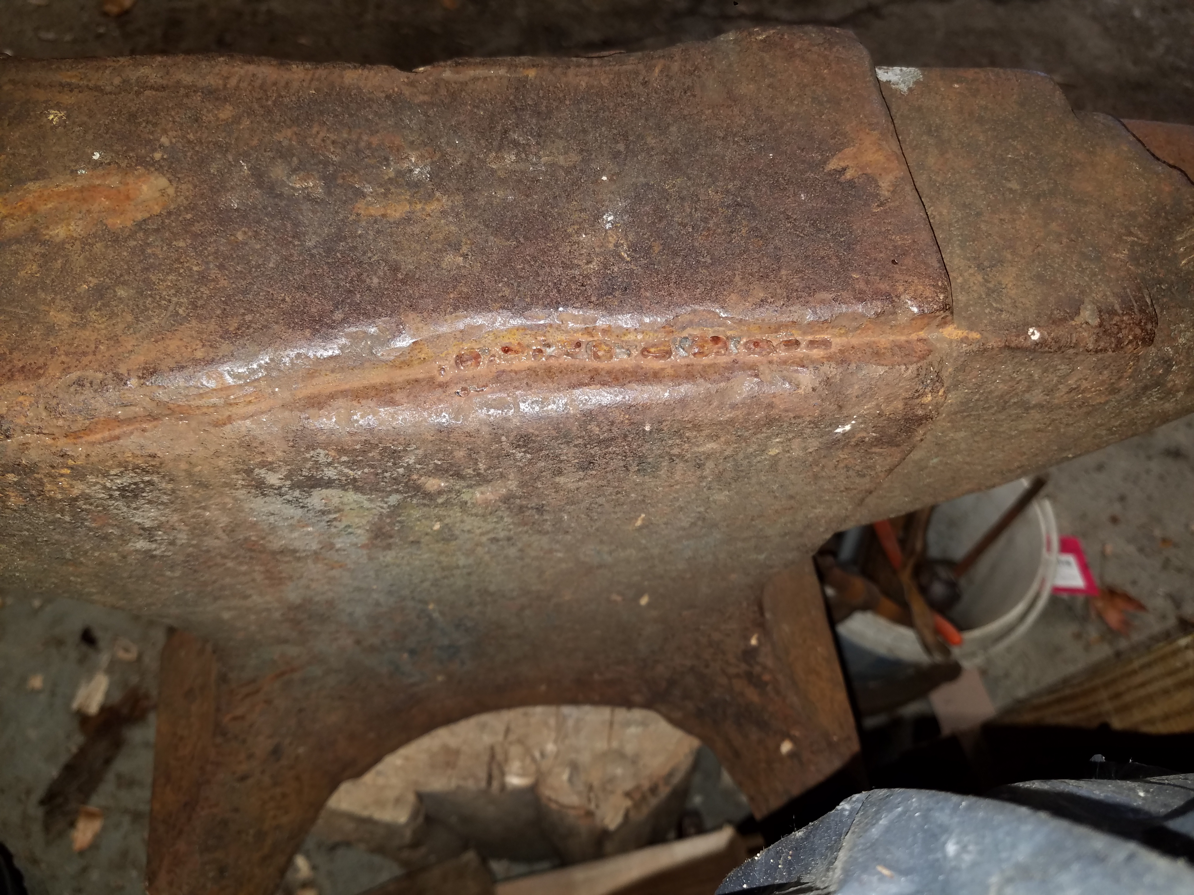

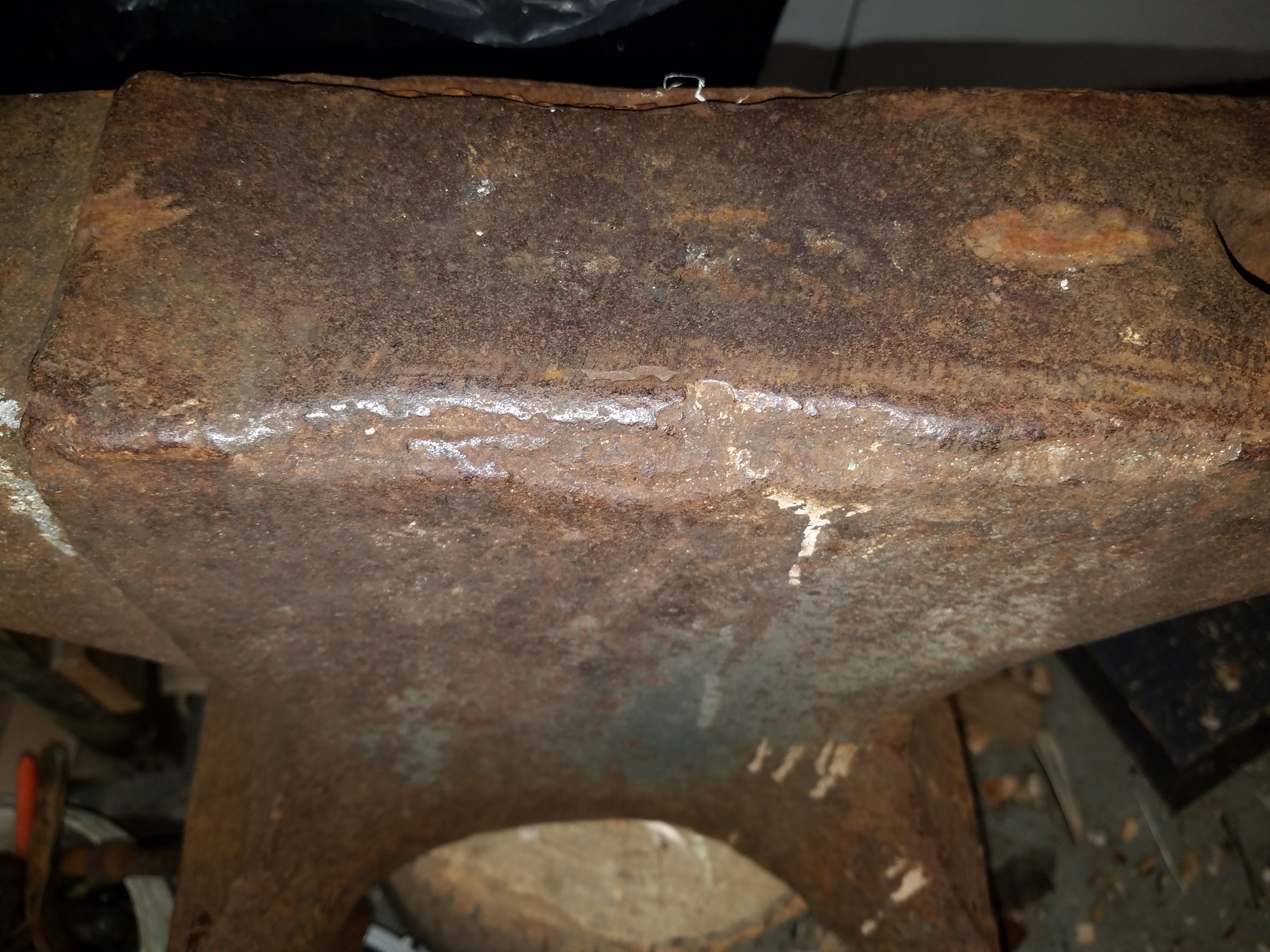

the iron dwarf Posted January 7, 2017 Share Posted January 7, 2017 looks like someone has tried to reweld the plate along one side with arc, check how it sounds when you tap it in that area Quote Link to comment Share on other sites More sharing options...

Marc1 Posted January 8, 2017 Share Posted January 8, 2017 Surely not the worst anvil I have seen. Probably not worth $160 though. Since you have been hunting anvils for a while, don't say no, just make an offer ... a low offer. Try $40 and see what they say. And then just use it as it is. You can always go to one of those anvil repair meeting and be the star of the day Quote Link to comment Share on other sites More sharing options...

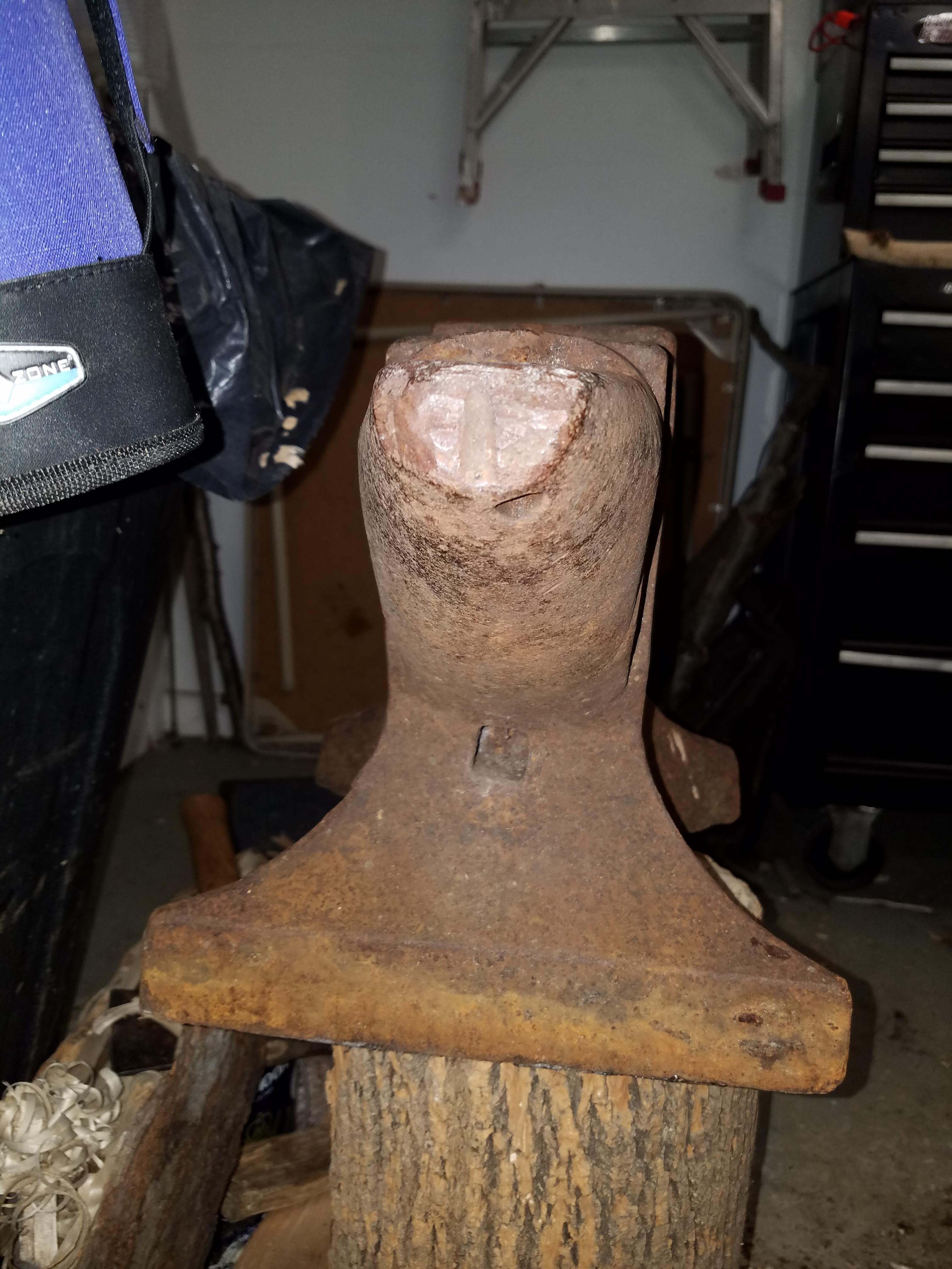

njanvilman Posted January 8, 2017 Share Posted January 8, 2017 That anvil is just about worn out. Walk away and look for a better one. Most of the horn steel is missing, you have no edges to work with, and what is left of the face plate is very thin. Quote Link to comment Share on other sites More sharing options...
ThomasPowers Posted January 8, 2017 Share Posted January 8, 2017 Most anvil repair days don't work on cast iron anvils if the steel face is missing over parts of it. I have had a vulcan "touched up" at one but no major work was needed. The costs of the rod for working on cast iron can be pretty hefty. Cheap it would be a nice hardy holder to go with a block of steel anvil; but most folks think they are made from gold lately... Quote Link to comment Share on other sites More sharing options...
