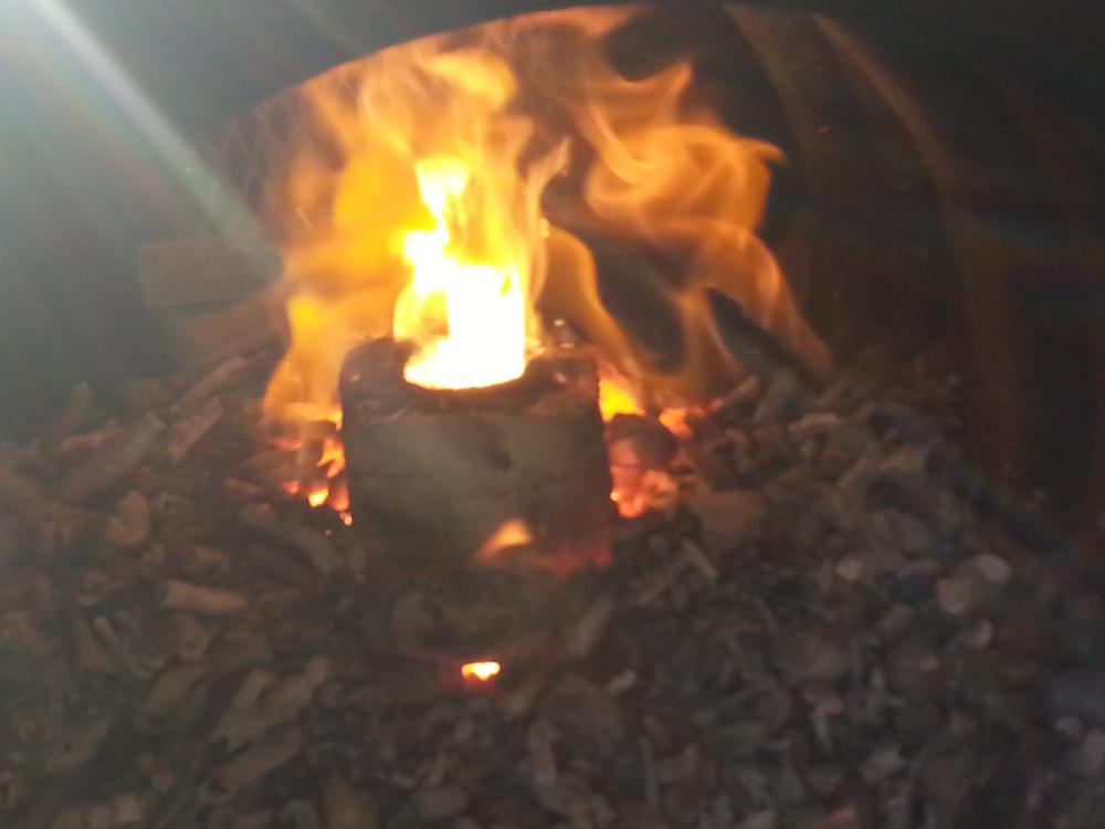

 Here is a few pictures of my forge I recently have changed the connecter to the crank so it doesn't kink which gets me way more air flow. These forges have an adjustable baffle running through the bottom with holes you turn the baffle to open more holes. All the wood I use is 2x4s and 4x4s split in half gets hot enough to forge weld just fine and I can fit pieces all the way to 30"+ in it.
I also do not pre make charcoal at all I just use wood scraps.

I'm very new to blacksmithing (first post too), and have had good success with wood in the <10 times I've gotten the "forge" going.
I use a camp fire in the back yard, I've tried side blast, and also have a couple pipes I've drilled one is 3/8" holes the other 1/4". Then this connects to an electric blower fan we already had.
I tend to use short chunks of scrap lumber or pallets but really just use whatever is laying around.
I can consistently get the metal to forging temperatures, but only in a small area, and I am continually poking the coals around, to maintain a nice bed of coals above and below the metal where I want to heat it. So far, getting enough heat in the right place is more challenging than hammering the metal into the correct shape.

"Nice" is not very specific; can you tell us how many inches of charcoal is on the top and bottom and if your blower is putting out too much air?

Build a jabod forge. The coals must be banked when using a campfire. A jabod is a simple and effective proven design. There's many threads on them.

Botom blast forges just are not the most effecent for charcoal, which is what wood is after it is reduced to coals, the wood fire just isn’t hot enugh until the wood is pyrolized. So essentially a wood fired forge is a charcoal forge, the forge is essentially the same, just with an added component to convert the wood to usable coals. Not unlike a cooking fire.

You'll want to take a look through the solid fuel forge section and specifically charcoal forges to get an idea of what guys are using. Charcoal likes a side blast better than a bottom blast. A bottom blast tends to cause larger fires and burn significantly more fuel for the work you get out of it. Check out the JABOD forge, you can make the same configuration with what's on hand, a hole in the ground works a treat. Bricks are good to shape the trench but don't get fancy. Be VERY careful if you use rocks, they can explode if there is water trapped in the stone when the temp raises above boiling.
NO portland cement concrete, none it's a dangerously BAD thing to put in a HOT fire.
