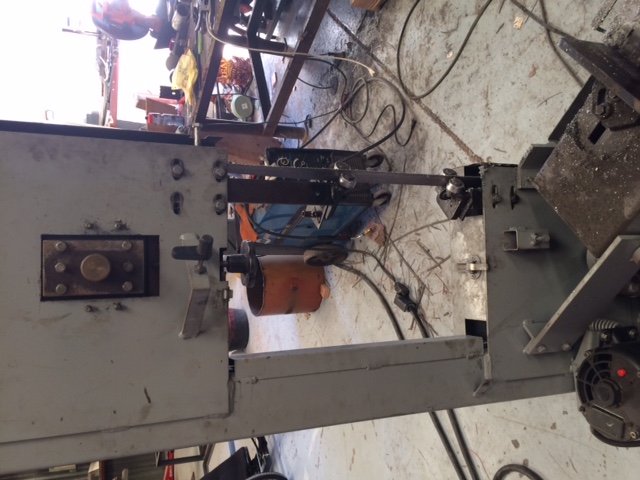

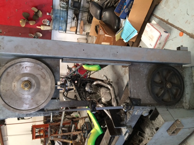

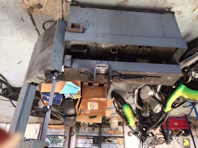

I borrowed a 7x12 metal bandsaw Brand name probably came off twenty years ago.  It is old and according to the owner bullet proof.  His blade was trashed and one condition of borrowing it was putting a new blade on it.  In the grand scheme of things this was not a bad rental fee.  New blade is on but I can't get a straight cut to save my life.  I have squared the clamp with the cut line.  Then squared it with the blade.  I am using a precision machinist's square.  The blade is taught, the saw is not loose in the brackets.  The material is square.
I am at wits end.  Any thoughts?
Post an image? I can't make it out from here.

Does the machine have a tracking adjustment?
It tracks just fine but yes there is a tracking adjustment.  Yes I inverted my shop just to take the images.

Do you use a coolant flow onto the blade whan in use? Heat generated can allow the blade to flex and wander, also blades have to be 'run in' gradually when new or that can cause problems,
Minimum clearance between supports is necessary, and an appropriate toothed blade for the material size and type being cut.
All roller supports and bearings should be incorrect situ and good working order,
The one I have to use is a PIA, blade keeps jumping off even when everything is set up as per manual, and when new ones fitted,
Good luck with sorting it, I even checked  the play in the main pivot point, it still jumps off and wanders.
I have seen blades put on backwards that still cut.
Too much downfeed pressure
Side rollers not tight against the blade
Rear roller set too far back so the pressure pushes the bade in between the side rollers and wiping out the tooth set.
Check the vertical blade travel with a square to see if the whole head is moving on an angle.
Are you expecting too much precision? Have you contacted the owner to compare notes...get him to come and set it up.
Are consecutive cuts parallel or is it wandering erratically? If the cuts are constant you should be able to adjust alignments to present the metal square to the blade.
Is it cutting vertically or wandering sideways as it goes down?
How did you set the tension on the blade? If over tight you may have flexed the frame and taken the idler wheel out of line with the main spindle.
Is the section of the blade between the guides straight? If it has a twist in it...as the carriage drops the contact line of the blade changes. On my saw the guide rollers are mounted on a block which can be rotated to adjust any twist out.
Have you set the fence/fixed vice jaw perpendicular to the blade, and checked it is still square at different heights through the drop arc?
Is it the right size blade for the saw?

There isn't a platten on the saw in the pictures so I don't think he's talking about using it vertically.  The blade guide needs to be moved in as close as will clear the vise. the blade tension may be too loose, I tighten mine by ear to a musical tink, just don't get carried away. I don't see a coolant line of nozzle so it probably doesn't use liquid coolant.
The most common operator error I know of with a cut off bandsaw is too much down pressure. Even an old worn to sloppy cut off bandsaw will cut pretty straight if you feed it slowly enough. Try backing the feed speed way down.
I wouldn't start adjusting the machine's set up till I got the operating adjustments correct and talked to the owner. Messing with the machine's set up adjustments, guide roll tilt for instance, before you know specifics can have you chasing ghosts.
It's pretty hard to trouble shoot these machines without being there. You might be able to find an operator's manual online. Getting the machine's set up right is pretty universal for these machines regardless of make. different makers might do things a little differently but the needs of the band are the same. For example, They all have to twist the band from the drive wheel orientation to vertical past the vise, all the guide rolls nafe to be snug against the blade but not binding tight. etc. etc. Anyway, an operator's manual for any of the better machines should have enough basic info to get this one online.
