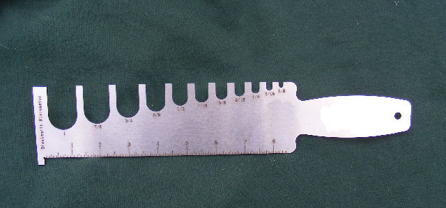

September 19, 20169 yr I use a printing industry line gauge. stainless steel, pretty cheap, measures in inches, picas, and several other obsolete print measurements.
September 19, 20169 yr Now that looks like a handy rule John especially if a person is running into a lot of different stock sizes in a day. I have several framing squares and wouldn't be without one. For larger work I have my sheet rock square and a number of carpenter's squares which are good for marking angles. This is turning into a terrific thread. Frosty The Lucky.
