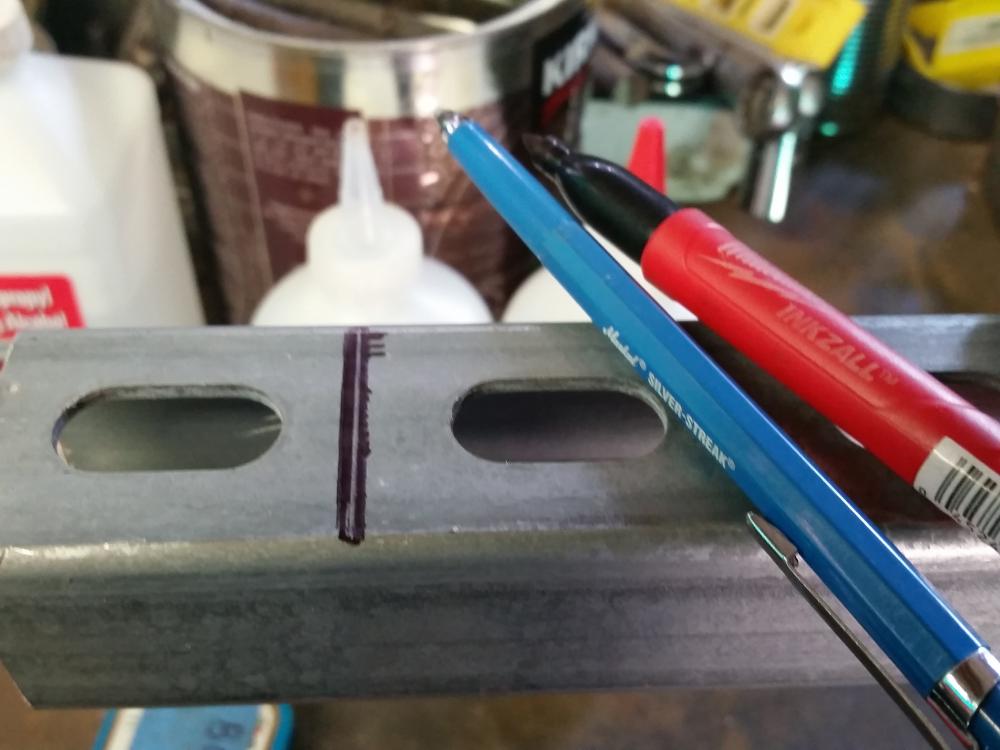

natenaaron Posted August 31, 2016 Share Posted August 31, 2016 I see it all the time. Trace the shape with a sharpie. Mark the length with the sharpie. Then complain because your cut is inaacurate. Yes I'm venting. I watched a grown up measure and mark something with a sharpie. He measured twice because that is what he is supposed to do. He cut and what do you know he was off. In this case, too long. Nothing a grinder couldn't fix. He did it again and was too short. Obviously his saw is messed up. It couldn't be the fact that he was marking with a chisel tip marker. He had to make multiple cuts the same length and every one was different in the end. Wait, set up a stop at the length you need? Nah Takes too much time Maybe it is my woodworking back ground but when I mark something it is with as thin a line as possible. A scribe or sharpened soap stone. Heck a nail or flat head screw drive in a pinch, and how the heck hard is it drop a brick or piece of steel as a stop. Grrrr. Rant over. Quote Link to comment Share on other sites More sharing options...

Anachronist58 Posted August 31, 2016 Share Posted August 31, 2016 Here is how I cope: Silver Steak over wide Sharpie background. Oh, and Slag, something from My trade: "Tribal Knowledge Trumps ISO". Robert Taylor Quote Link to comment Share on other sites More sharing options...
