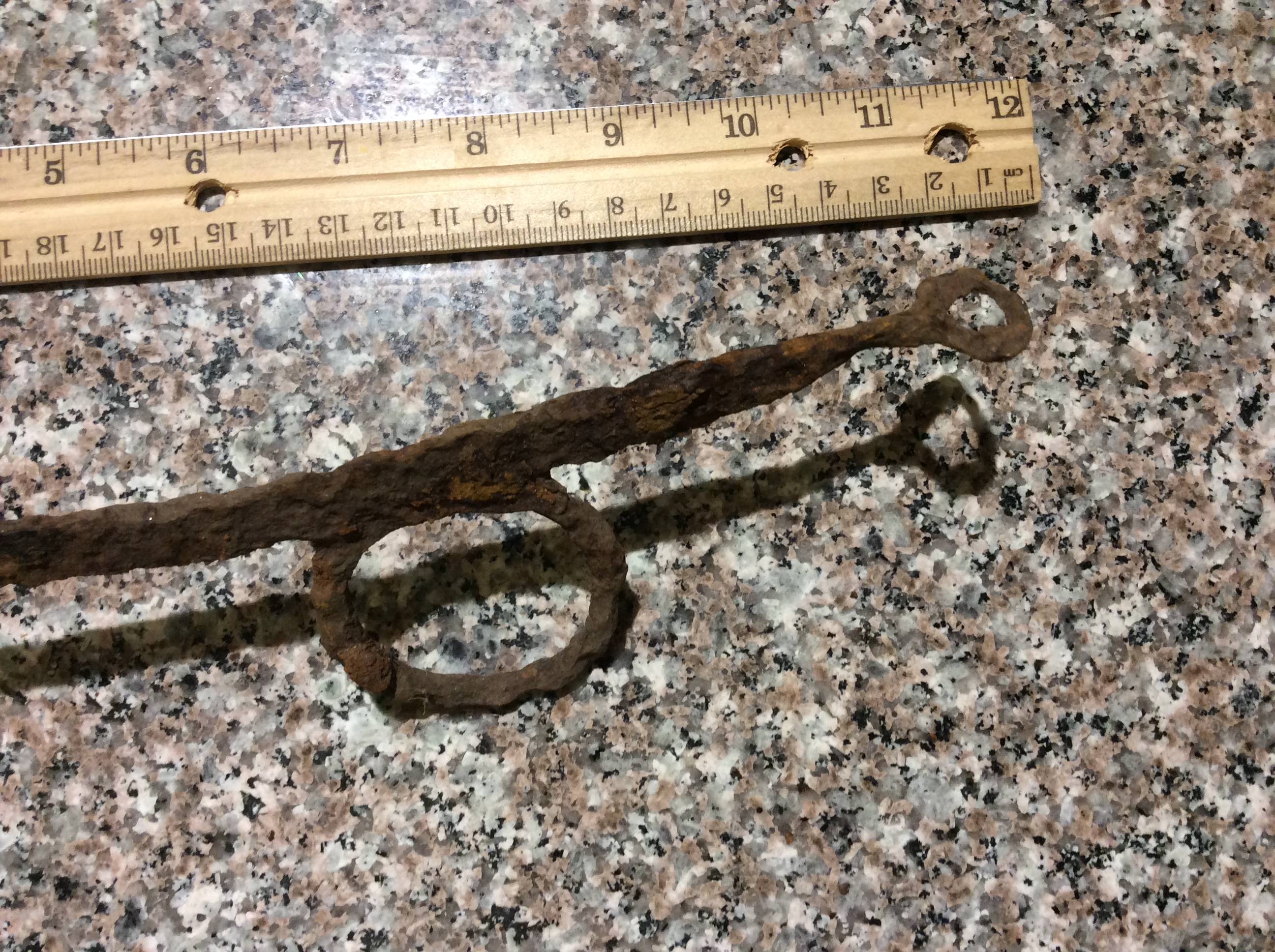

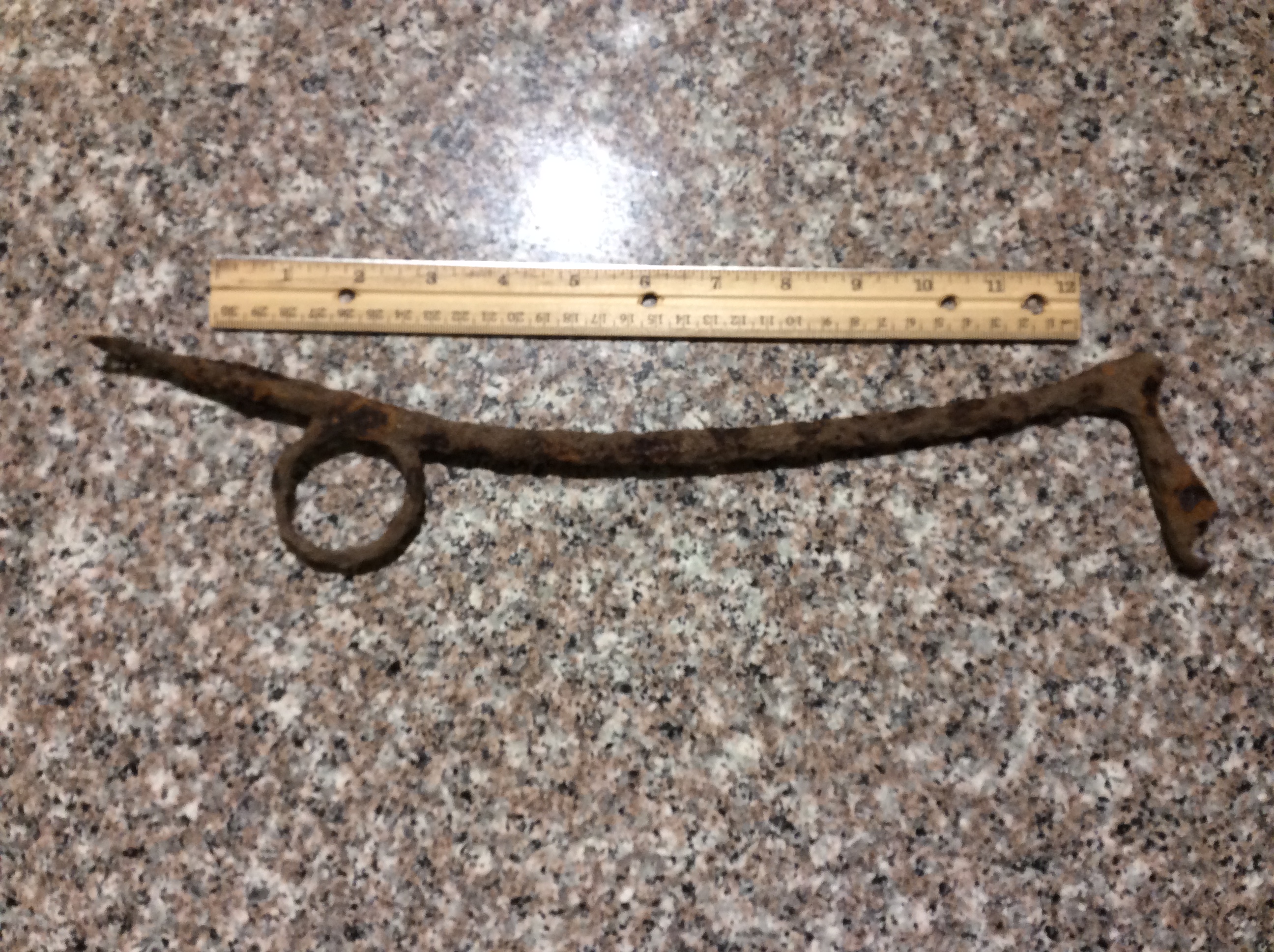

Another hobby of mine is metal detecting and the cool early American items I find in the ground are one of my major inspriations for blacksmithing.  I found one item in what I believe was a trash heap along the outside wall,of a mill that started along the CT River well before 1700.  There was a 250 year old oak growing in the center of the foundation.  Along with loads of bent nails, clam shells and broken plates I found this item.  I need to go back and dig deeper because there is more on this site but time is not with me.  Anyway, can anyone recognize this or guess it's purpose?

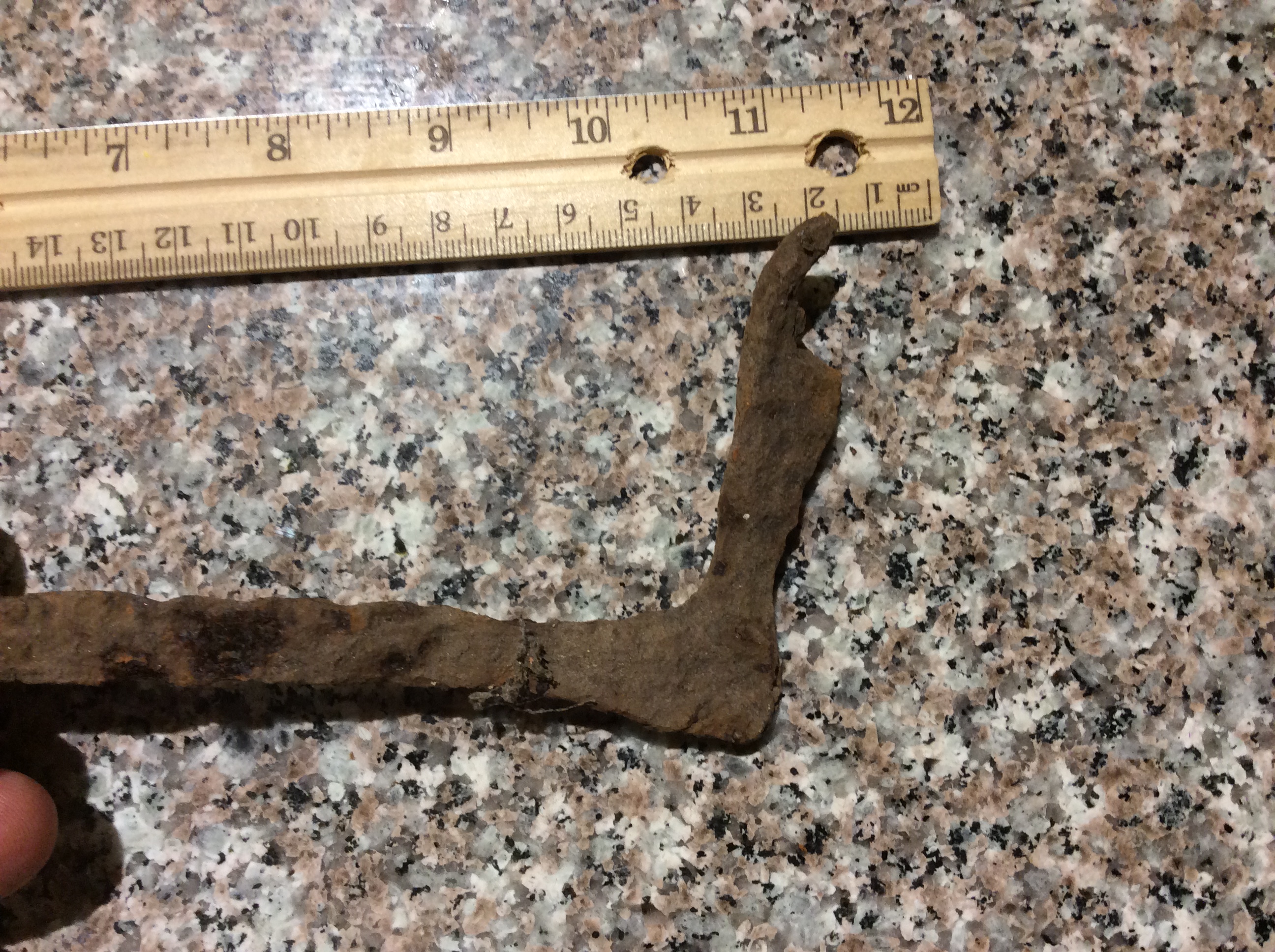

image.jpegIt was clearly broken in one place in the thickest section that is handle-like.
image.jpegThe other end has a saddle shaped opening the purpose of which I cannot surmise.  I've been trying to unravel the mystery of what this once was for a while now.  Perhaps someone here (a curmudgeon knowledgeable in early Colonial ironwork perhaps) can point me I the right direction.  Thanks in advance for any suggestions.  The only clue I can offer is that I found a number of ox shoes and lead horn tips nearby so they definitely had oxen as working animals for the mill.  The area was also known for the granite quarry just up the hill that shipped stone as far as London.

Looks like part of a harness set for a horse pulling a plough.
I was thinking the same thing but was put off by two things:. It is very small comparatively and they always seem to be made out of wood.  Right after reading your post I went ahead and searched images and found ONE example of something similar but it had more rings and was more ornate.  I'd be pleased to find out it is part of a super primitive plowing harness!

Acualy your close, it's part of a set of light hammes for a buggy harness.
training and shoeing driving horses is my day job ;-)

in all seriousness, I would love to recreate this thing but my skills aren't there yet.  I can't even figure the order of production or how to weld that ring in place.
using real wrought iron I can see either placing the ring on the anvil horn and placing the bar on top of it and welding. (done very fast and at spitting heat of course.  Or you could even overlap it on the face of the anvil and weld and flatten down to the bar size and then redrift the ring to true it up.  Any weld lines to show how they did it?
It is very corroded.  I found it underground more than a foot down in a very old trash pile.  I haven't tried to scrape through to see more detail on it for fear that I would destroy it.  But, now that I know exactly what it is I can try without fearing making identification impossible.
I picked up a crossbow quarrel tip when I was in Germany from a fellow doing metal detecting.  He was surprised when I didn't want to buy the most perfect example; but I bought one where the corrosion showed *exactly* how it was forged as you could see the weld and the wrought iron showed how it was hammered into shape.
