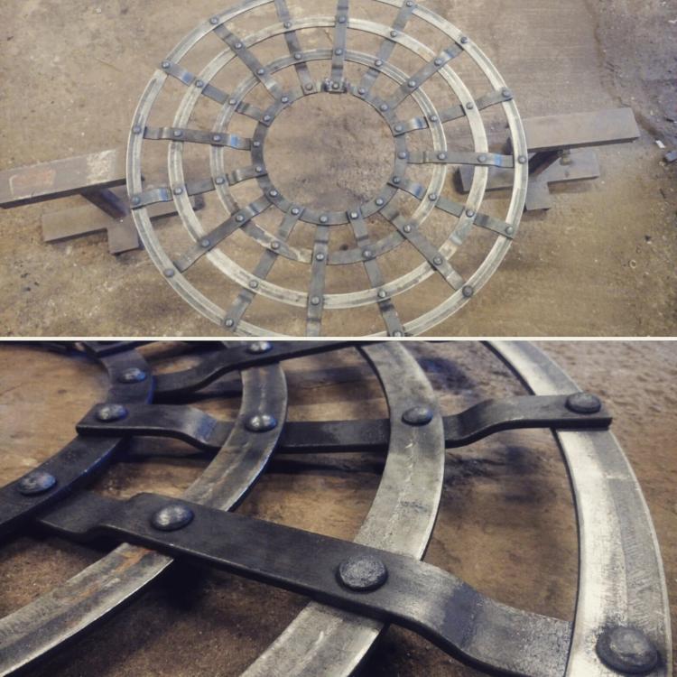

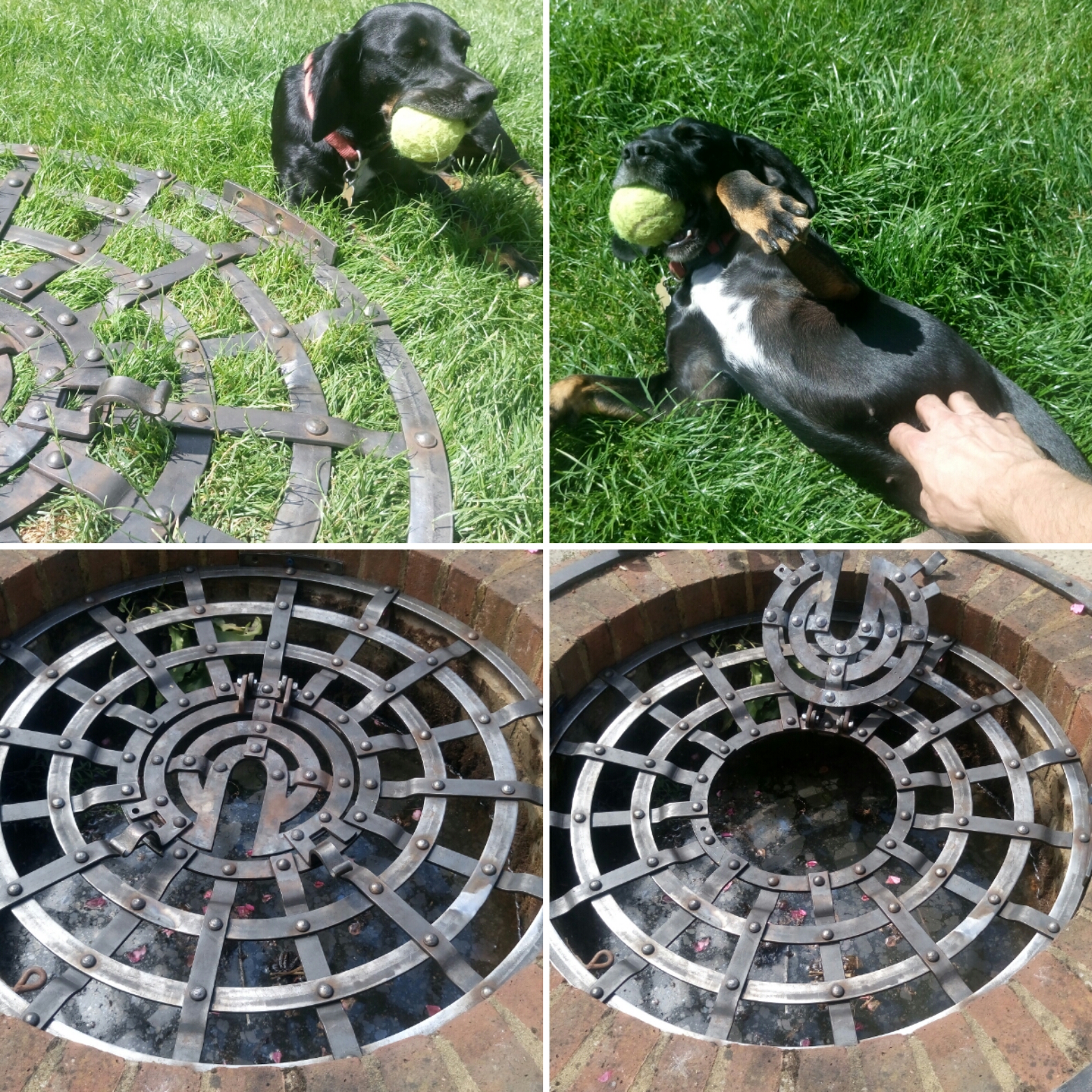

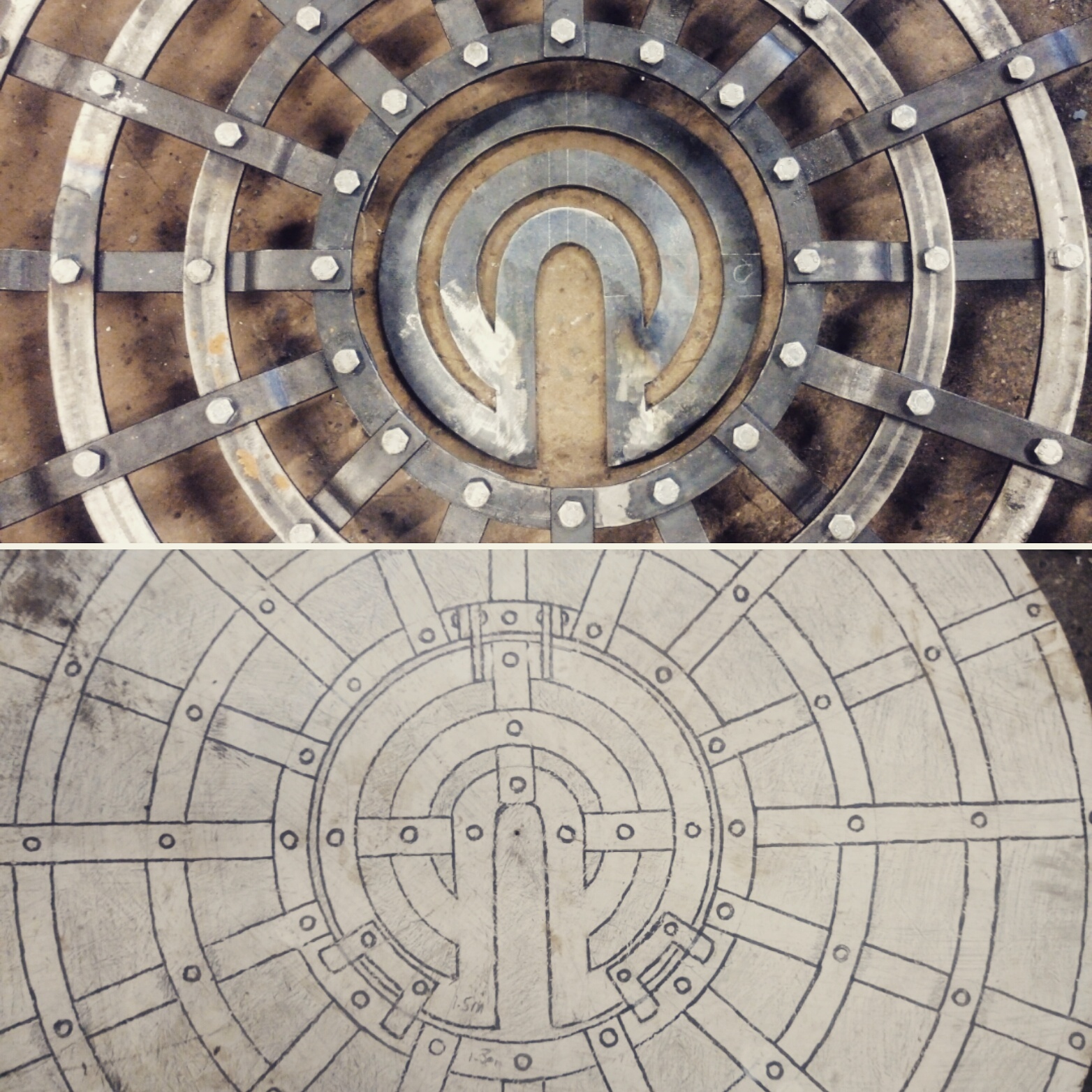

I'm working on a well cover at the minute & because of the construction method (riveted steels that sort of weave) & because it's made from 30 x 6mm flat bar rolled on edge (manually by me) I thought it might be of interest to some.

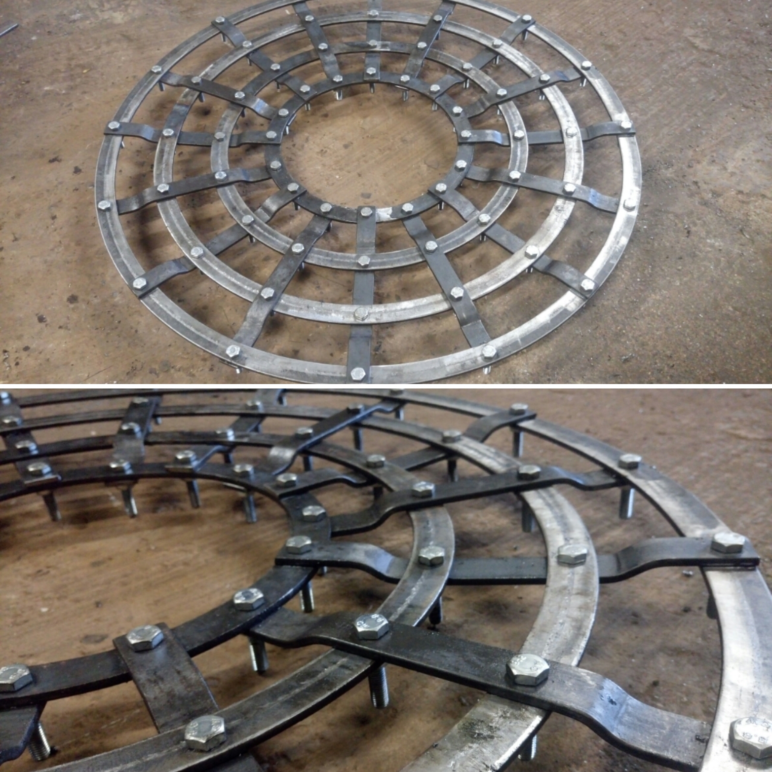

I'm a fair way through it but still got to do a few bits and bobs, including removing all the bolts to replace with rivets. I've been putting the odd video of the making on YouTube & taking production progress snaps. The idea of the hatch design is so that my clients can lower in their well pump & close the hatch back down without the hatch pinching on the pump hose. It was mutually designed, I started the ball rolling with a few ideas & we went from there.
The flat bar in the hatch was bent hot & the smallest diameter hoop of the 4 outside hoops was rolled nearly all the way, then finished off hot.

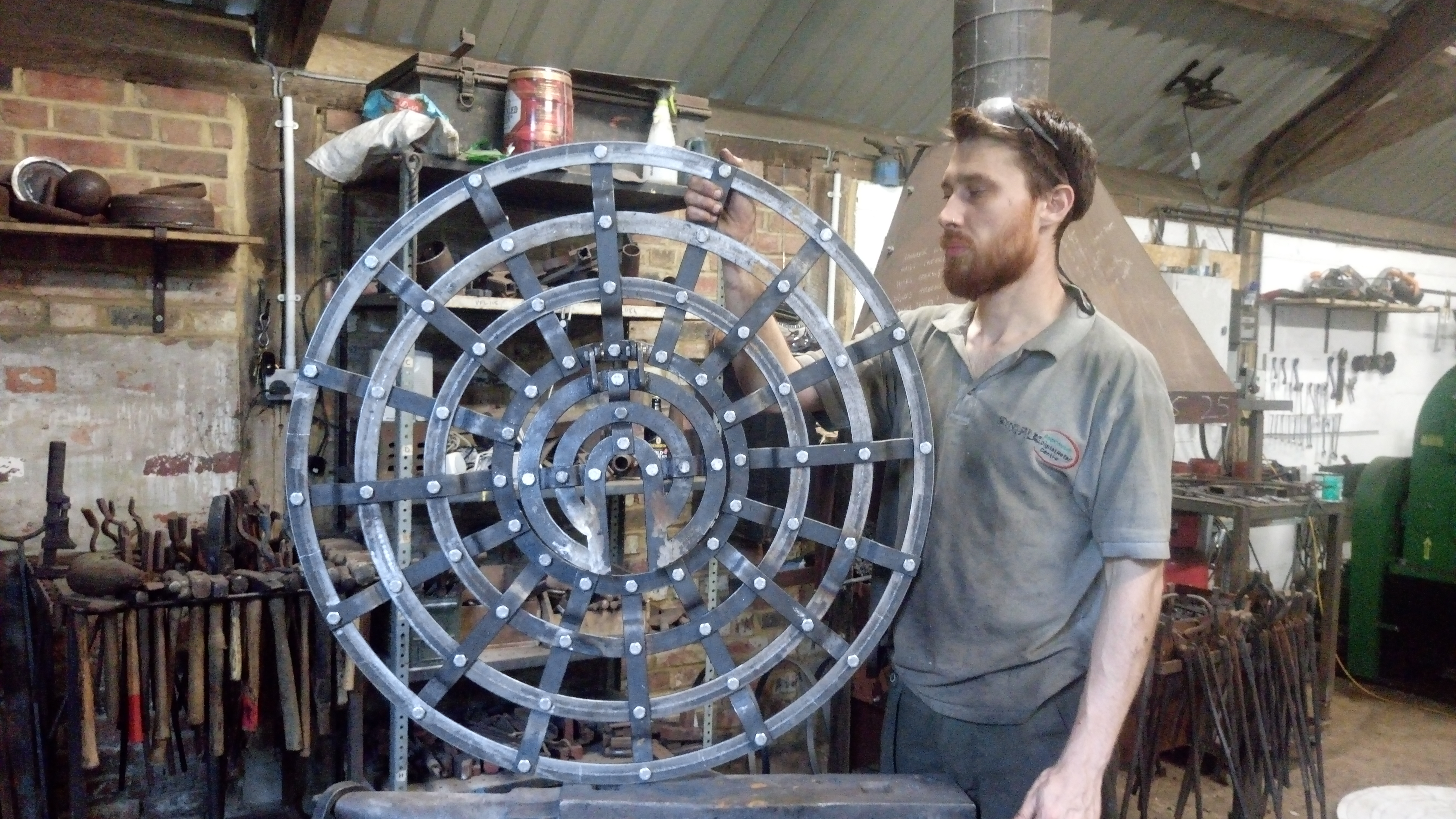

I've got a young chap with me at the minute working as my "apprentice" before he goes off to blacksmithing college in September - today we did all the 64 outer rivets in 2 hours. I recorded some video which I'll upload to YouTube later.

Dummy run install to sort fixing points went well.
Off for blasting, zinc spraying & vinyl top coat now & hopefully ready for final fit next week.
