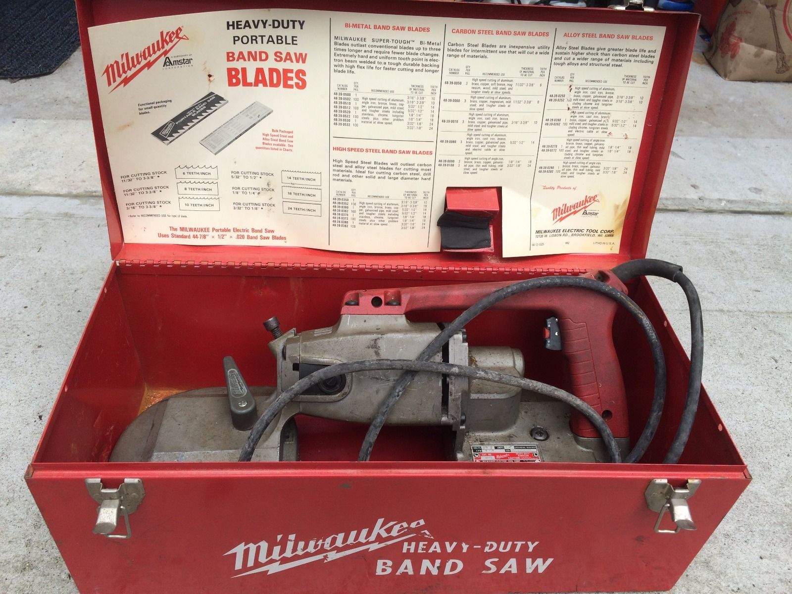

you can get all kinds of name brand portaband saws for under 70 bucks at the swap meets....
I picked up a milwaukee like this one (not the same, just a pic of one like it) for 50 bucks with box etc.... and there was another portaband heavy duty all metal 2 speed for 65 bucks...this was last week...I see them all the time...Just go early!
