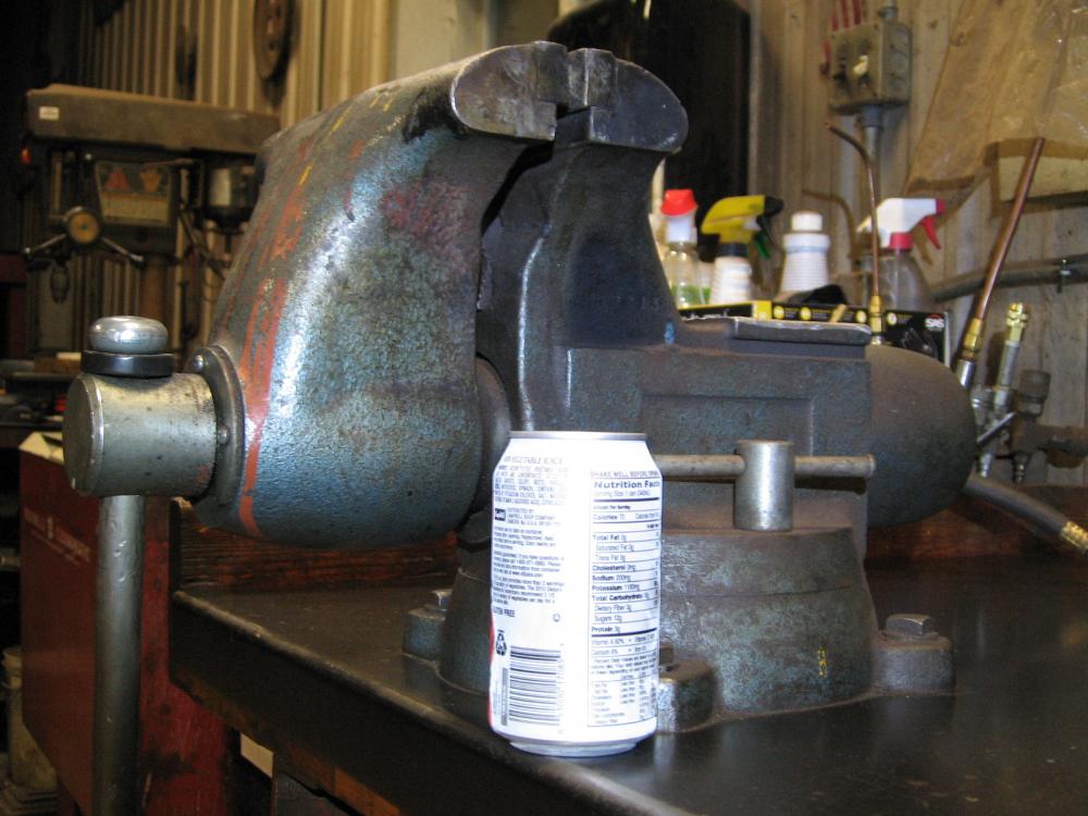

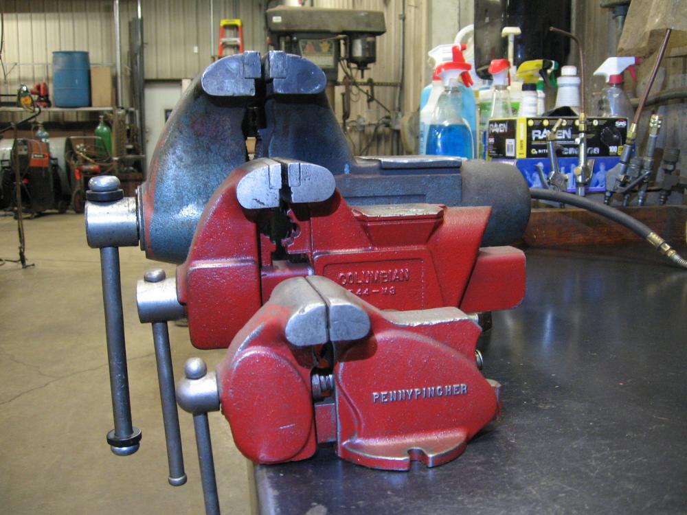

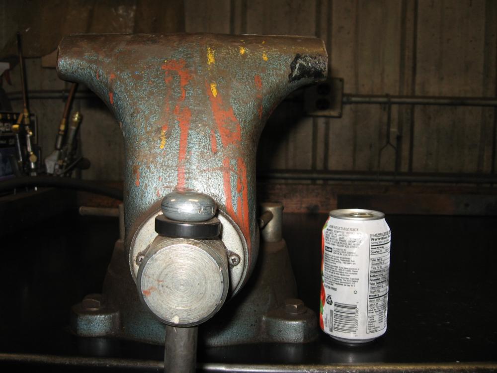

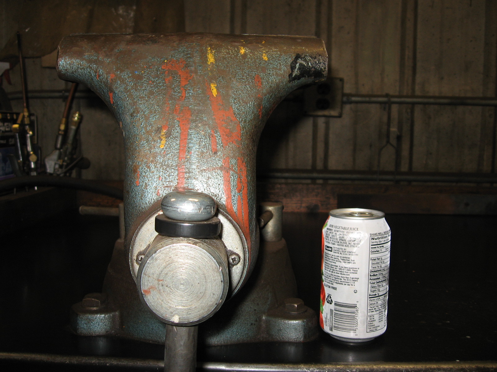

SReynolds Posted April 1, 2016 Share Posted April 1, 2016 I'm only going to say this once. If you think for one minute that a bench vice cannot take abuse of a very heavy hammer you either need to discard the Fisher Price play toy and buy a real tool or you overheard someone's Uncle say that very same thing who had used a Toy bench vise and experienced poor results. Oh......by the way, I overheard someone say in the lawn mower shop all Polan chain saws are junk and I think all Interstate Batteries are junk. Quote Link to comment Share on other sites More sharing options...
Frosty Posted April 1, 2016 Share Posted April 1, 2016 I have a 8" Wilton that can take a lot of abuse but compared to what a leg vise is designed to take. Not so much and the same model Wilton goes for $1200 at the industrial real hardware store. By take a beating I'm talking about two guys and sledge hammers team striking a piece in a 4" leg vise day in and day out. Ever run Stihl or Huskvarna? Poulan aren't junk but . . . Not professional grade. I don't have a lawn mower, don't have a lawn I live in the forest. No, that wasn't a gauntlet but I've used these things lots. Really I have. Frosty The Lucky. Quote Link to comment Share on other sites More sharing options...
SReynolds Posted April 1, 2016 Share Posted April 1, 2016 How did you know? Yes. Very Very costly. Malleable iron. Dent's, won't crack. A can of soda next to the Wilton. And a Very stout four inch Colombian Shop Vise with a common household vise next to that. Quote Link to comment Share on other sites More sharing options...
