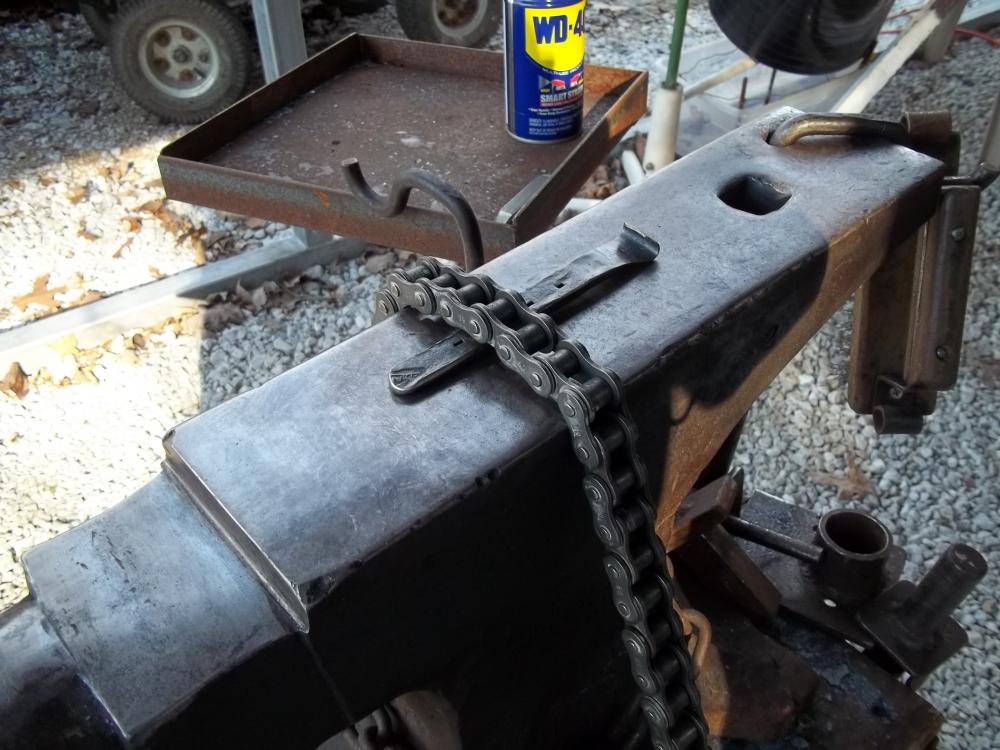

arkie Posted December 26, 2015 Share Posted December 26, 2015 As dickb suggested, a chain works great. I used a roller chain from some logging equipment. Regular link chain doesn't lay as flat as the bike chains. Motorcycle chains are great too, but with the proliferation of belt drives, the motorcycle chains are getting harder to find. I also use a hold down that sticks in the prichel hole. (I think I have posted these pictures before). Quote Link to comment Share on other sites More sharing options...

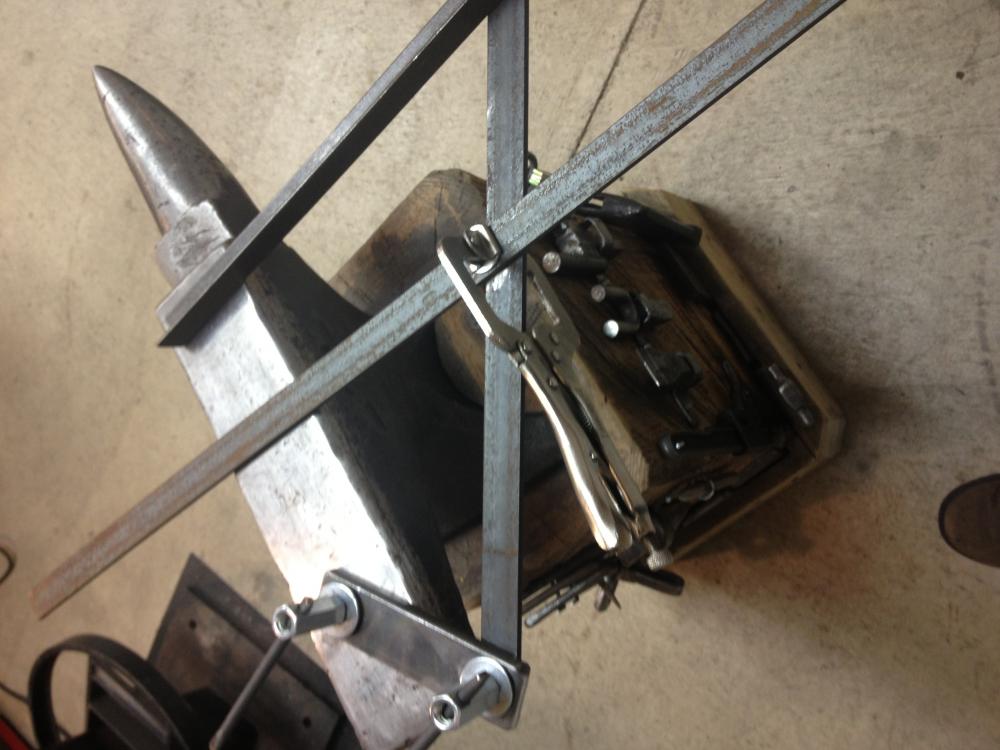

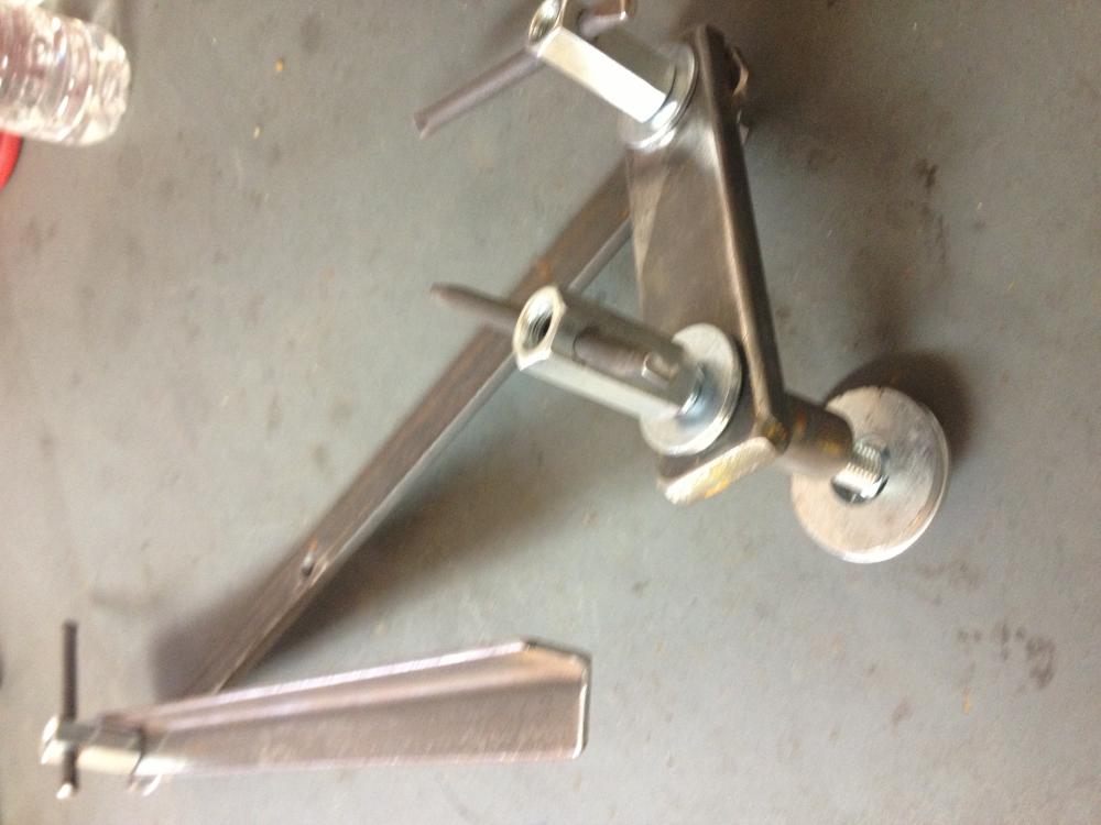

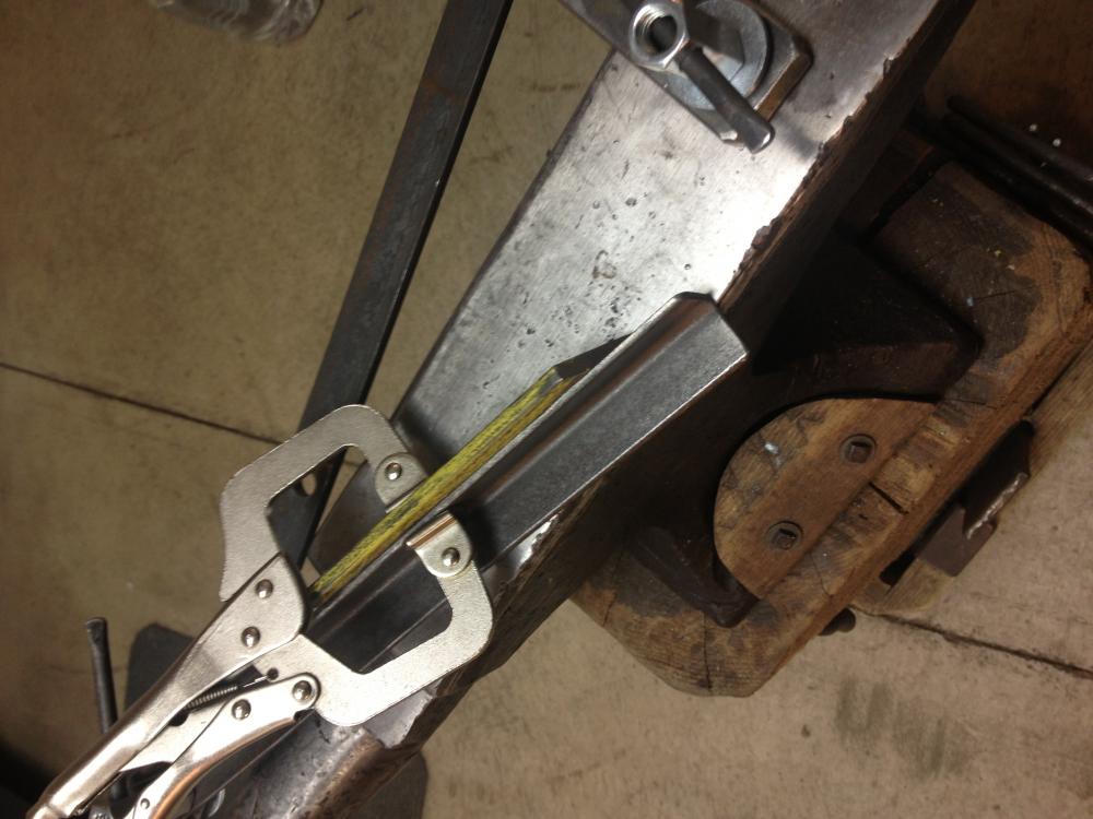

Jim Coke Posted December 26, 2015 Share Posted December 26, 2015 Greetings Vend/ all. I have posted this before but I though a refresh was in order. A simple set up for holding a part on the anvil or for edge work. Easy to make and handy.. Have s great new year. Forge on and make beautiful things Jim Quote Link to comment Share on other sites More sharing options...
