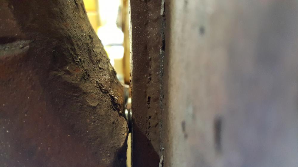

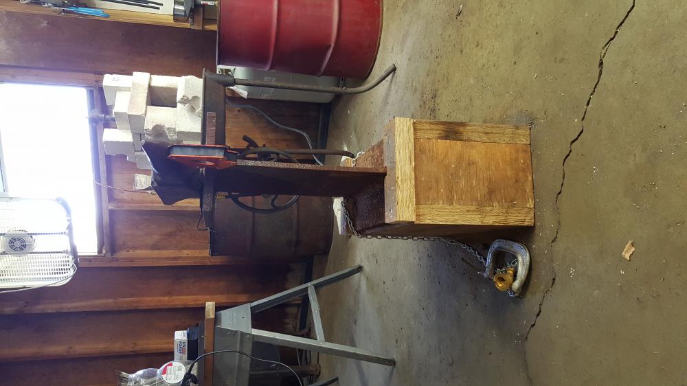

Xaiver Posted October 15, 2015 Author Share Posted October 15, 2015 Here are a few photos to help with visualization. Quote Link to comment Share on other sites More sharing options...
Buzzkill Posted October 15, 2015 Share Posted October 15, 2015 Not sure if you want to go this route, but I'd be very tempted to cut the I-beam just below the top plate and then bolt that plate to a new stand - probably wooden. The pictures may be deceiving due to angles, but it appears to be pretty high. Quote Link to comment Share on other sites More sharing options...
Charles R. Stevens Posted October 15, 2015 Share Posted October 15, 2015 Yikes, not the way I imagined it at all.. If your dead set on retaining the "I" beam i would certainly laminate 2x stock to fill in the sides. It will quite and stiffen the web. I would also trim the top flange, especialy tord the horn, but posibly the heal as well. A bit of work with a hot axe and you could have a nifty 3 leged stand. Slice the web and bottom flange off, sculpt the web to make the back legs (think plywood table) and the bottom flange as the front leg and brace/ stiffener. Trim the top flange and the scrap becomes gusets, feat and leg extensions. Quote Link to comment Share on other sites More sharing options...
Frosty Posted October 15, 2015 Share Posted October 15, 2015 That's a gong. Try strapping a couple sand bags to the web till you can get it cut off that piece of wide flange and remounted to something better. Mounting it on wood will only let it resonate longer so it's going to be louder for longer.Honest, I'd have my cutting torch out or taking gouging rod to the welds before I struck anything on it. I'd rescue it if I could but I'd never use it if I had a choice.Do you have a welder? I suppose if I couldn't find a chunk of steel large enough to replace it's body and feet and I just HAD to use it I'd start welding steel into it. Criss crossing strap and bar between the flanges against the web. Different lengths and weights of NON STRUCTURAL SHAPES will disrupt the resonance and help turn the ear splitting ring into a clang.I see Charles and I have been writing at the same time again.Frosty The Lucky. Quote Link to comment Share on other sites More sharing options...
LibrariaNPC Posted October 15, 2015 Share Posted October 15, 2015 I'm with the others: if you have some way to cut that off, do so. I'd even pitch the idea of cutting off the topmost part of the beam (the "table" with the anvil) and find some way to bolt that to a new base that you can easily dampen.Barring that, Frosty and Charles are on a good wavelength. Quote Link to comment Share on other sites More sharing options...

Xaiver Posted October 15, 2015 Author Share Posted October 15, 2015 It's mostly angles for why it looks so tall. It is a little higher than the recommended height, but iI haven't had any troubles with it there. Second photo is from my chair,third is the best iI can get for between the anvil and the beam. It looks like they cut a hole in the beam at center and then bolted the anvil to this little plate and then welded the plate on the beam. Quote Link to comment Share on other sites More sharing options...
Buzzkill Posted October 15, 2015 Share Posted October 15, 2015 Well, you currently have about the worst case scenario for ringing, so just about anything you try is likely to be an improvement. One of my dad's favorite sayings is "Try the easy things first." What's easiest and least expensive for you to try? If it doesn't require much time or money then that's where I'd start. Cutting the vertical portion of the beam with a 4 inch grinder and cutoff wheels is doable, but it will probably take several wheels and then you'll still have to grind it flat because you won't be able to get right up against the horizontal plate while cutting.In your situation I probably would try putting some tight fitting lumber against the web between the horizontal plates and strapping it in tight and then testing to see if I could live with it, but I wouldn't be too optimistic about it. Quote Link to comment Share on other sites More sharing options...
Frosty Posted October 15, 2015 Share Posted October 15, 2015 NO, NOT wood! If you've ever made or looked at a percussion instrument say triangle you'll notice it's mounted on leather or . . . WOOD. Wood won't damp the vibrations (SOUND) and you want to damp the sound. You would do better (Literally) gluing rocks to the web.Unbolt that thing and use the wide flange (you're calling I Beam) for something else. Coupling the anvil to the wide flange better will increase it's ability to resonate making it louder.If you've ever touched a cymbal, triangle, etc. while it's ringing you've experienced a damped reverberation. That's what you need to do, disrupt the resonance. Just taking it off that wood stand and sitting it on bare concrete or dirt will help.Remove it from the wooden stand, find a wooden box it will fit inside with a little room. Block it to your working height and fill the box with sand or dirt. If you lean or JB Weld different lengths of rebar against DIFFERENT heights of the web before you fill it with dirt it will help.Frosty The Lucky. Quote Link to comment Share on other sites More sharing options...
