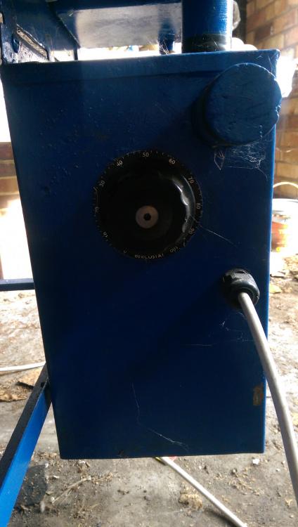

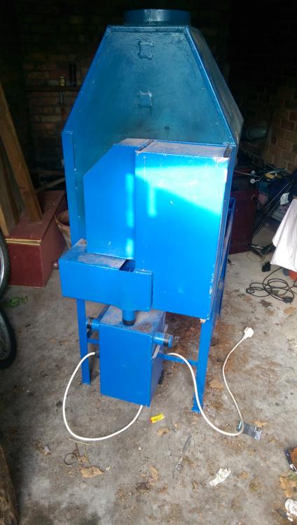

i'm here to ask you all for yet more advice. When i bought my anvil, vise and tools the seller talked me into taking his forge too, which at the time seemed like a good idea. Now the problem is that i've had to buy materials for and build a lean-to/workshop type structure down the garden, to eventually work in,  and generally make sure its suitable for what I intend to do. i've spent months working on this trying to get it all ready to use before winter and my personal deadlines keep being missed and its disheartening.
Now the forge I got is a beautifull thing, however i've never even had the chance to light it and after the cost of building and aquiring everything to actually start swinging i've now ran into the issue of electricity to power the blower on the forge and it's starting to get demoralising. The cost of laying a cable and getting power would be madness and due to recent circumstances money has suddenly became a very precious comodity. What i'd like to know is if you all think I would be better served selling or trading my current forge for somthing smaller and simpler to get me started, and worry about paying for such luxurys as a blower and power points when i'm skilled enough for that to be more of an issue and can hopefully make my forgings pay for itself.

Sadly this one requires the electricity, thats why it's such an issue right now. It has a blower and everything built on the back, unless you meant to remove the electrical element and attach a bellows that way? i'm sorry if im confusing you or not being descriptive enough, the learning curve is feeling so vertical recently its begun its own scrollwork.

Can we get a photo or two of the existing blower mechanism? I would also explore human-powered modes of air supply, and it may be possible to remove the electric motor and provide some other means of turning the fan.

Ill take tomorrow, this would be ideal.

If it is a universal motor, then DC (batteries) is a tempuary selution. One of the small gennsets is an option as well.
This is another ideal solution. Gen is something i'd end up buying downline anyway I think so I can jusitfy this more expense-wise and i'd not even realised I could use batteries until this thread! Is their a guide on here somewhere for setting up whatever connections i'd need?
Lots of "off grid" info out their. Idealy with a gen set, one would use a batery charge and inverter to charge the bateries off the generator and use the inververter to produce AC (lines) electric. If you have a "universal motor on the blower (generaly have replacable brushes) then you can do with out the inverter. Now, the genset can be used independant of bateeries its just more fuel efferent.
My forge is unpowered, previously I used a water bellows as a stop gap until I completed my Box Bellows (these can be made very easily and very crudely and still be very effective), Your forge could still be used as is, as a simple hearth forge, and you could then update with a power supply later. I know it can be frustrating not meeting the deadlines you set yourself, I've been in much the same predicament myself for many years, but it looks like you are almost there.....keep pushing!
I'd also add, that for the learner, there is much to be said for a manual bellows......specifically, not burning half of your steel away through a temporary lack of concentration....you'd be surprised how quickly a good blower can ruin a decent piece of work!!!!!

I see no labels, stamps, stickers, plates or anything more than just the dial on the blower. It appears to be the original part and has a 13A fuse.

Just because that thing has a blower attached to it doesn't mean you have to use that blower.  Build a simple box bellows and plug it into the airway.  A day's labor and a few "quid" for some lumber... and it's all together except for joining it to the forge.
I certainly wouldn't get rid of such a nice forge.  Very nice bit of kit, even if that shade of blue is a bit on the ugly side.

Have to get in the housing to acualy see it, safty or noise abatment? Sould be simpe enugh to coble up somthing for a temp, say a 12v hair drier for a caravan camper, or adapt an old car heater blower (soup can and a cookie tin) ext, if you want to stay electric. Temperary with out to much brain strain looking to see if the motor is universal. Then again an inverter and a battery is still an option for now. Lots of ways to go.
